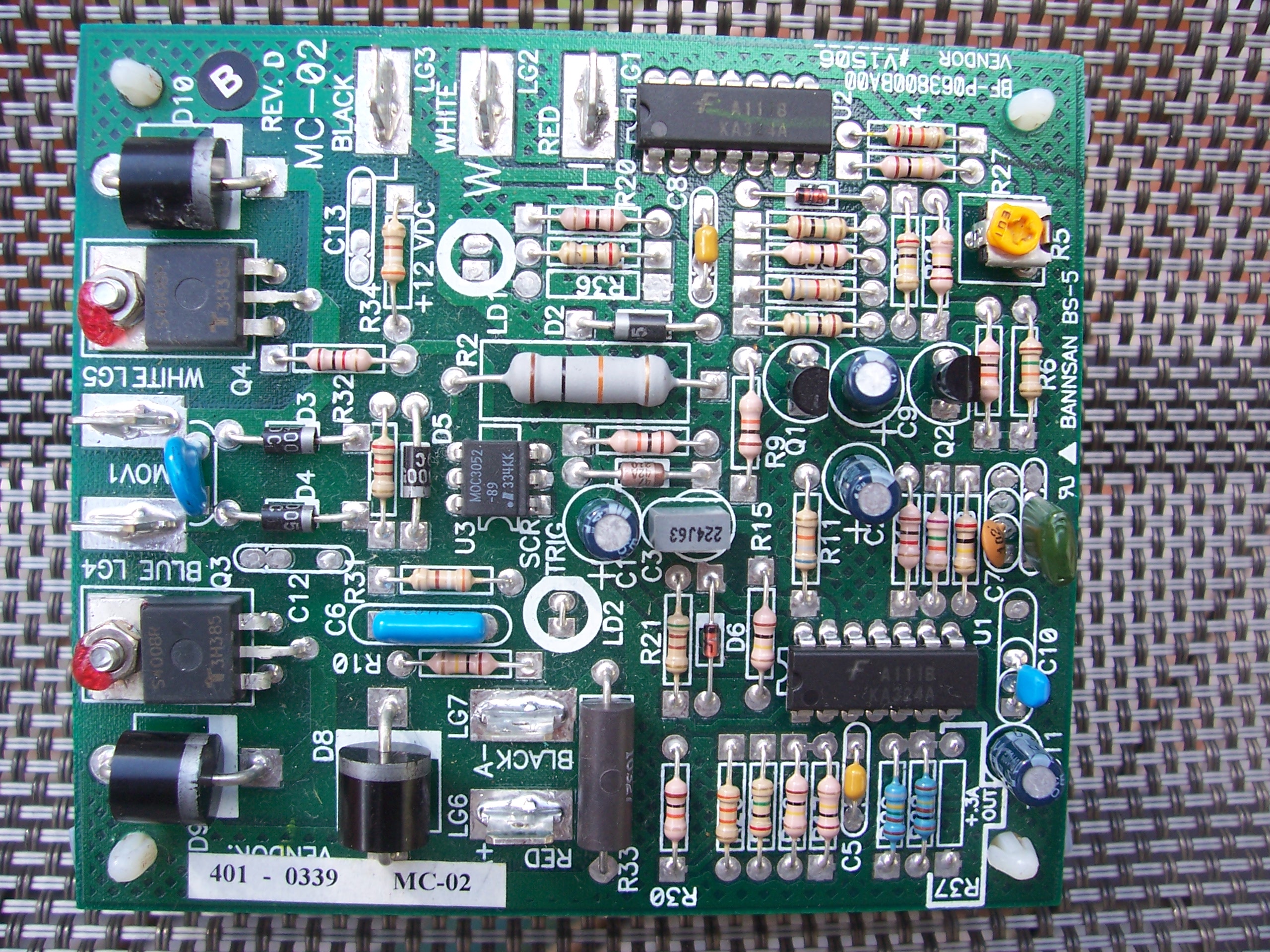

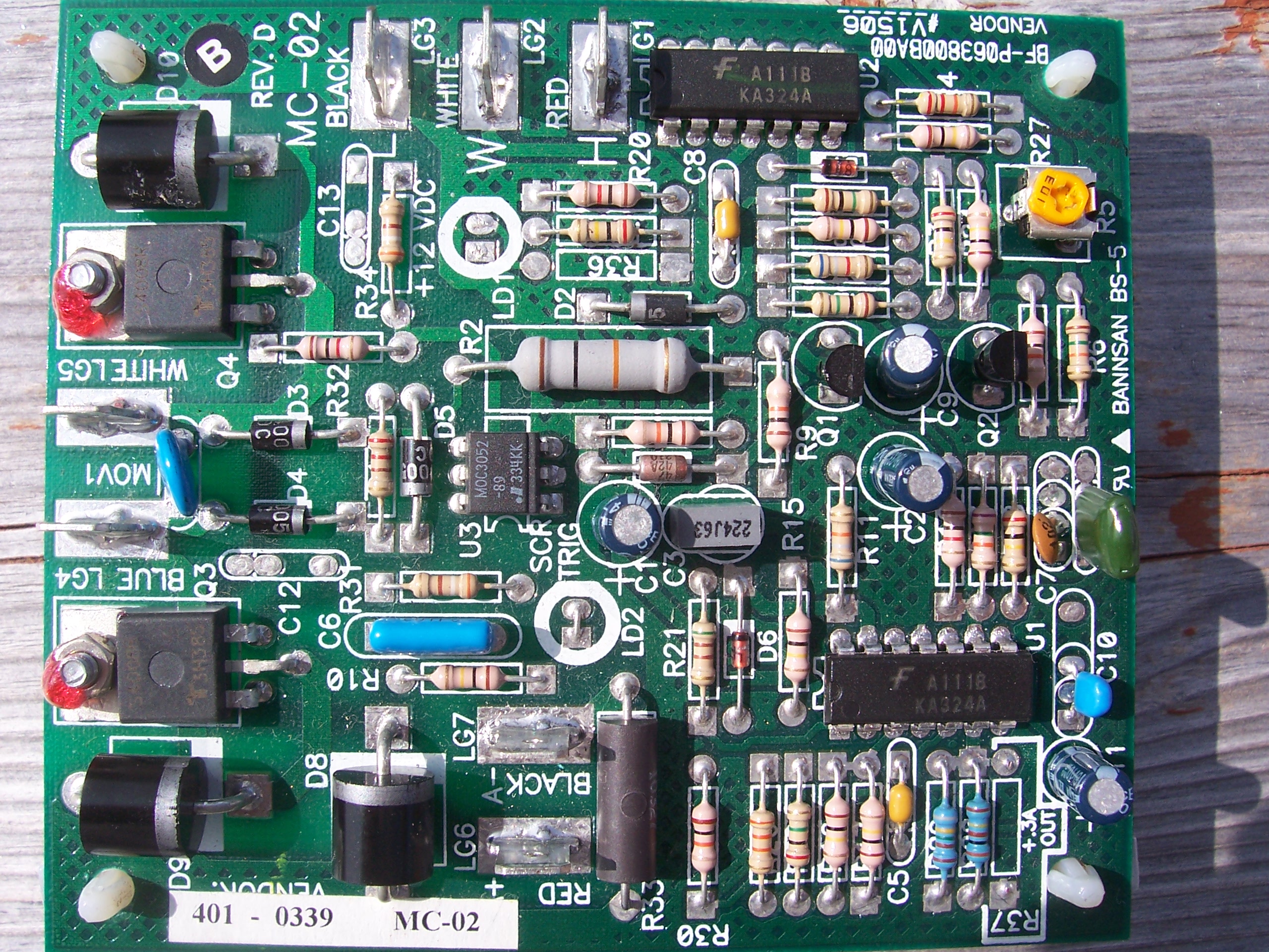

    Treadmill DC Circuit no motor start
    MC-02 Control Board
    I picked up a treadmill at a yard sale (was hoping to use the DC Motor and Controller on my drill press) brought it home plugged it in and it worked fine. I removed the motor, controller and the control panel from the frame and tested it on my bench it would not start the motor? I reinstalled it back on the treadmill frame and it still would not start the motor? All the wiring hook-ups was checked and double checked as per the wiring diagram. I must have damaged a component on the board but there is no evidence of that? The board is a MC-02. I checked some of the voltages on the board and recorded the following;
    1) 120 VAC across LG4, LG5.
    2) 5VDC across LG1 and LG3.
    3) No voltage across LG6 & LG7 (To Motor)
    4) Ground to LG6 is 54VDC the same on LG7
    5) Probes across LD1 is 12VDC (not sure what LD1 is)
    6) If I jumper center leg and right leg of Q4 motor will run?
    I have no idea what the voltages should be except the 120 VAC and the 5 VDC although 54 VDC seem to be present in many places on the board?
    I have no idea what happened or how to troubleshoot the board?

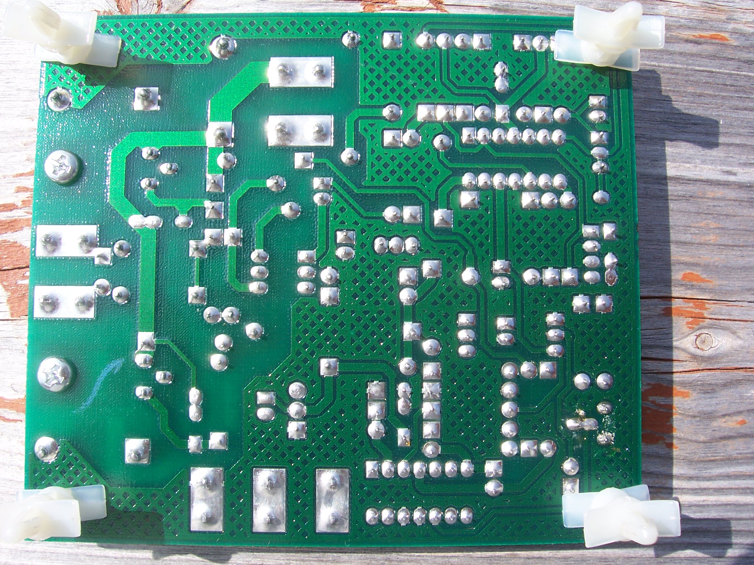

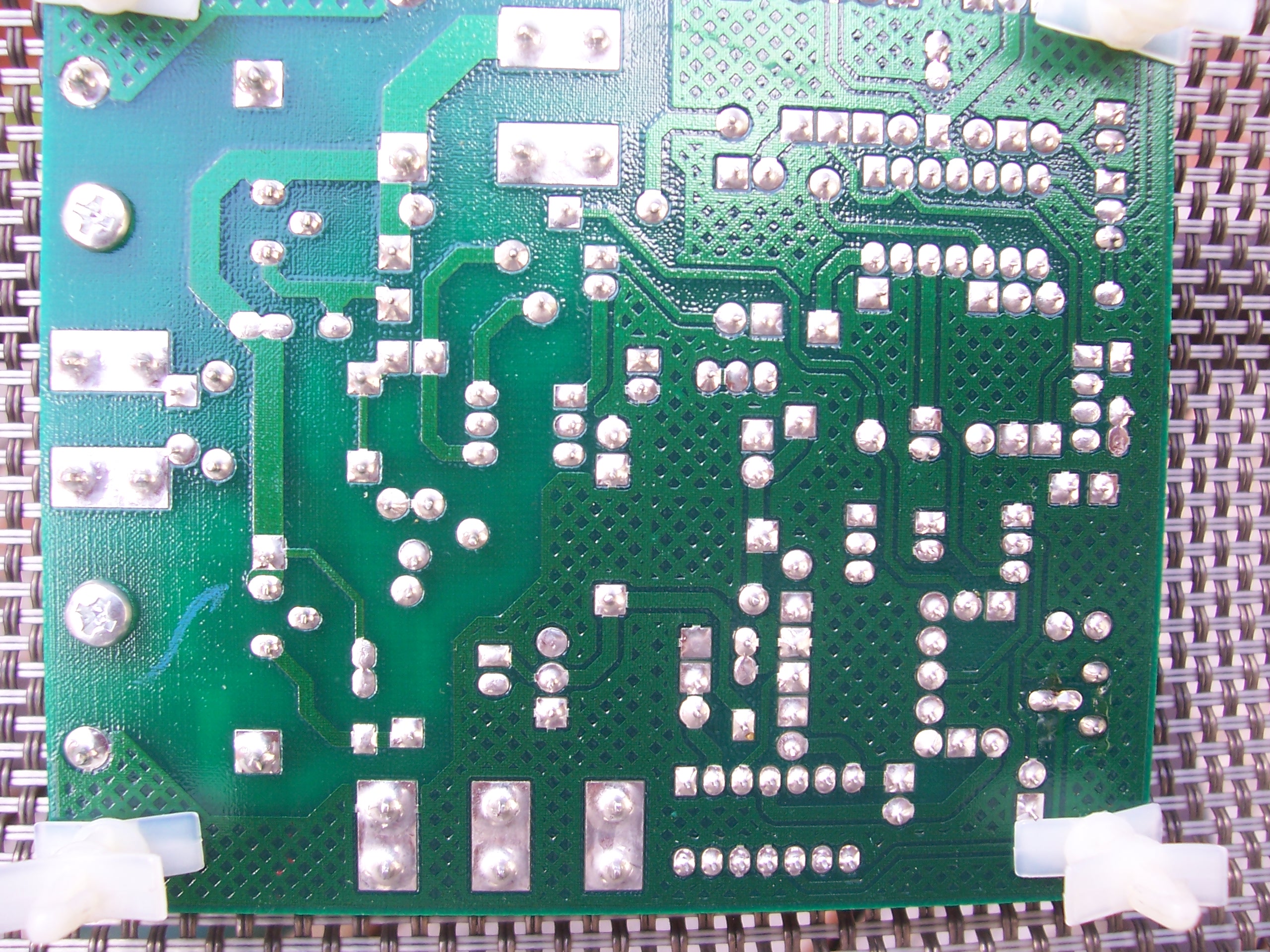

    I have included close-ups of the board front and back as well as the voltage diagram showing the wiring hookup.
    I know there are some capable people on here who know at a glance what the problem might be any help would be greatly appreciated.

    Re: Treadmill DC Circuit no motor start
    I would guess the first time you hooked it up on the bench you had a a couple wires mixed up. A close look at U2 looks like it got hot. the `2' in the KA324A looks discolored ands so does the last `1' in the A111B
          Easier to just replace. Both U1 and U2 are LM324's equivalents I think...
              What voltage do you have between LG3 and LG2, it should vary between 0 and 5 volts when the speed control is turned.
              Also check the reed switch wire, that may need to be connected, it receives pulses from the flywheel and may be needed to run.
              The mov should be ok, if it was shorted you would know it when you connected the 120v ac. Look at at it closely to make sure its not cracked or split. It should measure open or very high resistance. I see a couple marks on it but thats likely all it is.
              The KA324 are quad op amps, digikey has them for under $1.00. I would install sockets for them. something like digikey ae10012-nd or ed3114-nd would be fine.

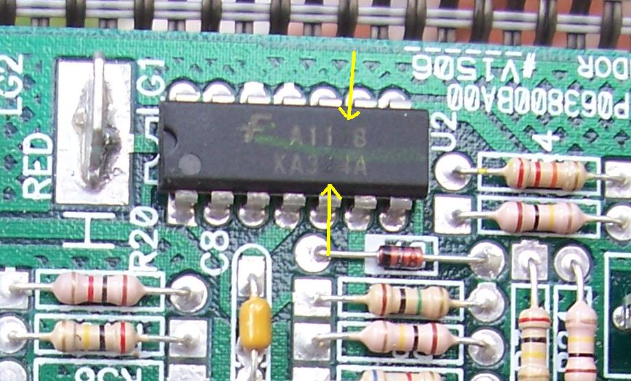

                            When I look at the ic I see these marks, If the ic got hot due to being shorted internally it can discolor the top.
                            Does the ic get hot? you could post the voltages of that ic's pins, That may or may not help.
                            The speed control does seem to connect to that ic so it would have something to due with the speed control, and if it is bad, speed could either be full on or full off depending on how it failed
                                You are not using ground to measure the voltages, Use LG3 for your ground or pin 11 of the ic
                                What point are you using for ground anyway? here is the pdf of the ic
                                R33 might be open
                                Check that R33 is not open, the value should be on it, its likely less than 1Ω
                                  beware this looks like a nonisolated possibly capacitive couple PSU, but anyway by superposition,
                                  Pin 1- 0.2, (out1) -- probably okay
                                  Pin 2- 2.2, (in1-)
                                  Pin 3- 0.5, (in1+)
                                  Pin 4- 11.4, (VCC)
                                  Pin 5- 0.1, (in2+)
                                  Pin 6- 0.1, (in2-)
                                  pin 7- 0.9, (out2) -- questionable, may be okay
                                  pin 8- 0.2, (out3) -- this looks overdriven or bad?
                                  pin 9- 0.2, (in3-)
                                  pin 10- 0.6, (in3+)
                                  pin 11- 0, (GND)
                                  pin 12- 0.3, (in4+)
                                  pin 13- 0.8, (in4-)
                                  pin 14- 0.3 (out4) - questionable?
                                  Which of U1 and U2 is this anyway?
                                      I would think the ic is bad, I can't trace where LG2 goes but it must connect to one of the ic input pins, It seems to go under the ic?
                                      check which input pin it goes to, the speed control should vary the input pin and likewise the output pin
                                      when you connected VCC pin4 to pin3 (in1+), out1 told the rest of the circuit to turn the motor full on. So I still think the ic is bad
                                      R33 will be good
