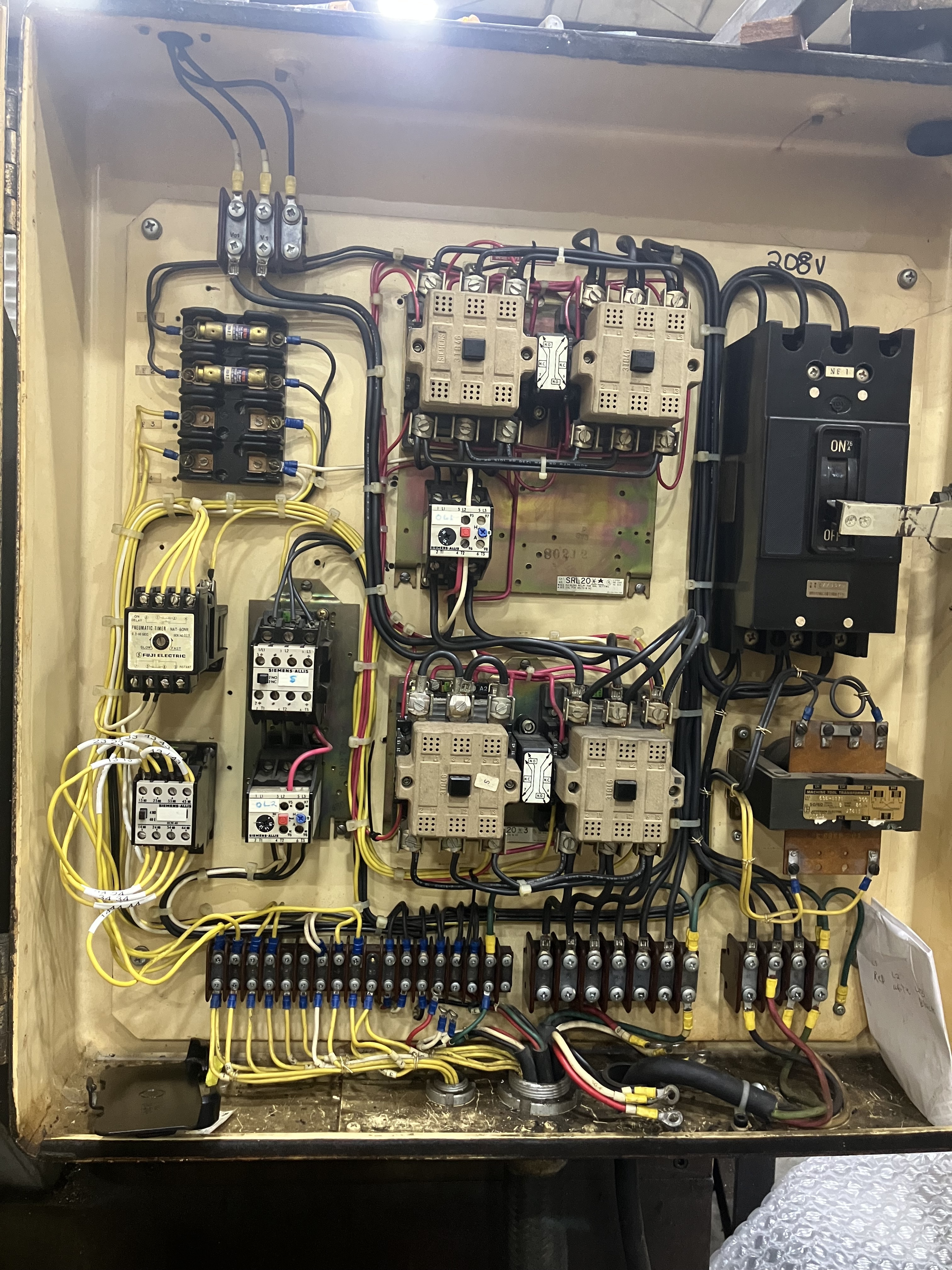

                            Update I have the controls on the lathe the person I doing this for has to find a motor rewind shop that can do this motor because of its configuration is the issue now about getting this motor rework done
                            Here is a picture of the control box the control relay is in lower left hand corner the big contactor on bottom left hand side contactor number three in the wiring diagram which is one you see with the jumper wires on the top of the contactor which figure out is the brake function for the lathe because does not turn on unless it is neutral now if you forward or reverse the four contactor turns on and one of the top contactors also turns on as well
                            One note you will notice that the motor leads have been disconnected from the wire terminal block as we as the coolant mister pump because there is an issue with both motors but there is also an issue with main motor wiring as we land needs to be replaced as well but there is also person I doing this for wanted me to get the controls working first now he going to get the other things that are needed to complete this job
