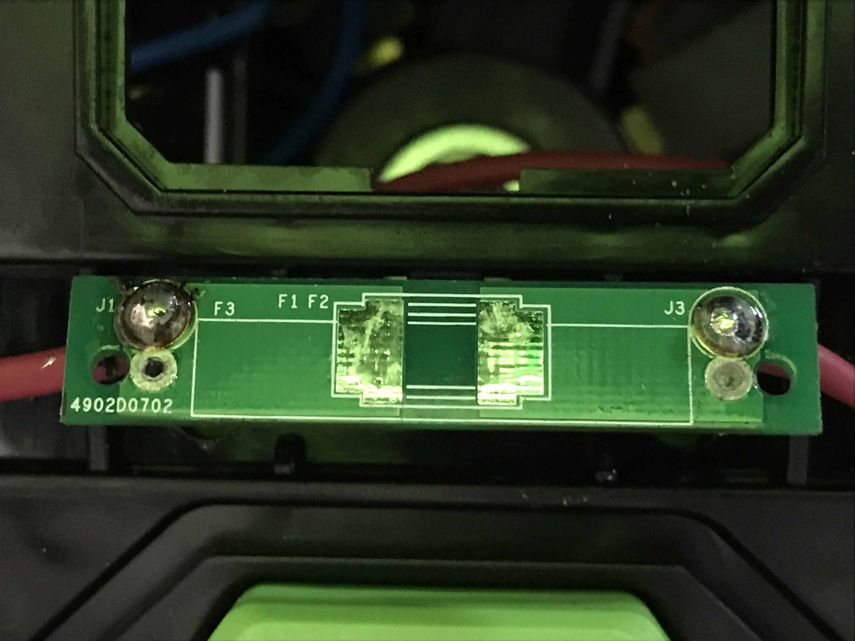

    Good morning. I'm working on an EGO brand 56V electric lawnmower like this one.
    https://www.homedepot.com/p/EGO-21-i...02SP/206515944
    I found the 40A 250V ceramic fuse to be blown. I temporarily jumped it with a 35A blade fuse and it powered on and worked.
    The fuse in question is a Schurter SUT series slow-blow fuse with pigtails for through hole mounting. When I look up the SUT series of fuses, they only show a range of 12A-30A. I'm having trouble finding an appropriate fuse. I don't have the knowledge to find a suitable replacement on my own.
    Here is the data sheet for the SUT series of fuses.
    https://cdn.badcaps-static.com/pdfs/...21042e2a76.pdf
    I don't really care if the fuse has the same package as long as it works the same. I don't have the mower in front of me at the moment, but the PCB that the fuse was mounted to has pads for a smaller surface mount fuse if I could find one of the appropriate size. I'll measure the distance from pad to pad when I get back to the mower.
    In the time being, I would really appreciate it if any of you with a better understanding could help me out.
    Thanks guys.

      Re: EGO 56V electric lawnmower, blown 40A 250V fuse
      Can we see the circuit board that the fuse is soldered on to?
            I found a Bussman 3AG glass fuse that should work. MDL-40. The data sheet only goes up to 30A. I'll have to mount the fuse a little differently as the replacements don't have any leads.
            https://cdn.badcaps-static.com/pdfs/...e500281c7a.pdf
            I've attached a pic of the board.

                Originally posted by johnboy1313
                This is in response to what you posted above
                If it were me
                I would use this one and do away with the pcb board and fuse holder
                      You have room on the PCB you can use this one:
                      https://www.homedepot.com/p/Cooper-B...R-40/100170316
                      Just wrap and solder solid wire to each eand.
                                  https://www.digikey.ca/product-detai...792-ND/2515916
                                  https://www.digikey.ca/product-detai...0801-ND/701068
                                  These are a slow blow.
                                  I'd probably change the fuse holder to accept blade fuses and take a bunch of those fuses of the last link.
                                  Thanks CapLeaker. I went with the first link after the "40A 250V" fuses I ordered on eBay turned out to be 40A 32V fuses. It's working again.
