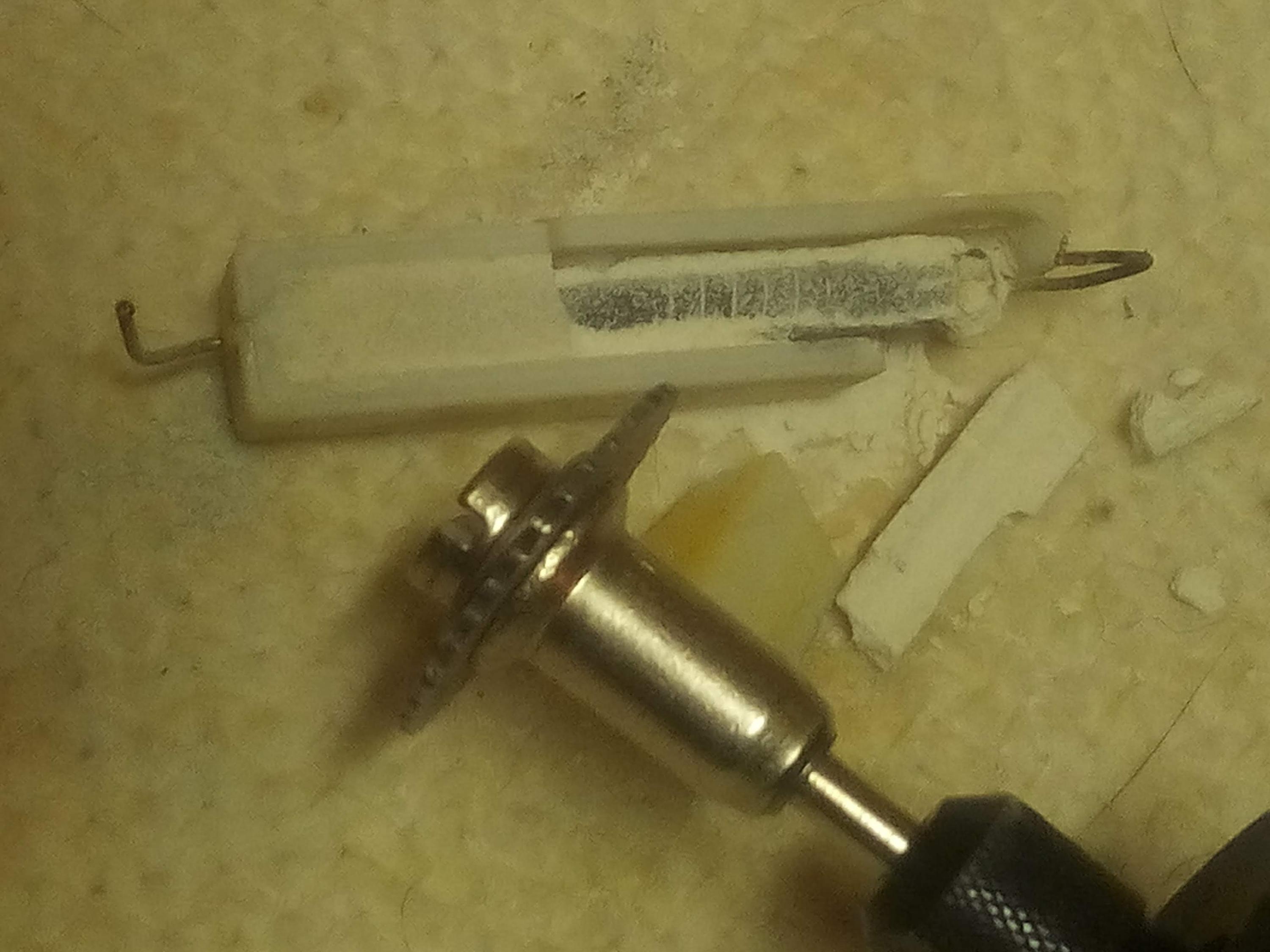

        I thought failed resistor is "Ceramic Cement", but can't find it in such lists:
        https://www.lifewire.com/types-of-resistors-818848
        https://en.wikipedia.org/wiki/Resistor
        Is it same as wirewound ? just maybe not wound so much, so in effect the construction is similar?
        It might be that the shocker was mis-used, maybe someone put a tool or something that caused the fence to constantly "shock" the tool, not sure, it's very told too

              smash the faulty one open and check, they arent always wirewound.
              i have seen the cement box type with ceramic/metal-film resistors in them a number of times.
              usually where you dont want inductance or any magnetic issues.

                OK, took the advice, and it seems like wirewound. Searching I've found THREE very similar resistors, pair of 470 Ohm 390Ohm, 330 Ohm, all 10W, the question is it going to work with either one? probably not want to mix the existing 360 Ohm...
                any thoughts welcomed, that would be an instant fix, no need to ship anything

                  found another with 350 Ohm / 10W, i think that is close enough to try replacing both

                        BTW: tested the existing/good shows exactly 360 Ohm, the bad one, shows upwards to 600K Ohm, and sometimes 1M Ohm, and sometimes OL so, it's bad
