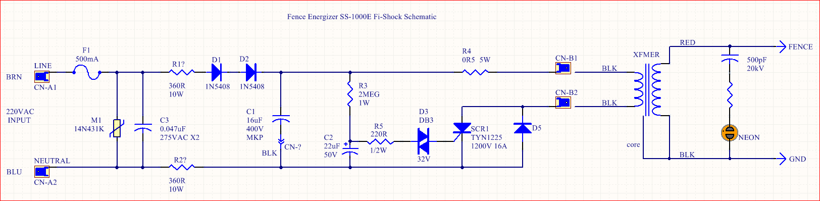

                Posting the updated schematic.
                You could test this with a series light-bulb, to limit current and give some indication of current draw. With the transformer disconnected, the only load that could heat up the power resistors is that big motor starting cap. It might be breaking down at high voltages.

                    With the transformer disconnected, the only way to heat those resistors is with a short across the large capacitor, nothing else will do it. except maybe 2 leaky/shorted diodes but they would both need to be bad at the same time.
                    It's the cap.

                      OK, took some time to test/measure, all tests were done without Load/COIL as follows:
                      Test1: Pull 400v/16uF large capacitor OFF circuit (pull cable) and energize the board. that came OK, no heat even after 3 minutes.
                      Test2: Connect 400v/16uF to board, energize the board within 5 seconds the resistors become super HOT to touch, Immediately cut power!!
                      Test3: pull both diodes out of circuit, energize board, resistors do not get hot
                      Measured components as follows:
                      Measure1: on-circuit both resistors show exactly as 360 Ohm. when board energized both resistors get 230VAC to them.

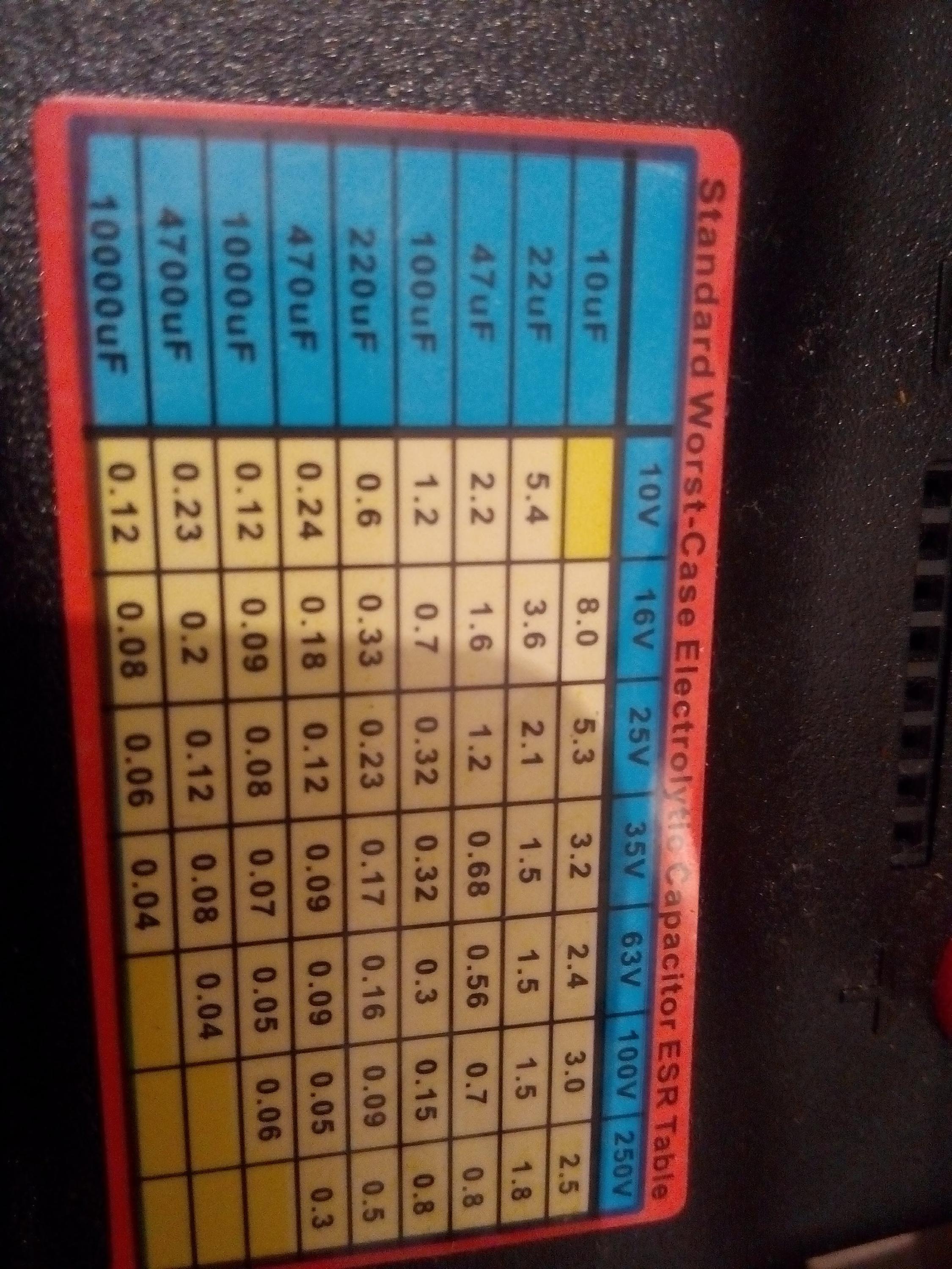

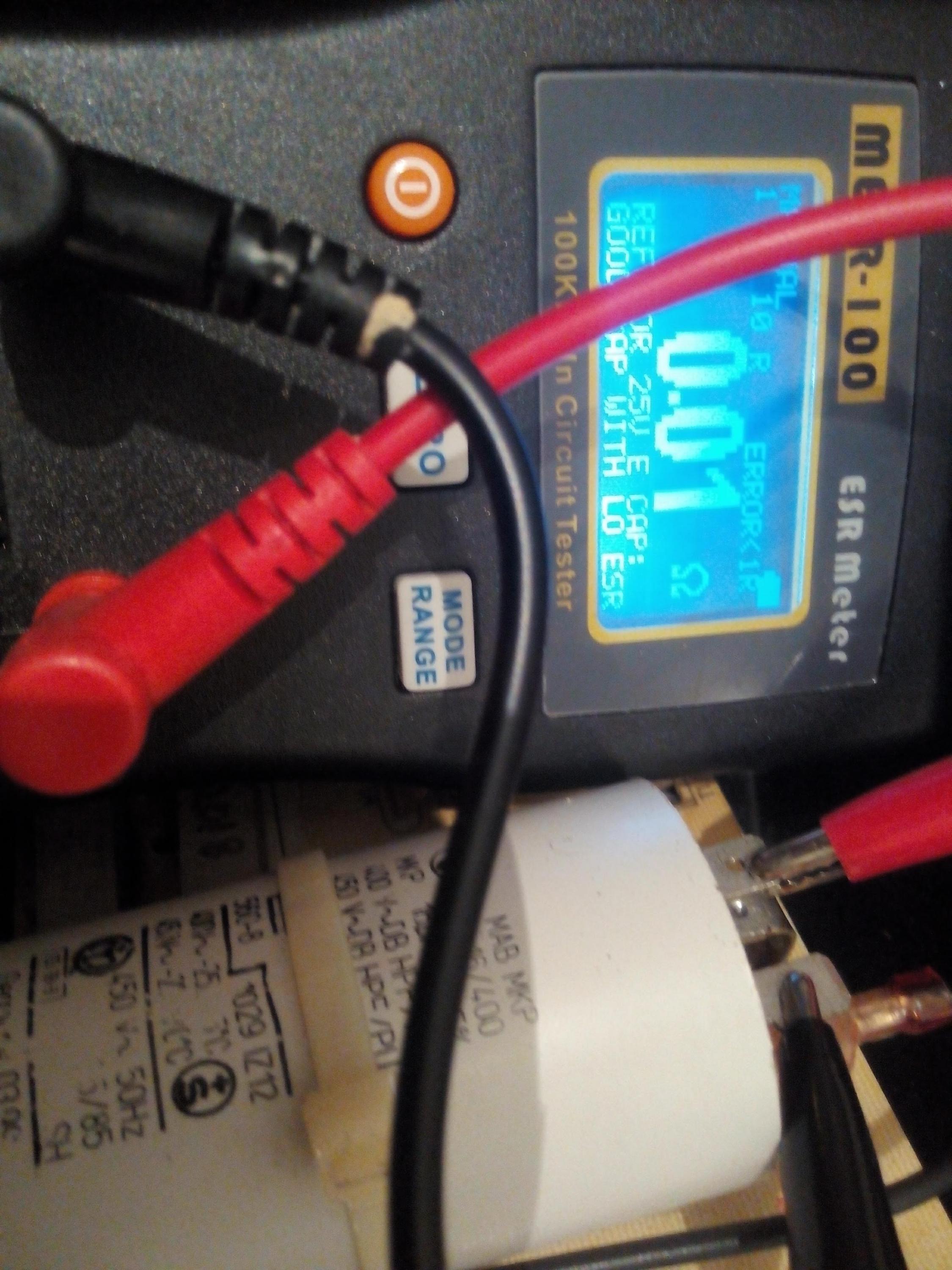

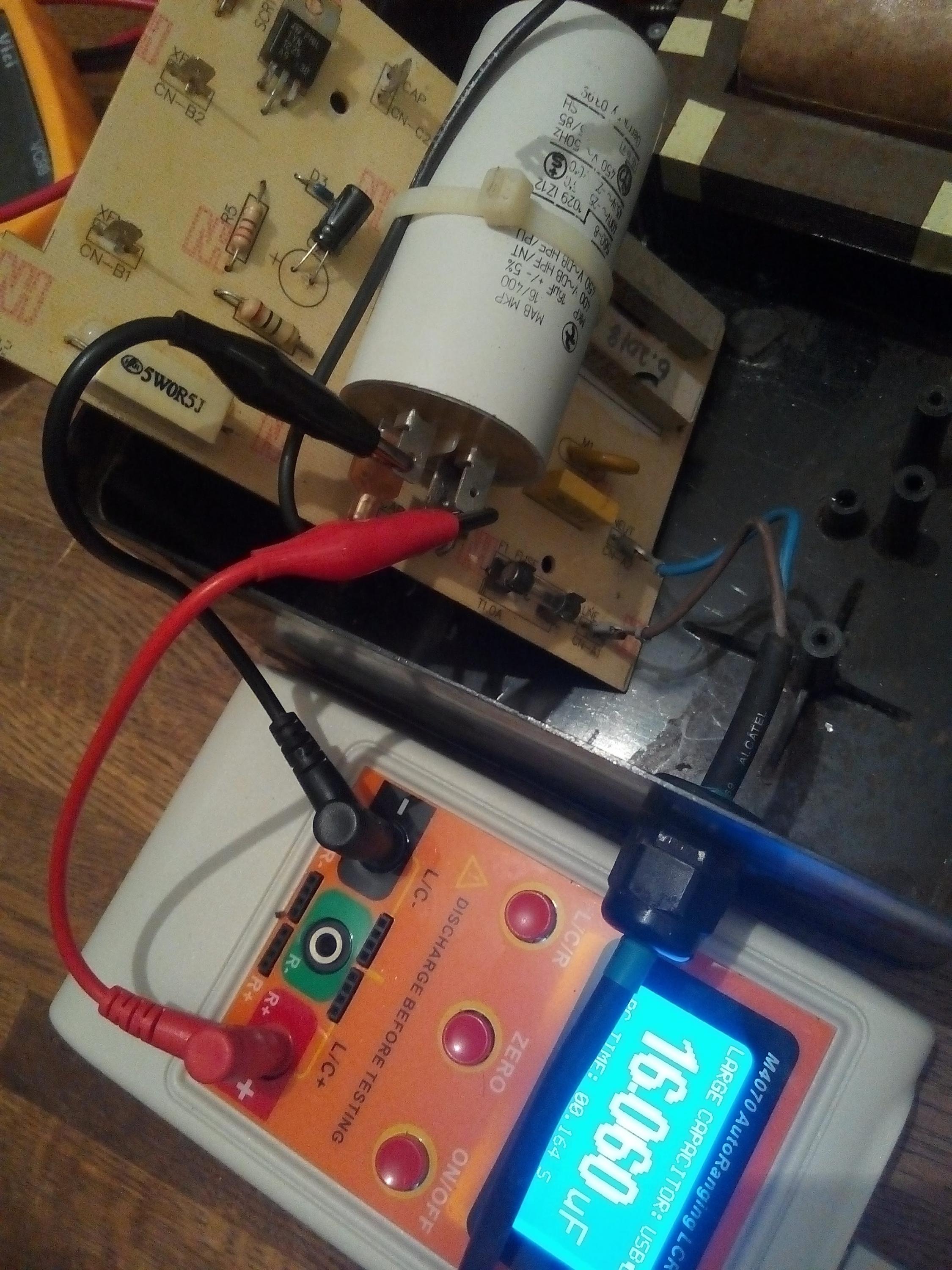

                      Measure2: Off-circuit large capacitor shows as 16uF (see photo) also, ESR 0.01 (very low).
                      Measure3: 1N5408 diodes show resistance of 70K Ohm vs 10M Ohm (other direction) and 80K Ohm vs 360K Ohm. Testing other diodes from other boards, it seems the other direction should be infinity so, maybe both diodes are (partly?) bad after all???
                      The 1N5408 described here:
                      have 1000V/700V RMS/3.0A.
                      I'll try to energize with the spare 2A diodes and see if resistors get hot, either way I'll find new 1000V/3A diodes soon.
                      Thanks for any tips, looks like the big guy gets to stay for now since diodes are suspects

                      • eccerr0r
                        Solder Sloth
                        • Nov 2012
                        • 8713
                        #111
                        Re: Repair Fence Energizer SS-1000E Fi-Shock
                        yeah, diodes seem like they've seen better days. Even vacuum tube diodes have near infinite reverse resistance.
                        Now what caused the diodes to go bad... Better make sure the big cap didn't go leaky...

                          [RE-RESOLVED]: Repair Fence Energizer SS-1000E Fi-Shock
                          Hi there!!
                          Maybe we can say Miracles do happen!!? Looking in pile of unopened parts, found these new diode strip, within 3 minutes the unit is back working, now ticking every second or so, and giving very good ZAPS, more sparky than before!
                          Left it running for 20 min, and resistors were COLD...
                          Lets see what the farm animals will think up this time around
                          This was a joyful and fun learning experience!
                          Thanks for the absolutely AMAZING encouragement ("dark humor"??) and thorough knowledge.. it came in very handy!!
                          If the big capacitor is leaky? Not sure how to test for that, time will tell maybe..

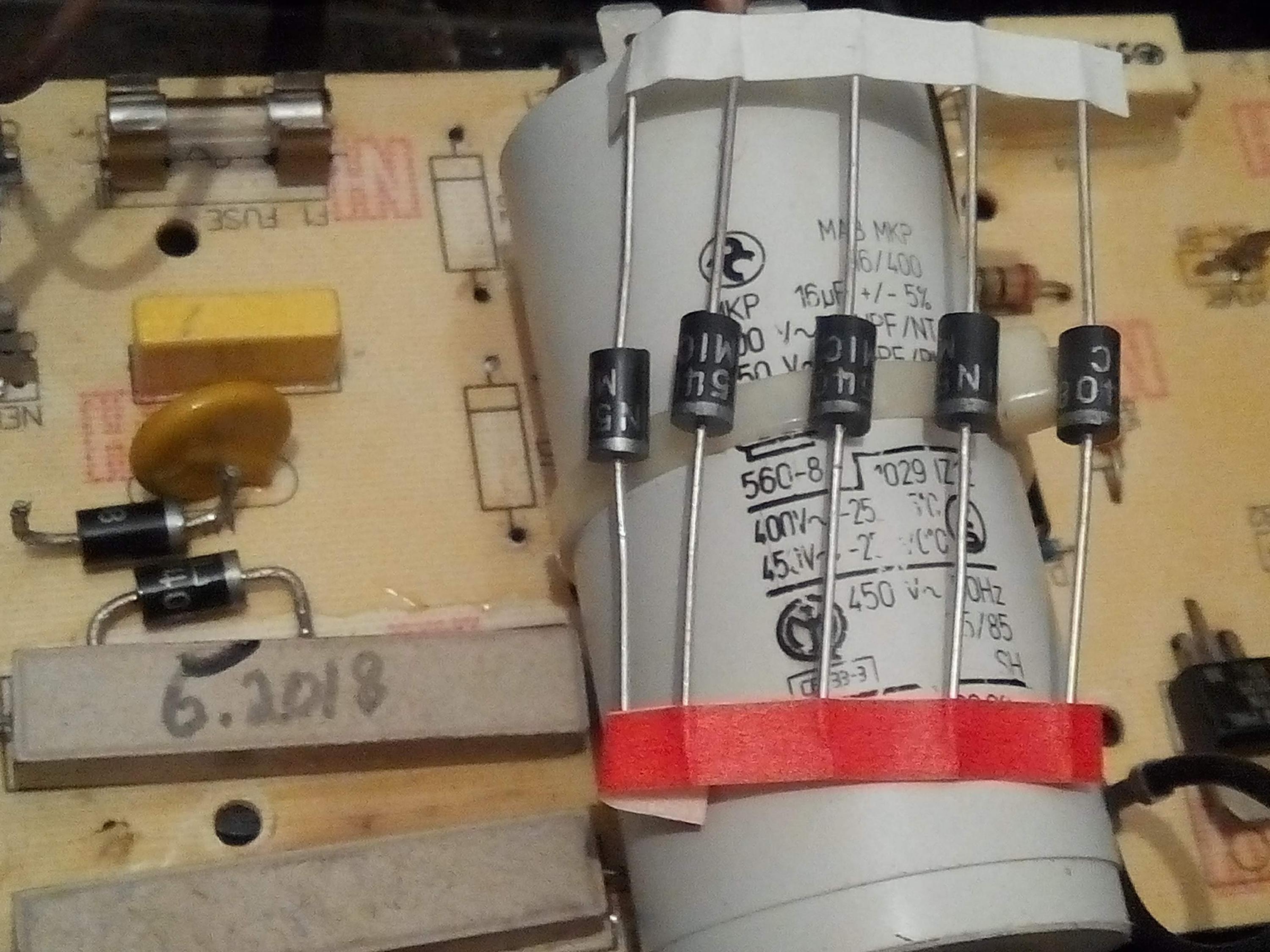

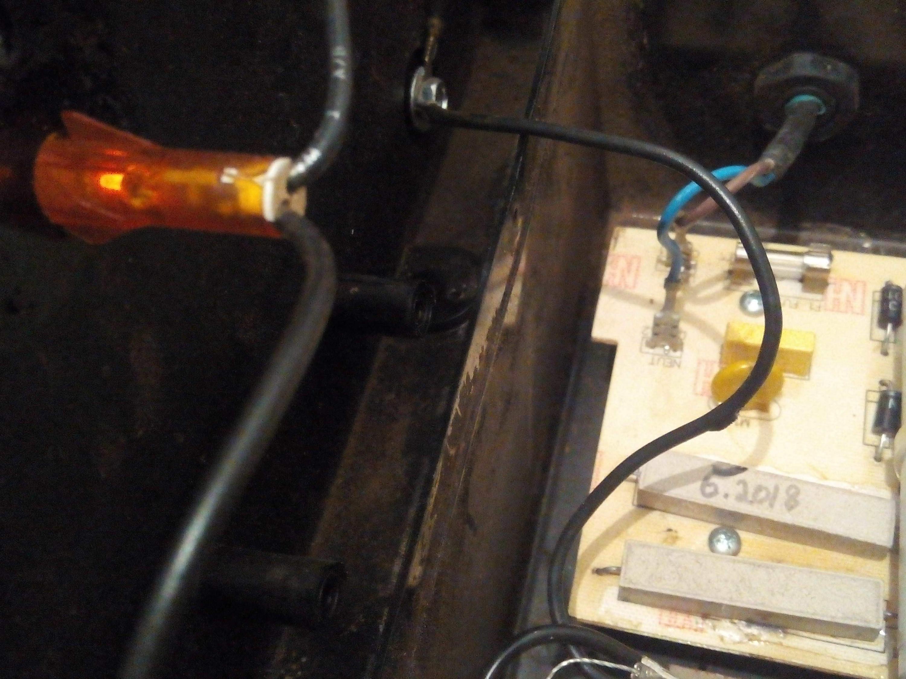

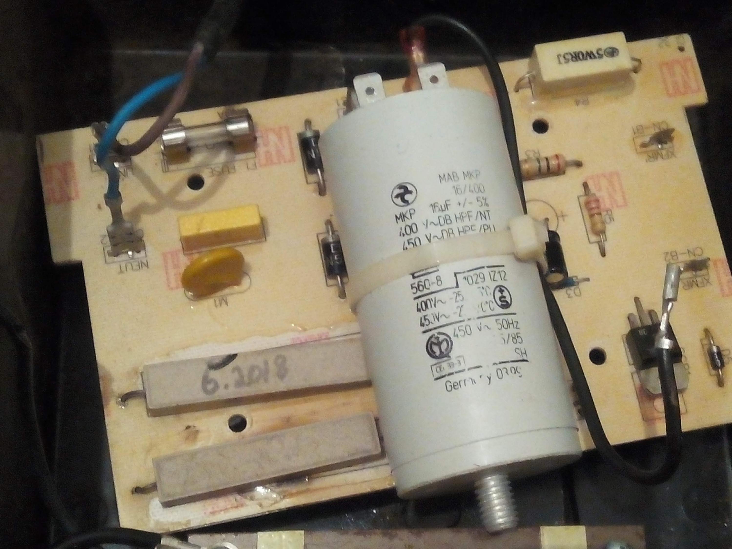

                          See photos of proof the unit is working, you can see the new diodes, new resistors as well as NEON lighting up.
                          Maybe lessons learned, when one resistor burns change the other, and when diode is "weak" change both I'll try to remember that
                          Thanks again.

                                i dont know if its those series diodes ..if its parallel i match the vf . not sure when in series if it matters .. thinking it might do .. be good to know if anyone knows .
                                • eccerr0r
                                  Solder Sloth
                                  • Nov 2012
                                  • 8713
                                  #116
                                  don't need to match if in series, just like LEDs. However if dealing with reverse voltage they may need to be treated like capacitors and deal with the leak caused by the balancing...
                                  • redwire
                                    • Dec 2010
                                    • 3912
                                    #117
                                    The two series-rectifiers are good to 2kV PIV, so I think mains transients damaged that one. With +340V on the big cap, you have -1.6kV left
                                    Lightning, or line switching transients, a reverse-voltage spike can avalanche a diode and kill it. The 2x360R resistance limits any current through them but diodes don't take much avalanche current.
                                    I think an outlet could see 1,500V-2,500V spikes depending on the electrical system and nearby loads etc.
