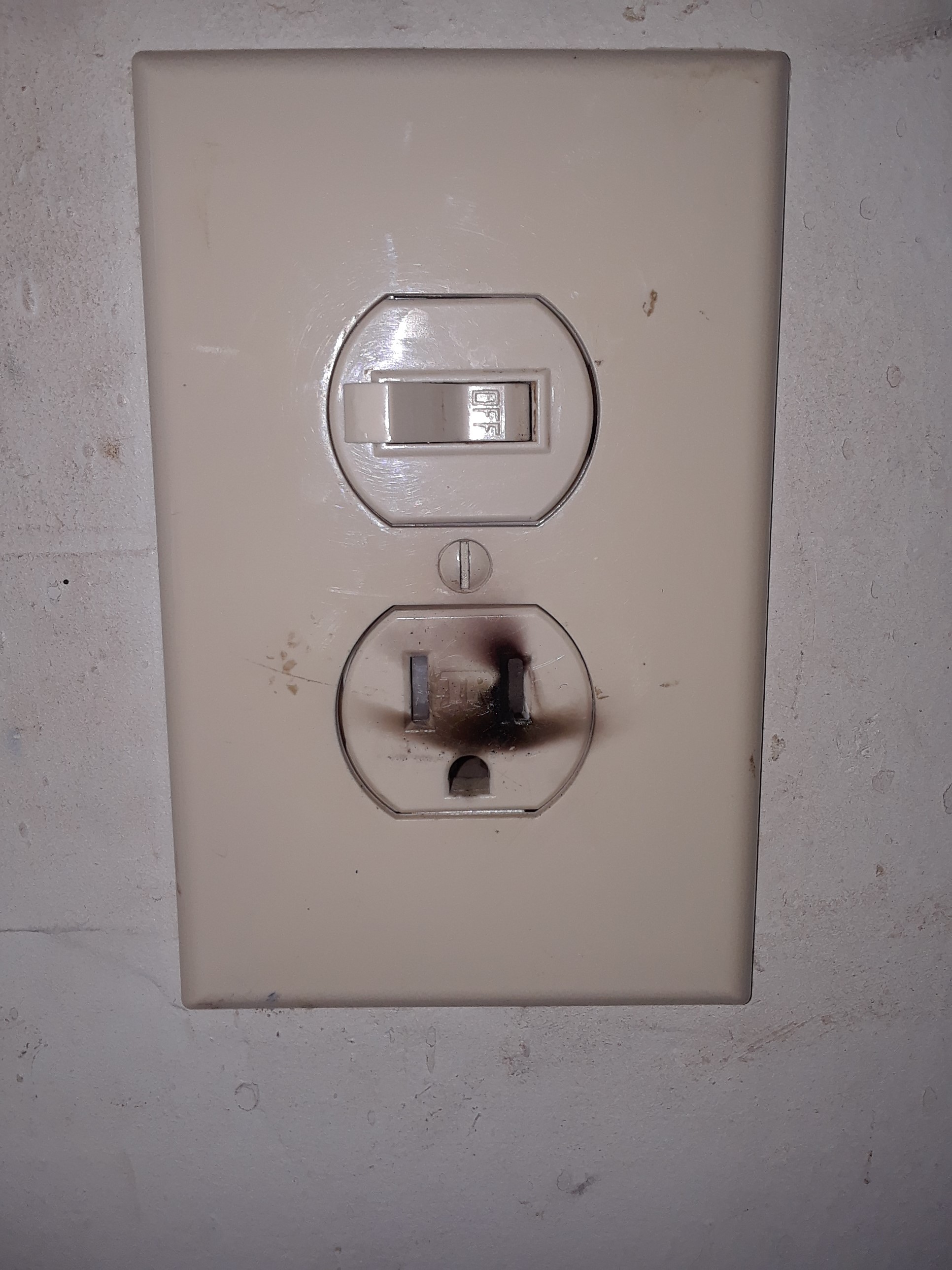

      I carefully reassembled the motor per your diagram, making sure to keep the thermal protection on the black, switched, "L" side of the motor. Plugged it in, turned and turned it on. It ran for about 3 seconds and then this happened:

        That's weird, did it run as energetically as before it zapped the outlet? When it starts spinning it should pass some power back and not fry like that, or was that outlet there in bad shape to begin with?
          Re: Help With Reassembling Basic 110 VAC Motor
          That to me looks like bad contact on the Line side socket of the AC outlet.
          BTW, is it the same out you used when the vacuum stopped working?

              PSA: If you plug in something and it feels "loose" or the plug easily pushes in or pulls out, that outlet is in poor condition - WORN OUT - and should be REPLACED. If you can't replace it, you must derate it significantly - if it's nominally 15A, do not even think about attempt to power 13A, 10A, or even 5A through it, it will overheat and can cause a fire. If it's weak, best to stay below 1 or 2 amps tops, and you'll still be frustrated with it losing contact... REPLACE IT!

                  I've seen a lot of "outlet fire" post-mortems and always wondered how the fire could have happened. A short should have triggered the circuit breaker so that couldn't be it. However if there was effectively a 900 watt heater pointed at the plastic of the outlet and plug... that would explain everything.
                    Yes. At first I thought it was going to "go", and then it died, looked over my shoulder and saw the outlet.
                    It's a brand-new switch/outlet. I replaced it less than a year ago because I wanted an outlet near the door that connects the house to the garage. I haven't tested the outlet yet to see if it's hot or not. I don't think a circuit breaker flipped, but it might have. Have not checked that yet either.

                    I don't know if by "bad contact" you mean the outlet is defective in some way, or something is wrong with the way the motor is wired.
                    No, it's not the same outlet I used when the vacuum quit working.

                      The wiring in this house is completely f*****. Before we moved in, there was a house fire and this is the area of the house that burned. Afterwards, some kind of professional "flipping" company did the repairs and they did horrible terrible things with everything, such as painting over charred wood, and other things with the wiring too terrible to even mention. So defective wiring is on the list for possible suspects in every outlet in the entire house.

                          Looks like the plug is the issue, not the socket...

                            There are ONLY two wires connected to the switch so it cannot be wired wrong. The whole connections of the motor and switch are in series.
                            You have bad contact problem between your AC plug and the outlet.

                              The outlet tests good with a standard household light bulb plugged in (a home-made "trouble light". It's also brand-new. I've used a household vacuum cleaner in that outlet within the week. It's one of the most-used outlets in the whole house. I converted a simple switch (for the lights in the garage) to a switch + outlet because an outlet in that location was necessary for lots and lots of things, and I've been using it for lots of things since I installed it.

                                    You mention "It's one of the most-used outlets in the whole house" which would imply it could take a lot of wear. The outlets, depending on how it's designed, is usually the wear point. Granted higher quality outlets would not wear out as fast but it's hard to tell the quality by looking at the outside. And even if it gives a tight fit when plugging and unplugging, it may not be the metal contacts that are providing the needed friction to allow a strong, low resistance connection.

                                      budm in post #33 is right. Lose or worn out plugs and or outlets usually do not show the results of such damage with low current devices plugged in. It take high current things like air conditioners, microwave ovens, space heaters and vacuume cleaners to see the effects of worn contacts. what current rating is the breaker? It should be a 20 amp. When you plug in vacuume cleaners do the lights dim?
                                      Put one probe of your ohm meter on one prong and the probe on the other prong. With the vacuum switch in the ON position you should see a LOW ohm reading ( it will vary in numbers because of the carbon brushes ).
                                      Do the same above but with the vacuum switch in the OFF position. You should see an open circuit reading.

                                        Usually wet/dry shop vacs use a 3-wire cord, and that outlet looks like a standard NEMA 5-15 - which is usually paired with a 15-amp fuse or breaker.
                                        Looking at the photo closer, oh nice, it's an even "newer" tamper resistant outlet ... not sure about the design tradeoffs they made to make these tamper resistant outlets...

                                          Another thing that could cause the outlet to fry is if you had the shop vac switch turned on before you inserted the power cord into the live outlet. instant sparks or fire.
