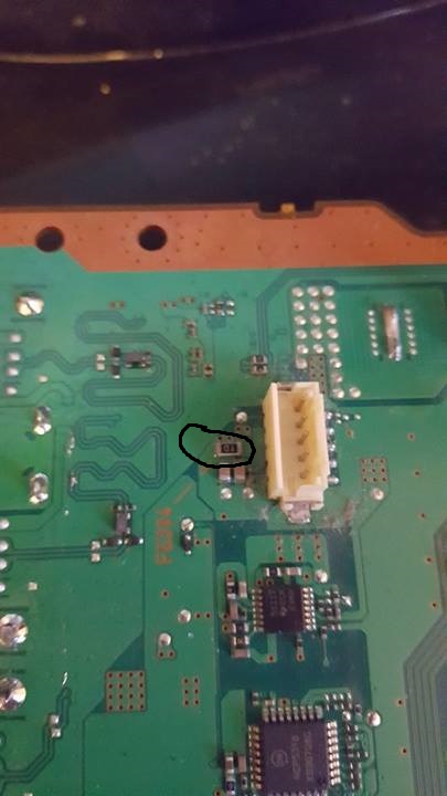

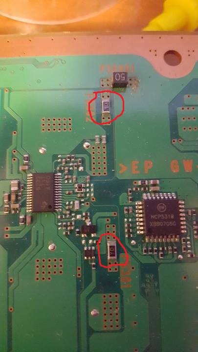

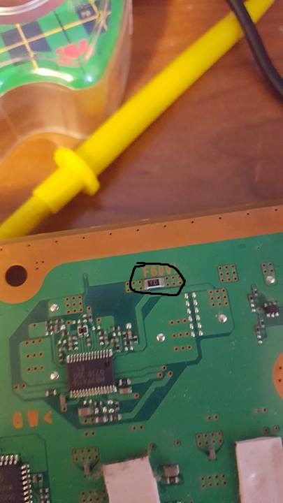

                              Re: PS3 CECHE01 3 Red beeps when plugged in
                              I managed to find what i think are all of the fuses and circled them using my magnificent paint skills XD. I've attached photos of what I found. my question is, how do I measure these fuses. I've seen normal fuses that have clear legs for positive and negative output, but these are so small I don't know how to measure them or replace them for that matter.
                                master hoarder
                                • May 2008
                                • 12175
                                • Bulgaria
                                Yes, those are the fuses I was talking about.
                                Fuses do NOT have a positive (+) or negative (-) leg. Current simply comes in from one side and exits the other. But we don't care about that. All we care is that the fuse is not open-circuit or high-resistance.
                                Therefore, you measure a fuse using a multimeter set to the lowest resistance scale (typically 200 Ohms for manual-ranging MMs). You should get no more than 1-3 Ohms, or whatever is the lowest resistance your multimeter can show (some of the extremely cheap multimeters may have crappy probes and wires, so they may show as much as 3 Ohms even with the probes shorted to each other - i.e. the lowest resistance the multimeter can measure).
                                Also, very important when you measure fuses: make sure the power to the system is turned off and the power supply is disconnected from the wall.
                                Finally, if it comes to removing these SMD fuses, you can use a regular 60 Watt soldering iron with a chisel tip (if you can't get one with a chisel tip, then get one with a conical tip that is made of copper - that way you can sand it down to a chisel, bevel, or spoon-shape for SMD work.) And flux (rosin or RMA will do, doesn't matter if liquid or gel.)
                                COK-002 is the board number I believe.
                                Okay, I will have to look though the retired computers in my closet as I can't find it on my main PC here. I'll try to get that done before this weekend.
