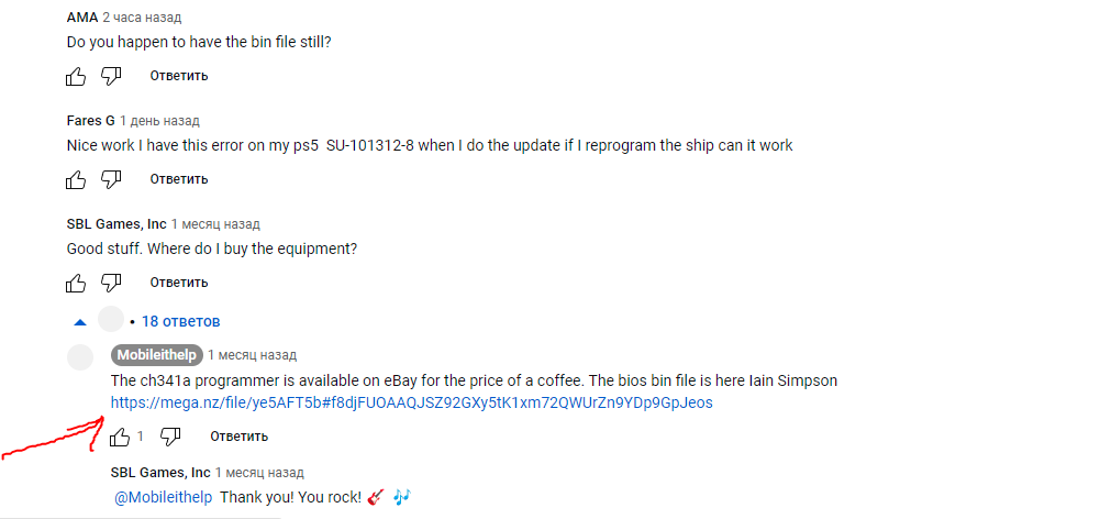

          • lotas
            • Jan 2016
            • 4536
            • Russia
            Re: Ps5 three beeps when plugged in, no life
            Originally posted by Xwalt
            How did you get the bios file? mind sharing it?
            There is a link to the firmware in the comments.
            • Vila_666
              • Sep 2023
              • EspaΓ±a
              Anyone has the files?
              Comment link is down.
