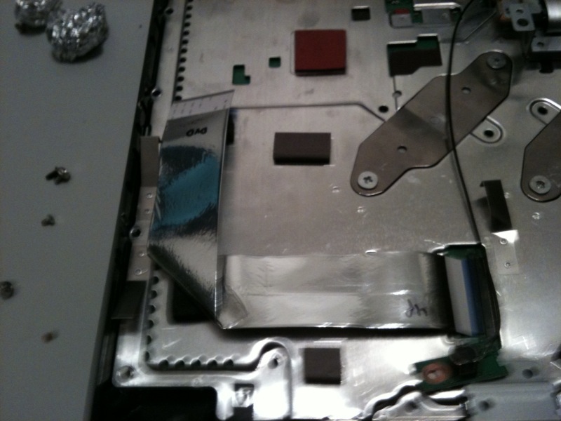

    By the way, can you post a picture of the blue-ray ribbon connector on the main board? I just did a PS3 reflow last month, but was unsuccessful. I suspect the "tech" who reflowed it before me screwed up something, including the blue-ray connector (which looked damaged), but I'd like to confirm this. Thanks.

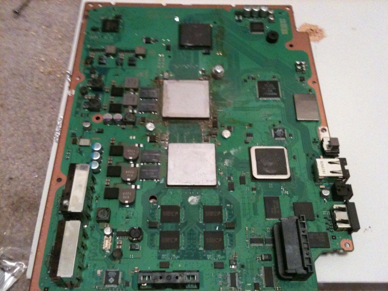

          Here are some pictures. The first picture is of the bluray cable and the next is the aftermath of the heatgun. I bought some liquid solder flux from microcenter... but it looks messy as hell... I'm hoping I got the right type. I blasted the gpu at around 220 and 240 C for 10 minutes. I noticed the board was kinda warping so I used some bolts and washers to try to keep it in palace. This is the 3rd time I've done this. The other two unsuccessful attempts I blasted it for around 5 minutes. If this doesn't work I'm probably going to sell it for parts.

            still not working..... bla.....

              Wow, yours too? I reflowed mine twice, but nothing changed for me as well (was still getting YLOD).
              Are you at least still getting the same problem or is your PS3 totally dead now? Or do you have the Yellow Light of Death (YLOD)?
              390C is too much. I always went with 210C over 7 minutes when i was using the oven.
              I'm not sure if 210C will be enough since the PS3 uses lead-free solder as far as I know.
              I think Micro Center only had one type. Got mine from there as well. It was the $10, 100ml one from MG Chemicals. Came in a black bottle. If you have the same one, it should be right.
              Doubt the warping was caused from the heat because I reflowed mine twice, with the second time at over 400C. No warping or damage to the board whatsoever. Did you pre-heat your board? If not, peraps this could have cause the issue.
