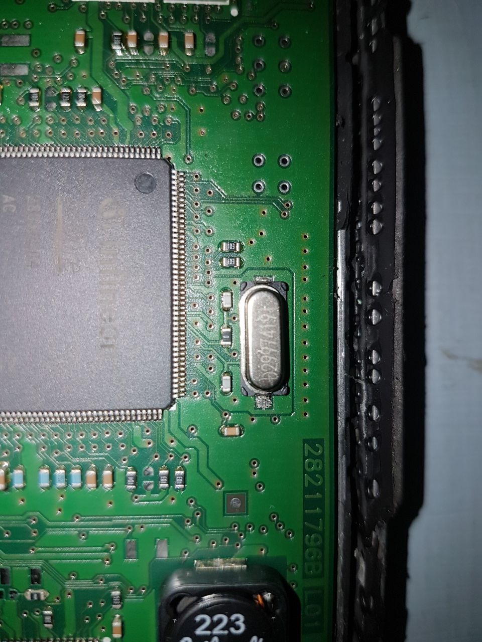

      Re: Delphi MT60 Car ECU Revisit - No activity on CPU
      Must have got them confused then, my bad. Not too versed in that area. Here's a pic.

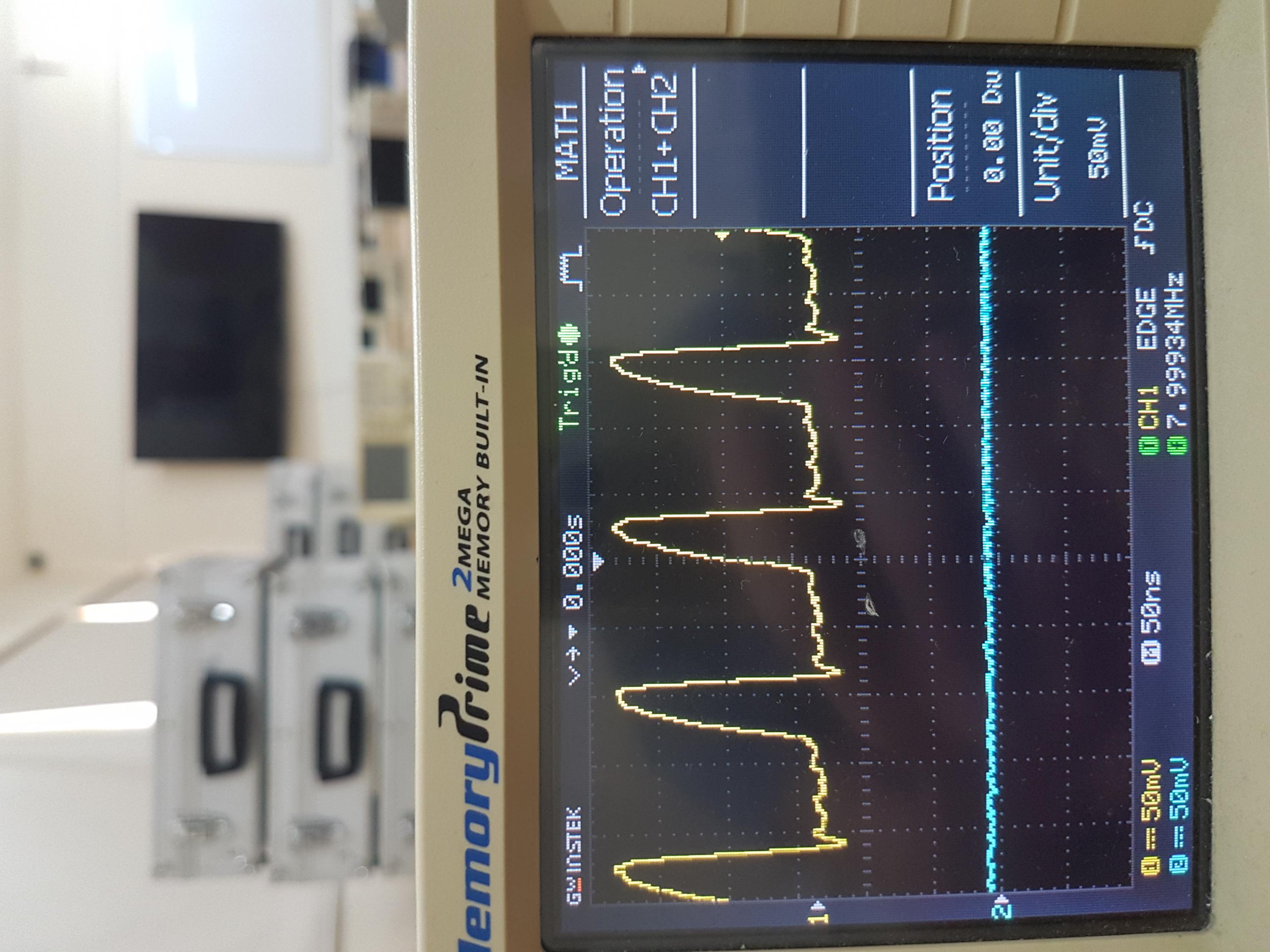

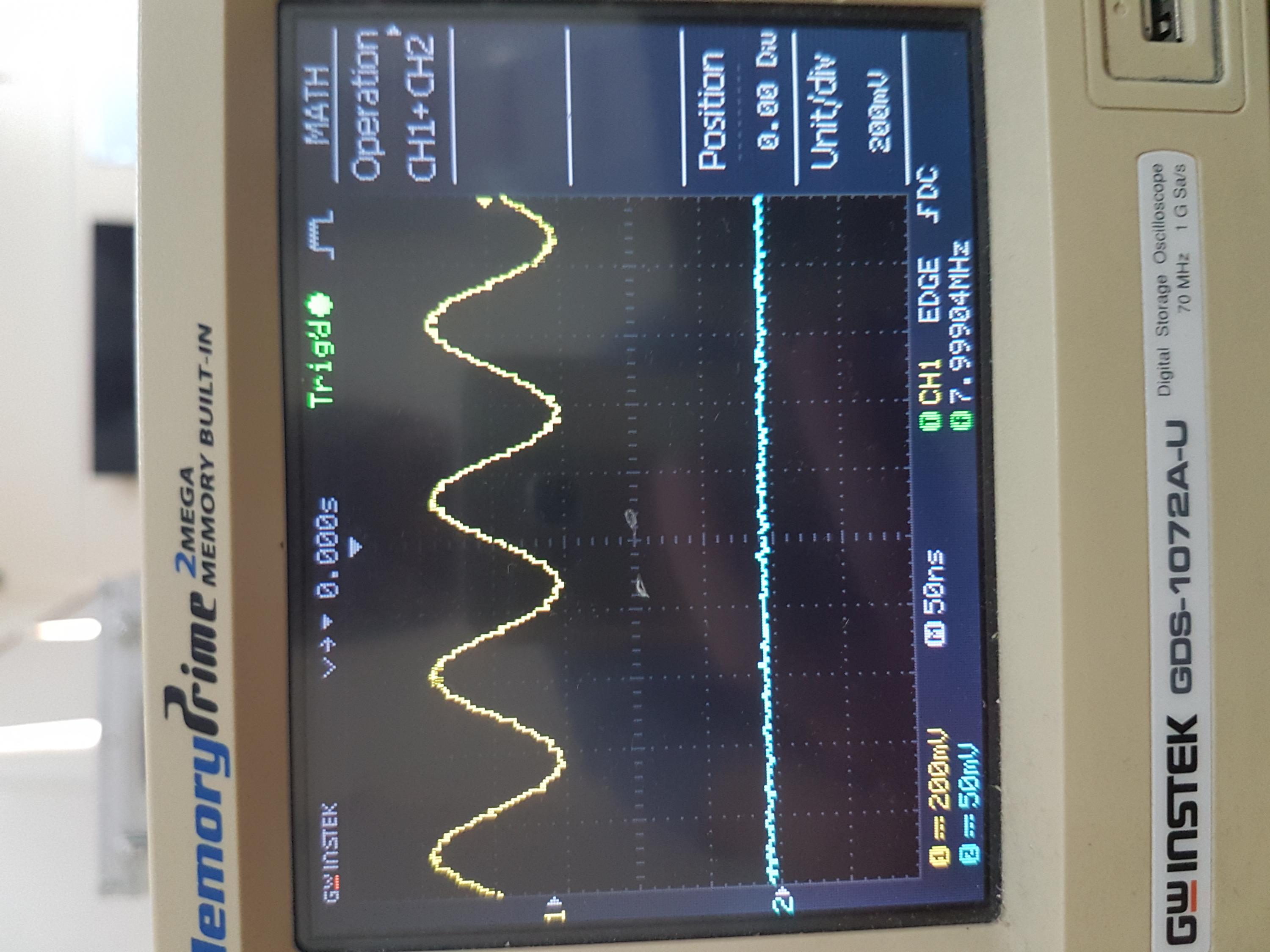

        I tried probing around with a logic analyzer and I saw a waveform on the crystal. I don't think my sampling rate is high enough, logic analyser goes up to 16MS/sec, and I can just about see the square wave. It looks strange but I believe that's due to sampling rate issues. I'm not confident about the frequency but most probably 8MHZ crystal. still don't really see any activity on the CPU however.
        What would be a good way to tell If CPU is alive, preferably not using a scope. I saw some people trying to read the ECU by performing some mod on the tricore CPU:
        http://blog.vvdishop.com/use-vvdi-pr...-with-tricore/
        Could I maybe use this to check if the tricore alone is alive?

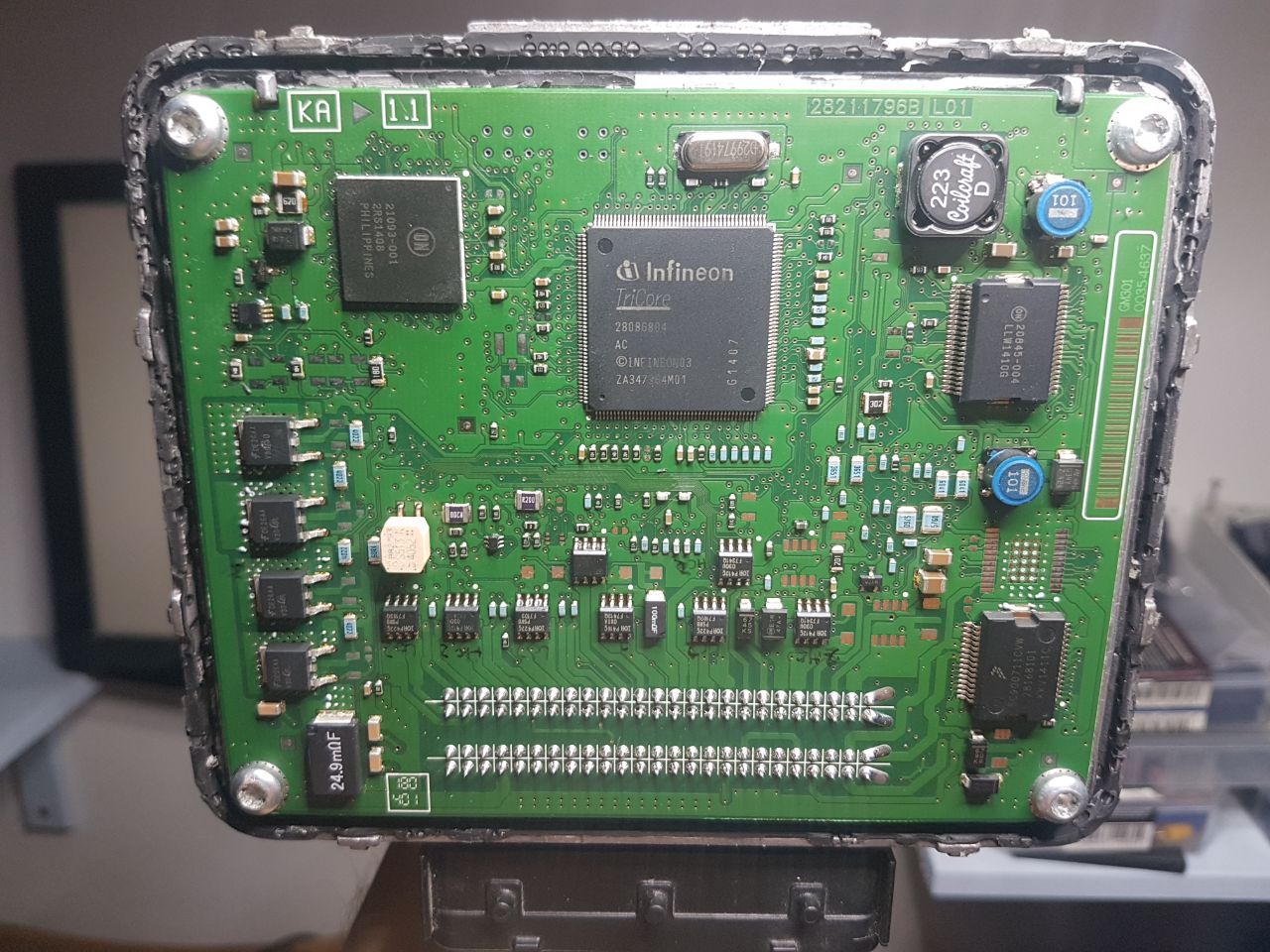

            Alright, I've included a picture as well as all the information I know about this ECU currently, If there is a supervisor IC then I believe that must be the 20845-004 Onsemi IC located on the top right of the picture, wether it has capabilities apart from voltage regulation I cannot say, no datasheet exists for it from what I can find. It seems to be working ok? from what I can tell, 5v, 3v3, 1.2v are present when probing the IC which are probably all the rails needed for functionality. (Again no datasheet, can't tell for sure)
            the top right large black coil has 12v on both sides, I'm unsure as to why a coil is present usually those are used for buck/boost circuits so I'd expect something other than my input voltage. but the 12v on the coil seems to be the same as the one from my bench input. the top blue inductor has 5.8v and the bottom blue inductor has 4v which seems a little strange, those are not standard voltages. both are smps and the 20845-004 is what's driving them.
            on the bottom right is a SC900711CVW idle driver IC, I'm unsure how to test this (no datasheet) but I wouldn't expect it to kill the whole system if it malfunctioned so I didn't focus on it.
            the infineon CPU in the middle I believe is getting clock, although I can't be 100% sure due to my scope not having fast enough sampling rate. But I think the crystal is most likely 8MHZ. Again I'm unsure how to confirm that it's working ok.
            top left is a "gate array IC" by Onsemi part number 21093-001, I found an old blog that described a succeful repair having the same symptoms as my ECU involving a reball of this IC, I did successfully reflow it but still nothing. If I exhaust all options I might consider attempting a reball.
            The top 3 Ic's all get somewhat warm during operation. (see thermal image), the CPU and gate array IC getting hottest while the voltage regulator IC get's barely warm. the Idle speed IC has no temperature change. I've tested all other discrete components on the board as best as I could and found no damage or faults.
            I'm unsure how to proceed at this point without any sort of datasheets but I'm pretty sure the fault lies on one of the 3 IC's up top, how can I test these IC's? Might have bit off more than I could chew with this one

            • CapLeaker
              Leaking Member
              • Dec 2014
              • 8352
              Since it isn’t communicating, maybe the cpu and everything is fine and the problem is the CAN bus on the ECU?

                    • 31289
                    to check a crystal you need a frequency counter with a high impedence low capacitance input or a scope and a x10 or x100 probe.
                    a mutimeter with a 10meg input usually works too - but most meter other than the UT-61e dont go very high.
                    the explanation is simple - if your probe has a capacitance of more than a few pF it will effect or even stop the crystal!
                      Yep, I don't have any of those unfortunately. Explains why I can't get a proper reading.
                      Thanks for the info!

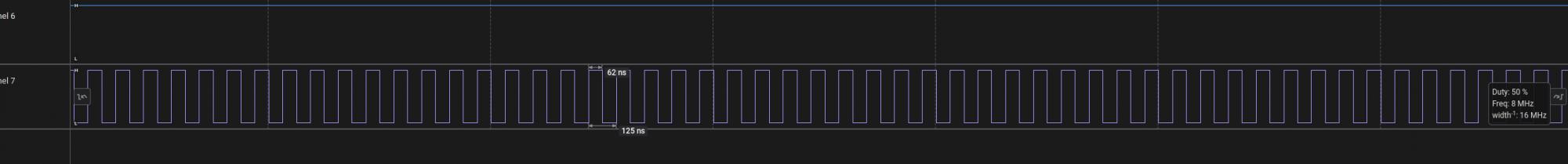

                            Yes I did that, terminated the bus too with a 120ohm resistor. Both lines showed no activity on scope remaining at a constant 2.5v, the second terminating resistor is located somewhere on the ECU but not on the gate array IC as the 120ohm resistance was still there after pulling the chip. The chip was responsible for signal generation however as with it removed no 2.5v is present now. From what it looks like to me, either a bad gate array or bad CPU and swapping CPU is not a realistic option as it requires flashing new firmware with tools I don't have.
                              The 2.5v comes from the divider network and means that it isn’t connected to anything.
                              Shit like that happens when the battery is totally flat and someone jump starts the car.
                              I’ve got a ECU from an 18 wheeler, in which the owner jump started the truck on totally flat and to make things worse, he also had the polarity reversed.
                              I gave up on the board, because after taking a dozen bad IC’s off, others were still shorted. Worst ECU I have ever gotten in.

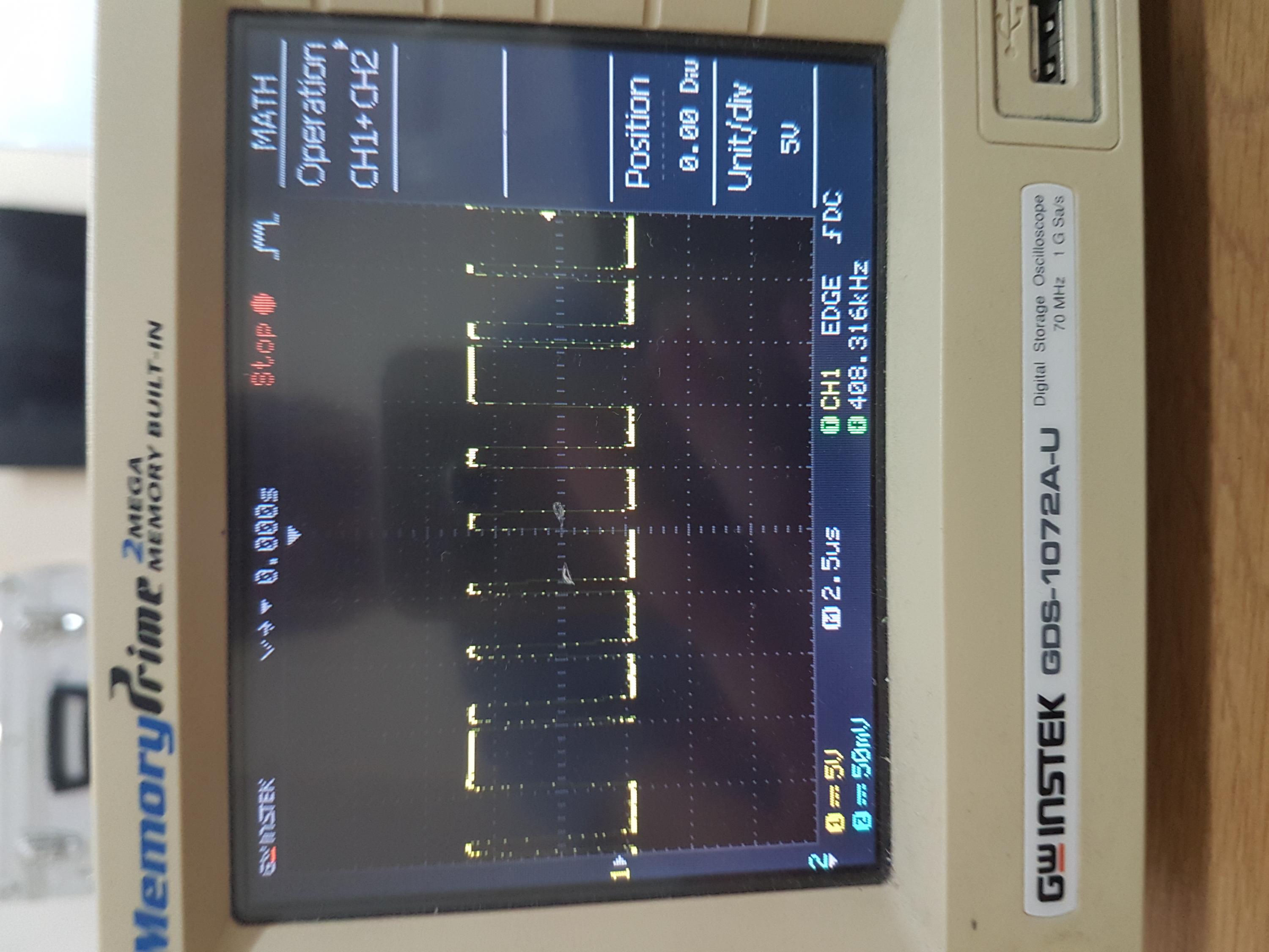

                                      Update:
                                      Got the new gate array and replaced it successfully, unfortunately nothing seems to have changed however I haven't tried it in the car yet. I did however get my hands on a decent scope so I checked both the crystal and SMPS. Crystal seems to be oscillating good at 8MHZ on one pin however the waveform has a lesser amplitude and looks distorted on the other pin, I'm not sure if this is normal (see pics)

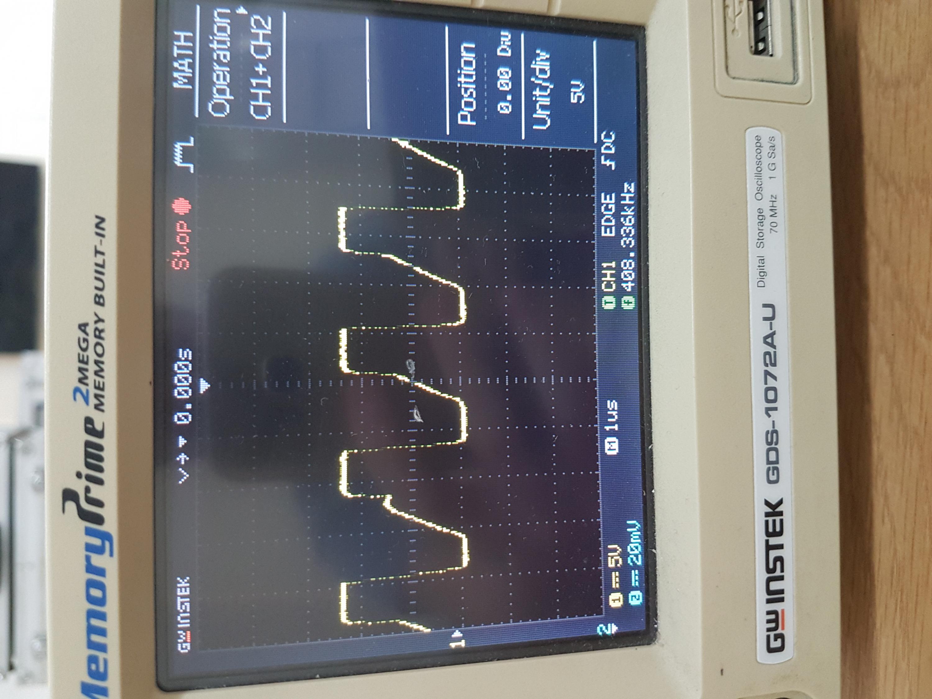

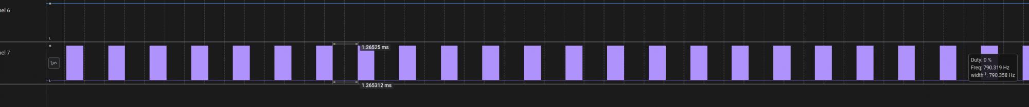

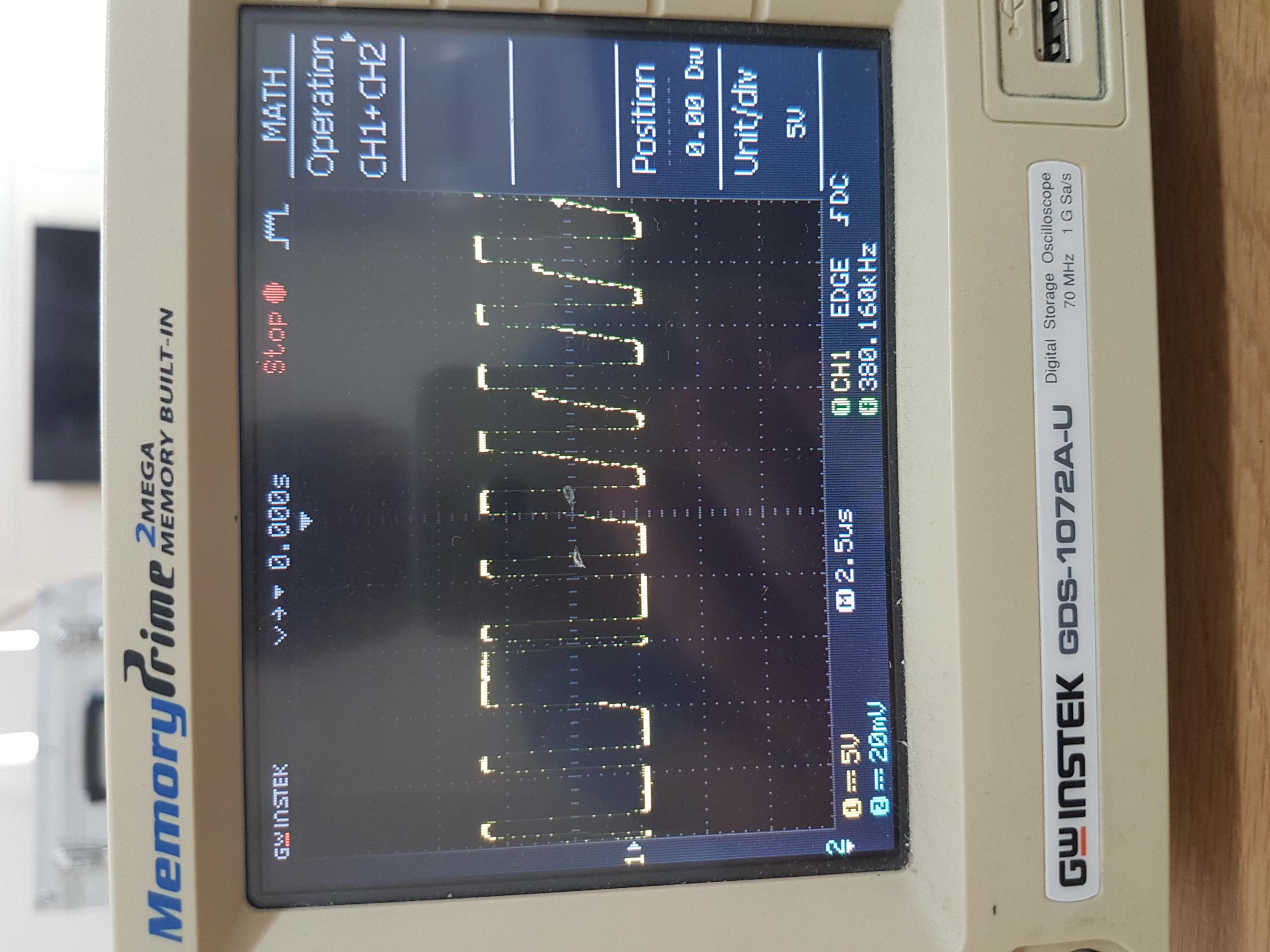

                                      I checked the 2 coils driven by the power IC to see if they are switching correctly. They operate at around 400KHZ and the 4v rail looks ok however it is switching duty cycle very rapidly which is a little strange, the 5v rail has a strange slope near the rising edge of the square wave, to me this is not normal.
                                      Any ideas? Thanks!
                                        • 31289
                                        the crystal is normal,
                                        i dont understand exactly how they work but the drive circuit usually has some kind of drive-feedback between the pins so it's almost driving itself!
                                        the switching psu frequency/duty cycle is another curse of modern design, the control chips like to shift stuff around to avoid being detected causing rfi.
