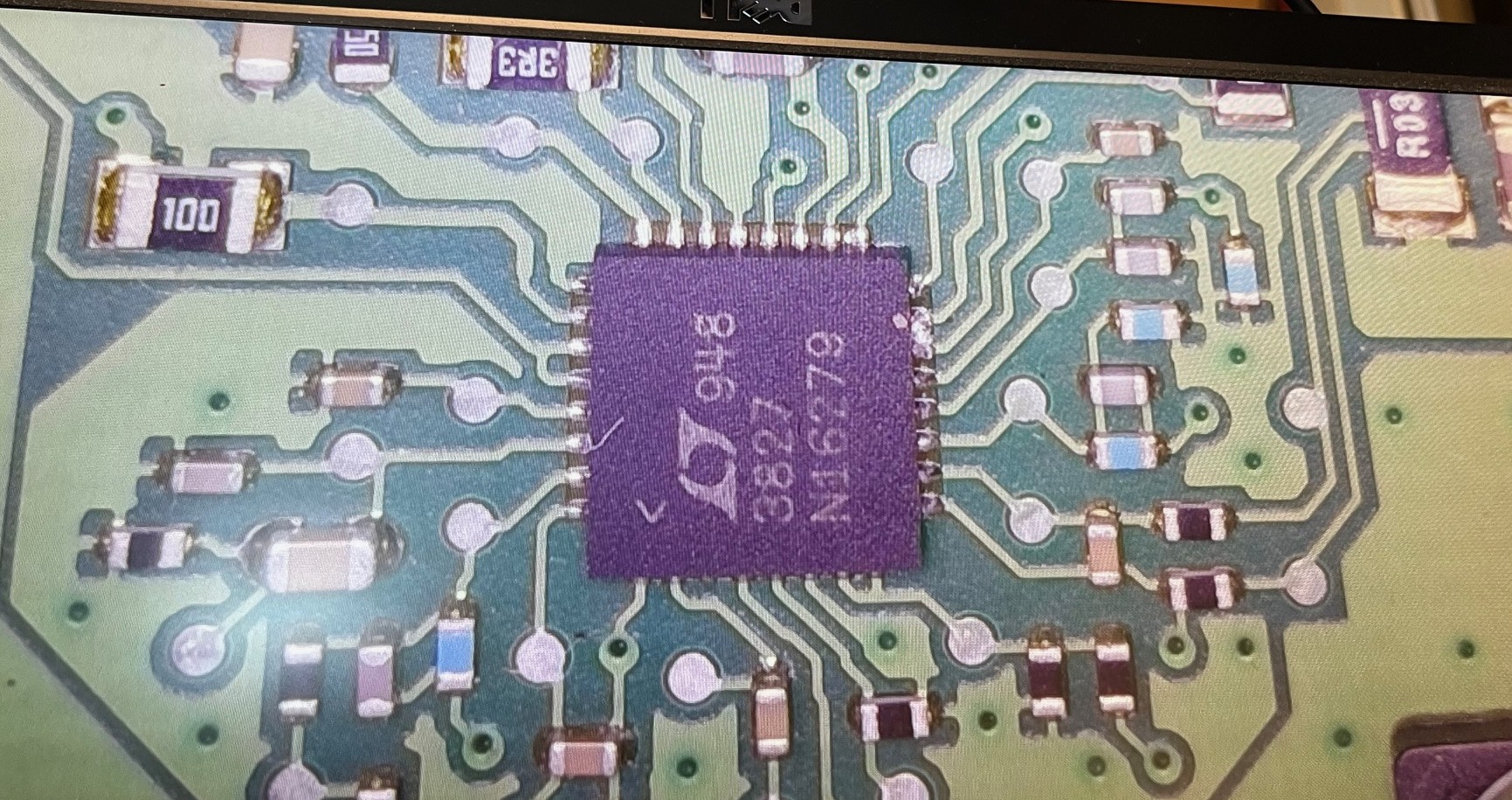

    Delphi 28242585 radio power supply section
    Trying to identify what the chip in the photo is. It is a component in the power supply section of a Delphi radio model 28242585 which is in a Volskwagen Jetta. Pin 1 is measuring 198 ohms to ground so I think I might have to change it.
    Does anyone know what this is ?
    Thank you!
  • R_J
    • Jun 2012
    • 9535
    Re: Delphi 28242585 radio power supply section
    Ltc3827
    • rddube
      Aspiring Expert
      • Jun 2013
      • 940
      Thank you R_J! Is it my understanding that pin 1 is where you have the < sign ?
      • petehall347
        • Jan 2015
        • 4426
        • United Kingdom
        looks like that side to me going off what is connected to pgnd .
          • 31020
          the picture looks like you have solder balls between some of the "pins"

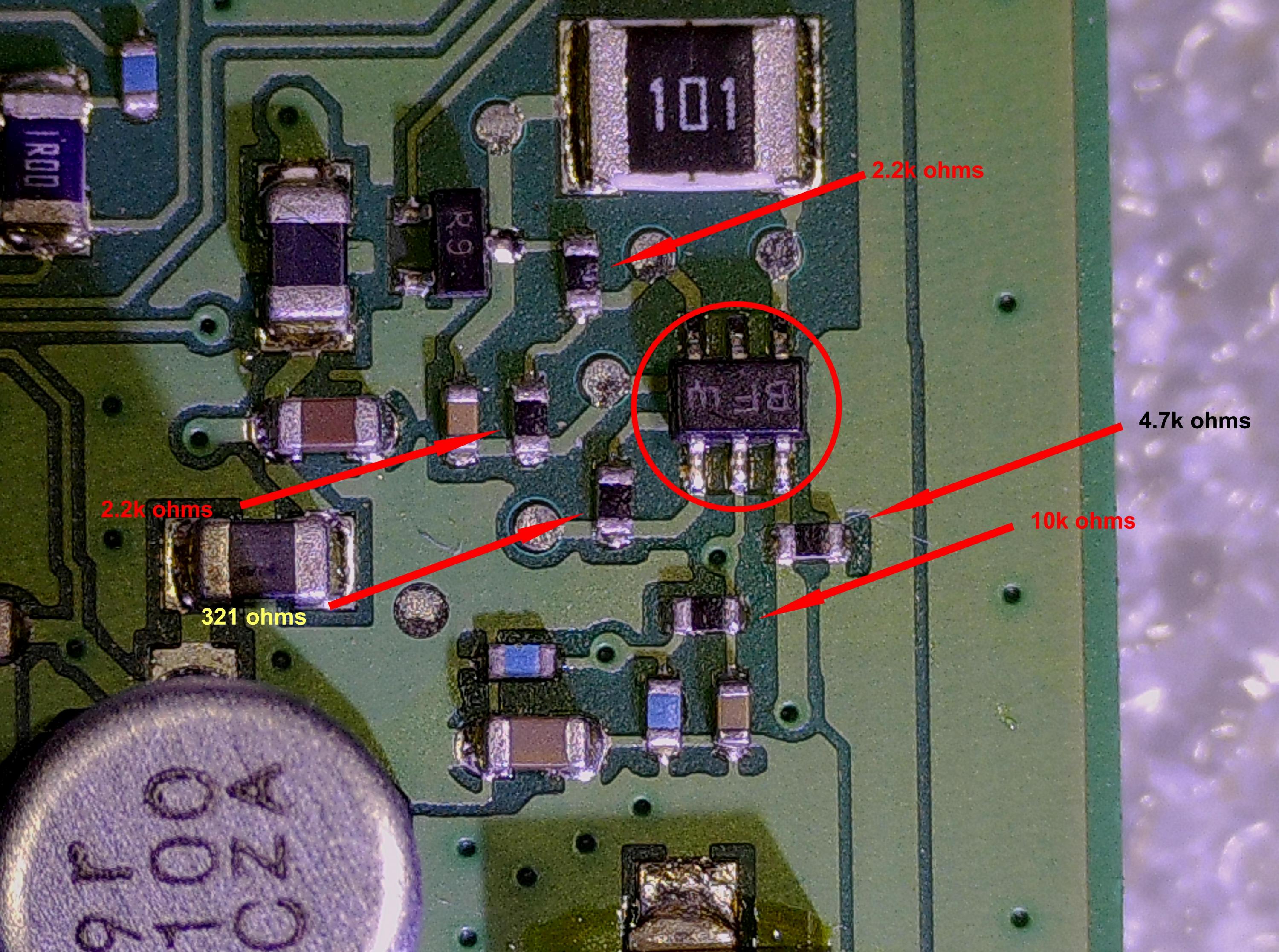

          • rddube
            Aspiring Expert
            • Jun 2013
            • 940
            Hi STJ, no it's just a reflection, checked it out and it is fine.
            I think I might have found where my problem is in the same power supply. Attached is a photo that I am trying to identify the component circled in red. If you look at the resistors around it, they are all giving me in the k ohms readings, while one of them is giving me 321 ohms, which is the reading I am getting from positive to ground on this power rail.
            Any idea what that component in the circle could be and is that resistor value good, or has it semi-shorted?
            Many thanks!!
              • 31020
              R5421N136C lithium ion protection ic
              ?? do you have a lithium cell in there to back the memory up?
              • rddube
                Aspiring Expert
                • Jun 2013
                • 940
                Not that I can see, and I have another 3 other of the same IC and 2 of them don't use that pin where the 321 ohm resistor is but the other one does and it is again a 321 ohm resistor.
                Could they be using this for another type of application, this is a car radio?
                  • 31020
                  probably just another company using the same code - it's a common problem
