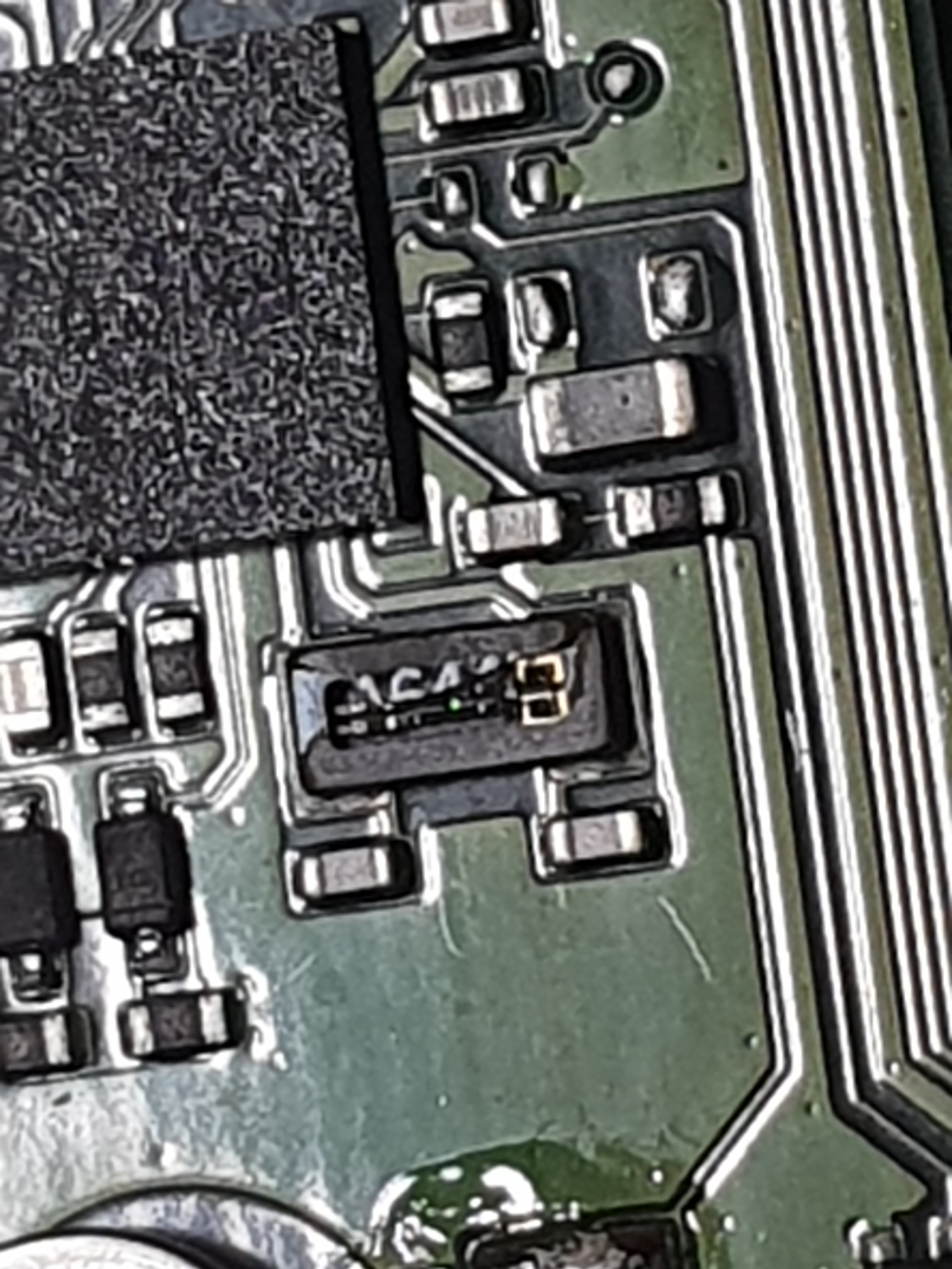

    Hello, I have a Fujifilm hybrid camera with an issue : the time don't run. I set 12:00 and 3 min later, the same : 12:00
    I saw an obvious root cause : a broken quartz (resonator). But with the box broken, I can't read the marking code. Probably : 464… or A64…

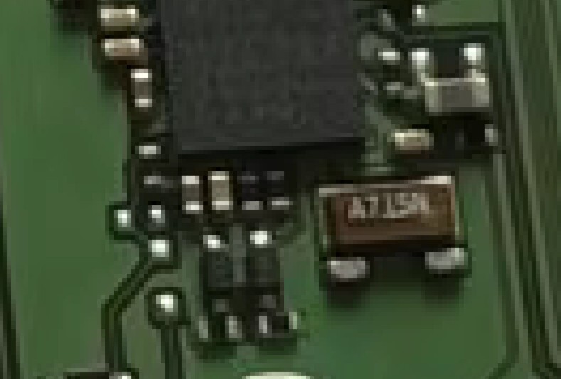

    I found on the web a picture of the same camera board but with marking code very different. Probably : A7…5N
    I'm searching another one for compare…
    Do you have an idea or another way for find the frequency of this resonator please ?

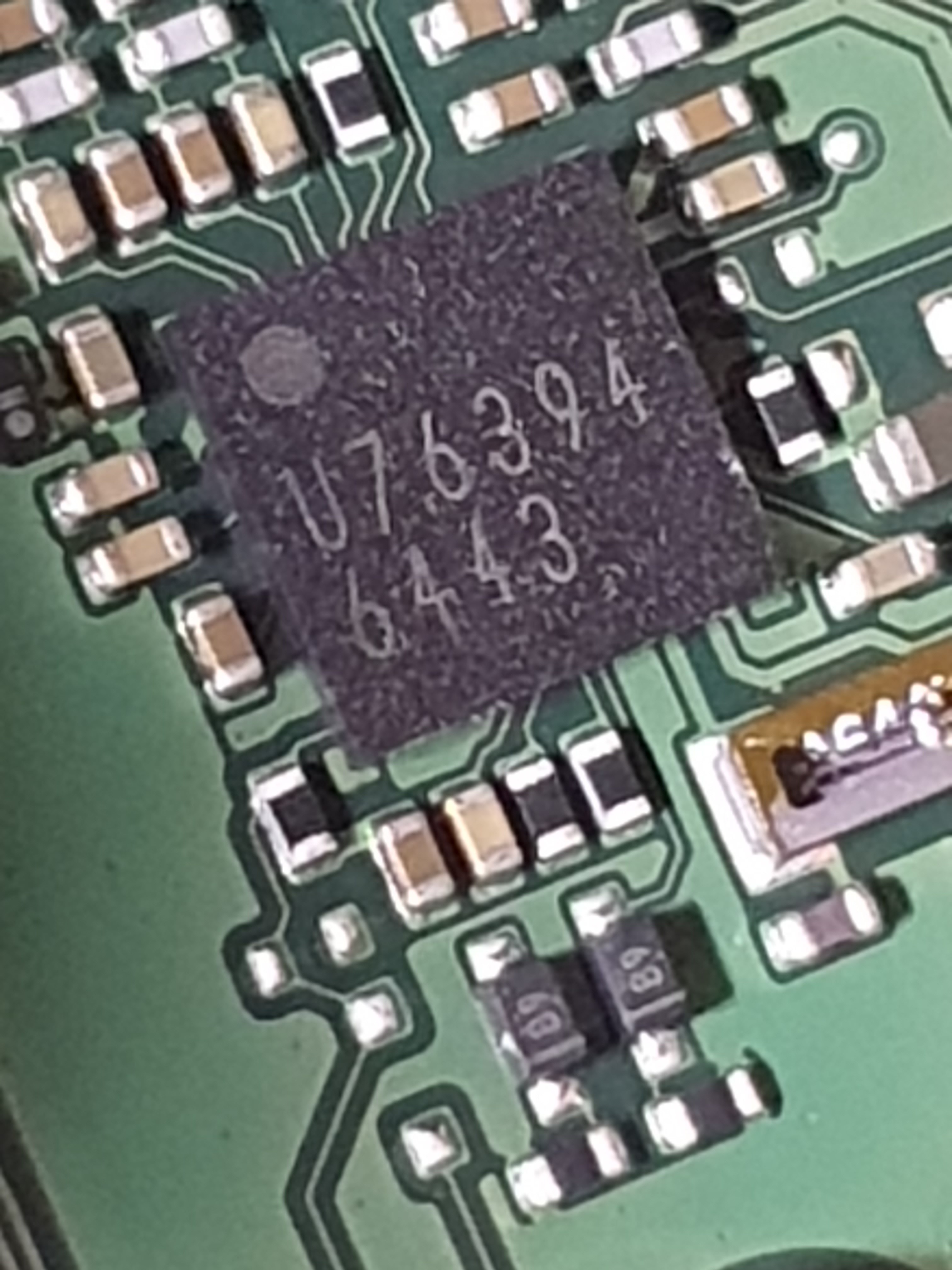

    (I did not found the manufacturer of this component ? And I did not found the chip).

    It's probably a Seiko-Epson 32.768 kHz crystal.
    https://www.google.com/search?q=32.768khz+fc-135&udm=2&sclient=img
    https://www.yangxing.hk/u_file/photo/20200107/FC-135-Datasheet.pdf

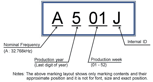

      Yes, you found it, exactly this one.
      And now I saw why marking codes are so differents : only the first letter « A » is usefull.
      Thanks you
