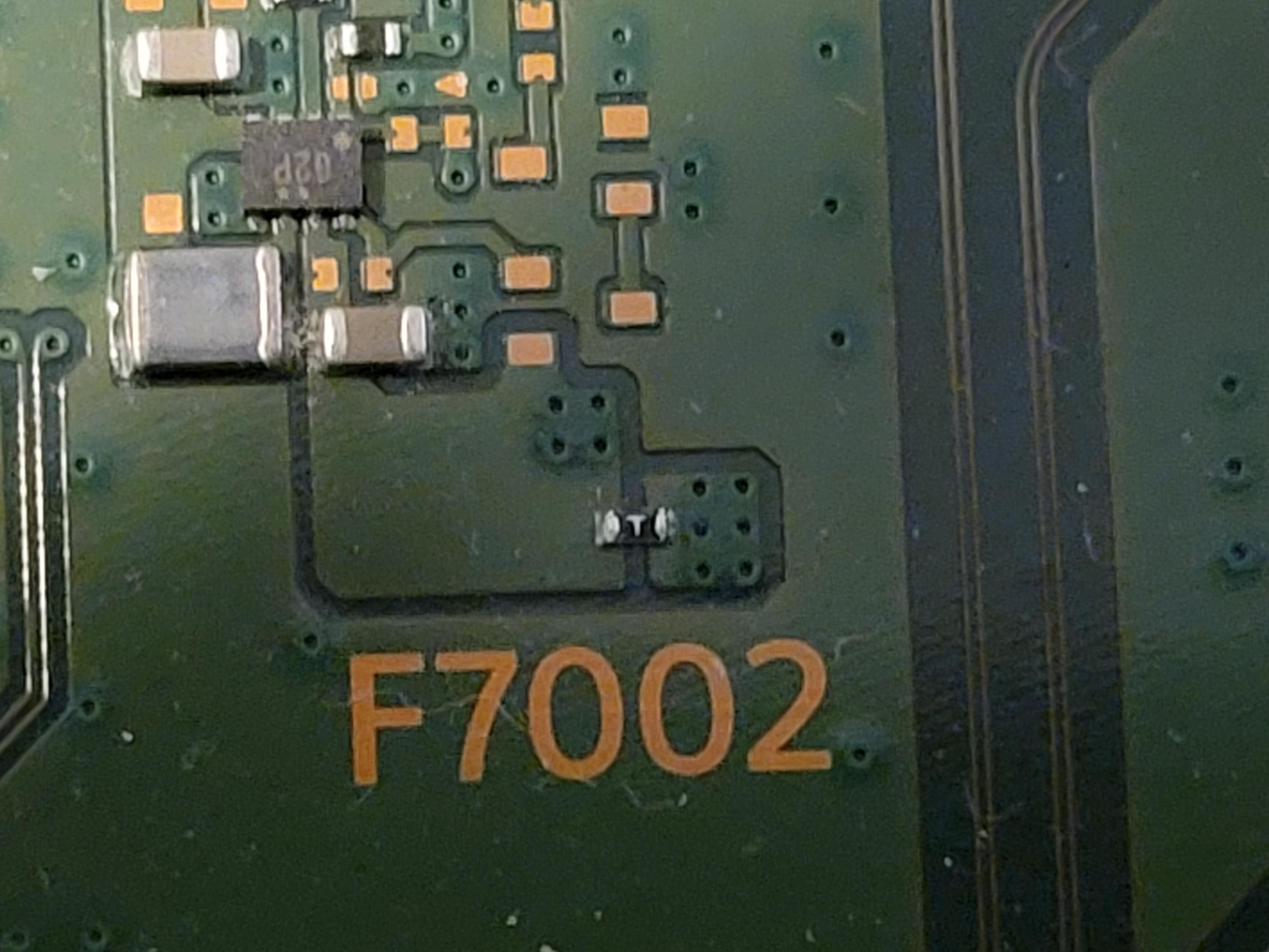

    Originally posted by TheWizard
    Fuse is a 0603 Timed(slow blow) 3 a 6v. I can find fuses but not 0603 3 amp with 6v. All the voltages i am finding are much higher
    Are you sure it's 3A, it looks like it's 2A to me.

          #84
          Re: PS5 BLOD- CFI-1115A Disc Version- Board= EDM-020
          Not completely positive. Just what i was informed. But here is the fuse I am looking for. Ideas? https://kasynparts.com/product/ps5-b...e-replacement/
          It looks like a round dot in this post. https://www.badcaps.net/forum/showpo...7&postcount=72

            #85
            Exactly "stj".
            Diif, Sorry was a horrible picture after the downsize for upload. I snapped a new one. Here you go. "T"

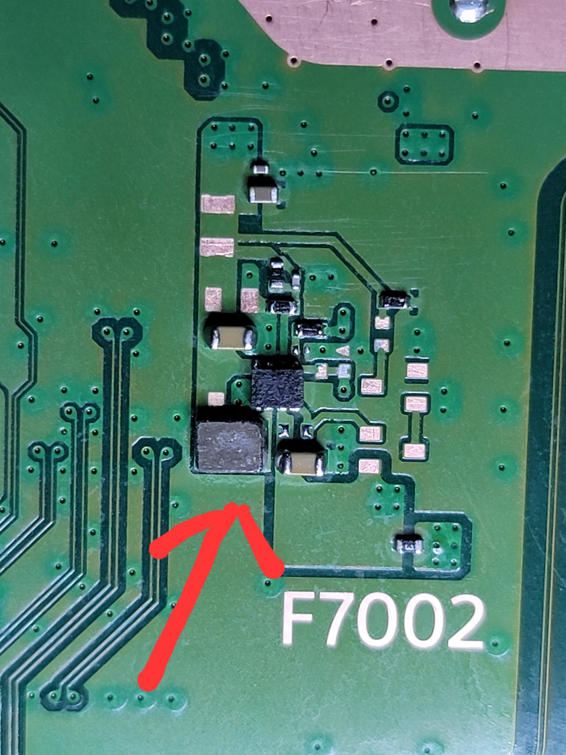

                              • TheWizard
                                • Feb 2015
                                • 190
                                #95
                                Originally posted by stj
                                well 0402 is a lot smaller than 0603, so get the correct size or soldering it in wont be easy
                                Ordered the replacement for the A2 chip along with fuses. Went with 0402 3a 24v. That was the lowest i could find. Pretty sure its just the chip and the fuse most lilely blew from when i injected voltage.

                                    #97
                                    Any idea what the value is of this power inductor?
                                      • 31256
                                      #98
                                      maybe if you check the size in mm and then look at inductors at digikey you can get an idea

                                        #99
                                        Yeah was going down that road. Playing the reference game. Haven't measured the part yet. Will keep you posted.
