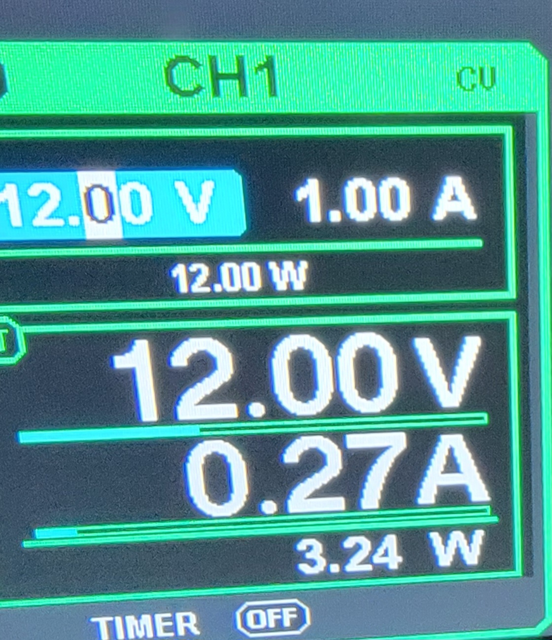

    Update: New BIOS chip programmed with known good BIOS BIN. Same issue. 0.01 current draw. I have purchased a PSN banned board off of ebay. Going to compare voltages , verify. This may be the APU or Southbridge. Not sure. More investigaing needed.

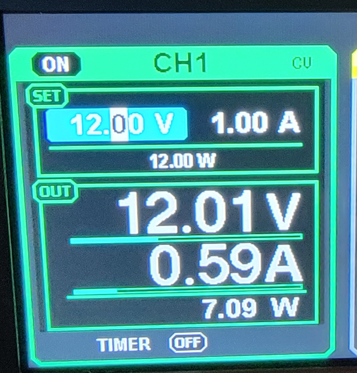

          Cleaned up some solder joints and now it jumps to 59ma and back to 26ma. I have a southbridge on order. Pretty sure we are on the right track. Time will tell. Thank you.

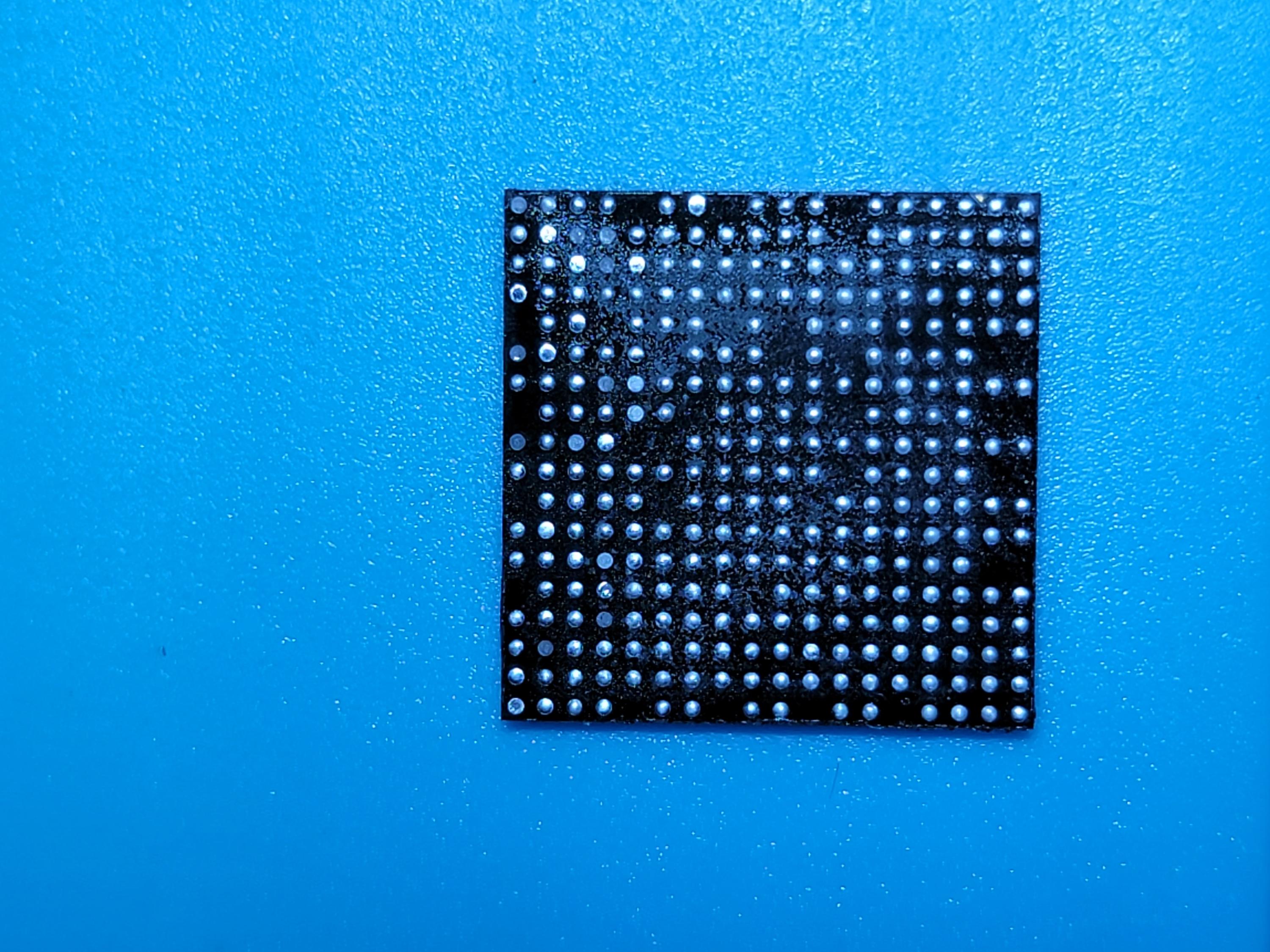

              Re: PS5 BLOD- CFI-1115A Disc Version- Board= EDM-020

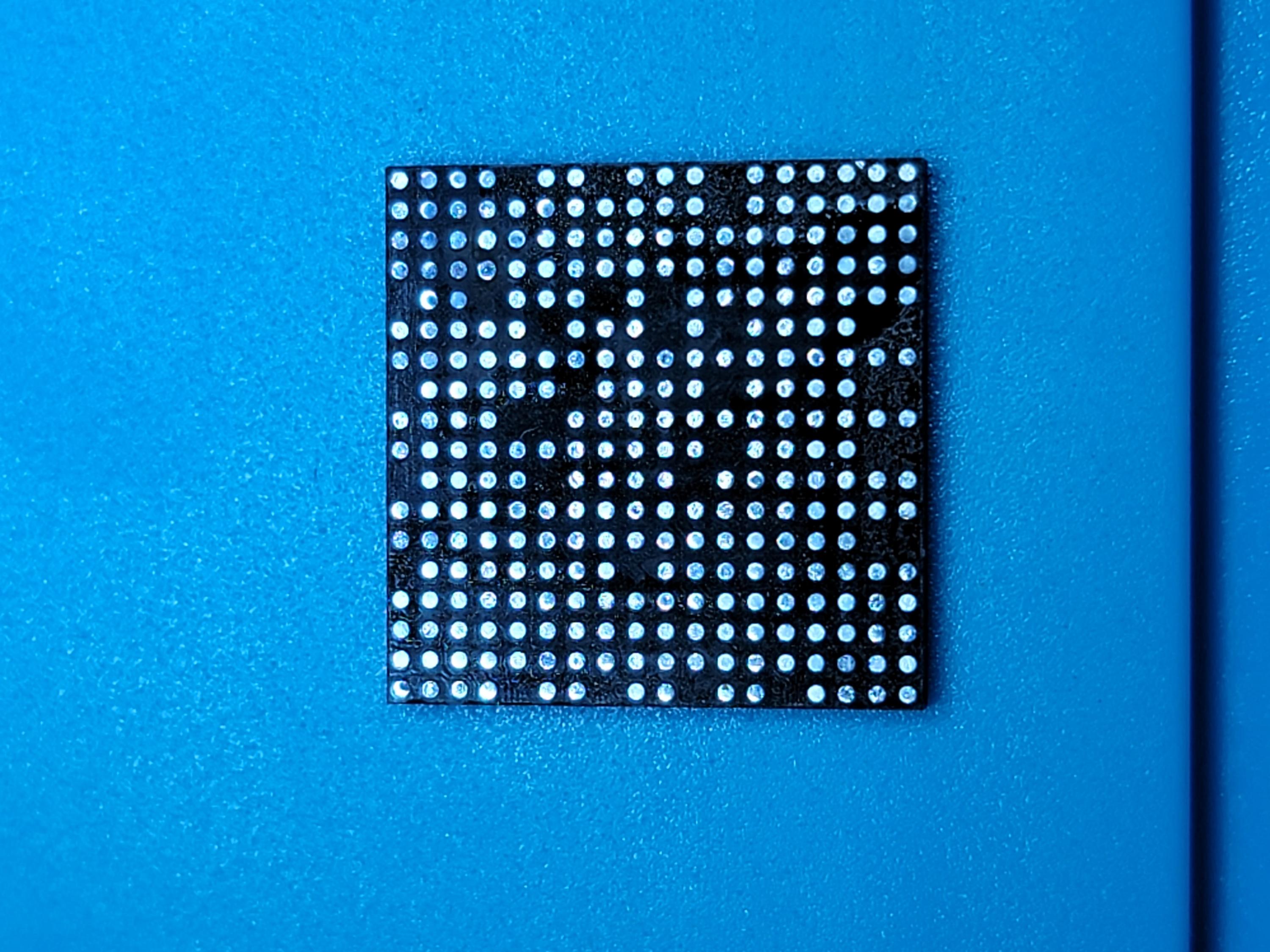

              So I think my stencil for the southbridge chip got lost. Has not moved since June 16th from last location. Just to be sure I did some further troubleshooting while i wait. Now i just have a single beep without making any changes. Due to that fact and having to wait. I pulled the APU sticker up and found liquid metal bridging a cap. I have cleaned the APU and around it. But i have three questions. How would the APU get this diced up on the surface? Will this effect the chip? And last but not least.. Can i use solder mask to coat the area around the APU, or should I use conformal coating? Anyone else coated around their APU?
                • 31256

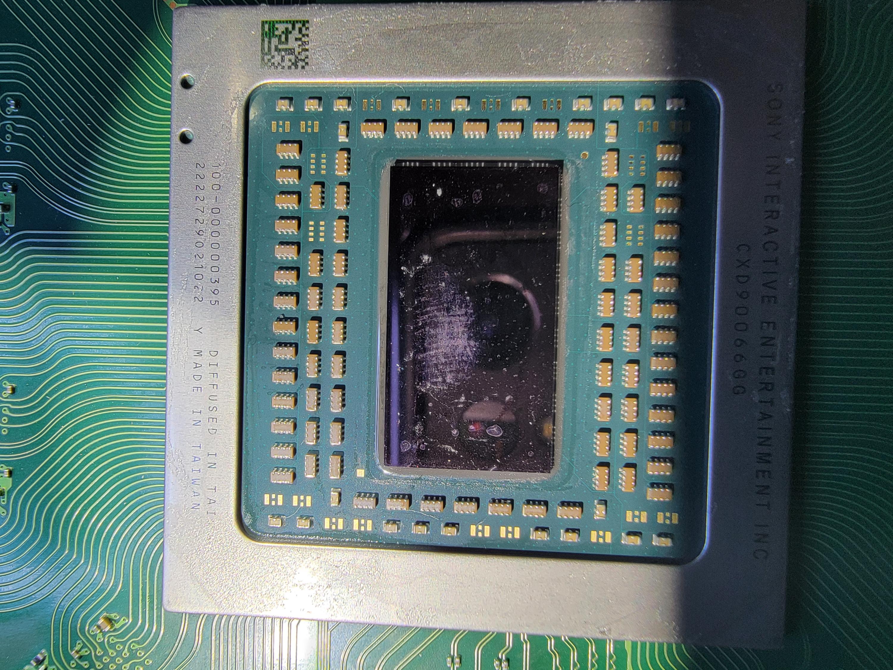

                #47
                some of those filters still have something on them - galium??
                as for the die - i think it has a coating - maybe the coating is bubbling - cant tell from the pic
                • TheWizard
                  Stj,

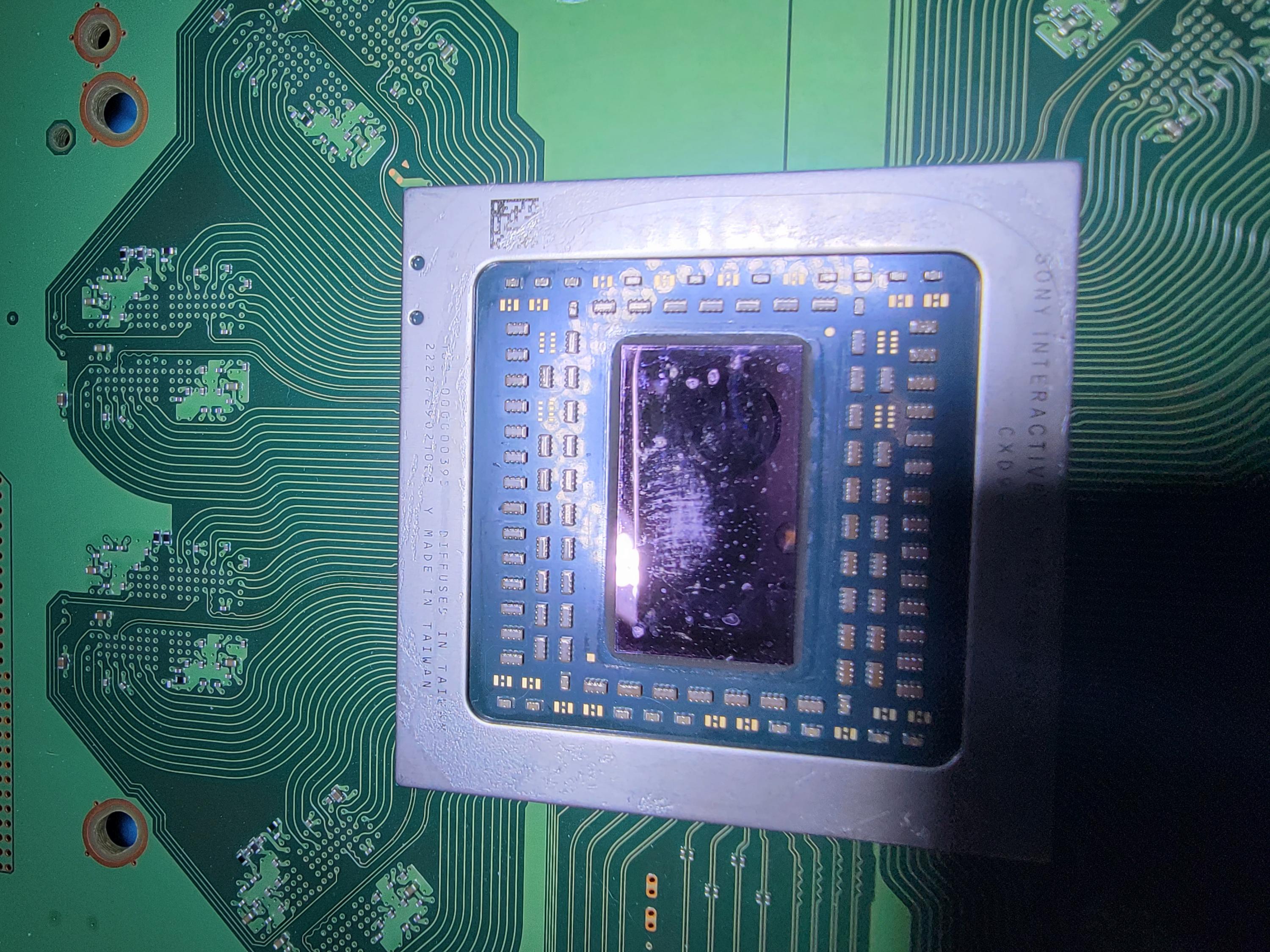

                  This is a better pic. Took one with my anti glare light. Clean. The chip literally looks like it has a fingerprint on it. And as for the solder mask application. Instead of conformal coating. I think I will be okay as long as I coat it fully and protect against the liquid metal. Console will be sitting horizontal anyway. What you think?
                    • 31256
                    #49
                    well it may be caused by previous "cleaning",
                    it shouldnt matter as the chip is effectivly upside-down anyway.
                    UV solder mask may be a good idea, does it even need galium? isnt it paired against aluminium?
                    if it was that hot they could have used copper.
                    • TheWizard
                      • Feb 2015
                      • 190
                      #50

                            Makes sense. Okay used the red. Cured it and put the foam and liquid metal back on. Now i draw 54 ma of current and as soon as i check the southbridge cap. Boom down to 26ma. I think we may have a failing southbridge that just becomes more degraded each power up. Thinking of lifting it and reballing by hand lol. Sick of waiting for stencil lol

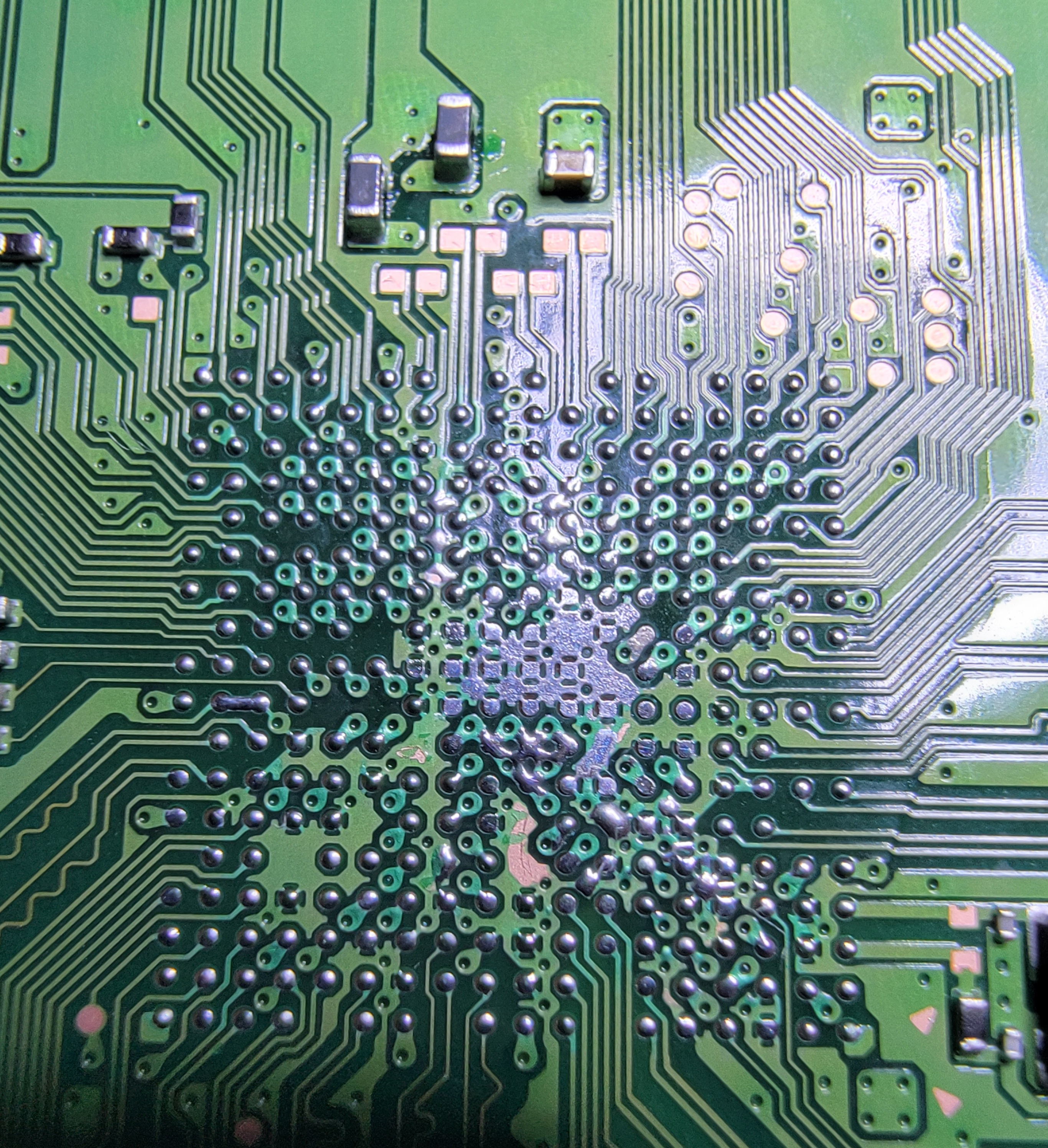

                                Lifted the Southbridge and boy did I find a surprise. Not only oxidized pads. But whoever worked on this before exposed the copper and put the chip back down. Explains the eratic intermittent behavior of this console. Now I have to refer to online pics of the traces and mask what should not be connected. Fun times.

                                  gotta be honest, if i get something that has the slightest sign that somebody has been fucking with any bga chips - i wont touch it.
                                  i'v seen too much destruction in ps3's and xbox360's
                                  another thing while i'm on the subject.
                                  i wont touch car dashboards - they have usually been fucked by people trying to reprogram the mileage who cant solder and often dont even have the right tools.
                                  there is a guy in my area - never met him but he has one hell of a reputation.
                                  i think he ruins about 20% of the stuff he touches - he uses a fucking Portasol gas soldering iron to lift eeproms!!!!!
