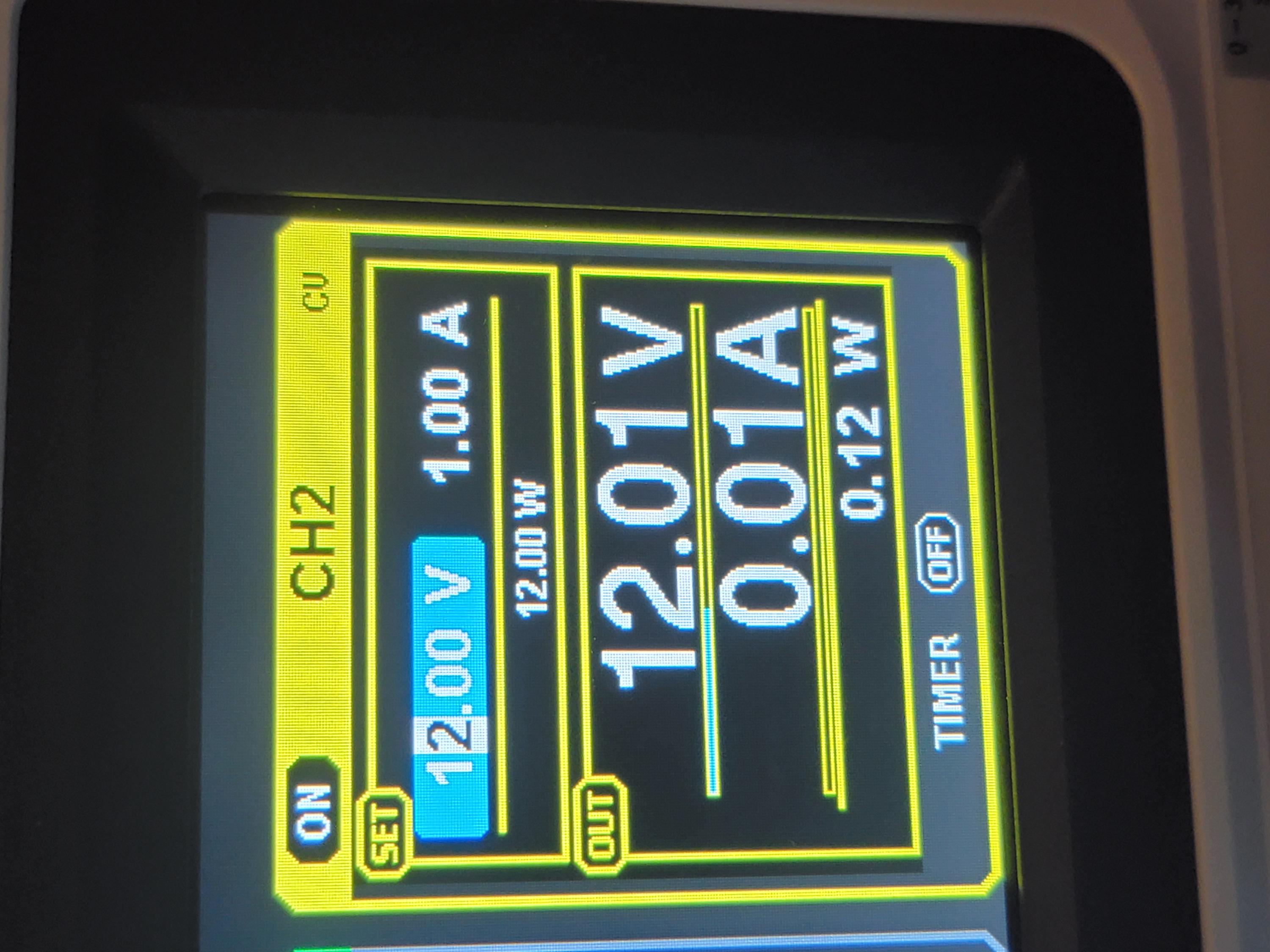

        Update: Removed board and connected to DC power supply. Providing 12 volts and 1 amp current. Looks to be a small short somewhere. This should be fun to find. Haha

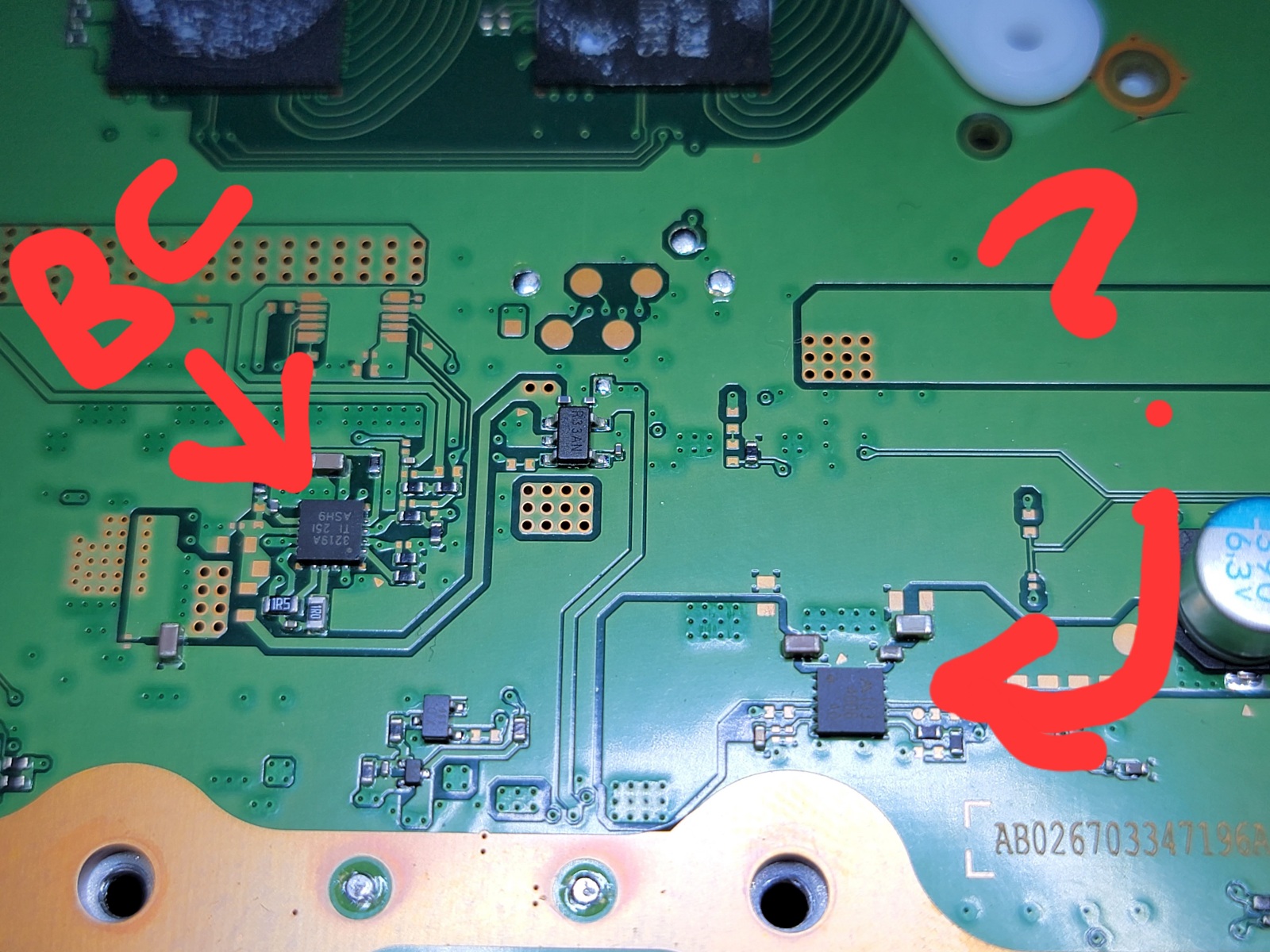

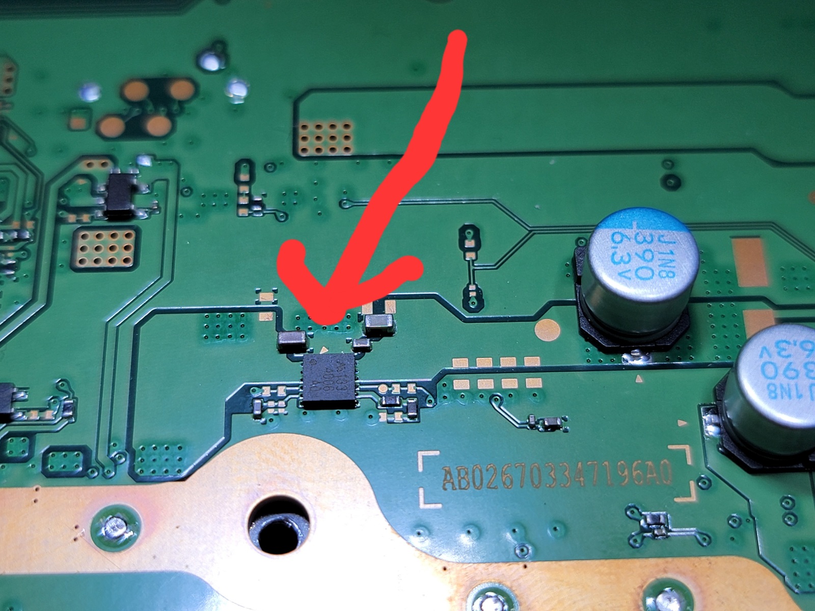

              Anyone know what the full part number of this chip is? It is located right beside the buck controller. 1st pic shows buck controller to left and un-identified chip to the right. 2nd pic is un-identified chip zoomed in.

                      Re: PS5 BLOD- CFI-1115A Disc Version- Board= EDM-020
                      On PS4, this behavior was the same as you have on PS5 (not a working HDMI chip) and the set-top box did not boot to the end.
                                Lotas,
                                So you think i have a bad hdmi encoder chip?
