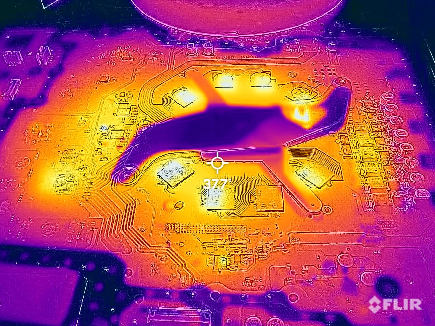

                                #35
                                Re: PS5 BLOD- CFI-1115A Disc Version- Board= EDM-020
                                So while I wait for the new bios chip to arrive. I decided I would take the thermal cam out one more time. Here is a look at the EDM-020 powered up. More to come. Need to document part numbers heating up in pics.
                                • TheWizard
                                  • Feb 2015
                                  • 190

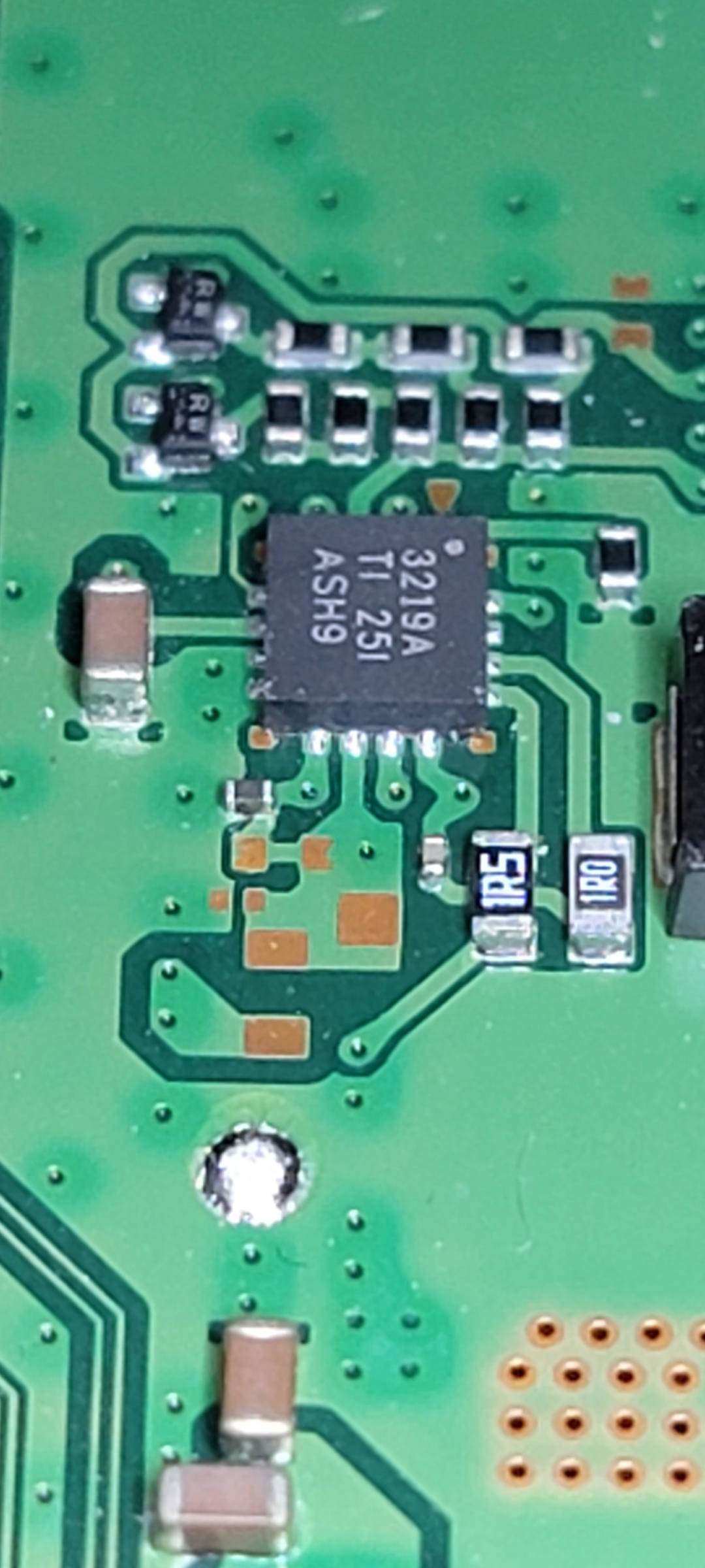

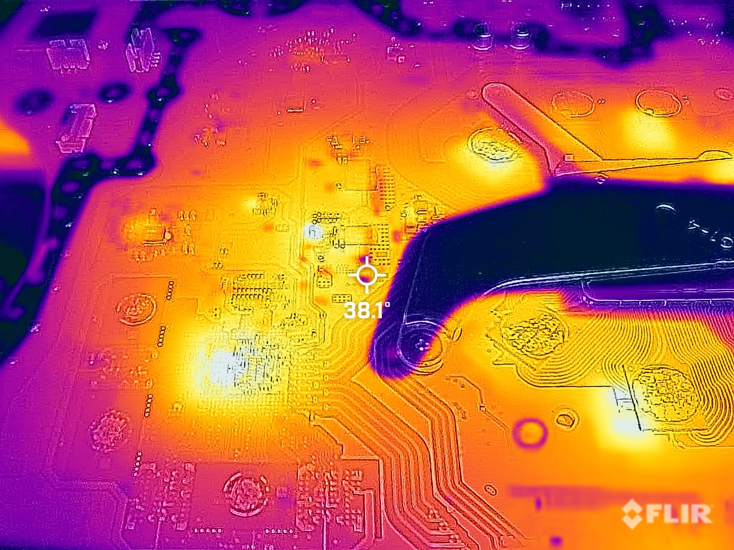

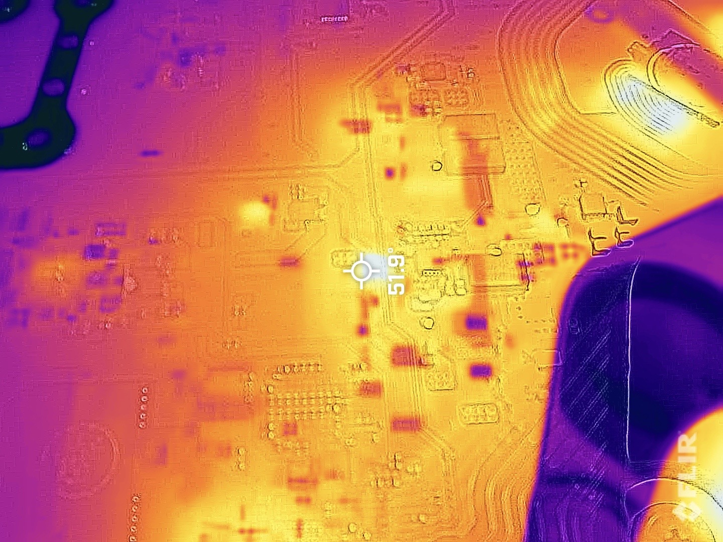

                                  #36
                                  There are (2) 3219A chips on the board that appear to be heating up. The first is located left of the APU and the other is located just below the bottom left RAM chip. If i had a known good board i could see if these chips getting warm normal or not. Anyone else have a EDM-020 board? Maybe we can work together to fix two units?
                                  • lotas
                                    • Jan 2016
                                    • 4467
                                    • Russia
                                    #37
                                    3219a - tps53219a
                                    • TheWizard
                                      • Feb 2015
                                      • 190
                                      #38
                                      Originally posted by lotas
                                      3219a - tps53219a
                                      Lotas,
                                      I am wondering if they are worth replacing. Dont want to go down another rabbit hole. What you think?
                                      • lotas
                                        • Jan 2016
                                        • 4467
                                        • Russia
                                        #39
                                        They should get warm, check the datasheet for output voltages.
                                        • TheWizard
                                          • Feb 2015
                                          • 190
                                          #40
                                          Oh sorry i missed that. 40 celsius to 85 celsius. Well the highest i have seen is 60 celsius on the chip to the left of the APU. The one below the RAM chip is running low 40's to 50.

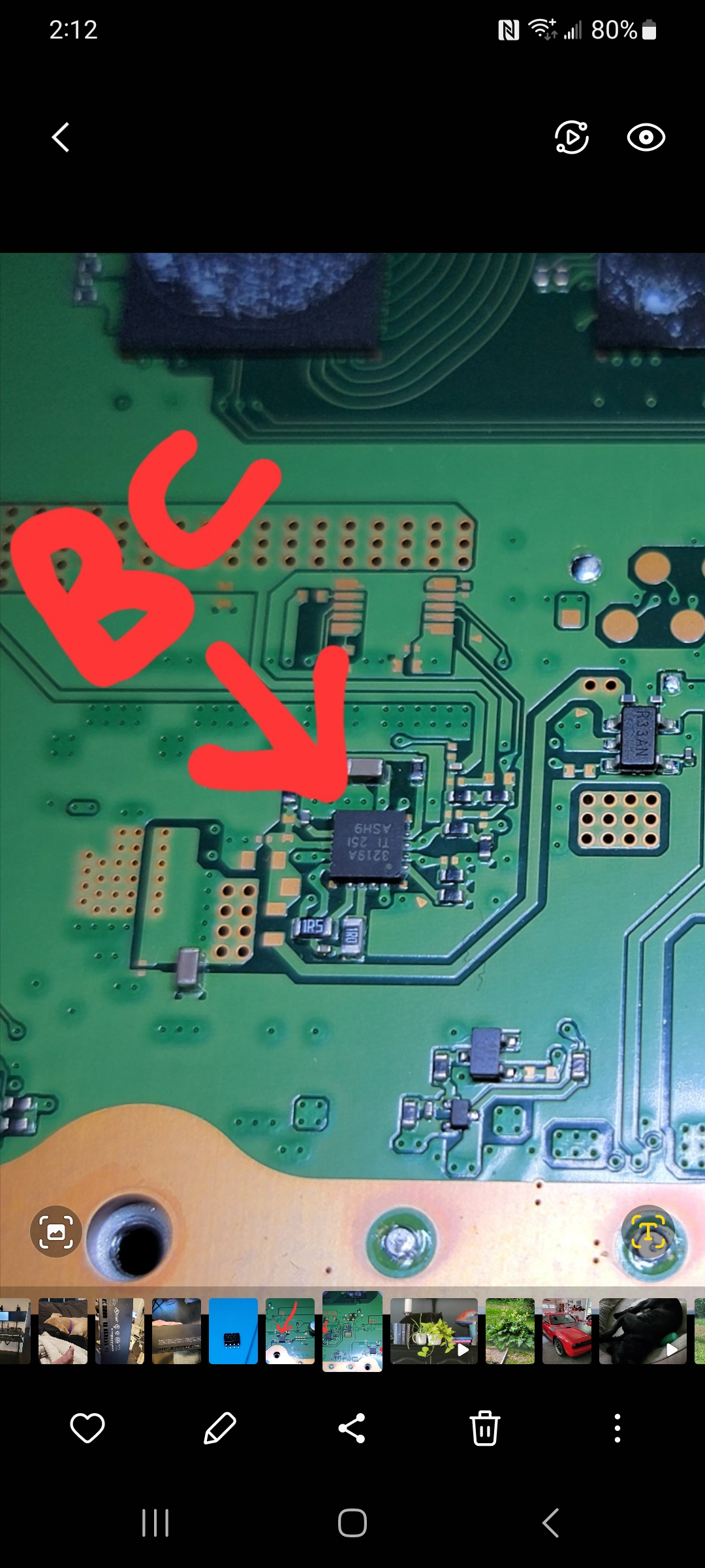

                                            PS5 Disc Not Supported/ Disc Not Recognized Board Num: EDM-020
                                            by Junior††
                                            Good Afternoon fellas,
                                            Issue:
                                            Disc is showing as not supported when a disc is put in.
                                            Here's what I've done, you can skip this if you just wanna know the question:
                                            - replaced with a disc drive from a donor ps5 (honestly questionable if this is known to work)
                                            - reflowed the disc drive connector
                                            -reflowed the chip in question (shown on image)
                                            - I will say this console was very dusty so it's conceivable that it got so hot that it made the chip joints cold and potentially other things on the board
