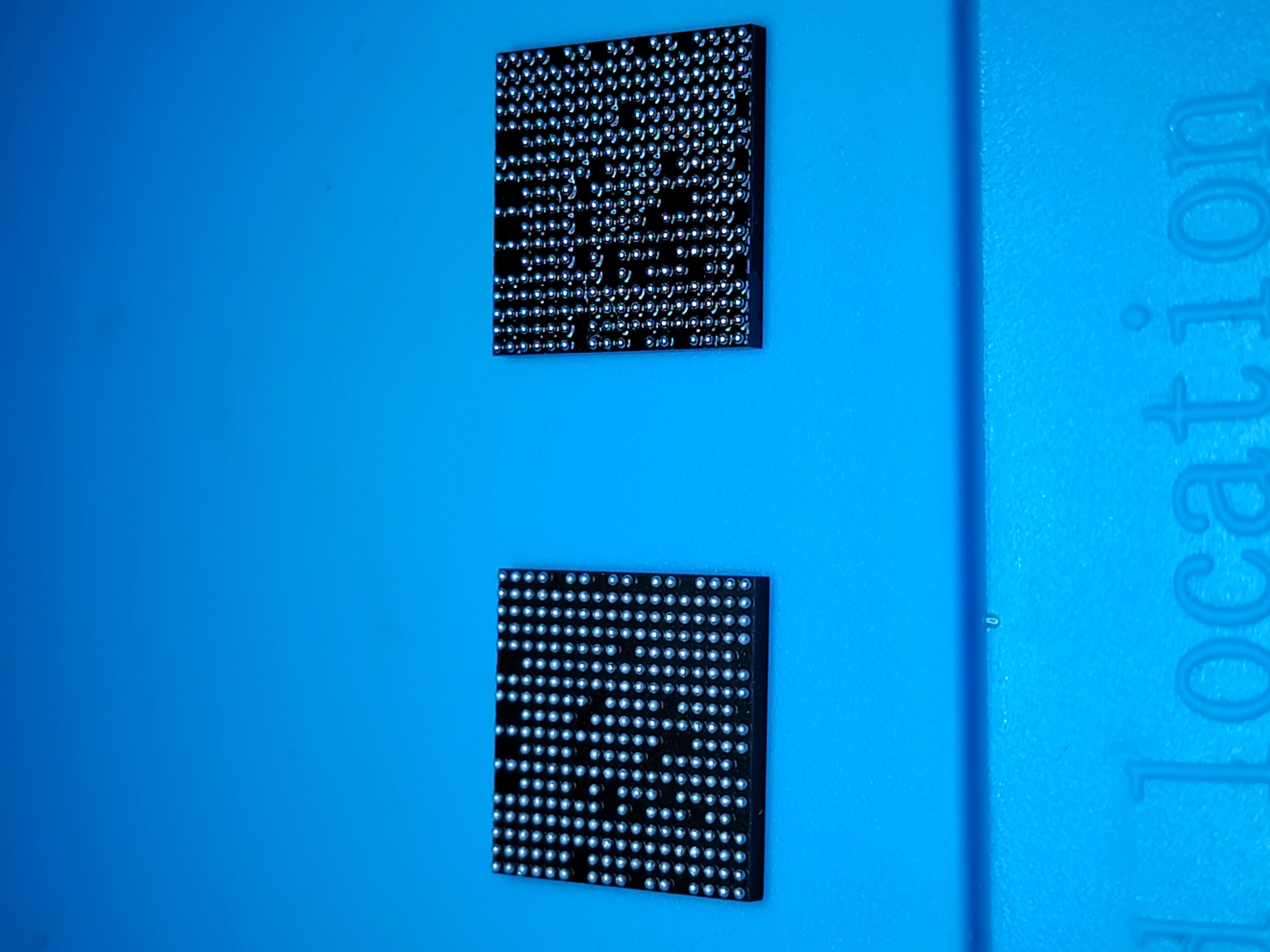

      Re: PS5 BLOD- CFI-1115A Disc Version- Board= EDM-020
      As Alex from NorthridgeFix would say " Better than factory"
      NEW chip on LEFT. Re-Balled original chip on RIGHT.

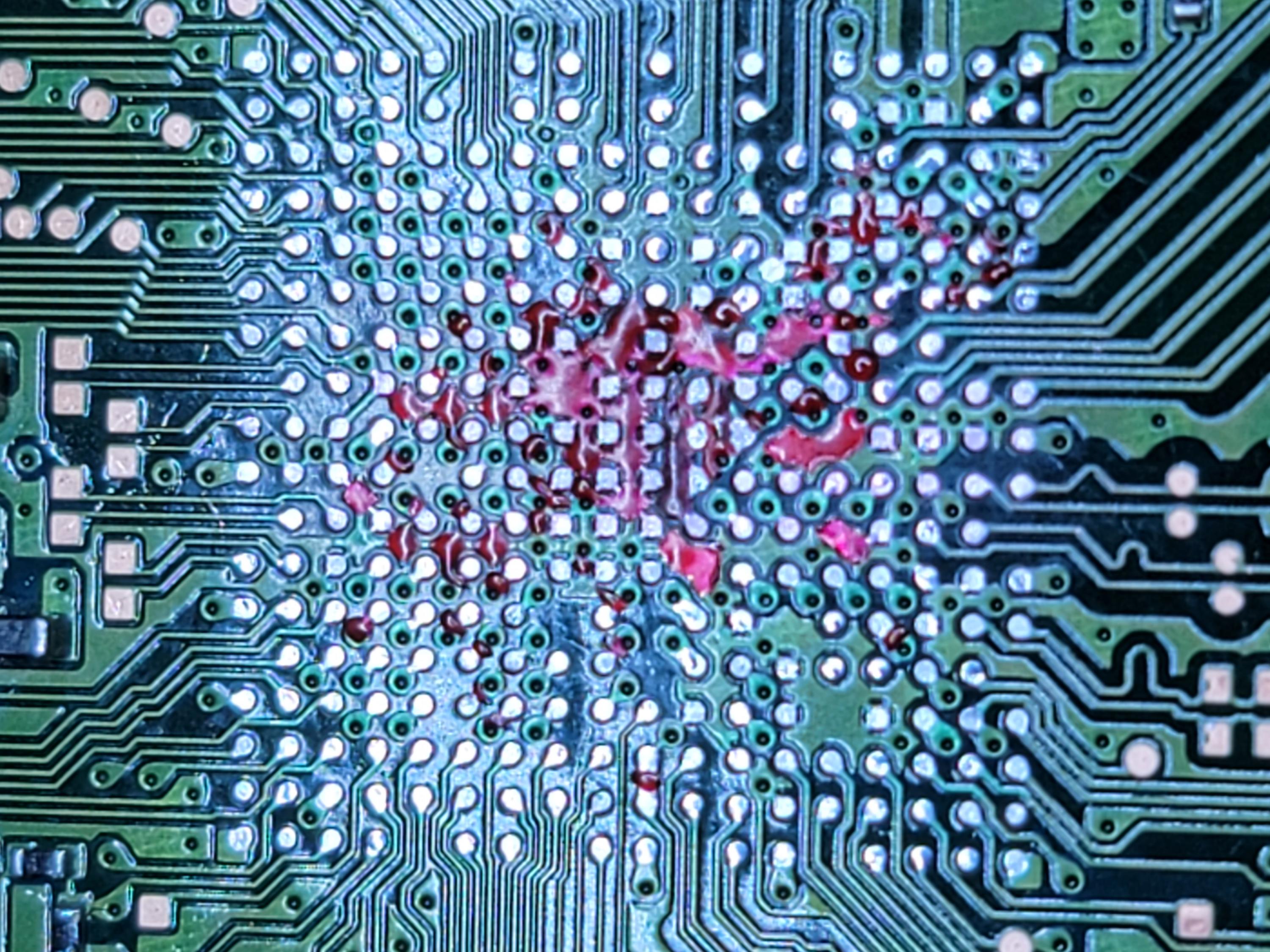

        #63
        Okay I think we are ready for chip orientation, flux and hot air. That and a whole lot of miracles haha

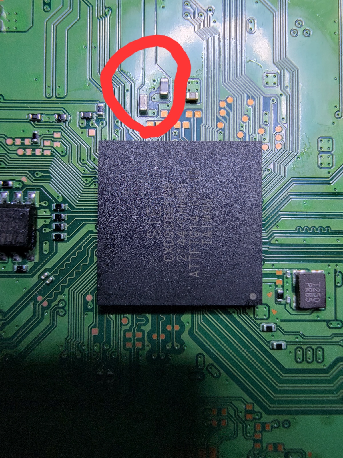

          Successful replacement of the NEW Southbridge chip from China. Issue still remains though. But I have 4k ohms resistance to ground. When i feed it 12v of power @ 1amp. The board draws 54ma then drops to 22ma. Maybe the WIFI IC or the SSD controller.

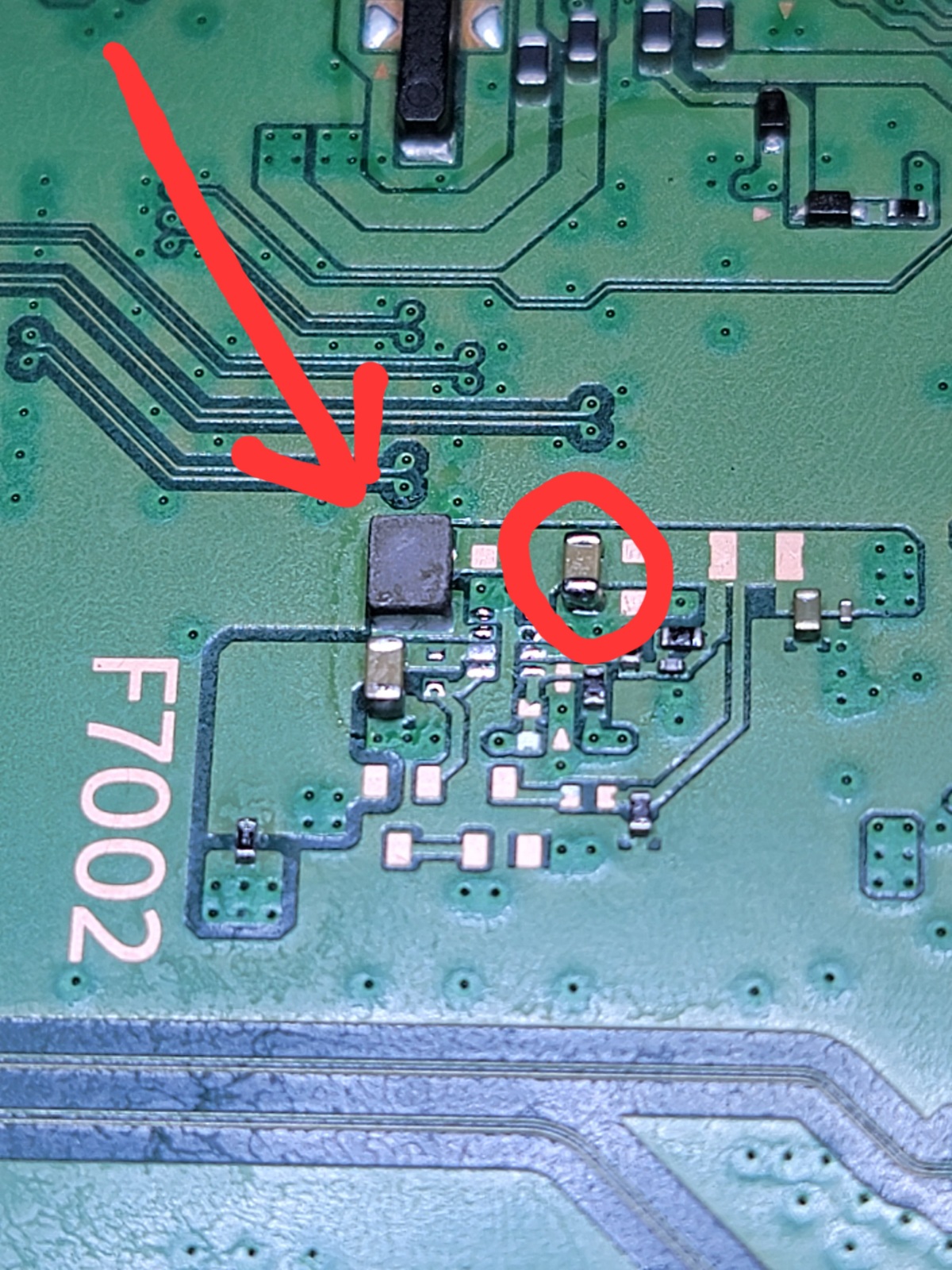

                          #72
                          The A2 chip was not making a good connection. This chip is a bear to get soldered due to the confined space. I had 5.0v on the right side of fuse but only 0.473 on the left. Checked the fuse i continuity mode. Fuse blown. Anyone know the specs of this fuse?

                              Mario,
                              I still dont trust that A2 (TPS62822) chip either. The bench power supply no longer limits since i fixed the oxidated pads under the A2 chip. Will revisit . Thank you as always.

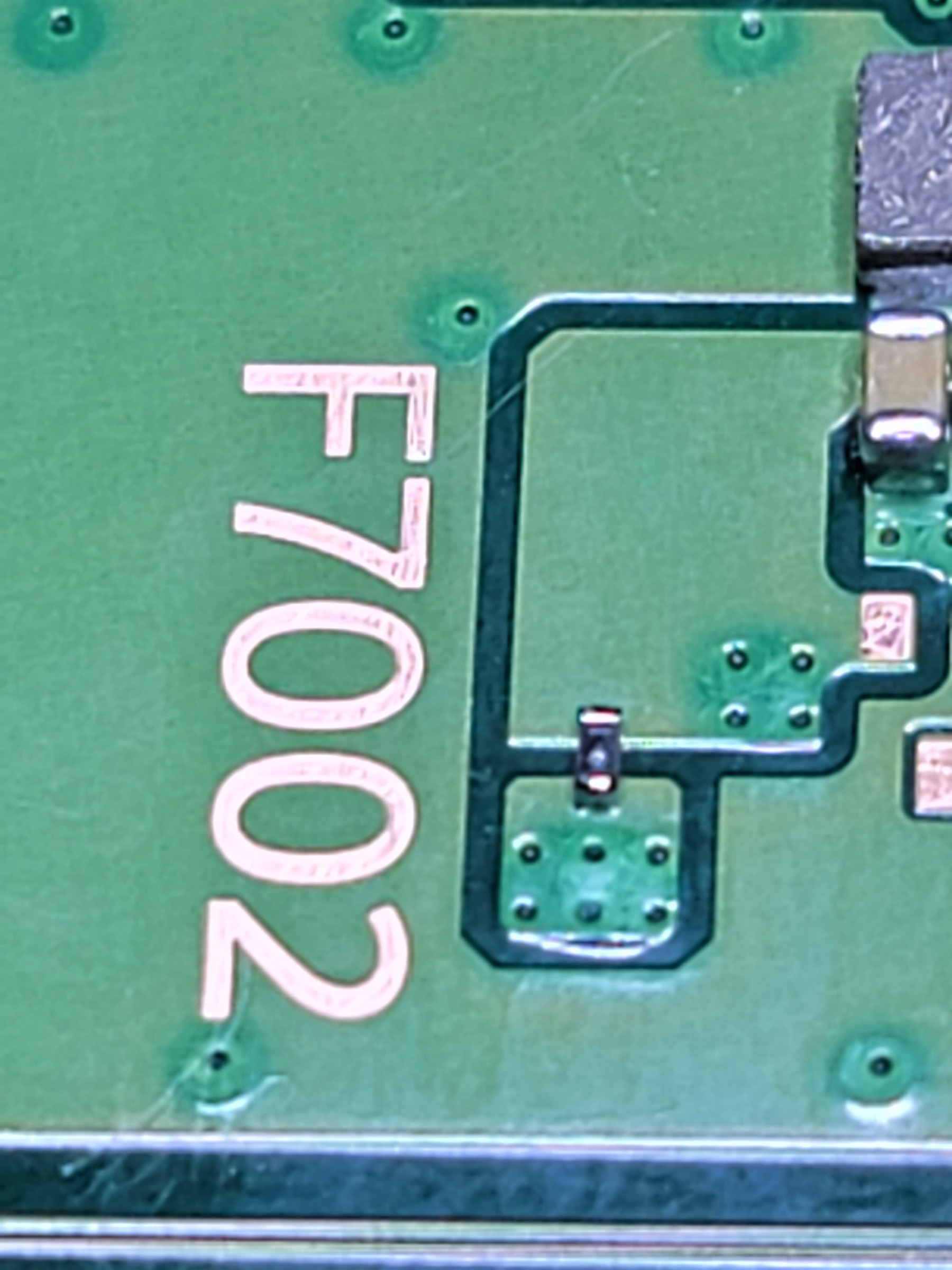

                              • TheWizard
                                • Feb 2015
                                • 190
                                #75
                                Where can we source the F7002 fuse from? I see Kasynparts has them but not sure how long it will take to receive. Anyone have ideas or experience?

                                    Fuse is a 0603 Timed(slow blow) 3 a 6v. I can find fuses but not 0603 3 amp with 6v. All the voltages i am finding are much higher
                                        Right but for that circuit. The voltage should only be 5v on both sides of that fuse.
                                          • 31256
                                          #80
                                          so if it's rated for 250v your fine.
                                          fuses dont blow based on voltage - only the current matters
