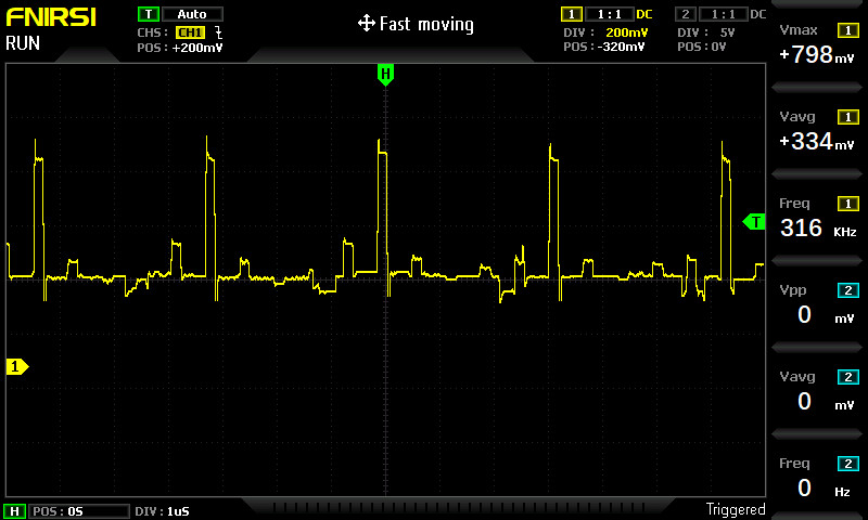

                  Re: Gigabyte Aorus 1080ti - card not initialising
                  Out of interest, here is the scope output for the GPIO pin on the working card (i just used auto ranging on the scope).
                  It's not a PWM signal as far as I can see as waveform does not change, and neither does the voltage on the MOSFET.
                    Looks a bit dodgy, is your scope isolated from the mains?
                    • benwaterson
                      It's usb powered (using front usb connector on pc). Shows freq of 316khz. Tested the crystal on the card with this set up and it reported a pure 27mhz sine wave (no interference).
                        Strange yeah should be OK if scope has the same ground reference. Still looks like interference, since surely this is a digital signal.
                          Try this one (used USB charger instead of PC) - reported voltage is way better too
                            Yeah that looks more like it, still hasn't helped much with finding out what the problem is tho, hmm...
