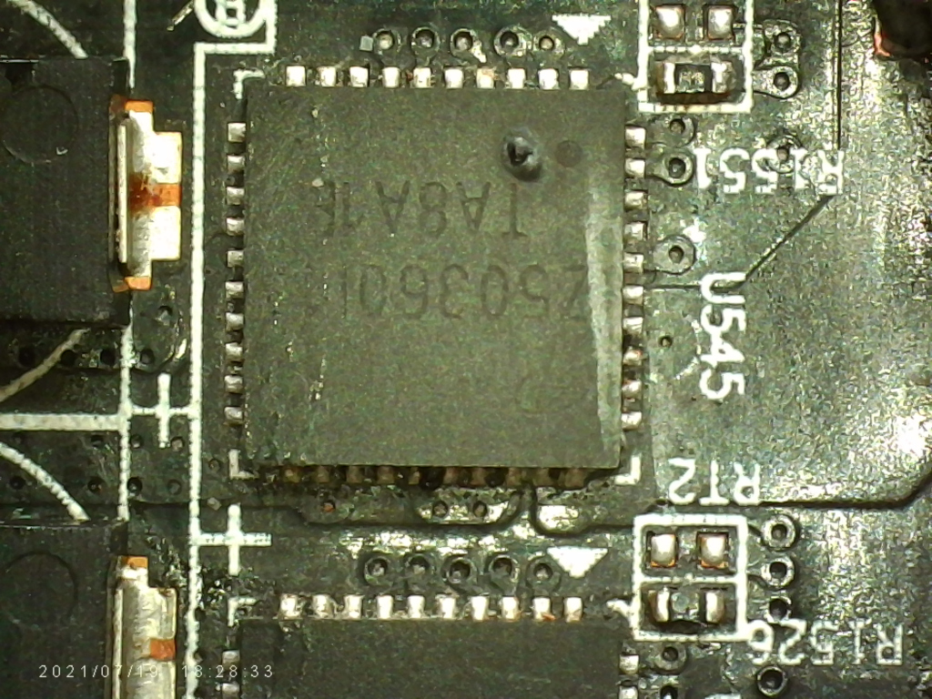

    Yikes, its had an overvoltage on the 5v rail it would seem. I know the FDMF6820a drmos cannot handle more than 6v, similar thing happened to me and when the 3rd drmos popped it took the gpu memory controller with it It'd be a shame to give up now

        Re: Gigabyte Aorus 1080ti - card not initialising
        Looking at pinout and the results of the voltage injection / alcohol test, the heat is between 5VCC and the ISEN (current sensing pins from DRMOS chips) as per the attached diagram. Could be current flowing out of the ISEN pins to the DRMOS causing the heat on those 2.
          Originally posted by benwaterson
          Ordered more up9511's from the "chinese site"
          Good man, yeah dunno about the drmos I take it they are not shorted source to drain? You can check the gate high and gate low pins for shorts.
            Not checked yet, will have a look and report back (there is no 12v short to gnd through the core though)
              Do you mean between the marked pins on the attached? (GL and GH)
                Yeah gh and gl, I would expect a 5v overvoltage event to have blown up a running drmos completely so if it seems ok then probably it is.
                I think I would remove the up9511 then check the resistances on the suspect drmos pins and compare to a non-suspect one
                          Whilst waiting for supplies and thought I would do some more checking.
                          Isolated the up9511 from 5v by removing the 2.2ohm resistor attached to pin 12.
                          Did another voltage injection test and have found the failed DRMOS now. As all the current on 5v was going through that it has failed with a puff of smoke and a hole in the top (this was at 2.5v, not the full 5v). None of the remaining 10 seem to have failed.
                          Had already removed a failed one at the very start of this, so am down to 10 from 12 chips.
                          Time to order more chips......
                            Ok, progress update.
                            Received the Quick 861DW this morning. Preheated the card to 100c with a temp sensor below. Cranked it up to 460c / 110 air and low and behold the DRMOS was removed in 30 seconds!
                            Removed the up9511 in even less time.
                            Tested for 5v rail short, and voila - short gone (100k resistance).
                            Just need new chips now
