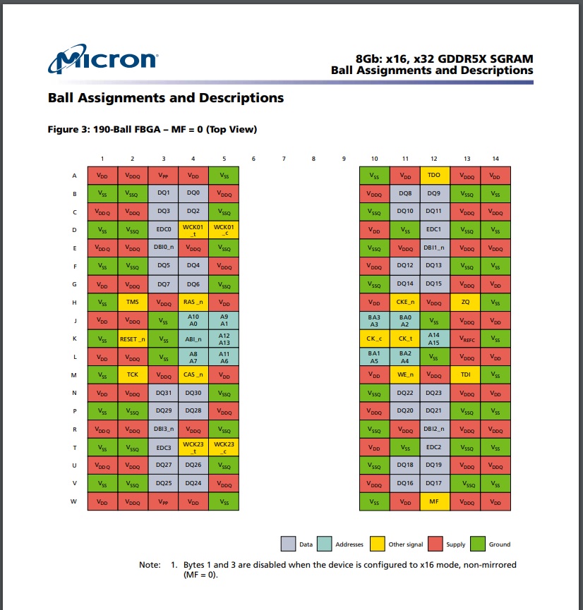

    VDD (positive) to VSS (GND), most of the GDDR5X chip pins are for power, so 1A to 1B perhaps (see image)

      Re: Gigabyte Aorus 1080ti - card not initialising
      Originally posted by benwaterson
      I am now systematically removing the ram chips one by one to:
      1) Find which are good still (if any!) to re-use
      2) See if the low ohms on the FBVDDQ rail is gone once all removed
      Removed 3 so far and all low ohms on the chips, 1 is 14ohm which is still too low (should be 30-60ohms)
      So my assumption appears valid - with all ram chips removed the FBVDDQ resistance is now almost exactly 60ohms, so no low ohms partial short within the core itself. Of the 11 chips removed, 6 have a reasonable resistance (kiloohm range, nominal value seems to be around 14k), 1 is around 800ohms, 4 are in the 2ohm range so deemed dead.
      The last 7 removed were all better resistance, so I believe there was a short under on of them (solder ball perhaps) as the FBVDDQ rail didn't return to 60hm till after the final 7 were removed

        A card with no ram at all installed is able to run MODS/MATS blind but will obviously fail on all memory tests (purpose of that being to see if the core still functions), the decision now is whether to continue and fix the low ohm 5v rail (by removing further DRMOS chips) or assess the new faulty card that should be with me tomorrow and see the extent of the damage on that first.

                  As a data point I have two supposedly new GDDR5X Chips here Micron code D9VRL
                  Their resistance of 1A to 1B measures:
                  20.6 K ohms date code 8MA77 (KJF4)
                    According to "CSN-11: Product Marks/Product and Packaging Labels Introduction" from micron on page 6
                    Date codes are alphanumeric characters that indicate the year and workweek the parts
                    were marked, in even-numbered workweeks. The first characteris the last numberin the
                    year, and the second (alpha) character is the workweek.
                    A = 2 E = 10 I = 18 M = 26 Q = 34 U = 42 Y = 50
                    B = 4 F = 12 J = 20 N = 28 R = 36 V = 44 Z = 52
                    C = 6 G = 14 K = 22 0 = 30 S = 38 W = 46
                    D = 8 H = 16 L = 24 P = 32 T = 40 X = 48
