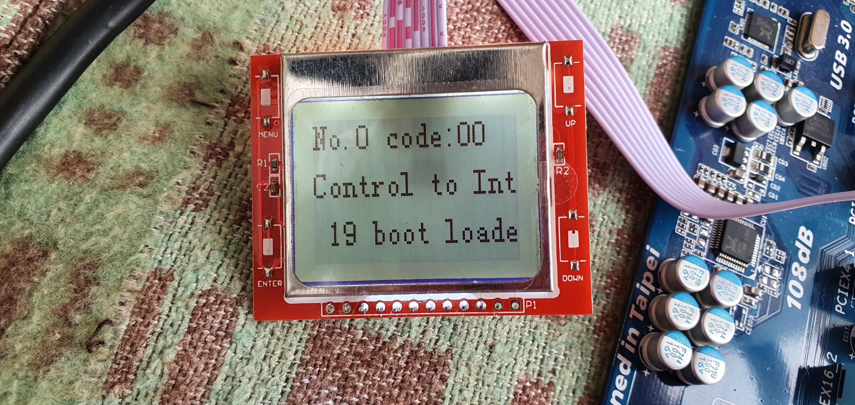

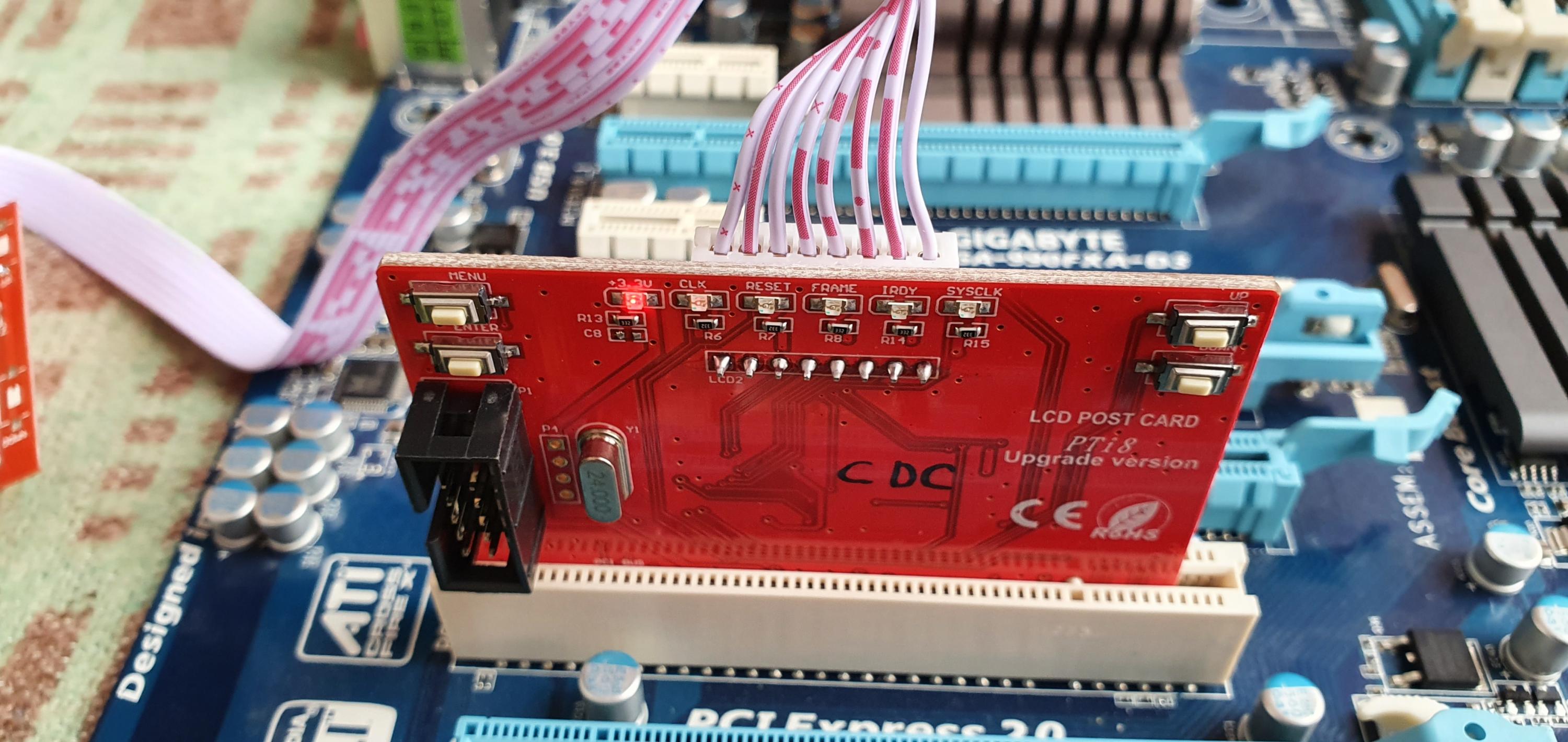

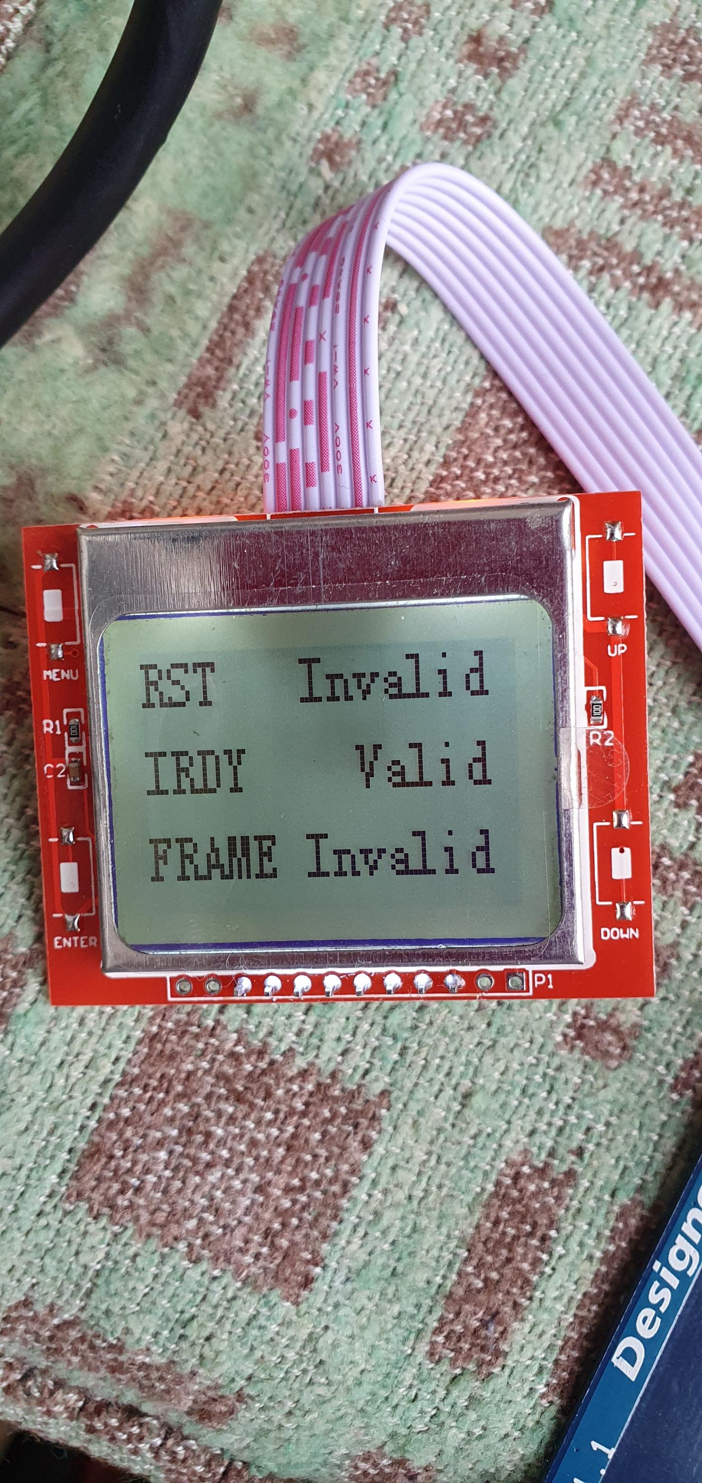

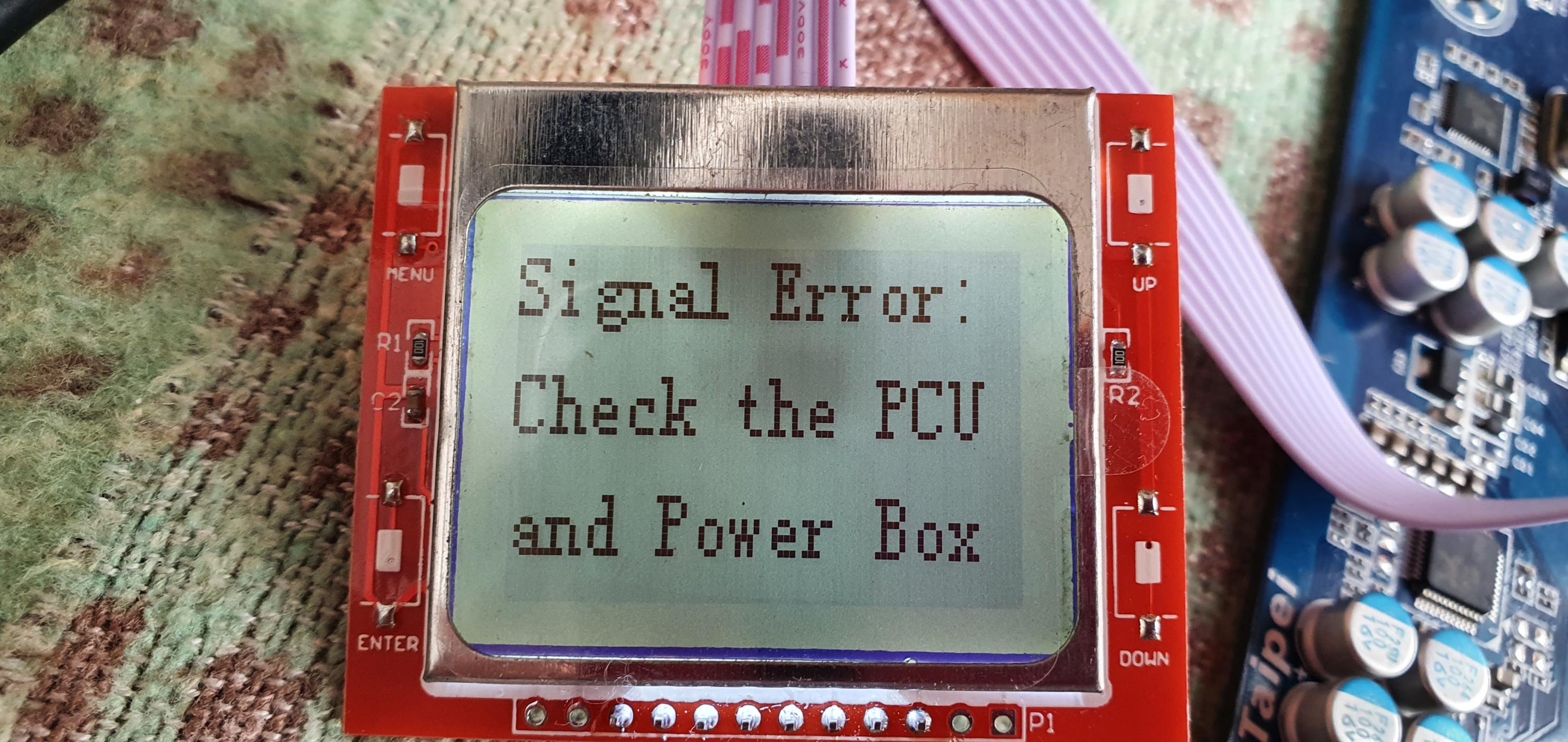

                            Hello chaps. I have a fairly similar MB with a fairly similar issue, so I thought I'd join too, in addition to creating my own thread, in case someone's been watching this more than mine.
                            My board is a ga-990fxa-d3 and has pretty much the same symptoms: won't do anything upon hitting the power button aside run its voltage rails and spin the fan. No beeps, not nothing. All the voltages seem there, including VCore (CPU gets hot). I know the CPU and RAM are good because I tested them in another MB and they work fine (unless this bad MB killed either of them somehow in the process, which I doubt, because I used this CPU before in it and then moved it back to the functional MB and it survived).I found the schematic for my board (though no boardview, so if anyone has one, it would be great if you could share it) and I'm thinking of maybe replacing the clock chip on page 13 (ics9lprs477)...
                            I tried using one of those cheap POST diagnostics cards, which although FAR from professional, tells me there's probably something wrong with the clock chip, because the "CLK" LED is only dimly lit and flashes every 2 seconds along with the RESET LED. The LCD display of the test jig shows what you see in the pics, which is not very relevant. The CPU has Vcore and gets hot, so I assume it's OK.
                            What I tried:
                            -reflashing the M_BIOS SPI chip as described before
                            -replacing the crystals around the bottom heatsink for the SB where the clock chip is located, not knowing what each does at that time. Looking at the schematic, I now know X7 is the one connected to the clock chip itself. It's worth noting all of them came from another dead board I had around, so it's not guaranteed they're good (do crystals have a tendency to fail or don't like being heated up too much ?)
                            -I noticed that if I remove the ATX_12V connector so the CPU is not powered, the CLK LED DOES light up solid, which would almost make you believe there's something wrong with the CPU and it kills the clock line. Then again, I'm not sure what these cheapo diagnostics cards really look at in order to determine if that CLOCK LED should be on or off, since there are multiple clock lines - not just the CPU one.
                            Wattevah...

                                Re: Gigabyte GA-990FXA-UD3 rev 1.1 No boot
                                Actually, I stand corrected:
                                On a working MB, the RESET LED comes on when you actually hit the reset button (pull the RESET pin of the front panel connector low to GND). On the "bad" Gigabyte motherboard, it does the same thing, except it flashes every 2s as the board fails to start and keeps resetting. It stays on continuously if I unplug the ATX_12v connector, but not if I remove the CPU itself ! It's as if the CPU is not being detected, as it has little impact on the whole operation whether it's in place or not, though it DOES get hot and I get Vcore.
                                The CLOCK LED: it stays on in a functional MB and glows dimly on the Gigabyte one and flashes whenever the RESET one also flashes. It does this with or without the CPU in place. It goes out entirely if the ATX 12v connector is disconnected.
                                EDIT: I made another discovery, which for some reason I thought I had already made. The CPU I'm testing this MOBO with is an FX-8320....guess what: this is not in the supported CPU list over on Gigabyte's website....
                                A little backstory: this board belonged to a friend of mine who asked me to take a look at it once it no longer worked. He brought it in with his own CPU which I can assume was compatible, since it had worked till that point. He took his CPU back after a while and that's when I remembered I had this 8320 lying around, so I dug it out and without checking, just tossed it in the socket. Since it fit, I just assumed I could carry on trying to fix the MOBO, but it turns out it's not in the support list, so that is certainly part of the problem....I sure hope I didn't kill the 8320 too, since I DO have a good MOBO I want to use it in, so that would be pretty sad ! :|
