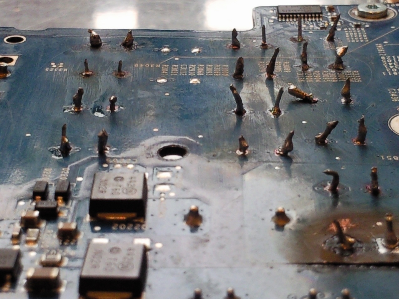

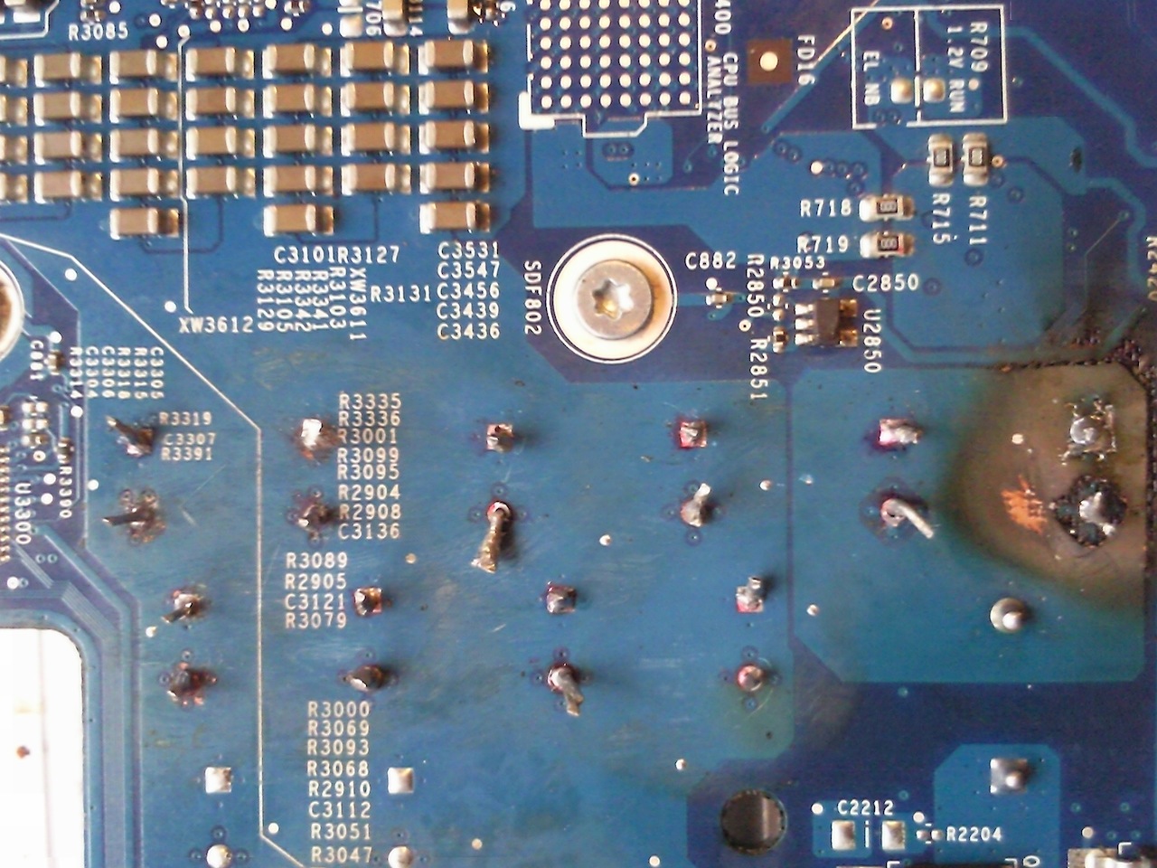

A Lesson In How To Recap Profesionally.
  • deckart
    • Sep 2009
    • 67
    Just got this off Ebay,20" Imac G5 1.8Ghz.I don't think anyone can beat this one for sheer lack off any ability to solder.For the burnt layer I reckon he must have used a blow torch!,nice caps though.The chap is coming round tonight to give me my money back,he was totally unaware of the botch,he gave it to his "IT" guy to fix,shame he didn't look at the PSU,nearly all of the caps are blown.
    On a positive note,he's using me now to do his works IMacs.

    Horrible to say the least!!!

      damn! he must have been using a butane torch (without the metal tip) or a zippo. maybe a 150w solder gun.

                what a mess!
                looks like the rework was done with a blowtorch and a cold iron!

                  Was that done by a 2 year old?? my first solder job ever done looked 100x better then those.. not to mention that he needed to trim those leads down a bit.. I think the guy that did that should have paid the customer for that kind of a job..

                      First I read the title and thought hmm, interesting...
                      Then I clicked on the thread, opened the attached images and was like WTF .
                      Seriously, even I think I did better when I was learning how to solder.
                      And if I was a techie, I definitely wouldn't practice or learn to solder on customers' boards - that's just wrong.

                          g5 boards are a little tricky, theres a lot of large copper planes on them, which makes flowing the solder a little more difficult. a hotter iron helps.... however, that cob job is an absolute disgrace!! even if I were an amateur, I'd be ashamed of that mess!

                            Reminds me of an episode of that Colony show the guy was harvesting components from an old electronic ballast. Without a soldering iron he blasted the board with a propane torch and pulled the components out.
                            It must have been the stupidest thing I've ever seen it made me wince. But that's what that board looks like .
                            Did this guy not own a pair of side cutters either?
                            It's understandable if the board has thick ground traces that a amateur solderer would leave cold joints.
                            But this guy wasn't even trying the solder wasn't flowing at all. Thick ground traces demand a 40-50 watt temperature regulated station. A 20W unregulated junker from Ratshack ain't gonna cut it.
                            Is the board actually delaminating around that dark area near the cap? Even when I began soldering I never caused that much damage this guys got talent!
