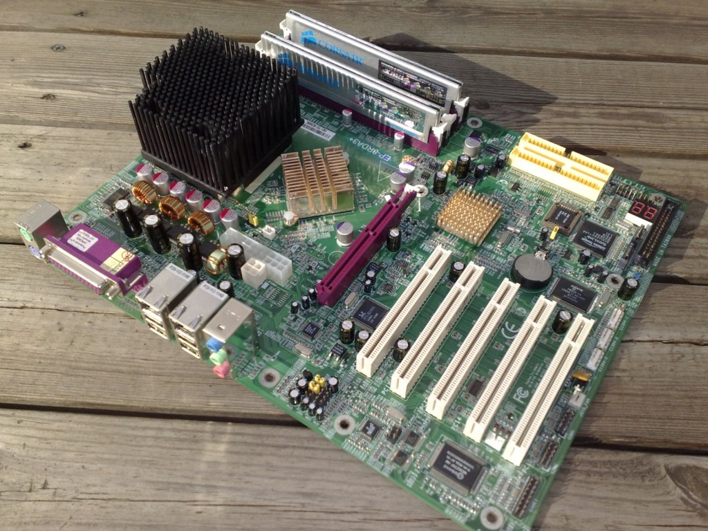

    Hi, this has been one of my favourite mainboards
    It's gone through allot of CPU's and different memory, I've owned it since November 2003. It now has 2GB Corsair TWINX2048-4000PT memory in it that only cost $400 when I bought it December 2006
    The CPU it uses is a Mobile Athlon XP-M Barton clocked to 2300Mhz
    Lately it has been commisioned into a HTPC at my parents place, I bought a ATI 2400Pro graphics card for it, it's connected to a Sony KDL-40D3550 LCD TV
    Last month or so it started locking up, it had been running rock solid up untill then at this OC, for several years...
    So I placed an order with Big Pope, since this mobo has such a sentimental value for me I thought I'd go overkill on it and give it some solid polymer caps
    Code:
    6x 2700uF 2.5v X-CON ULR
    3x 2200uF 16v Samxon GC
    4x 820uF  4v Sanyo OS-CON SEPC
    1x 1500uF 16v Samxon GC
    8x 1000uF 6.3v Samxon GC
    7x 470uF  16v Samxon GC
    3x 220uF  16v X-CON ULR
    After recapping it works great, I will see when I have time if there is now more overclocking headroom, I would think there is...
    Maybe I can also lower vcore now and still maintain stability
    The second pic I posted below as a thumbnail only shows locations of caps and their values...
    What was strange was that the caps I removed checked out ok for both capacitance and ESR, go figure, all where TEAPO except the 3 input caps for the CPU VRM (GSC). None where bulging...
    Last thumbnail to the right is an old before pic I found...
    Note; you can click image for a larger version

        Correction to the above from Big Pope, the 3 input caps for the CPU VRM are Samxon GD, not GC
        Btw, I was meaning to use solid polymers for the 4x 1000uF 6.3v caps around the RAM, but I was unable to fit the Sanyo OS-CON 820uF caps there because they where too thick (actually 3x OSCON's I could fit but the last one was impossible, so I used Samxon GC 1000uF 6.3v 8mm instead...)
