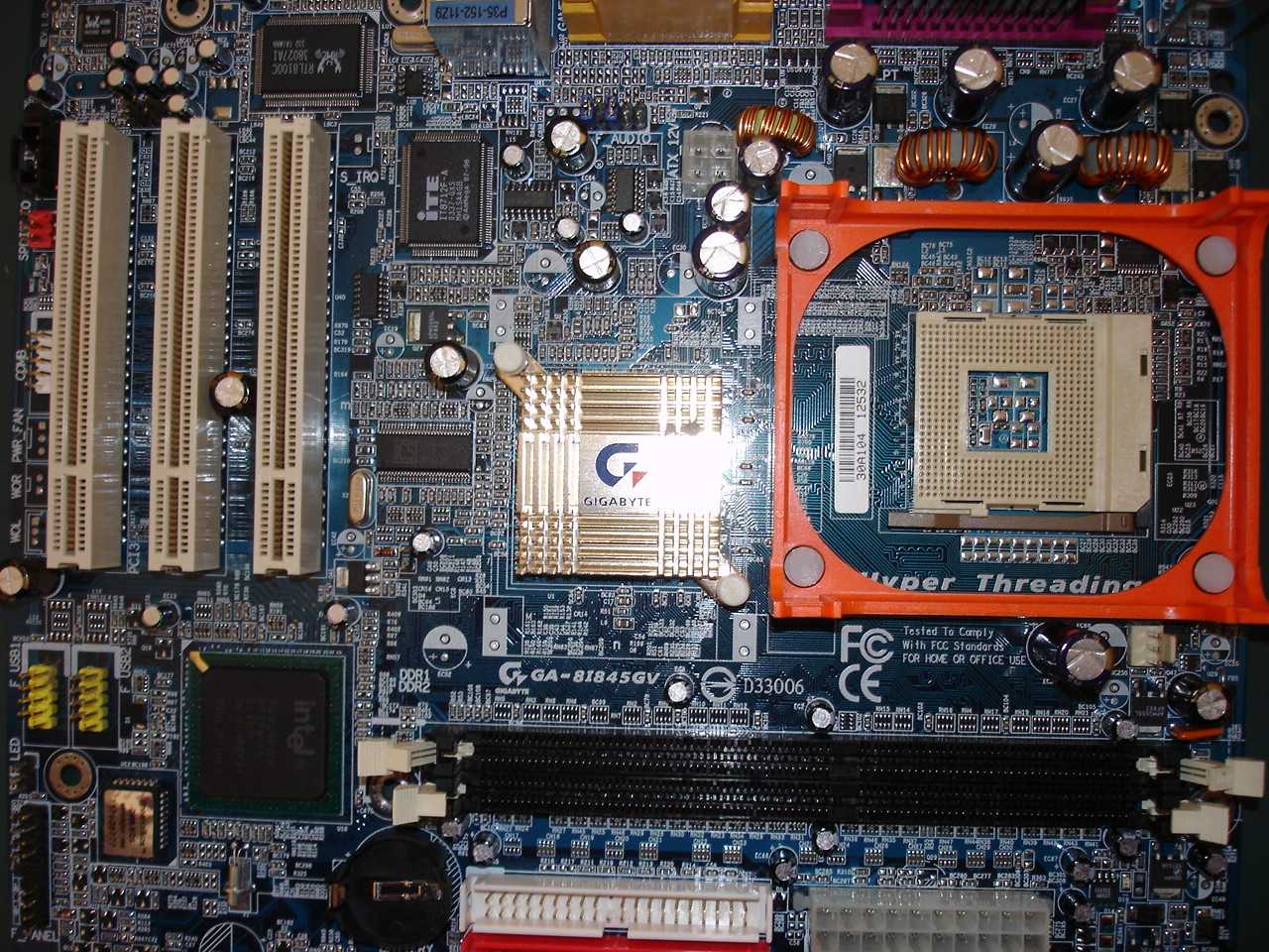

    Why I avoid Gigabyte
    Looks perfect, mainly Rubycon with some G-Luxon
    But won't P.O.S.T. - with or without battery fitted
    Possibly corrupted firmware in BIOS chip
    Any other board, pull the chip and rewrite with EEPROM burner
    Not an option with Gigabyte - they save what ? - maybe 5 cents per board, by soldering it direct
    Another Gigabyte to be cannibalised !

    Is the chipset fried by any chance? That would also cause what you said.
    I had a board similar to that one also by Gigabyte with a fried ICH5 southbridge and it exhibited the same issues. Fans would run but no POST.
    It too had Rubycon, Sanyo, Nichicon and G-Luxon caps on it.
    One sign that it was running was the fans spinning and the incredibly hot southbridge chipset.
    And yes, I also avoid Gigabyte boards because I've had a variety of boards from them which are utter crap.

      The board is probably dead. A failed northbridge or southbridge is probably the problem.

        Southbridge does not go over mildly warm - not the problem where you can burn your finger after a few seconds
        My issue with Gigabyte is when you do have corrupted BIOS firmware, there's nothing you can do about it, unlike most other makes, even cheapies like Jetway and PC Chips where the BIOS chip is socketed

            Perhaps you need to consider the current Gigabyte boards. In terms of bios they have dual bios so if one is corrupted the board will auto boot off the other. A leader in multiphase power and solid caps.

                that board is known for failures in between layers under the nic or i/o chips.
                i have several in my scrap box.
                look for bubbling or discoloration under the chips.
                they also stink when they die.

                    Poorly cooling with or without heatsink or using wrong TIM or not enough copper plane in ounces per inch.
                    I had a MSI board (socket 462 athlon) with MOSFET array (mosfet pull up x 3 and mosfet pull down to ground x 2), all gauged together by one controller IC, I THOUGHT it was 2 or 3 phase but it is NOT, just push-pull! Because it was hidden under a orange heatsink soldered down with double sided sticker tape. NO TIM! It went into trash after parts yanked off. VIA chipset also. Was working pull but wasn't 100% perfect. Occasionally annoyances.

                        Looks like HM ?? on the board too??
                        i845GV was a bad time/vintage to have HM's.
                        Gigabyte is same as Asus in my eyes. - Average.
                        Some good, some junk.
                        I have two GA-8IPE1000MK in service ~ a year and they are doing fine.
                        One had KZG in VRM Vcore side - replaced with MBZ as precaution before service.
                        Other had MBZ on Vcore as original.
