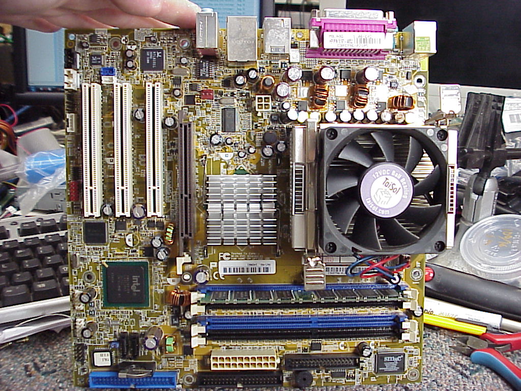

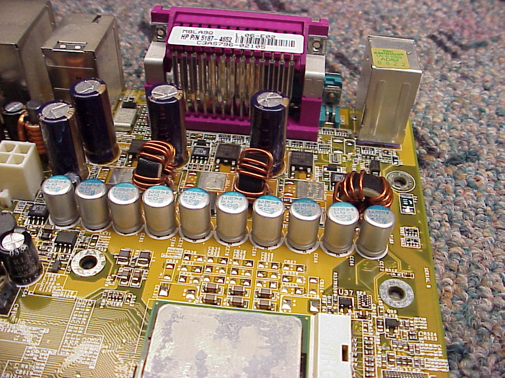

    asus/hp 478 board with blown mcz
    asus built hp board.
    blown 1800@6.3 mcz
    the ones not bulging were open.
    only reason it still ran was the polys were still good.

      Re: asus/hp 478 board with blown mcz
      no.
      its a midtower case.
      no bad fans or power supply although the bestec is getting recapped to eliminate the common +5 stby overshoot.
      seems these boards get hot in the vrm area.
        So i think it's the limit of mcz then.. running in the hot area for years (s478 era), with minimum vents and high heat. Even good caps will fail. And like zandrax said, they were "glued" to the heatsink...
        That's a bit of weakness in design too..
                FJ is slightly better, I think - I haven't seen any blown FJs ever, though there may be quiet dry-out failures around.
                MCZ failures in the VRM area, especially in Prescott boxes with low ventilation, have been known. However, just about any Al electrolytic will probably die in similar conditions (except maybe high-endurance Rubycon ZT (125c), NCC LXF and Nichicon PX - but those will not meet the ultra-low ESR requirements for the Vcore rail). The only viable option remains polymer caps on Vcore.
                                better than, worse than, better than, worse than,,,, AHHHHH.
                                Here is my cheat list.
                                Groupings based on just based on ESR/Ripple.
                                This came from looking at 8x20mm and 10x20mm cans between 820uF and 3300uF.
                                Within a Series ESR changes with CAN SIZE, not with uF.
                                Numbers after Series are ESR for 8x20 | 10x20 mm for that group.
                                HZ, GA ...... .009 | .007
                                MCZ, HN, GC, KZJ ..... .012 | .010-.011
                                FJ, NRSJ, [FL - I THINK. Don't have an 'official' data sheet for FL.] ...... .016 | .013
                                MBZ, WG, KZG, GD, NRSK, HM ....... .018-.021 | .013
                                ZLG, FM, GE ...... .020-.030 | .014-.019
                                HV, NRSH, KZM, KZH ...... .029-.033 | .019-.020
                                ZL, HD, GK, KZE, WX, NRSG ...... .041 | .023
                                ZT (high temp series) ...... .054 | .030
                                KY, HE, YXG, YXH, FK, PA ..... .044-.069 | .035-.046
                                FC, PW ...... .065 | .052
                                NRSX, NRSZ, LXZ, PM ...... .069-.085 | .052-.060
                                Any that look out of sequence or like they overlap aren't and don't.
                                It looks that way without the ripple ratings which I took into account too but I don't wanna write all that out.
                                This isn't a perfect cross reference. (Because there isn't one).
                                Why? - Some given uF/volts in one brand/series may be a different can size in another brand/series and so for that case their ESR/Ripple won't follow the general rule.
                                This list is an aid to know which data sheets are best to look in.
                                You still need to look in the data sheets to cross reference for sure.
                                KC is right.
                                Hot Boxes need poly's to live long (and prosper?)
                                Need to look in data sheets for those too.
                                Some series are rated worse than the better Electrolytics.
