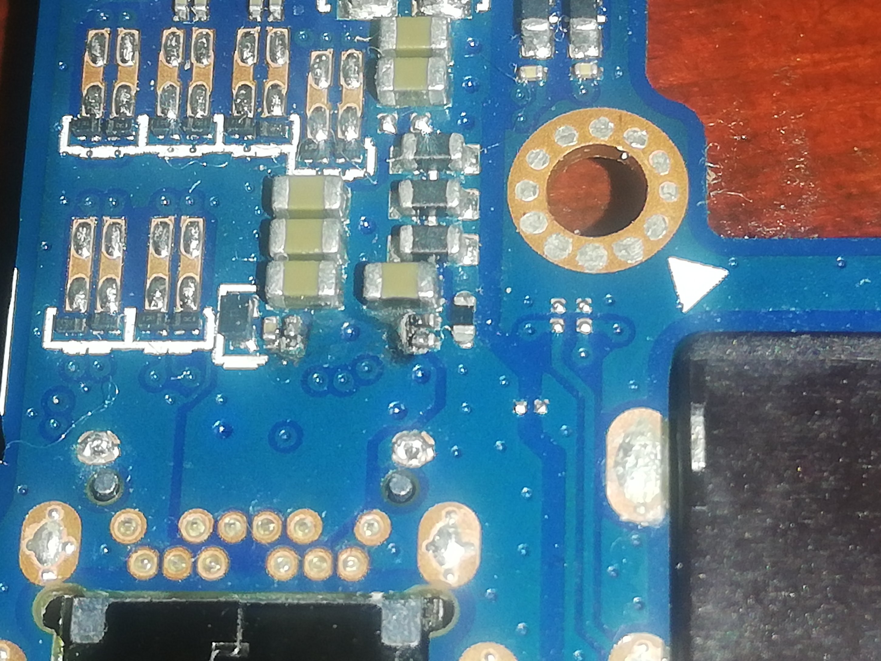

    Greetings friends.
    I was given this nice little laptop and would like to revive it if possible but i'm stuck identifying blown components. I'm very new to the repair game so i'm proceeding very cautiously.
    I don't know the history of this laptop and the donator didn't elaborate what happened but it seems some moisture got into the USB C charge port and the result was what looks like some blown caps. The tell is some gunk inside the USB C port and corrosion on the outside as well as what looks like corrosion around the blown components.
    Any guidance on proceeding or should I keep looking for the schematics?
    If all else fails i can just replace the whole board, they are not too expensive on ali.
    Attached picture of the damage. Just checking all the caps I don't find any shorts on the power board or the motherboard.
    Thanks in advance.

    Remove the shorted cap and measure resistance on all coils to ground, see that usb c port is clean and no damage in the port. Put all values on hd picture . Resistance need to measure without power . And on 200 ohm scale. Put all the values on hd picture.
    Then people can see what be the next step.

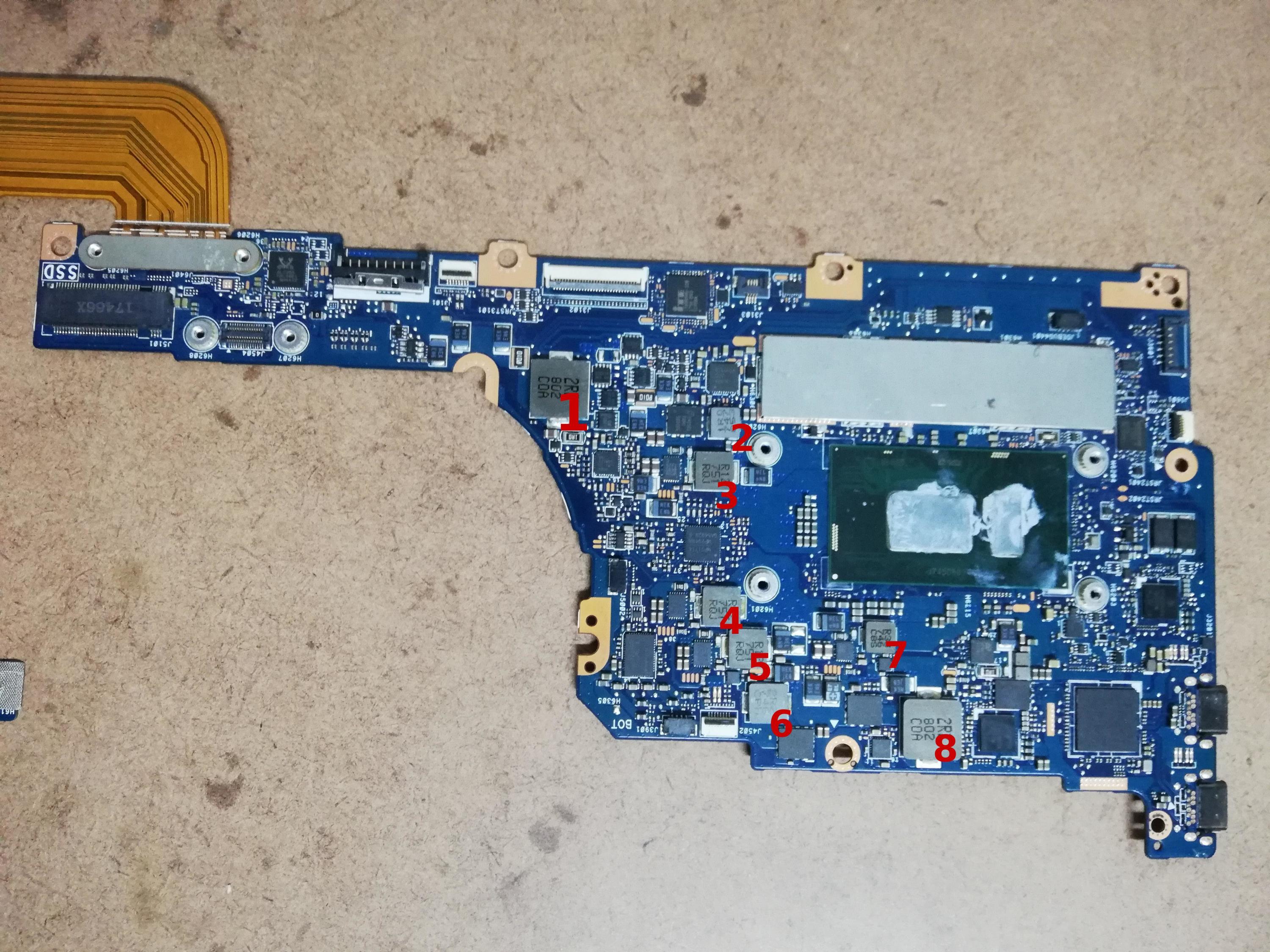

      Here is the requested information. I've connected the IO board with the main board via it's flex cable before taking measurements. There is no coils/inductors on the IO board or none in a package i recognize as one in my limited experience.
      Across the leads my multi meter measures 00.3 on the 200 scale. I had difficulty taking pictures of the measurements since nobody around to hold the camera so i will list the values below and attach a picture with the coils numbered. I can take clearer pictures of any requested area of the board but sadly I only have my phone camera which doesn't take great macro pictures.
      Coils.
      1. Out of range
      2. 1 Ohm
      3. 14.2 Ohm
      4. 8.9 Ohm
      5. 8.9 Ohm
      6. 199.6 Ohm
      7 49.3 Ohm
      8 190.3 Ohm
      Thanks much

        How much resistance you have on main power rail ( current sensor) to ground , resistance values look very low except one coil. Especially the one with 1 ohm. You can use and app calles cosy magnifier and microscope for good close up pictures.

          As for measuring the coil resistance. I'm not sure why but i'm getting different results now. I'd have blamed my multimeter but not all the measurements is different and i've done nothing to the board besides setting it aside until now.
          1. Out of range
          2. 1 Ohm
          3. 10 Ohms
          4. 6.8 Ohms
          5. 6.8 Ohms
          6. Out of range
          7. 20 Ohms
          8. Out of range
          The track under the 1 Ohm coil seems to lead of to the CPU. As I understand it very low resistance is to be expected there?
          Microscope is on my shopping list, i will get one soon but in the mean time I will try the app.

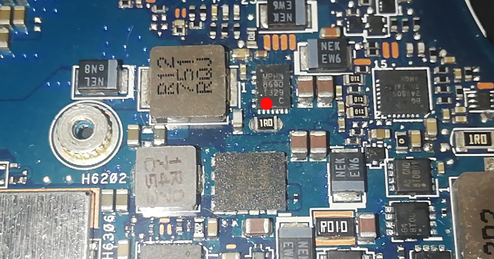

              Hello friends.
              I've have returned to this after taking a detour in trying to fix with a bios flash. My previous assumption was that it is posting but the display is dead but that was wrong.. The blown resistors was on the keyboard connector, not the display connector.
              I beleive i know what the issue is now but it seems Asus doesn't like people repairing so I'm not finding any schematics and the markings on the component I beleive to be faulty doesn't bring up anything significant on google.
              I beleive it's the power management chip for the cpu that is faulty since i'm measuring power on caps leading to it but nothing after the chip on the CPU side. All power rails is present on the board, i'm getting 1.5, 1.8, 3.3, 5, 7.9 and 19 volt
              Could someone perhaps ID this part for me?
              I marked it with a red dot and since my camera isn't the best the numbers on it is as follows.
              "MPHN
              8690
              1329
              C"
              Thanks in advance.

                MPS # MP86901

                  i really don't have the intention to stop the party, but the 1Ohms Coil indicates that the RAM Chips and the Memory Controller inside of the CPU are shorted...
                  I'd check to what controller it is connected with Phase Pin to identify this power rail and make sure what it supplies.

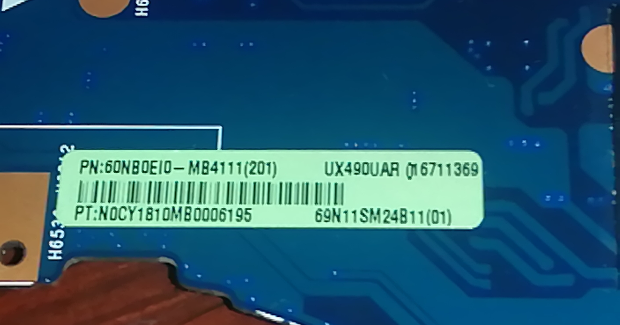

                    Remove this coil from the board and measure the resistances to ground on both pads on the place of this coil.
                    And specify the motherboard marking code. It's marked on the bottom side of the board.

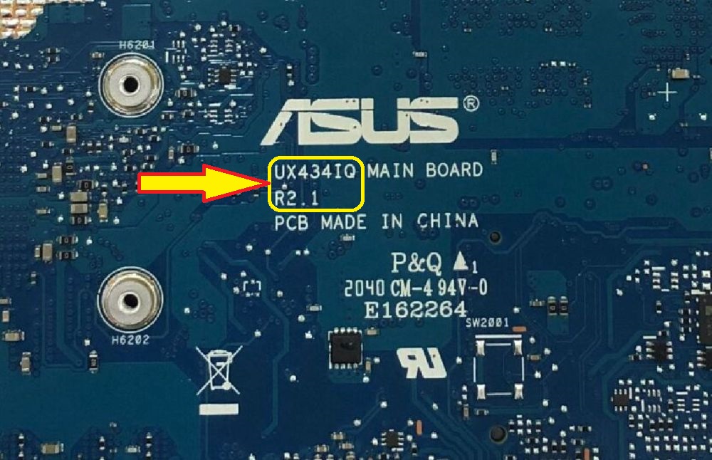

                        Probably not, but first specify the motherboard marking code to make it clear.
                        This sticker is not a motherboard marking code.
                        It should be printed in white directly on the PCB laminate (for example as in the following picture).
