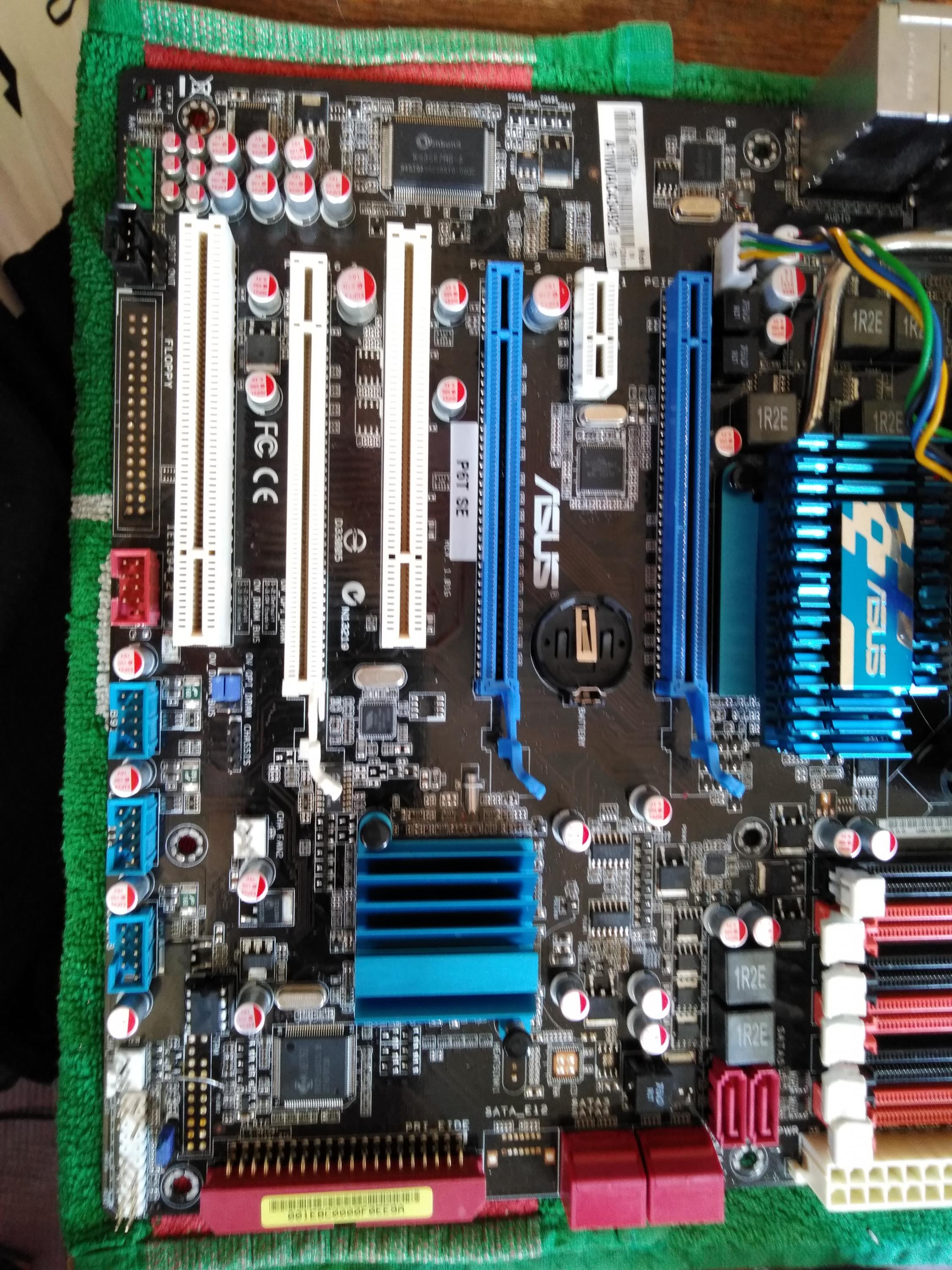

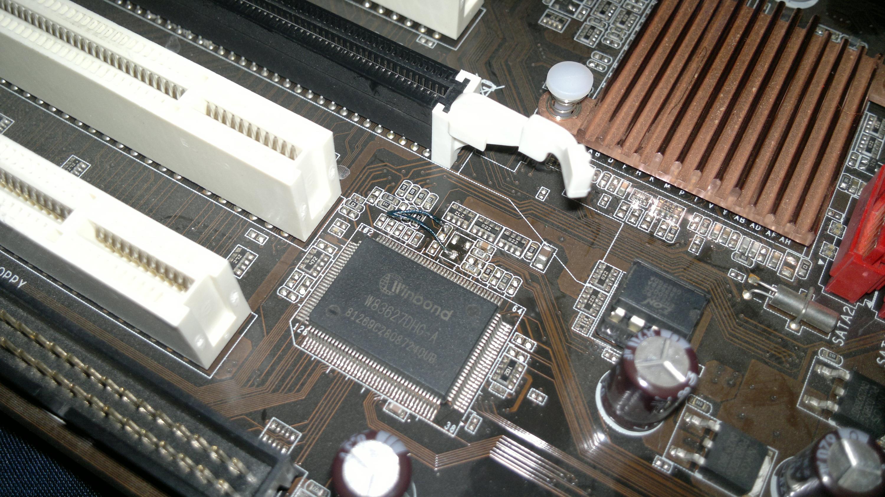

[HOWTO] Fix/Repair "Chassis Intruded Fatal Error System Halted" on Asus P5QL
This is a sticky topic.
  • AvenocturnO
    replied
    Just finished fixing this one. Apparently, this is a common issue with all Asus P5 series boards. I first assumed it's a bad BIOS flash or corrupt CMOS settings, as it would go away once after resetting CMOS, but upon the next reboot it would be there again. Same if i changed any BIOS settings and saved them.
    I read that people have flashed BIOSes to no luck, and someone pointed towards a transistor on another (older) board, so i proceeded to look for a hardware issue. And i found it. See attachments for fix.
    Instructions:
    1. Follow directions in pictures
    2. Clear CMOS
    3. Power board up, redo all BIOS settings
    4. Be happy and have a cold one.
    This should apply to *all* boards that exhibit this behavior, obviously the parts may be in a different location. Follow these directions to find it if your board differs:
    1. Remove jumper cap from chassis intrusion connector (if you're reading this, you already found it's of no use anyway).
    2. With the board powered ON, measure with your voltmeter and find the pin of the chassis intrusion switch connector that has somewhere between 1.7v and 3.3v on it.
    3. Disconnect board from PSU.
    4. Use continuity tester function of your DMM and probe on the SOT23 transistors next to the super IO controller, you should find it beeps on one of them.
    5. Power the board back ON and find a 3.3v supply nearby
    6. Power board OFF, remove transistor, solder drain connection (it's gonna be the single pad, just like it looks in the picture) to 3.3v supply.
    The rest is the same as above.
    I'm also going to tell you what causes the issue to appear in the first place in a follow-up post.
    Thx a lot, working here in an ASUS M5A78L-M/USB3 followin' your guide. These are the points to jumper in my mobo;
    Click image for larger version  Name:	PLACA.jpg Views:	0 Size:	118.9 KB ID:	3594808
    About the "New CPU installed..." issue, I've experienced it in another machine in which a Phenom II 1100T is installed. The previous owner of the processor has blown up a couple of pins (which I'll fix when I have the time), one of those missing pins causes that bios post in my case, beyond that doesn't harm in anything and the machine boots just fine after a couple of seconds. Perhaps in other several cases the same situation could be caused by dust or other debris shorting down the socket, & why not exceeded thermal paste all over the place (I've seen very forgetable scenes...., u surely know 🤣🙈) . Obviously could be caused by bended sockets too, as been said several post above, but a deep clean of the socket could fix the issue in some cases.
    Leave a comment:
  • selekop
    replied
    Re: [HOWTO] Fix/Repair "Chassis Intruded Fatal Error System Halted" on Asus P5QL
    This is what mk I don't understand.
    Last edited by SMDFlea; 12-20-2020, 08:46 AM. Reason: google translate
    Leave a comment:
  • RJARRRPCGP
    replied
    Re: [HOWTO] Fix/Repair "Chassis Intruded Fatal Error System Halted" on Asus P5QL
    Originally posted by mockingbird
    I think this has more to do with a quirk on some Asus motherboards than it has to do with a defective battery circuit. I only have this problem on my P5PE-VM with a certain CPU installed, and I do have an unsupported CPU (Xeon hack) running in this one, so I might just try it with my Q9650 instead.
    Reminds me of my Asus socket 1366 motherboard, using a Radeon RX580, causes to CMOS to get reset, a bad bug!
    If this is to do with video card chronology, looks like for Nvidia, would possibly mean you can't install a later video card than a GeForce GTX 980 series on an Asus pre-UEFI motherboard and possibly a Radeon R9 290X for AMD video cards. (suspect it's the VBIOS)
    Leave a comment:
  • Mister_Natural
    replied
    Re: [HOWTO] Fix/Repair "Chassis Intruded Fatal Error System Halted" on Asus P5QL
    Thanks to this thread and contributors, I finally managed to boot that old Asus at5nm10-i (Atom inside). The chassis-intruded sot-23 diode on this model can be found up to the second 'c' of the label 'clrtc' near an angle of the mobo, if somebody else got one if those relics and need a fast-11-years-repair.
    Leave a comment:
  • mockingbird
    replied
    Re: [HOWTO] Fix/Repair "Chassis Intruded Fatal Error System Halted" on Asus P5QL
    There is a dual diode which feeds power to CMOS memory from two places: 5VSB rail of PSU via 3.3V regulator, and the coin cell. You should trace the circuit going from the coin cell holder until you get to that diode. Either the diode is bad or a leaking battery corroded the trace so the battery simply does not get connected to the circuit.
    It's been some time, finally making some progress with old projects here...
    I found the diode, it tests fine. It comes after a resistor marked 01B (1Kohm) which tests fine. There is a 0.2V forward voltage on both pins.
    I think this has more to do with a quirk on some Asus motherboards than it has to do with a defective battery circuit. I only have this problem on my P5PE-VM with a certain CPU installed, and I do have an unsupported CPU (Xeon hack) running in this one, so I might just try it with my Q9650 instead.
    My question is: What exactly keeps the SPI alive during a no power state when there is no voltage showing on any of the SPI pins... I tested this on a different motherboard, I installed a battery, and I do not see 3V on the VCC pin of the SPI chip. Unless of course there's supposed to always be 3V on VCC, but I don't remember this other motherboard exhibiting this same issue (Asus P5B).
    Leave a comment:
  • loli_roller
    replied
    Re: [HOWTO] Fix/Repair "Chassis Intruded Fatal Error System Halted" on Asus P5QL
    Ok that's a good pic. With the board powered ON, measure voltage at the CHASSIS jumper. Find the pin that has somewhere between 1 volt and 3.3v. Could be anything in that range.
    Once you found it, turn all power OFF and unplug the power supply, and set your multimeter to beeper. One probe goes to that pin you found with the voltage on it, and with the other probe measure on the little 3-pin transistors around the Winbond chip. You should find one that beeps on the single pin at the top, which would be the collector or drain.
    Return with these results and i will try to help you further.
    Hi Th3_uN1Qu3, First of all thanks for posting this solution and keeping this thread alive. I have Asus m5a78l-m lx v2, i dont see any 3 pin transistors near the Super I/O Chip but there is another small chip below the super I/O chip that has those transistors.
    Leave a comment:
  • t8c
    replied
    Re: [HOWTO] Fix/Repair "Chassis Intruded Fatal Error System Halted" on Asus P5QL
    Originally posted by fu-raz
    So, there we go... Thanks for the help Th3_uN1Qu3! Found a new 3.3v point, cleaned the board and reset the CMOS. Everything is working now.
    In the attachment is my final solution for the Asus P5E Deluxe
    Thanks so much. I did the exact same thing on my Asus P5E and it is working perfectly. I used a soldering iron cranked on 420c together with a pre-tinned wire, plus flux on the tinned wire and the surface mount components. I also used electrical tape on neighboring components in order to shield them from heat.
    Leave a comment:
  • SlowRabbit
    replied
    Re: [HOWTO] Fix/Repair "Chassis Intruded Fatal Error System Halted" on Asus P5QL
    I thank the gods for your fix OP
    Found myself a now fixed asus p6t se
    From being a pain in my ass as going for space i got this coolermaster cosmos s fully up and running again.
    Found the mosfet not where i suspected
    Keep em running
    Asus P6T SE fix in pics
    Leave a comment:
    replied
    Re: [HOWTO] Fix/Repair "Chassis Intruded Fatal Error System Halted" on Asus P5QL
    Might help to make your own thread with pictures so we can help you more specifically. If you have a multimeter and know how to use it, finding a way to actually fix the Chassis Intruded issue may actually be easier than messing with BIOS modding.
    Leave a comment:
  • djbordie
    replied
    Re: [HOWTO] Fix/Repair "Chassis Intruded Fatal Error System Halted" on Asus P5QL
    yea that works sort of,
    i modded my bios to a somewhat decent set of defaults.
    the issue is that if i constantly test/reset/test it eventually says chassis intruded.
    however given my situation is a bit different (ground has 5v.) and i could not fix it yet, i am stuck with bios modding.
    nearly impossible to overclock and save the settings, but im getting by..
    Leave a comment:
  • ChaosLegionnaire
    replied
    Re: [HOWTO] Fix/Repair "Chassis Intruded Fatal Error System Halted" on Asus P5QL
    Originally posted by djbordie
    problem with this, is i can not overclock or tune the bios much.
    any thoughts on the matter?
    my asus maximus 2 formula has an option to save the cmos settings to the hard drive. not sure if the asus p5q has that function as well...
    anyway, i heard there are programs that boot to a dos prompt and let u save the cmos settings to a floppy or to the hard drive. everytime u power on the system, boot the cmos program and load the cmos settings saved previously and apply it to the cmos then reboot. saves the trouble of having to constantly change the cmos settings back to what u want them.
    another way is to mod the bios to change the cmos settings defaults but bios modding is a highly advanced skillset and u risk bricking the board if u mod the bios incorrectly.
    however, none of the above options still exempt u from having to set the system clock to the correct time each time u power on. however, there is now internet time server synchronisation so that is not really a big issue.
    Leave a comment:
  • RJARRRPCGP
    replied
    Re: [HOWTO] Fix/Repair "Chassis Intruded Fatal Error System Halted" on Asus P5QL
    Originally posted by Galvatron
    I have P5B Deluxe and there is no LED there. MOBO acts now like it would be bricked, I have two exactly same PSU's, when I connect one nothing happens and when I connect another, blue light comes up(means powered but not running). I can't even get to "chassis intrusion" error anymore, and that's not solved yet.
    Be careful, the P5Bs possibly have bad caps! Likely before Asus regularly used Fujitsu/FP cap caps! Being a P5B, it possibly has bad wet electrolytic caps!
    If wet electrolytic caps, probably Ost. Ost caps are known to sometimes, if not randomly fail.
    Last edited by RJARRRPCGP; 12-22-2018, 07:24 PM.
    Leave a comment:
  • djbordie
    replied
    Re: [HOWTO] Fix/Repair "Chassis Intruded Fatal Error System Halted" on Asus P5QL
    *cant edit my message
    but i also have continuity to more than one transistor, so i decided not to go ahead with the mod. pin 3 (intrusion signal) has continuity to multiple spots on the motherboard.
    a head scratcher for sure
    Leave a comment:
  • djbordie
    replied
    Re: [HOWTO] Fix/Repair "Chassis Intruded Fatal Error System Halted" on Asus P5QL
    great info, thanks for keeping this alive.
    i have an odd one here;
    p5q
    5v showing on the pin4 (ground)
    So i read another tutorial saying if you have voltage on the ground pin, the pins wont jump and put intrusion detection at its normal state. (jumped signal and ground)
    I have 5v on the ground pin...so i tried grounding the signal and ground pin on that header to a psu ground.
    This did not work unfortunately.
    my workaround so far has been no cmos battery, AMIBCP to modify the bios to my liking and just let it restore defaults every boot.
    problem with this, is i can not overclock or tune the bios much.
    any thoughts on the matter?
    Leave a comment:
    replied
    Re: [HOWTO] Fix/Repair "Chassis Intruded Fatal Error System Halted" on Asus P5QL
    Originally posted by drhabib
    Hello
    I have an asus p5kpl/1600 motherboard that show same prompt "Chassis Intruded " and i follow your instruction but problem didn't fixed please help me.
    Thanks.
    Double-check your 3.3V source and make sure it actually has enough current to drive the LPC/SIO chip. I would run a wire from the 3.3V rail directly and hook it up with a 1K-4.7K resistor instead.
    Leave a comment:
  • Th3_uN1Qu3
    replied
    Re: [HOWTO] Fix/Repair "Chassis Intruded Fatal Error System Halted" on Asus P5QL
    There is a dual diode which feeds power to CMOS memory from two places: 5VSB rail of PSU via 3.3V regulator, and the coin cell. You should trace the circuit going from the coin cell holder until you get to that diode. Either the diode is bad or a leaking battery corroded the trace so the battery simply does not get connected to the circuit.
    Leave a comment:
  • mockingbird
    replied
    Re: [HOWTO] Fix/Repair "Chassis Intruded Fatal Error System Halted" on Asus P5QL
    I have a P5K-E that basically ignores the CMOS battery... If power is disconnected from the system completely, it loses all the BIOS settings. Is this also because of a weak transistor?
    Leave a comment:
  • drhabib
    replied
    Re: [HOWTO] Fix/Repair "Chassis Intruded Fatal Error System Halted" on Asus P5QL
    Hello
    I have an asus p5kpl/1600 motherboard that show same prompt "Chassis Intruded " and i follow your instruction but problem didn't fixed please help me.
    Thanks.
    Leave a comment:
  • theoxyd
    replied
    Re: [HOWTO] Fix/Repair "Chassis Intruded Fatal Error System Halted" on Asus P5QL
    Originally posted by theoxyd
    Hi dudes !
    I've only removed the transistor and the motherboard is working perfectly !
    I'm happy because i haved scratched the gate pad when desoldering.......
    Thank's all ;->
    Edit it is on p5kpl-am motherboard
    Leave a comment:
  • theoxyd
    replied
    Re: [HOWTO] Fix/Repair "Chassis Intruded Fatal Error System Halted" on Asus P5QL
    Hi dudes !
    I've only removed the transistor and the motherboard is working perfectly !
    I'm happy because i haved scratched the gate pad when desoldering.......
    Thank's all ;->
    Leave a comment:
  • playit
    ps/2 port keyboard dead ? p5ql pro / ethernet cable light
    by playit
    my system is p5ql pro asus mobo , logitech keyboard ps2 keyboard (more than 10 years) .
    my place use to get some power drip for a second ,at that time , pc shuts and restarts itself , it dint cause any problem till now , once or twice i noticed , i am not sure if it was exactly at power drip time or normal time - both keyboard and ethernet lan stopped working , the keyboard would lose power i mean led lights-num lock caps lock would not stay on , no light at etherbet cable too..then i would restart the pc - then its all good .
    few years back ps2 mouse stopped working, but ps2...
    12-23-2024, 06:05 AM
  • harp
    Howto open schuco rubber plug
    by harp
    Oh, sadly it has no screw...
    What is the proper way to open this so that not destroy rubber?
    I feel if go on forward with not knowledge howto open, that it be broken rubber seal on it....
    12-16-2022, 02:35 PM
  • OKRPKCOMP
    B85m-e rev 1.02 chassis intrude error
    by OKRPKCOMP
    Asus board B85M-E bios is ok, motherboard is ok, everything is fine but i am facing this error at startup
    Chassis intrude,pls check yours system
    Fatal error, system halted
    Remember, there is nothing in bios setup to disable chassis error. Anybody can help me to solve this prob
    Thanks in advance...
    07-20-2022, 10:12 AM
  • vishal24
    Lenovo ideacenter B320
    by vishal24
    I m Having Lenovo Ideacenter B320 all in one.
    when i Press F1 for BIOS, Asking for password. after 3 times wrong password, give error Fatal Error System Halted.
    i forgot my bios password.
    08-10-2021, 03:18 AM
  • angelos
    LG 42" Plasma TV - Howto invoke AUtO GEN?
    by angelos
    I got in this beast of a tv of which i am needing advice on how to access the AUTO GEN function so that i can test if my main board is perhaps faulty.
    There is a 4 pin plug on the plasma control board but i don't know what to do there and i cannot find any reference on the web to it.
    I have added photos to jar your memories...
    This is PDP42V8 chassis.
    Any suggestions would be greatly appreciated.
    Angelos...
    06-07-2020, 10:10 AM
