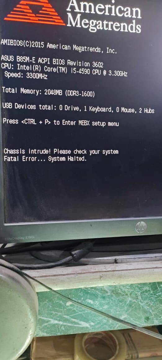

    Asus board B85M-E bios is ok, motherboard is ok, everything is fine but i am facing this error at startup
    Chassis intrude,pls check yours system
    Fatal error, system halted
    Remember, there is nothing in bios setup to disable chassis error. Anybody can help me to solve this prob
    Thanks in advance

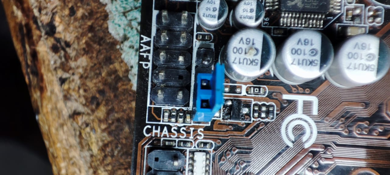

              It isn`t a bios problem,it could be a bad transistor,its next to the blue jumper.
              A similar problem on an old asus board here https://www.badcaps.net/forum/showthread.php?t=32502

                Re: B85m-e rev 1.02 chassis intrude error
                Problem solved
                There was 3.3 volt missing from chassis jumper to nearly existence 10k
