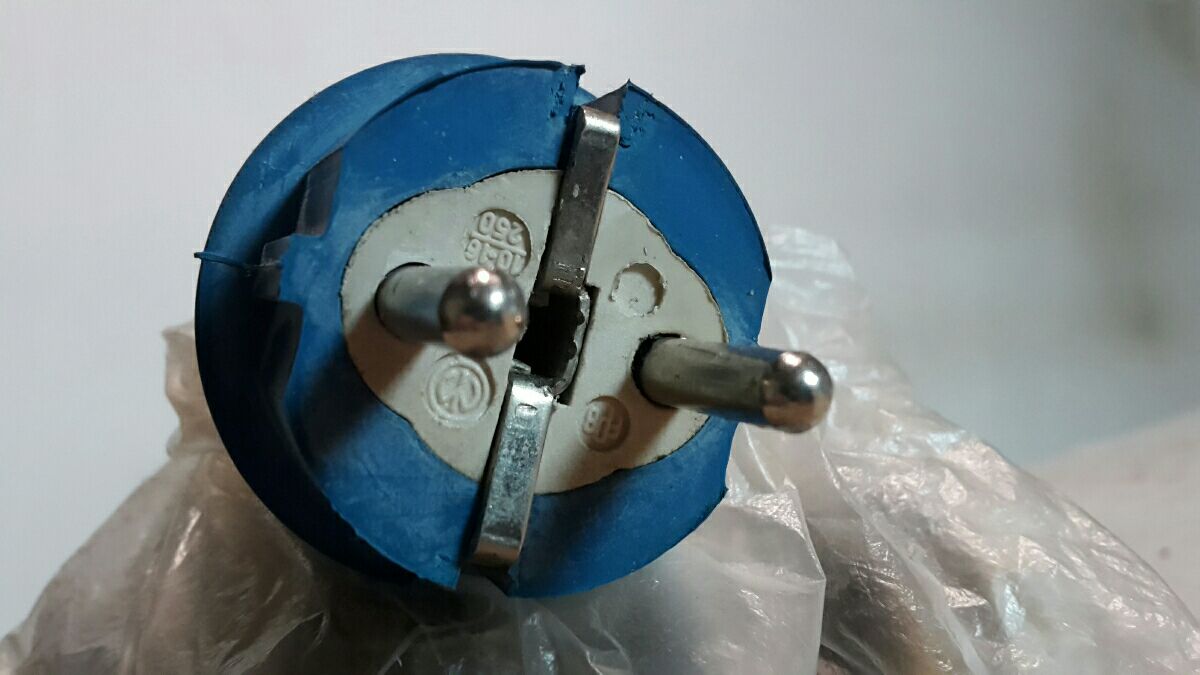

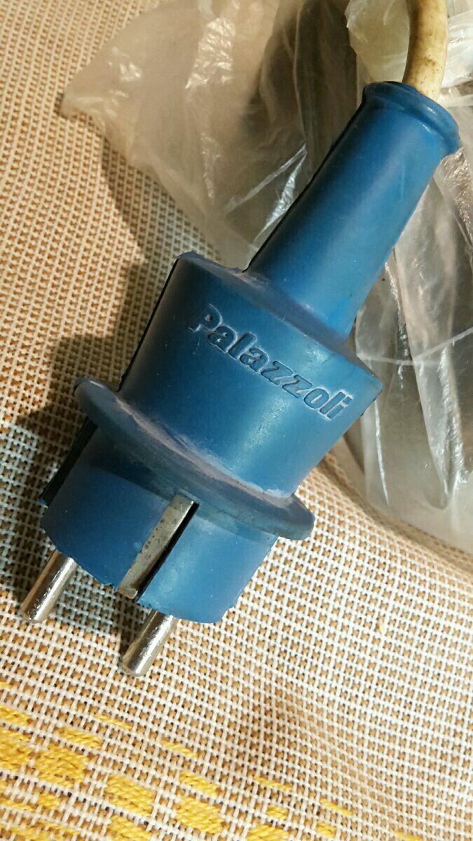

    Oh, sadly it has no screw...
    What is the proper way to open this so that not destroy rubber?
    I feel if go on forward with not knowledge howto open, that it be broken rubber seal on it.

    it looks like it was molded over the cable & core
    maybe if the earth can be unclipped from the center you could pull out the core

      Cable is not original (it is gap between), it is some diy transformer from scratch...
      I try to pull ground earth pin, he is moving but it stuck on position.
      I try to push into hole, on side, up down anywhere, but nothing move nor ground pin deatach. So if some know the trick, or video showing that, I waiting

        I haven’t seen this style of plug coming apart yet. Plus if the is a rubber core sticking into a rubber housing, good luck getting this apart.

          The core of connector (light color) is of standard hard plastic like usual, I suppose there is inside a standard way to connect wire with screws. Rubber over core is can move, but not deatach till earth pin is there (I hope so it is not broken in this process, because it is only way to open).
          When I knew the principe what must be done to dossasemble that plug, I try my best, maybe is some broken latch inside or somehow stuck...

            logically the inner core must have a lip or barb to lock into the rubber outer part
            maybe just prying the core out with small screwdrivers will work

              Yes it has big inner lip, but it also locked in place with earth pin who overlaping rubber on both side that cannot acidently slip out.
              Without removing the earth pin there is no chanse to stretch rhe rubber out of this inner lip.
              I think that this tipe of plug is common on outdor aplication around the house, or in garage, some watter and force (smash) resistance is characteristic for rubber, but I see that is like unique nobody know how to get in...
              Before I post here, I was thrully try to pry this plug, with all tools and technique... but I know where to stop. You see that earth pin is bent, and it is time when I stop, and ask here, I beleave ther is a simple catch how to open this, but it is not intuitive.

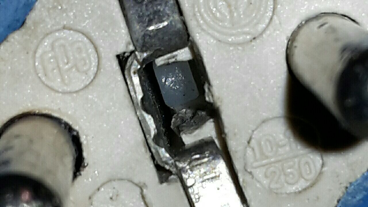

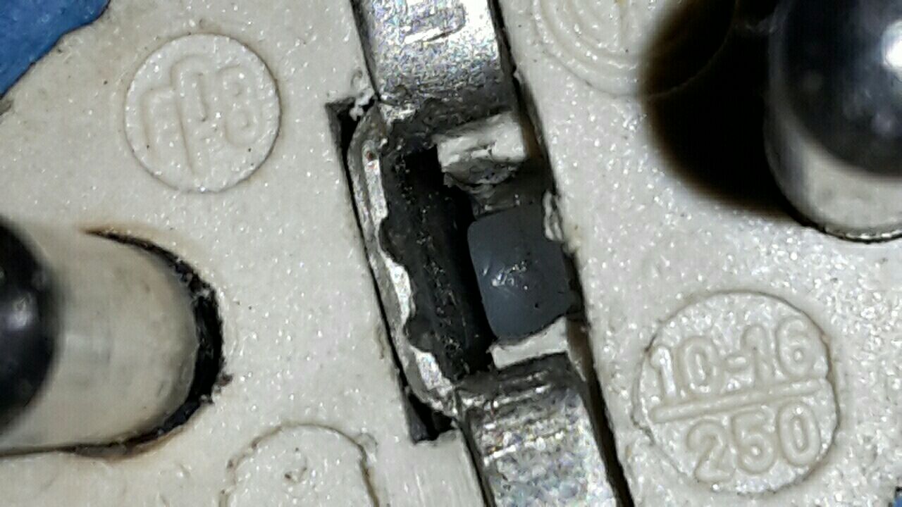

                Inside the hole there is a white rounded plastic thing, that is not connected on either side (I can put screwdriver by it side), but nothing happens, I try to pull up earth pin...
                Try to push it, also nothing... cant grab it or hook it, it is deep in hole.

                  i think you can pull the core out without touching the earth contact.
                  the stuff in the hole is glue - probably to keep water out

                    Even if you get the earth clips out, what are you hoping to pull out the end? The core/transformer looks bigger than the opening.
                    The earth pin looks like a latch or glue is down there. I would use a dental pick to try get it out, or drill it to see what it is.

                      on a schuko the earth is duel standard
                      in france the socket has a pin that goes into that hole,
                      in germany the side clips are earth
                      that contact assembly is connected to the earth wire
