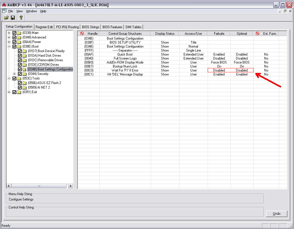

[HOWTO] Fix/Repair "Chassis Intruded Fatal Error System Halted" on Asus P5QL
This is a sticky topic.
    replied
    Re: [HOWTO] Fix/Repair "Chassis Intruded Fatal Error System Halted" on Asus P5QL
    Originally posted by drag
    But can i just take one of the orange wires? I think that all power supply wires must be connect to motherboard?
    I'm not sure I understand what you mean by this.
    Just use your multimeter to find a 3.3V source near the ATX connector and run a wire from that to the Drain of the Chassis Intrusion MOSFET. Make sure the Gate of that MOSFET is grounded, otherwise that MOSFET will try to pull 3.3V rail to ground and *will* burn out.
    Leave a comment:
  • drag
    replied
    Re: [HOWTO] Fix/Repair "Chassis Intruded Fatal Error System Halted" on Asus P5QL
    Originally posted by momaka
    I don't know if 5V would be too much - that depends on the LPC SIO chip.
    But just take 3.3V from one of the orange wires on the PSU connector - that's 3.3V for sure, so it should work fine.
    I was thinking that too. But can i just take one of the orange wires? I think that all power supply wires must be connect to motherboard?
    Leave a comment:
    replied
    Re: [HOWTO] Fix/Repair "Chassis Intruded Fatal Error System Halted" on Asus P5QL
    Originally posted by drag
    I start PC and motherboard working fine! Its not broken afterall
    I not found 3.3.v supply but I found 5v. supply. Is 5v supply be good enough or is it too much?
    I don't know if 5V would be too much - that depends on the LPC SIO chip.
    But just take 3.3V from one of the orange wires on the PSU connector - that's 3.3V for sure, so it should work fine.
    Originally posted by drag
    And motherboard battery has 3v. Can I use it somehow?
    No, don't use motherboard battery for anything.
    Leave a comment:
  • drag
    replied
    Re: [HOWTO] Fix/Repair "Chassis Intruded Fatal Error System Halted" on Asus P5QL
    Originally posted by momaka
    Hard to give you more advice how to repair it without pictures and more info. Need to know what you shorted, what the motherboard does now, etc.
    Worst case, put it on eBay for sale as "parts or not working" and mention the problem.
    I start PC and motherboard working fine! Its not broken afterall
    I not found 3.3.v supply but I found 5v. supply. Is 5v supply be good enough or is it too much?
    And motherboard battery has 3v. Can I use it somehow?
    I think i can remove battery case from old motherboard and connect it straight to Asus P6T SE chassis
    intrusion connector.
    Last edited by drag; 06-20-2016, 08:17 AM.
    Leave a comment:
  • mockingbird
    replied
    Re: [HOWTO] Fix/Repair "Chassis Intruded Fatal Error System Halted" on Asus P5QL
    Originally posted by momaka
    According to our Romanian friend, Th3_uN1Qu3 , this should be another transistor, just like with the chassis intrusion .
    That is post #5 in the first page. Linked here for convenience:
    https://www.badcaps.net/forum/showpo...86&postcount=5
    Now, as far as how to find that transistor... I haven't a clue! But probably some SOT-23 transistor either near LPC Super IO chip or perhaps even CPU socket itself.
    Thank you my friend. He gave great instructions on finding the chassis intrusion detection transistor, so it should be located adjacent to it, but you're right, personally, I have no way to be certain at the moment.
    So I came up with an easier solution (Will not work with chassis intrusion, but should with "New CPU detected"):
    So hardwiring that in there should bypass the message permanently. And I also disabled "Express Gate", because it also seems to re-trigger it (But all the other options stay put IIRC).
    Leave a comment:
    replied
    Re: [HOWTO] Fix/Repair "Chassis Intruded Fatal Error System Halted" on Asus P5QL
    Originally posted by mockingbird
    Does anyone know how to fix "New CPU is inserted in your system !"?
    According to our Romanian friend, Th3_uN1Qu3 , this should be another transistor, just like with the chassis intrusion .
    Extra bit of fun info: The transistor right next to it will make the board report "New CPU installed!" every time until you clear CMOS, if you touch it or probe it. But at least it lets you boot the system.
    That is post #5 in the first page. Linked here for convenience:
    https://www.badcaps.net/forum/showpo...86&postcount=5
    Now, as far as how to find that transistor... I haven't a clue! But probably some SOT-23 transistor either near LPC Super IO chip or perhaps even CPU socket itself.
    Leave a comment:
  • mockingbird
    replied
    Re: [HOWTO] Fix/Repair "Chassis Intruded Fatal Error System Halted" on Asus P5QL
    This guy claims it's caused by a substandard Asus socket:
    Might just try tightening the retention bracket... If not, I should have some motherboards around here with some spare sockets...
    Leave a comment:
  • mockingbird
    replied
    Re: [HOWTO] Fix/Repair "Chassis Intruded Fatal Error System Halted" on Asus P5QL
    Does anyone know how to fix "New CPU is inserted in your system !"?
    This is on an Asus M4A78LT-M-LE
    This happens after a hard power off with the PSU switched off and a power loss to the motherboard. The CMOS battery has been replaced with a fresh Duracell to no avail.
    Leave a comment:
    replied
    Re: [HOWTO] Fix/Repair "Chassis Intruded Fatal Error System Halted" on Asus P5QL
    Originally posted by drag
    No, I search 3.3v supply but not find it and then accidentally touch something
    and there was short and motherboard are broken...
    Maybe someone know how to repair it.
    Hard to give you more advice how to repair it without pictures and more info. Need to know what you shorted, what the motherboard does now, etc.
    Worst case, put it on eBay for sale as "parts or not working" and mention the problem.
    Leave a comment:
  • drag
    replied
    Re: [HOWTO] Fix/Repair "Chassis Intruded Fatal Error System Halted" on Asus P5QL
    Originally posted by momaka
    And? Did you get the fix to work?
    No, I search 3.3v supply but not find it and then accidentally touch something
    and there was short and motherboard are broken...
    Maybe someone know how to repair it.
    Last edited by drag; 05-29-2016, 02:10 PM.
    Leave a comment:
    replied
    Re: [HOWTO] Fix/Repair "Chassis Intruded Fatal Error System Halted" on Asus P5QL
    Originally posted by drag
    Finally after 2 hours intensive searching I find the beeping transistor on Asus P6T SE near the BIOS chip!!!!
    And? Did you get the fix to work?
    Leave a comment:
  • drag
    replied
    Re: [HOWTO] Fix/Repair "Chassis Intruded Fatal Error System Halted" on Asus P5QL
    Finally after 2 hours intensive searching I find the beeping transistor on Asus P6T SE near the BIOS chip!!!!
    Leave a comment:
    replied
    Re: [HOWTO] Fix/Repair "Chassis Intruded Fatal Error System Halted" on Asus P5QL
    Originally posted by drag
    Chassis intrusion jumper has (propably all motherboards) +5vsb first, then empty, then chassis signal and then ground.
    The chassis signal should be tied directly to the gate on a small SOT-23 transistor somewhere on the board either near the Super IO chip or near the chassis intrusion connector itself. Find that transistor, remove it, and tie the Drain pad to 3.3V rail. The video shows to do that without removing the transistor and typing the Drain to 5VSB. But ultimately, you get the same results. The only problem with the video is if that transistor somehow got turned ON while you have the Drain pin tied to 3.3/5V - then that would cause the transistor to smoke.
    Leave a comment:
  • drag
    replied
    Re: [HOWTO] Fix/Repair "Chassis Intruded Fatal Error System Halted" on Asus P5QL
    Chassis intrusion jumper has (propably all motherboards) +5vsb first, then empty, then chassis signal and then ground.
    Th3_uN1Qu3 instructions say that "With the board powered ON, measure with your voltmeter and find the pin of the chassis intrusion switch connector that has somewhere between 1.7v and 3.3v on it.
    Power the board back ON and find a 3.3v supply nearby"
    I wonder that video shows +5vsb to supply?
    Leave a comment:
    replied
    Re: [HOWTO] Fix/Repair "Chassis Intruded Fatal Error System Halted" on Asus P5QL
    Originally posted by drag
    I have Asus P6T SE. Do you know how to do this repair for Asus P6T SE?
    Not specifically, since I don't have this motherboard.
    According to one comment in the above video, the fix worked for a P6T, so my guess is this should be similar for the P6T SE as well. Thus just do what the guy in the video did - find the Chassis Intrusion jumper and see which transistor on the board it connects to. From there you can either follow the video or Th3_uN1Qu3's advice.
    If that doesn't help, you can always post pictures of your board here and we can try to troubleshoot that with you .
    Leave a comment:
  • drag
    replied
    Re: [HOWTO] Fix/Repair "Chassis Intruded Fatal Error System Halted" on Asus P5QL
    Originally posted by momaka
    I think it is somewhat similar to Th3_uN1Qu3's fix, so probably yes. Unfortunately, I don't speak Spanish very well (actually very little, though I was able to understand some parts of the video), so I can't tell you with 100% confidence that this video shows a good repair or not. But I am guessing it probably does. Hope this helps.
    I have Asus P6T SE. Do you know how to do this repair for Asus P6T SE?
    Leave a comment:
    replied
    Re: [HOWTO] Fix/Repair "Chassis Intruded Fatal Error System Halted" on Asus P5QL
    Originally posted by drag
    I think it is somewhat similar to Th3_uN1Qu3's fix, so probably yes. Unfortunately, I don't speak Spanish very well (actually very little, though I was able to understand some parts of the video), so I can't tell you with 100% confidence that this video shows a good repair or not. But I am guessing it probably does. Hope this helps.
    Leave a comment:
  • drag
    replied
    Re: [HOWTO] Fix/Repair "Chassis Intruded Fatal Error System Halted" on Asus P5QL
    Is this good fix/repair?
    https://www.youtube.com/watch?v=x2cJbefy1Fc
    Leave a comment:
  • fullmetaljkt
    replied
    Re: [HOWTO] Fix/Repair "Chassis Intruded Fatal Error System Halted" on Asus P5QL
    Hello ,
    forgive me again .
    I found two transistors on the motherboard .
    Which of the two I have to remove ?
    Thank you very much for your very important assistance
    Last edited by fullmetaljkt; 06-20-2015, 07:51 AM.
    Leave a comment:
  • Th3_uN1Qu3
    replied
    Re: [HOWTO] Fix/Repair "Chassis Intruded Fatal Error System Halted" on Asus P5QL
    You do not need to add an extra power supply, you will find it on the board. Worst case take it from an orange wire of the PSU, although that will be kinda long. But it will work like that too.
    Leave a comment:
  • playit
    ps/2 port keyboard dead ? p5ql pro / ethernet cable light
    by playit
    my system is p5ql pro asus mobo , logitech keyboard ps2 keyboard (more than 10 years) .
    my place use to get some power drip for a second ,at that time , pc shuts and restarts itself , it dint cause any problem till now , once or twice i noticed , i am not sure if it was exactly at power drip time or normal time - both keyboard and ethernet lan stopped working , the keyboard would lose power i mean led lights-num lock caps lock would not stay on , no light at etherbet cable too..then i would restart the pc - then its all good .
    few years back ps2 mouse stopped working, but ps2...
    12-23-2024, 06:05 AM
  • harp
    Howto open schuco rubber plug
    by harp
    Oh, sadly it has no screw...
    What is the proper way to open this so that not destroy rubber?
    I feel if go on forward with not knowledge howto open, that it be broken rubber seal on it....
    12-16-2022, 02:35 PM
  • OKRPKCOMP
    B85m-e rev 1.02 chassis intrude error
    by OKRPKCOMP
    Asus board B85M-E bios is ok, motherboard is ok, everything is fine but i am facing this error at startup
    Chassis intrude,pls check yours system
    Fatal error, system halted
    Remember, there is nothing in bios setup to disable chassis error. Anybody can help me to solve this prob
    Thanks in advance...
    07-20-2022, 10:12 AM
  • vishal24
    Lenovo ideacenter B320
    by vishal24
    I m Having Lenovo Ideacenter B320 all in one.
    when i Press F1 for BIOS, Asking for password. after 3 times wrong password, give error Fatal Error System Halted.
    i forgot my bios password.
    08-10-2021, 03:18 AM
  • angelos
    LG 42" Plasma TV - Howto invoke AUtO GEN?
    by angelos
    I got in this beast of a tv of which i am needing advice on how to access the AUTO GEN function so that i can test if my main board is perhaps faulty.
    There is a 4 pin plug on the plasma control board but i don't know what to do there and i cannot find any reference on the web to it.
    I have added photos to jar your memories...
    This is PDP42V8 chassis.
    Any suggestions would be greatly appreciated.
    Angelos...
    06-07-2020, 10:10 AM
