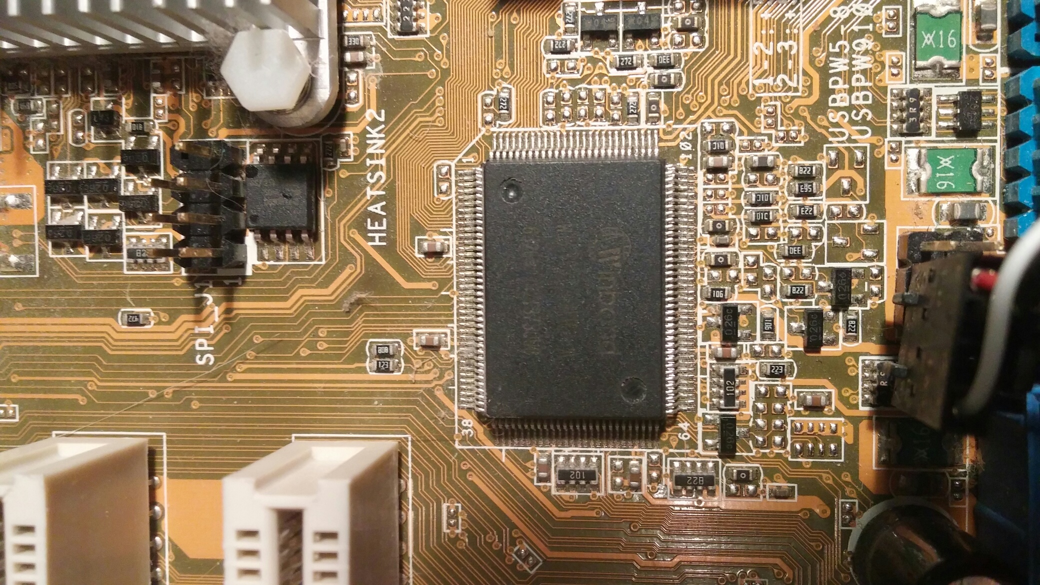

Re: [HOWTO] Fix/Repair "Chassis Intruded Fatal Error System Halted" on Asus P5QL
ok , I'll try to do it as well as you say .. These components are very small . I have not many possibilities ! I 'll tell you what will happen to the motherboard !
For the current regulation to 3.3v , I can use this :
" STEP DOWN LM2596S 5V power supply 12V 2A " ?
http://www.ebay.it/itm/Convertitore-...item3ce7305eb1
I wait for your opinion before starting work
 Thanks a lot!
	[HOWTO] Fix/Repair "Chassis Intruded Fatal Error System Halted" on Asus P5QL
	This is a sticky topic.
Re: [HOWTO] Fix/Repair "Chassis Intruded Fatal Error System Halted" on Asus P5QL
That is a SOT-23 transistor and it looks like so: http://gtsemic.com/uploadfile/20140807140911319.jpg
You see how it has 3 pins. Two at the bottom and 1 at the top. You need to remove it (use a hot air station, you may damage the board if you try to remove it with the iron) and solder a wire from a 3.3v supply to where the pin at the top went.
Here is how you find a 3.3v supply in that area. With the board connected to a PSU and powered on, take your multimeter and measure on the capacitors around the Winbond chip (small brown things). Black probe of multimeter to ground (computer case or any black wire from connectors of PSU), and touch red probe to each of the small brown capacitors.
You need to find a 3.3 volt reading on your multimeter. When you have found it, power the board off, solder a thin wire from that point and take it to where the top pin of that transistor was. Then clear CMOS again, power the board back on and be happy.
					Last edited by Th3_uN1Qu3; 06-17-2015, 12:47 PM.Leave a comment:
Re: [HOWTO] Fix/Repair "Chassis Intruded Fatal Error System Halted" on Asus P5QL
Ok, better reading the instructions I found the transistor to be deleted.
It is valid as I pictured?
Now, you could tell me how to complete the task?
Unfortunately I can not interpret the instructions.
Thanks a lot!Last edited by fullmetaljkt; 06-15-2015, 07:00 AM.Leave a comment:
Re: [HOWTO] Fix/Repair "Chassis Intruded Fatal Error System Halted" on Asus P5QL
Th3_uN1Qu3 Hello, congratulations for howto.
Even in Italy we need your help. :-)
I enclose a picture of my motherboard.
Can you tell me what to do to fix "Chassis intruted ...!" ?
I am deeply grateful to you!
Thanks a lot!Leave a comment:
Re: [HOWTO] Fix/Repair "Chassis Intruded Fatal Error System Halted" on Asus P5QL
Will try and find a solution for you in a few days. Until then, please post some pictures of your board.Leave a comment:
Re: [HOWTO] Fix/Repair "Chassis Intruded Fatal Error System Halted" on Asus P5QL
i have an asus p5kpl-cm with the same problem, i got no problem locating the transistors but it seems did n´t work the same way you described in this post.for example i dont have any voltage measure at the chasis pins, there is three pins , one with 5 v and the others have nothing.maybe is that my board is not like you find the fix.i even try to find a beep of the meter trying all pins with all transistors near winbond chip,and i got no condictivity in any of them i find just a litlle pas of current but with resistance in all transistors , please help if there is a way you can help me i´ll be gratefulLeave a comment:
Re: [HOWTO] Fix/Repair "Chassis Intruded Fatal Error System Halted" on Asus P5QL
thanks man u save my boardJust finished fixing this one. Apparently, this is a common issue with all Asus P5 series boards. I first assumed it's a bad BIOS flash or corrupt CMOS settings, as it would go away once after resetting CMOS, but upon the next reboot it would be there again. Same if i changed any BIOS settings and saved them.
I read that people have flashed BIOSes to no luck, and someone pointed towards a transistor on another (older) board, so i proceeded to look for a hardware issue. And i found it. See attachments for fix.
Instructions:- Follow directions in pictures
 - Clear CMOS
 - Power board up, redo all BIOS settings
 - Be happy and have a cold one.
This should apply to *all* boards that exhibit this behavior, obviously the parts may be in a different location. Follow these directions to find it if your board differs:
- Remove jumper cap from chassis intrusion connector (if you're reading this, you already found it's of no use anyway).
 - With the board powered ON, measure with your voltmeter and find the pin of the chassis intrusion switch connector that has somewhere between 1.7v and 3.3v on it.
 - Disconnect board from PSU.
 - Use continuity tester function of your DMM and probe on the SOT23 transistors next to the super IO controller, you should find it beeps on one of them.
 - Power the board back ON and find a 3.3v supply nearby
 - Power board OFF, remove transistor, solder drain connection (it's gonna be the single pad, just like it looks in the picture) to 3.3v supply.
The rest is the same as above.
I'm also going to tell you what causes the issue to appear in the first place in a follow-up post.
					Leave a comment:
Re: [HOWTO] Fix/Repair "Chassis Intruded Fatal Error System Halted" on Asus P5QL
thx for some knowledge. it'll be handy
					Leave a comment:
Re: [HOWTO] Fix/Repair "Chassis Intruded Fatal Error System Halted" on Asus P5QL
Same thing with the 1k resistor
					Leave a comment:
Re: [HOWTO] Fix/Repair "Chassis Intruded Fatal Error System Halted" on Asus P5QL
That's interesting. No voltage on the chassis intrusion pin, and a fairly low resistance to ground means it should be in the "closed" state, so a chassis intruded error should not pop up.
But maybe your board is configured the other way round. Put a 1k resistor from that 5 volt pin to the chassis signal pin. See if it does anything different.Leave a comment:
Re: [HOWTO] Fix/Repair "Chassis Intruded Fatal Error System Halted" on Asus P5QL
Hi, thanks for your reply, I'm happy to see you on this thread after all this time
Yes I already tried to clear cmos, change battery, clean everything, etc.
The resistance at chassis pin is 1420 ohmsLeave a comment:
Re: [HOWTO] Fix/Repair "Chassis Intruded Fatal Error System Halted" on Asus P5QL
You are supposed to have some voltage on the chassis signal pin. Measure resistance between that pin and ground. The 5 volts is coming from the 5vsb rail of your PSU, and has nothing to do with the issue.
I take it you already tried clearing CMOS and cleaning the dust off the mainboard?Leave a comment:
Re: [HOWTO] Fix/Repair "Chassis Intruded Fatal Error System Halted" on Asus P5QL
Hi, I have the same problem here, asus P5B-E,
worked fine for years,
I read the thread over and over, just to make sure, but I still have question,
I don't have any voltage at the pin #2 is this normal?
Manual say:
-+5VSB_MB,
-Empty
-Chassis signal
-Ground
Is the order 4-3-2-1. +5V being pin 4 or is thie 1-2-3-4, Ground being pin 4?
Anyways I only have voltage at the "+5V" pin, voltage being 4.9V, way more that than the "1.7v and 3.3v" Is this normal? I'm I suppose to have voltage on an other pin (Chassis signal)?
Also there's not transistor with that voltage near my i/O controller, though I have two transistors at 3.3V. (top righ on the pictures), And one "hidden" transistor between the battery and the panel connector (not visible on the picture) at 3.3V
ThanksLeave a comment:
Re: [HOWTO] Fix/Repair "Chassis Intruded Fatal Error System Halted" on Asus P5QL
We can't magically point which transistors needs to be removed. You'll need a multimeter and do a bit of detective work yourself. Read the entire thread, and if still unsure, post pictures of the super IO chip on your board (usually Winbond or ITE if I am not mistaken). Also, point out where your Chassis Intrusion jumper is.Last edited by momaka; 02-04-2015, 10:11 AM.Leave a comment:
Re: [HOWTO] Fix/Repair "Chassis Intruded Fatal Error System Halted" on Asus P5QL
Hey Bro can you help me, i have problem whit my mobo?Leave a comment:
Re: [HOWTO] Fix/Repair "Chassis Intruded Fatal Error System Halted" on Asus P5QL
hello, i have same problem whit my mobo, i touch jumper and the issue show's.
I have mainboard p5q deluxe and i don't know how to fix this problem, please help me i buy this mobo 1 mouth ago and now not work :'( !Leave a comment:
Re: [HOWTO] Fix/Repair "Chassis Intruded Fatal Error System Halted" on Asus P5QL
@Th3_uN1Qu3 thanks for replying I really appreciates that.
Which transistor are you talking about? I will be very helpful if you point it for me on a picture or something.
Thanks again, Im waiting for your answer.Leave a comment:
Re: [HOWTO] Fix/Repair "Chassis Intruded Fatal Error System Halted" on Asus P5QL
good job!
welcome to badcaps!
Hi Th3_uN1Qu3 !
Following your directions I was able to boot an Asus NCT-D motherboard, thank you.
With power ON has been measured 0.7 voltage on pin 2 of chassis intrusion detection jumper, found the same voltage on the drain of one of the seven SOT-23 NPN transistors and the same on a pin of the VIA IO chip. After the complete removal of the transistor I've found zero voltage on the IO chip pin. After three days of intense benchmarking no problems still has been found !
 to Th3_uN1Qu3 !!!Leave a comment:
Re: [HOWTO] Fix/Repair "Chassis Intruded Fatal Error System Halted" on Asus P5QL
Hi Th3_uN1Qu3 !
Following your directions I was able to boot an Asus NCT-D motherboard, thank you.
With power ON has been measured 0.7 voltage on pin 2 of chassis intrusion detection jumper, found the same voltage on the drain of one of the seven SOT-23 NPN transistors and the same on a pin of the VIA IO chip. After the complete removal of the transistor I've found zero voltage on the IO chip pin. After three days of intense benchmarking no problems still has been found !
 to Th3_uN1Qu3 !!!
					Leave a comment:
			by playitmy system is p5ql pro asus mobo , logitech keyboard ps2 keyboard (more than 10 years) .
my place use to get some power drip for a second ,at that time , pc shuts and restarts itself , it dint cause any problem till now , once or twice i noticed , i am not sure if it was exactly at power drip time or normal time - both keyboard and ethernet lan stopped working , the keyboard would lose power i mean led lights-num lock caps lock would not stay on , no light at etherbet cable too..then i would restart the pc - then its all good .
few years back ps2 mouse stopped working, but ps2... -
			by harpOh, sadly it has no screw...
What is the proper way to open this so that not destroy rubber?
I feel if go on forward with not knowledge howto open, that it be broken rubber seal on it.... -
			by OKRPKCOMPAsus board B85M-E bios is ok, motherboard is ok, everything is fine but i am facing this error at startup
Chassis intrude,pls check yours system
Fatal error, system halted
Remember, there is nothing in bios setup to disable chassis error. Anybody can help me to solve this prob
Thanks in advance...-
							Channel: BIOS & Schematic Requests!
			by vishal24I m Having Lenovo Ideacenter B320 all in one.
when i Press F1 for BIOS, Asking for password. after 3 times wrong password, give error Fatal Error System Halted.
i forgot my bios password.-
							Channel: BIOS & Schematic Requests!
			by angelosHi all,
I got in this beast of a tv of which i am needing advice on how to access the AUTO GEN function so that i can test if my main board is perhaps faulty.
There is a 4 pin plug on the plasma control board but i don't know what to do there and i cannot find any reference on the web to it.
I have added photos to jar your memories...
This is PDP42V8 chassis.
Any suggestions would be greatly appreciated.
Angelos... - Loading...
 - No more items.
Leave a comment:
