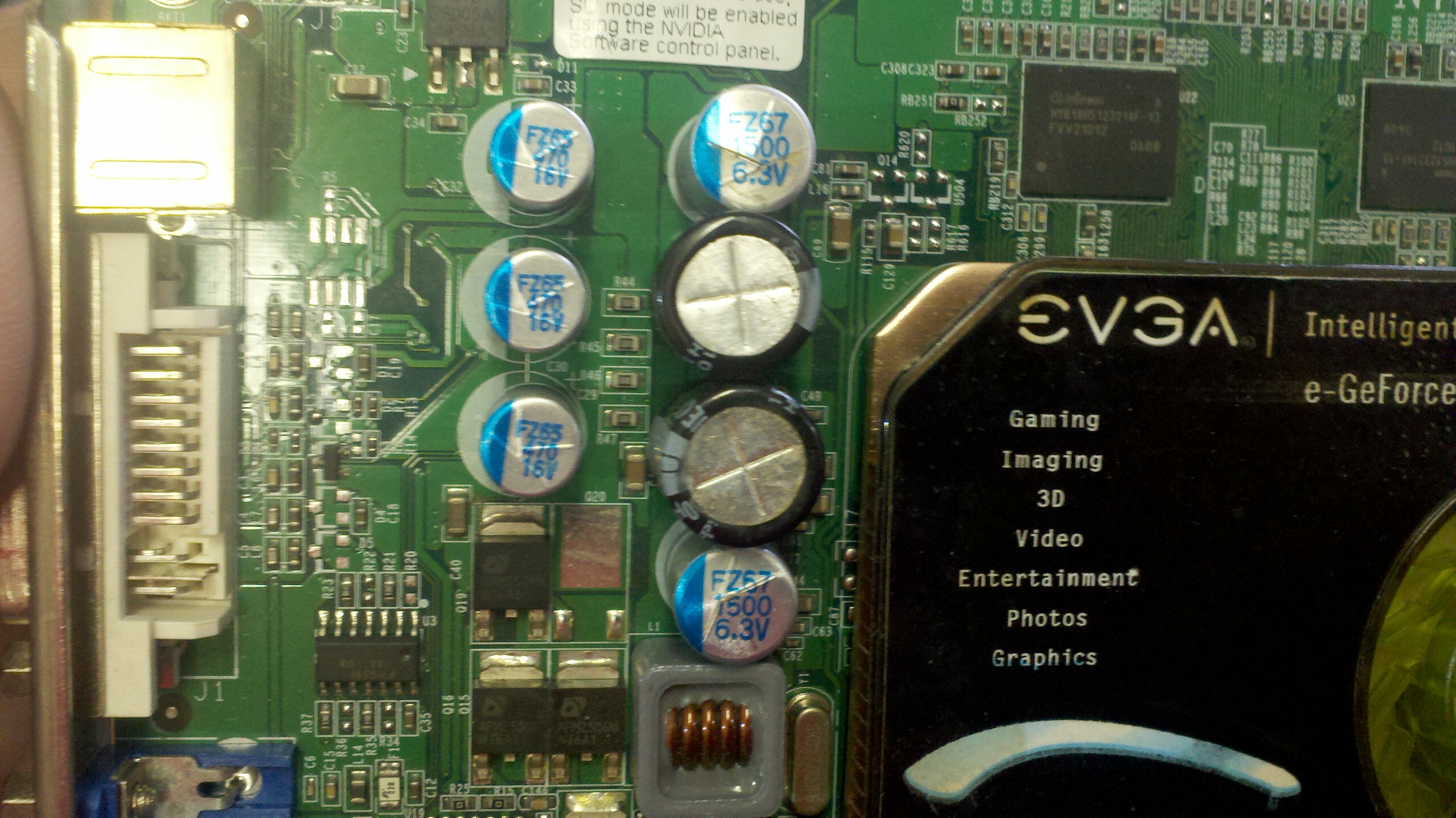

    recapping fail!
    not only partial but it never would have worked due to the mistake.
    gotta love it when folks try to fix their own stuff!

    Looks like he used Nich HE too. Totally unsuited to that application

      Gotta love it. "Oh, these two caps failed prematurely, surely they were just duds and the other ones should be fine!" I give them credit for at least trying though

        I don't think you can since they left one blown cap.

          ...And installed one of the new caps the wrong way around!

            Yep, that one capacitor is definitely in backwards:
            evga tends to use cheap capacitors.

              Cheap capacitors is one thing
              Fake polymer capacitors is a whole different thing
                They're not "fake polymers", they're just sleeveless electrolytics. Even Panasonic makes those, although Panasonic's are good.

                  Typical on GeForce 7 series, not on GeForce 8 series and later.
                  (Except maybe 8400 and 8600.)
