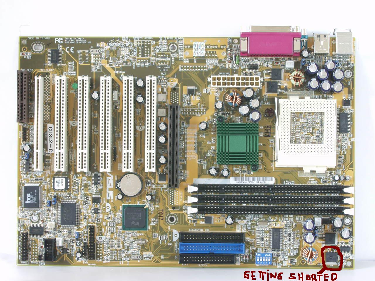

    Hi, I got several old p2b-f, cusl2-c, tusl2-c. They were in storage for many years and all of them start having "Power on and Power off" the TUSL2-C when turn on, fans spin for 2 second and then goes into sleep mode, sometimes it post OK, the p2b-f when plug-in in to the AC line fans spins for 2 sec without power it on, cusl2-c turn-on byu itself and never turn-off (dont respond to power-off) . It think, u guys are wiser than me, gotta be some kinda leakeage in the pw-sw line, i cant identify which transistor is, or if a small cap maybe smd cap is shorted or something else :S, but the problem in all my mobos is related with getting old in storage.
    http://en.wikipedia.org/wiki/Leakage_%28electronics%29
    Thank you from Argentina

          Re: Asus boards got old n leakeage transistors
          Originally posted by pfrcom
          I don't have problems with my CUSL2 with P3-1000 or TUSL2-C with P3-1400S
          Apart from the PS2 connector in this thread badcaps.net/forum/showthread.php?t=829
          Have you tried different power supplies ?
          Yes I had it to, took off the C151 8-legged CAP .
          Yes, all my Asus boards have good caps, but I thought that the power-on problem could be shorted little SMD caps or little transistors. MOST of more than 10 years old mobos start having problem in the CMOS battery line (with new batteries) because of a little 3v transistor near the battery,
              Originally posted by momaka
              I have an ASUS CUR-DLS motherboard that sometimes won't boot either (I press the power button, all of the fans spin for a split second and then it turns off). If I wait a few seconds I can repeat the process. Doing this over and over will eventually boot the motherboard. And sometimes it starts first time. I haven't spend any time to look into it, but given that it's an ASUS, I'm not very hopeful.
              Exactly the SAME problem with a CUSL2 and TUSL2C, it has to be a transistor in the pwr switch line, but there are many...:S

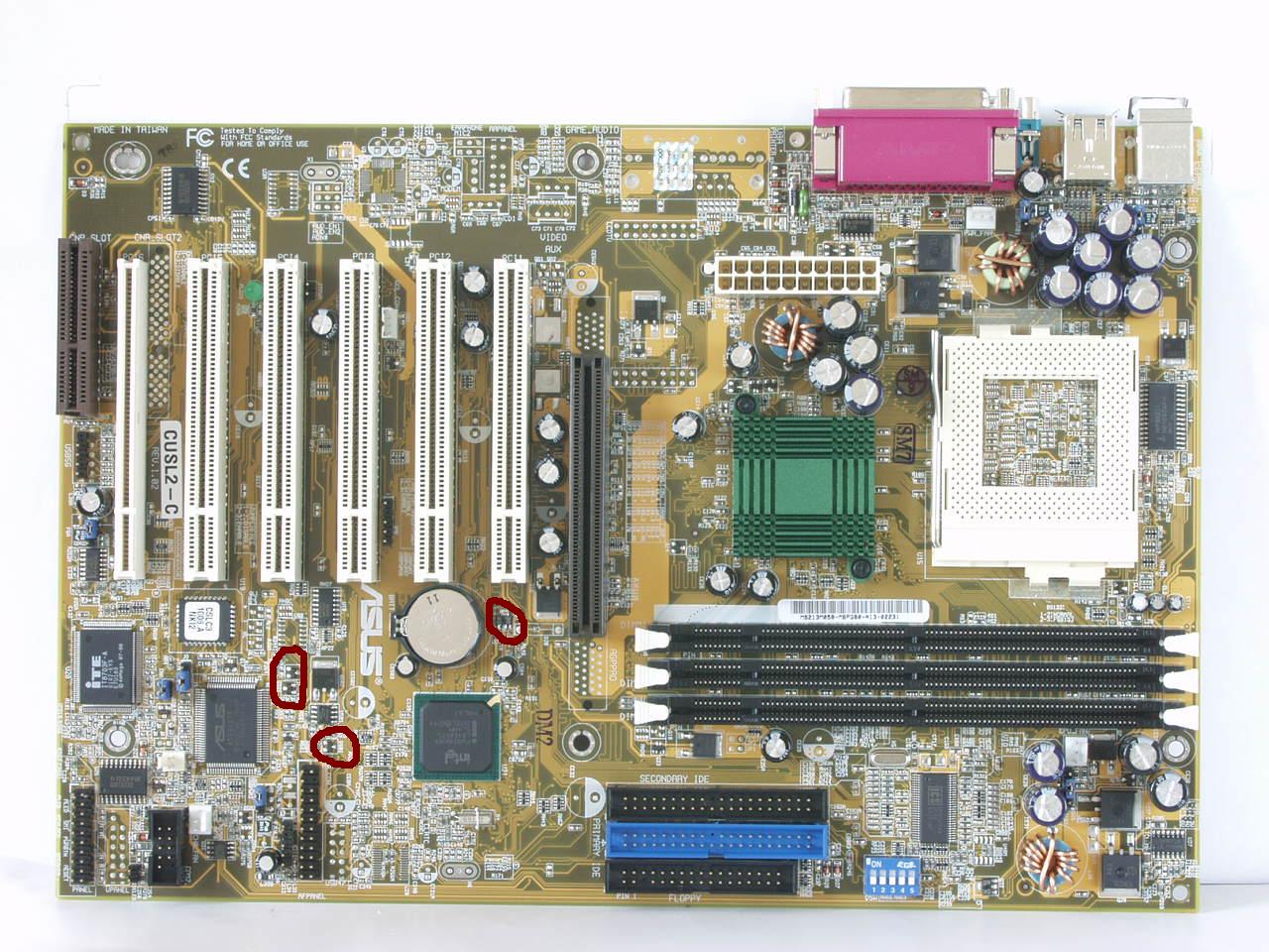

                              I've found out why the Asus had power up problems (power up by itself, or do not power dont never) I thought that was a BIOS-CMOS-BATTERY circuit problem, but the one big transistor getting shorted is 10N03L in the VIO VRM the other one is a little affected too. Do you recommend me using my HeatGun http://cfnewsads.thomasnet.com/image...493/493185.jpg or what?, I already have the replacement fet.
