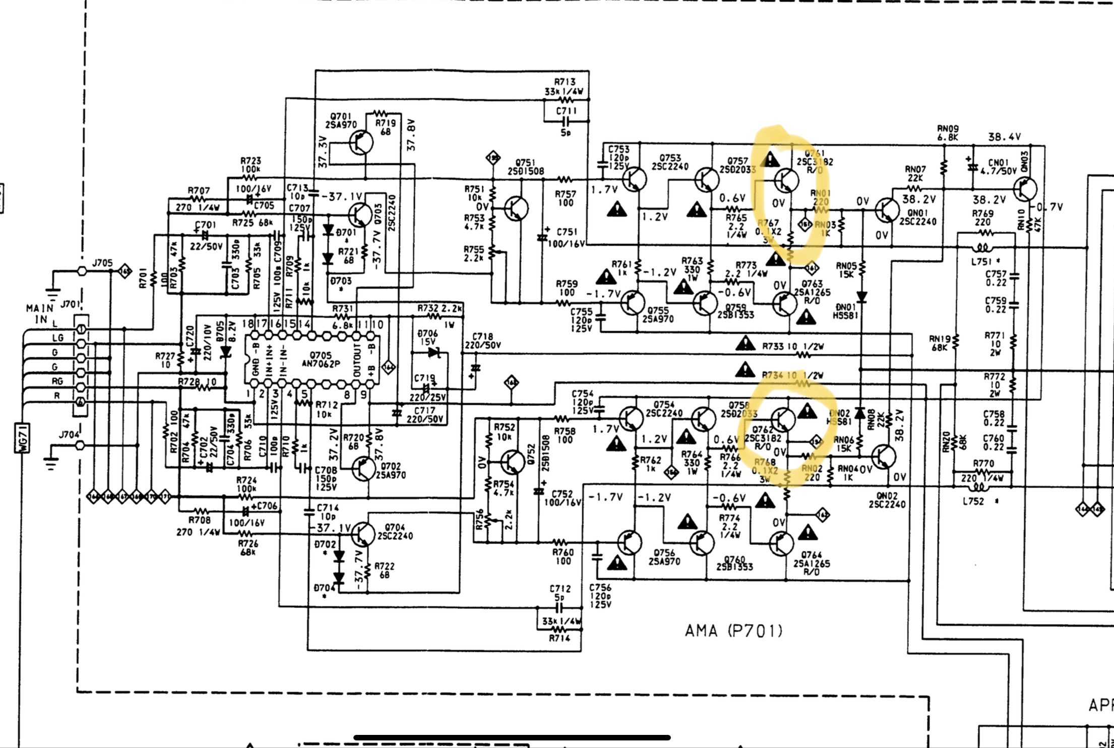

    While ago I replaced those big filter caps to that amplifier. After that started to happen. I connected the amplifier normally to the mains and almost immediately several transistors burned out. I really didn't do anything else (at least on purpose) than replaced those big caps C801 and C802.
    After that I replaced those burned transistors (I can't remember exactly what they were) and measured all the others, and now everything should be ok. But, when I power up that amplifier part with two bench power supplies connected in series there is obviously still something wrong. The voltages fluctuates up and down and (NPN's) Q761, especially Q762 gets very hot - of course depending on the input current. I just can't figure this out. I have measured practically everything on that board but I just don't see, what's wrong with it.
    When I remove (PNP's) Q763 and Q764 from board, the voltages is no longer fluctuating, but when I connect either of those, then the fluctuation and heating starts again.
    I'm not good at explain this situation, but I hope that you get something out of this, and I'm more than glad to give you more information. If needed I can try to remember out which transistors burned out in first place.
    Schematics:

    Again as a broken record, those main filter caps rarely fail on audio equipment... Sometimes they make them with a fake bulge.
    So Q763/Q764 are still good/not shorted?
    You should check the transistors upstream in replacement cases like this, especially Q757-Q760) to make sure they're likewise good and not shorted.
    You did check all the voltages printed on the schematic (with Q763/Q764 removed so you don't fry any more stuff)? Any hot resistors?

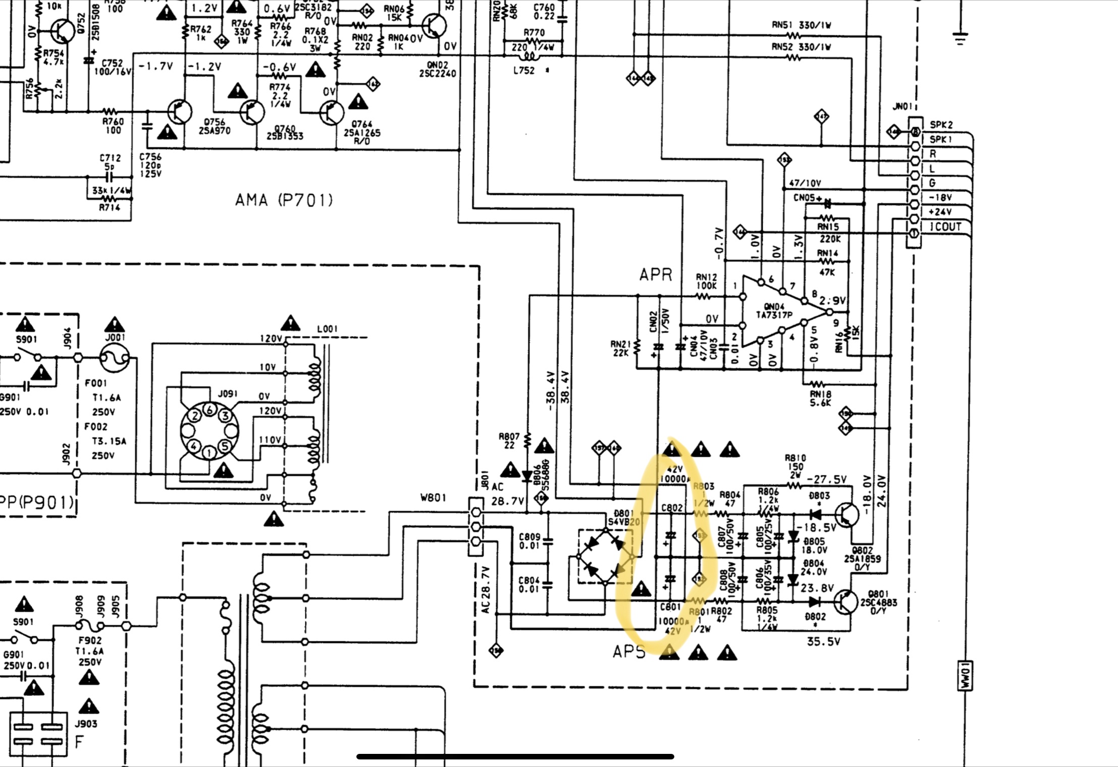

          Yes. screwed down to the heatsinks and properly insulated. Caps inserted as they should be.
          I have not found any shorted transistors and all transistors I have changed are likewise.
          About voltages, they seem to be all over the place:
          B; C; E
          Q802 -18.5 V ; -43.4 V ; -18.0 V
          Q801 25.1 V ; 44.3 V ; 24.6 V
          Diodes:
          Cathode; Anode
          D805 0 V ; -18.7 V
          D804 25.2 V ; 0 V
          D803 -18.8 V ; -18.5 V
          D806 ~32.9 V ; ~8 V
          D802 25.0 V ; 25.4 V

            R806 and D804 gets hot. From transformer comes 32.8 VAC. After bridge rectifier comes + / - 44.8 VDC. All of the voltages are higher than printed on the schematic.
            Voltages from QN02:
            B C E
            -22.1V ; 44.7V ; -22.1V, so far away from what those should be.

              QN02: appears shorted base to emitter as no volt drop .

                      ok i see now at least one channel has railed ..
                      see what voltage at QN01 emitter or L751 .

                          Voltage is -0.9V

                              ignore xNxx components for now, apparently they failed to do their job or at least they rather protect the speaker only, ignoring the driver transistors. Also their readings don't mean much if you have Q761 or Q763 out.
                              What are all the voltages at the bases of all the transistors (Q753 Q755 Q757 Q759 Q761 Q763) and the voltage across capacitor C751?

                                i think this channel is ok and its the other one thats gone to negative rail . yes it does have -900mv showing at the output but i think thats coming back from the protect circuit .
