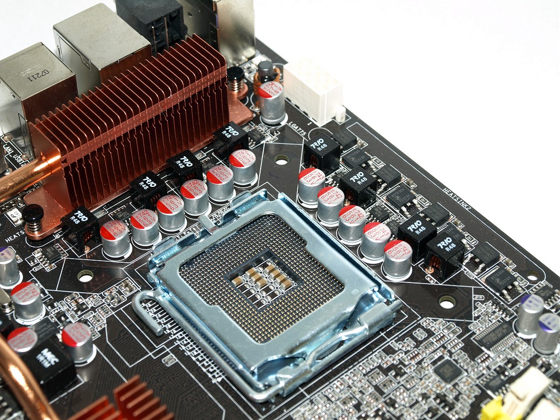

    Hi
    My friend has a Asus maximus 3 formula. But it was getting unstable. He thougt it was the videocard that was making the computer to freeze and bluescreen so he bought a new videocard. But the computer still bluescreened and freeze so he bought a new psu with more power (corsair 750w). But after hooking up the new psu and started the computer three caps got blown away from the mainboard(sounded like a firecracker).
    My question is. Do you think its possible to replace the bad caps and nothing more is damaged on the mainboard. Is it worth a try?. And i need to know what caps to buy. I can't read out what caps being used.
    I will get the mainboard and cpu(i5) for free so it would be nice if i could fix it myself. My friend bought a new mainboard and i7 so there is nothing wrong with the new psu.
    The ones i have marked with a red ring is the caps that got blown away
    http://zerox.myftp.org/~jens/blandat/maximus.jpg
    Thanks for any help i can get.

        Yeah, you'll have to get the board and post some pictures, closeups of those spots.
        I did some snooping around and found a review with closeup pictures of those areas:
        http://www.overclockersclub.com/revi..._formula/3.htm
        I can see in the pictures most capacitors have FP in the name which makes me think it's the short for "Functional Polymer" , a sort of hybrid polymer capacitors made by Nichicon.
        The capacitors on this board are probably a custom series made for Asus, as Nichicon doesn't make them in this washed out gold style.
        Going through the closeups around the CPU, I see on the thinner caps 101 16v, which is 100 uF 16v.
        On the top of the board I see one that says 271 16v, which is short for 270uF 16v - in another picture with capacitors near the back connectors I see a capacitor that has a code which starts with 2, so I assume that's also 270uF or 220uF 16v.
        As they're all 16v, it makes me think they're "energy reservoirs" for the voltage regulators which convert 12v to the voltage the processor needs, and the capacitors closer to the socket are probably rated for maxim 2.5-3v and store the actual energy that goes to the CPU.
        The old power supply probably started to give 12-14v or maybe even spikes over 16v, adding a lot of stress on these 16v capacitors and they crapped out.
        So based just on this information so far, you probably have to get 270uF 16v and/or 100uF 16v polymer caps, with high ripple and low esr values...

        This might be the actual series Asus branded in their colors:
        http://se.farnell.com/nichicon/rl81c...ial/dp/1853463
        You see the FP on the picture ... otherwise the picture is not correct, they just snap a photo of some random capacity/voltage combo in the series.
        In the worst case scenario, these *may* work, but specs wise, they're about 2 times worse than those polymer caps (still way better than other electrolytics)
        http://se.farnell.com/panasonic/eeuf...0uf/dp/1800683
        Yes, it's 50v rated and a bit wider at 10mm, but this is to get the specs as close as possible to the polymer caps.
        As for the 100uF 16v, you can get these:
        http://se.farnell.com/united-chemi-c...16v/dp/1687418
        and this *may* work as it's relatively close to the polymer capacitor specs:
        http://se.farnell.com/rubycon/35zlg1...35v/dp/1805449

          It's very strange for solid polymer capacitors to fail like this.
          Please use a power supply tester to test that new PSU.
          It is likely faulty and testing it with another mainboard will just blow up that too.
          Under the heatsinks on the mainboard next to the capacitors that failed there will be MOSFETS.
          Take a look at those, if they are cracked the price to fix the board will probably be too high...

                          Sorry for a late message. I replaced the three bad caps with regular 330uf 16v caps. Instead of 271uf 16v. But the where also some bad joints under the mainboard that needed fixing to. But the mainboard works again. So i am happy =). But it was really hard to get the solder to melt so i could remove the bad caps.
                          I forgot to take pictures of the fixing.

                              I replaced the bad caps with these
                              https://www.elfa.se/elfa3~se_sv/elfa...7-233-73&toc=0
                              Instead of http://se.farnell.com/nichicon/rl81c...-20/dp/1853463
                              Because my local dealer had the first one in stock and they only cost 12 sek for 4 pieces without any extra freight.
                              The computer have been running fine over the weekend. No bluescreens or crash so far.

                                Suncon is Sanyo so the quality should be fine, looks good! Should last a long time.

                                  That's a Sanyo WX electrolytic. Good quality, but not nearly good enough spec-wise to replace the original caps. As I've said in other threads, NEVER EVER buy your motherboard caps from local electronics stores. They rarely sell suitable caps for use on the VRM of a modern board.
