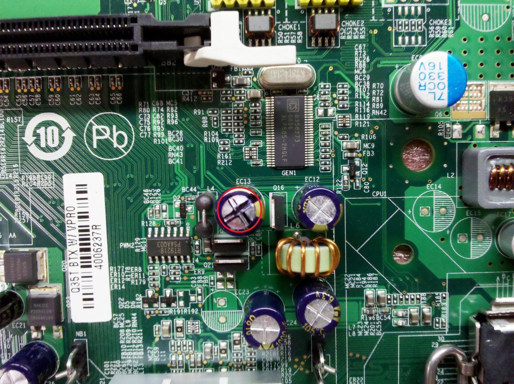

    This system was purchased in Aug. of 09, just months before MPC folded. MB is built by ECS, Intel Q35T chipset. Board is populated with a lot of OST caps, two of which are bulging, (See attached photos) both are 6.3v 1800uF
    History: The PC one day would not boot. First thing I did was check the PSU which was OK. Bought another board and got the system back up and running.
    Gonna check with the boss to see if he wants to try and have it repaired. If not I'm going to ask if I can have it. My question is about which caps to update? I seem to remember reading so time ago that only certain caps need to be replaced, and that it revolved around the size (voltage and capacitance). Any help provided would be much appreciated.

    Re: Gateway (MPC) E4620
    All those OST caps were made at the same time so should be equally bad. The earliest failures were subjected to the highest heat. You could:
    * Replace just the failed caps and see what fails next.
    * Replace all OST blue/gold caps in high heat areas since some might on the verge of failure. This doesn't seem practical since I only see 4 blue/gold caps that aren't at high heat risk.
    * Replace all OST blue/gold caps.
    * Replace all off brand and at risk good brand caps.
    If it was for a server I'd choose the last option. If it is an experimental home machine I'd choose the first option.

      sererach,
      The boss told me I could have the board, so I'll replace the bulging caps and see if it will come back from the dead. It means I'll have to buy a CPU and Ram.
        OST capacitors do not always bulge when they fail. Even if they look good, they may have failed internally. I would replace all the OST. The little caps (>100uF) are not likely to fail, so those can usually be skipped.

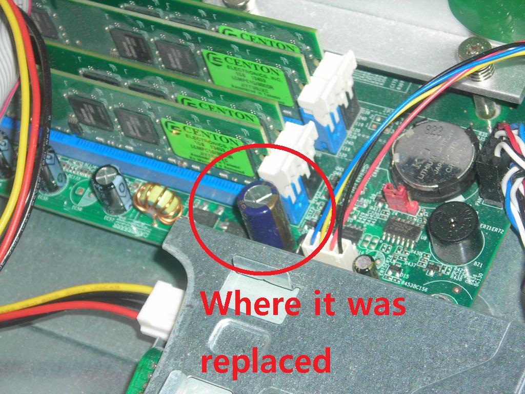

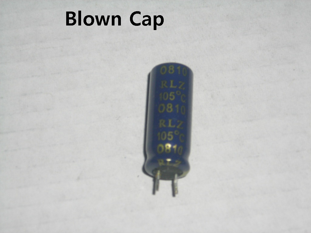

                      I have the same computer, and the motherboard had the same capacitor blown like the original poster, RollMe, uploaded. In my case, only one OST capacitor blown.
                      Please refer to the pictures I have uploaded. The symptoms I kept getting was
                      the frequent blue screens of death saying there are problems with system files or the system memory. Then one day, the computer completely died. It would power on with fan blowing, but no POST. So, I read RollMe's solution in this thread, tried to replace the blown cap. However, I ONLY replaced the blown cap with a Rubycon 2200uf 6.3v which has larger capacity than the blown OST 1800uf 6.3v, and the result is excellent! It immediately solved the problem!
                      I was worried that replacing with a capacitor with higher capacitance would
                      end up badly unlike the voltage which is rather recommended to be replaced with higher one than the blown cap, but I read "Topcats" reply in this thread
                      https://www.badcaps.net/forum/showthread.php?p=25370
                      and took his advice and just replaced it. Now the computer is working fine with no issues.
                      Huge Thanks to RollMe, TopCat, the Rubycon capacitor!
