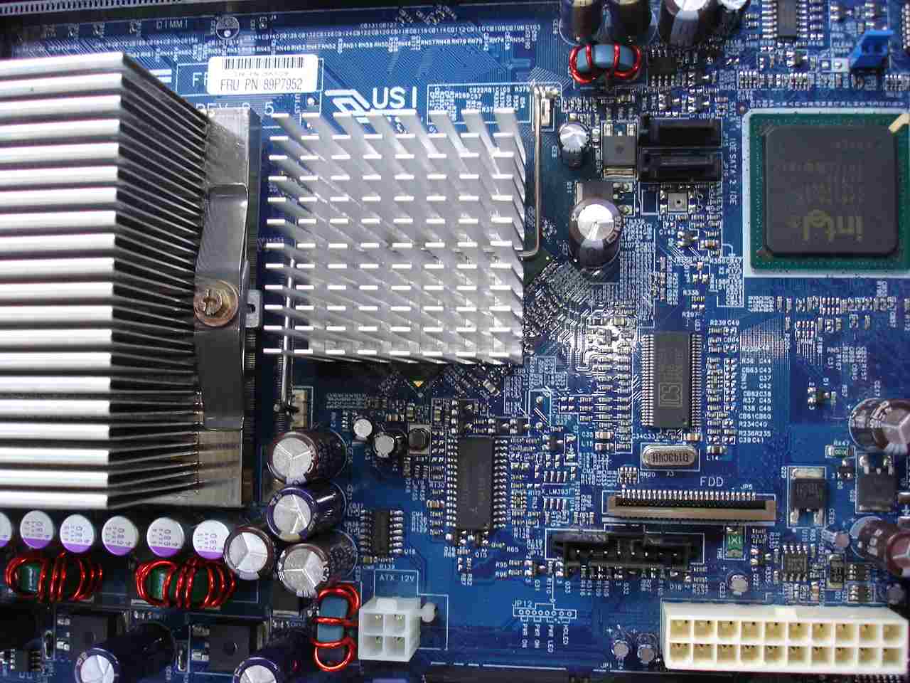

    This board from an IBM ThinkCentre 8184 has solid caps in VRM, and a mixture of Rubycon and Chemicon electrolytics elsewhere

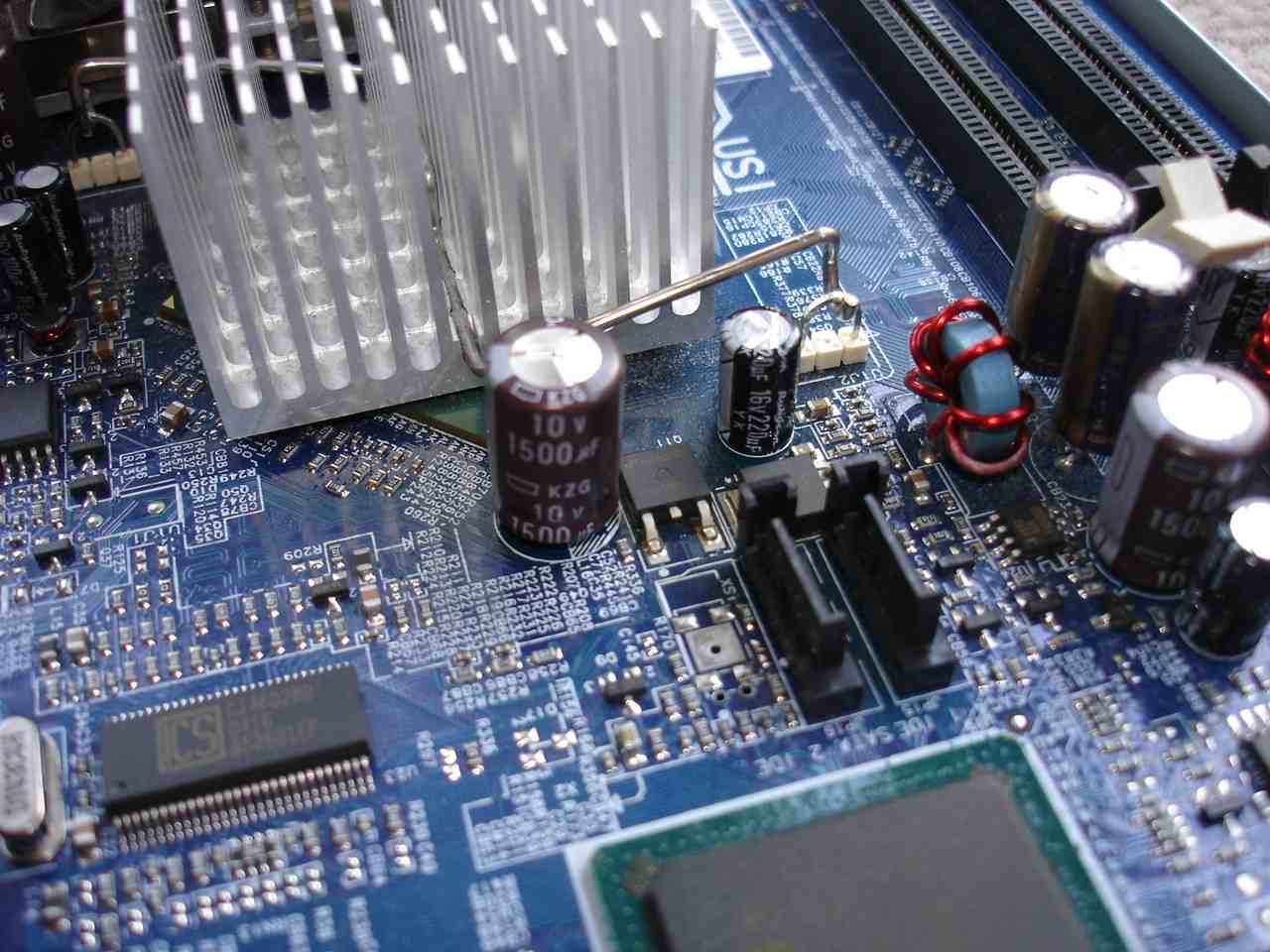

    In this case, the Chemicon KZG beside the northbridge heatsink lives up to its reputation for disliking heat and is bulging top and bottom
    Other KZGs, mixed with Rubycon, still appear OK
    Whereas the same model that I use every day scored all Rubycon in the lottery, and shows no sign of any problem

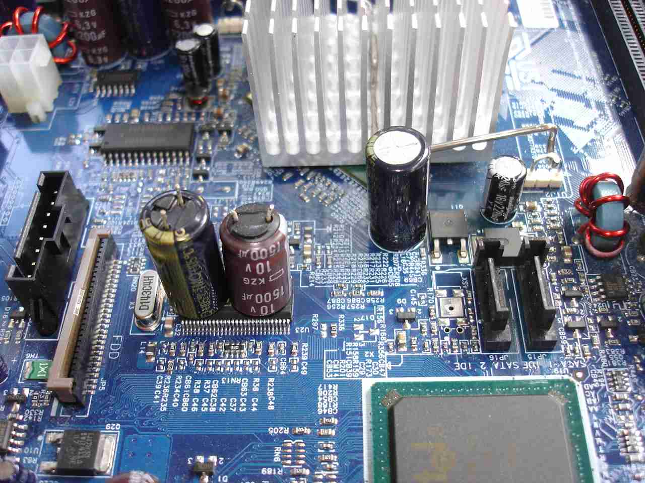

    Final pic shows replacement TMQ 1500uf 10v recycled from a scrap board, but tested OK on Dick Smith ESR meter before re-use
    Also shows underneath an identical TMQ, plus original KZG, both of which have the complex bung which usually means a good capacitor

      that spot is hot enough to pop mbz!
      have 2 now that have.just a bad design to put the cap next to those red hot mosfets.

        I have several of these boards, all of which, the mosfets are cooked along with the MBZ caps.

            Maybe I got to it just in time
            Other side of the PCB, underneath the mosfets beside that capacitor, it's quite discoloured - sort of browny blue, instead of bright blue

                As KC8ADU said earlier, bad design
                CPU cooling is by an external case fan which blows (from left to right in my first picture) across the CPU's passive heatsink first, then across the northbridge heatsink
                So by the time airflow reaches that capacitor, it's probably quite warm
                Compound that with heat from the mosfets beside it, and it's not a good environment for something heat-sensitive
                The fan is thermostatically controlled as well, only speeds up when CPU is working hard, so probably minimal airflow most of the time
                The board does have other KZGs - the group of four 2200uf 6.3v electrolytics to the right of the polymers are one Rubycon MBZ and three Chemicon KZG, all of which look OK
