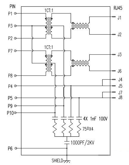

      • R_J
        • Jun 2012
        • 9638
        Re: About network cards failures...
        You could also check the jack itself as it could be a magnetic type (has built in transformer) its possible it could be an open winding, jacks are easier to replace if thats the problem

                  • hikaruichijo
                    • Aug 2015
                    • 123
                    • Spain
                    The transformer is that tipical black rectangular component that is usually close to the NIC chip?

                                • R_J
                                  • Jun 2012
                                  • 9638
                                  The transformer is internal to the jack itself. I repaired a fta receiver that someone replaced the jack on and just used a regular rj45 jack, I could never get better than a 10mb connection, I did some checking on another one I had and found it used a transformer type jack, I found one and installed it and now it connects at 100mb like it should. they are easly checked with a meter
                                  I believe most motherboards use this kind of jack but I could be wrong
                                  I just checked a couple motherboards and they use magnetic rj45 jacks. like this site http://www.btoptech.com/products/rj45-usb/91.html the transformer is internal

                                  • hikaruichijo
                                    • Aug 2015
                                    • 123
                                    • Spain
                                    So old cards have this transformer on the board an newer cards have it integrated on the jack itself.
                                    That's a great step forward on what I was investigating.
                                    But I still don't know what's the function of this tranformer.
                                    I'm going to look if it's posible to buy this tranformers new.

                                      • 31316
                                      function of the transformer is to isolate each system from the network, and to increase the current of the signal at the expense of the voltage so as to boost the effective range.
                                      • hikaruichijo
                                        • Aug 2015
                                        • 123
                                        • Spain
                                        Thanks a lot for the info!!
                                        I'm testing the rj 45 jack on the board of the Compaq n600c and it seens to have the tranformer integrated an shorted because i don't see it on the board and the pins have continuity with the board.
                                        I'm goinng to look for another boards to compare the results and look for another jack.
