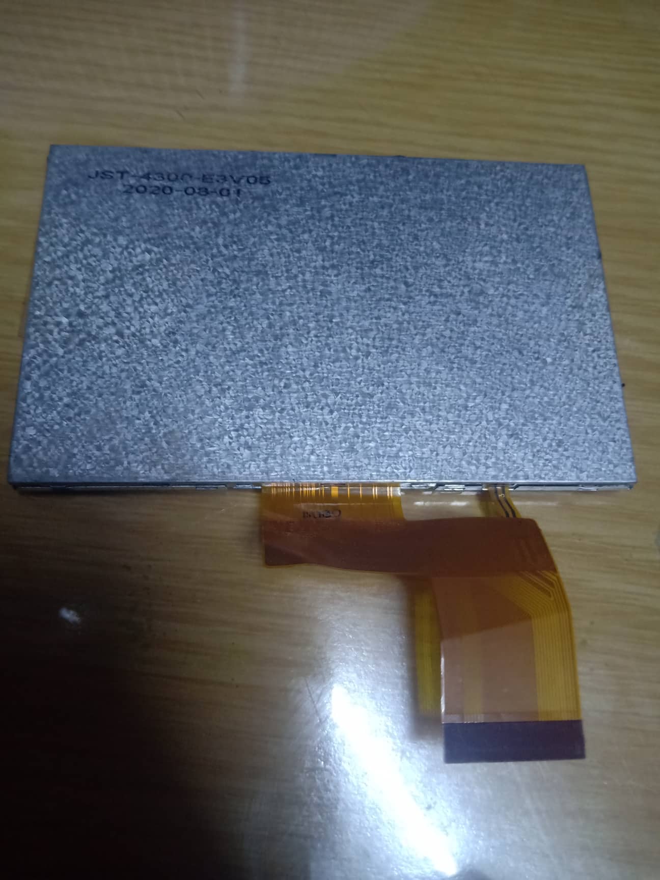

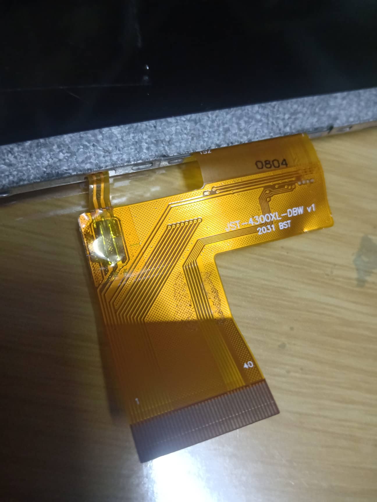

    Need help. my chinese made LCD microscope broke.. leaving me a broken lcd screen. Model number is JST4300-e3v05
    any idea guys where can i get a replacement, i already google it with no avail.
    it is a 40pins 4.3 Inch 3.3V 480x272 Resolution. any lcd model compatible with this lcd. thanks in advance...

    https://www.aliexpress.com/item/4000283839451.htm

      Maybe one of these? https://shop9165960972.panelook.cn/?...uct&catid=3175

          You're right, it's missing the l off the end.
          https://www.aliexpress.com/item/4000283839451.html

            Thanks for the reply.. https://www.panelook.cn/TL043WV01-00..._cn_97127.html i found it.. thanks...

              You can measure for the 3.3v and backlight on your board. Pinout in the link i posted. I would think a Chinese microscope would use a cheap generic screen.
