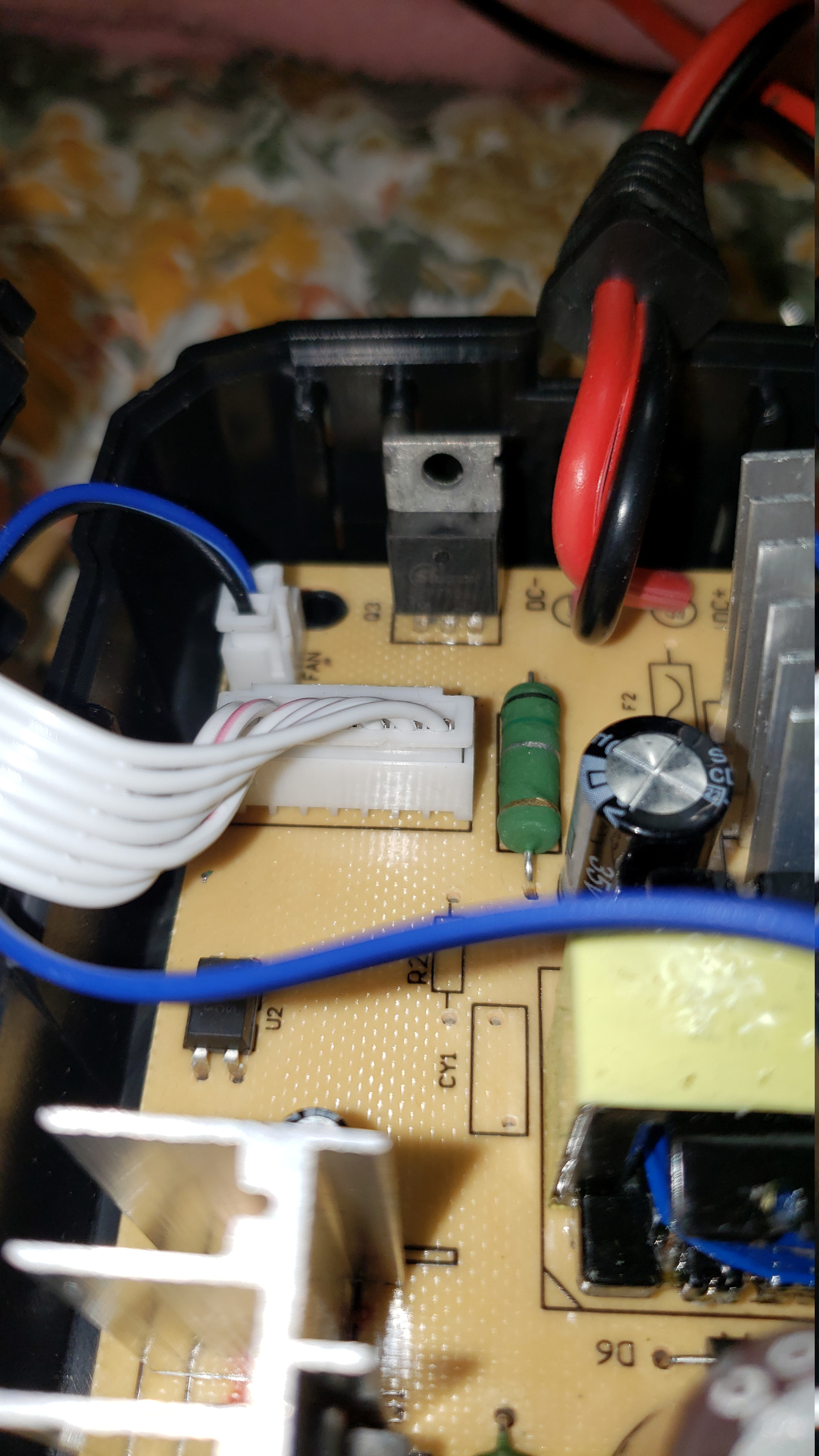

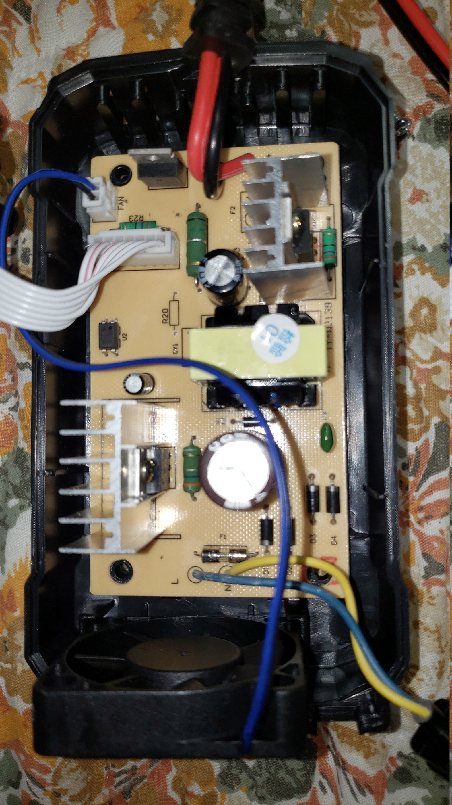

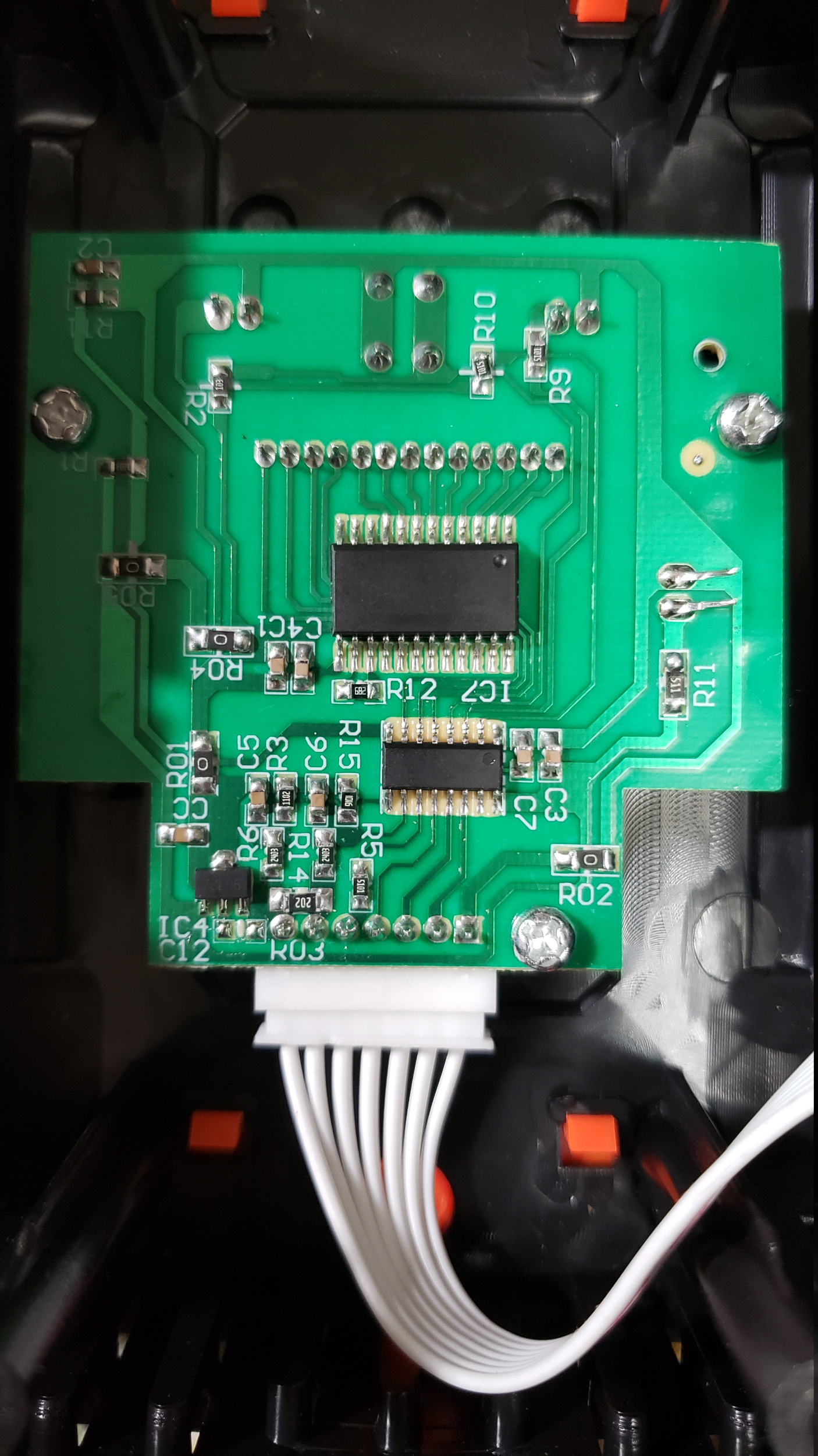

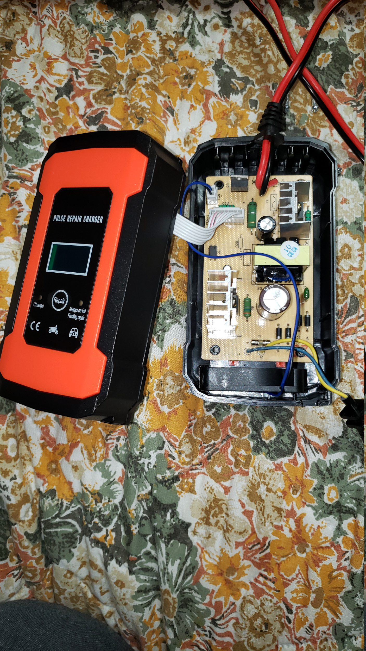

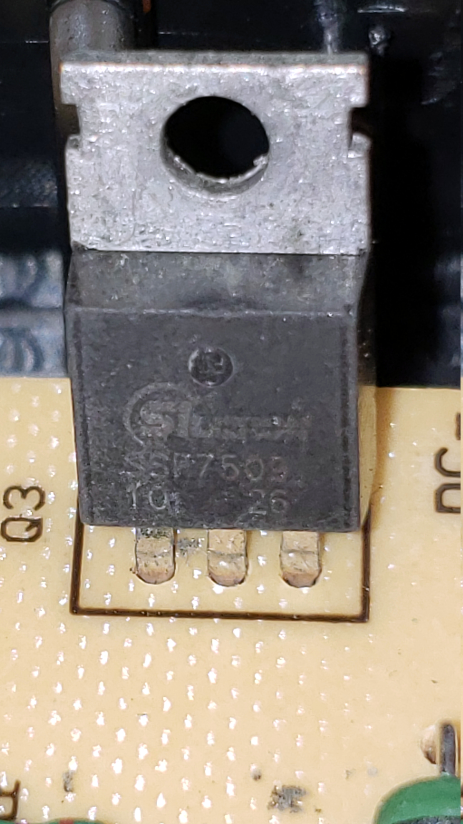

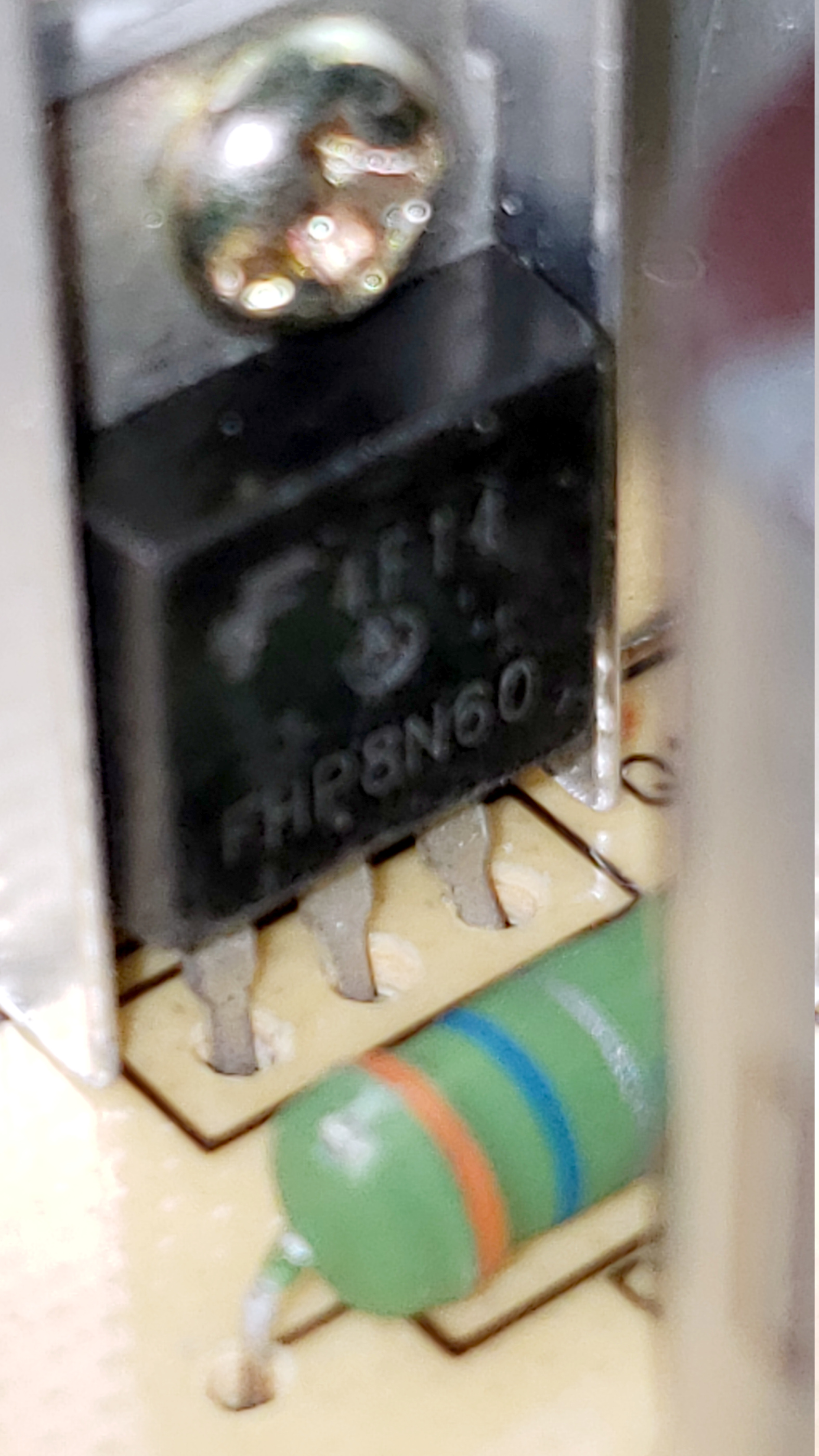

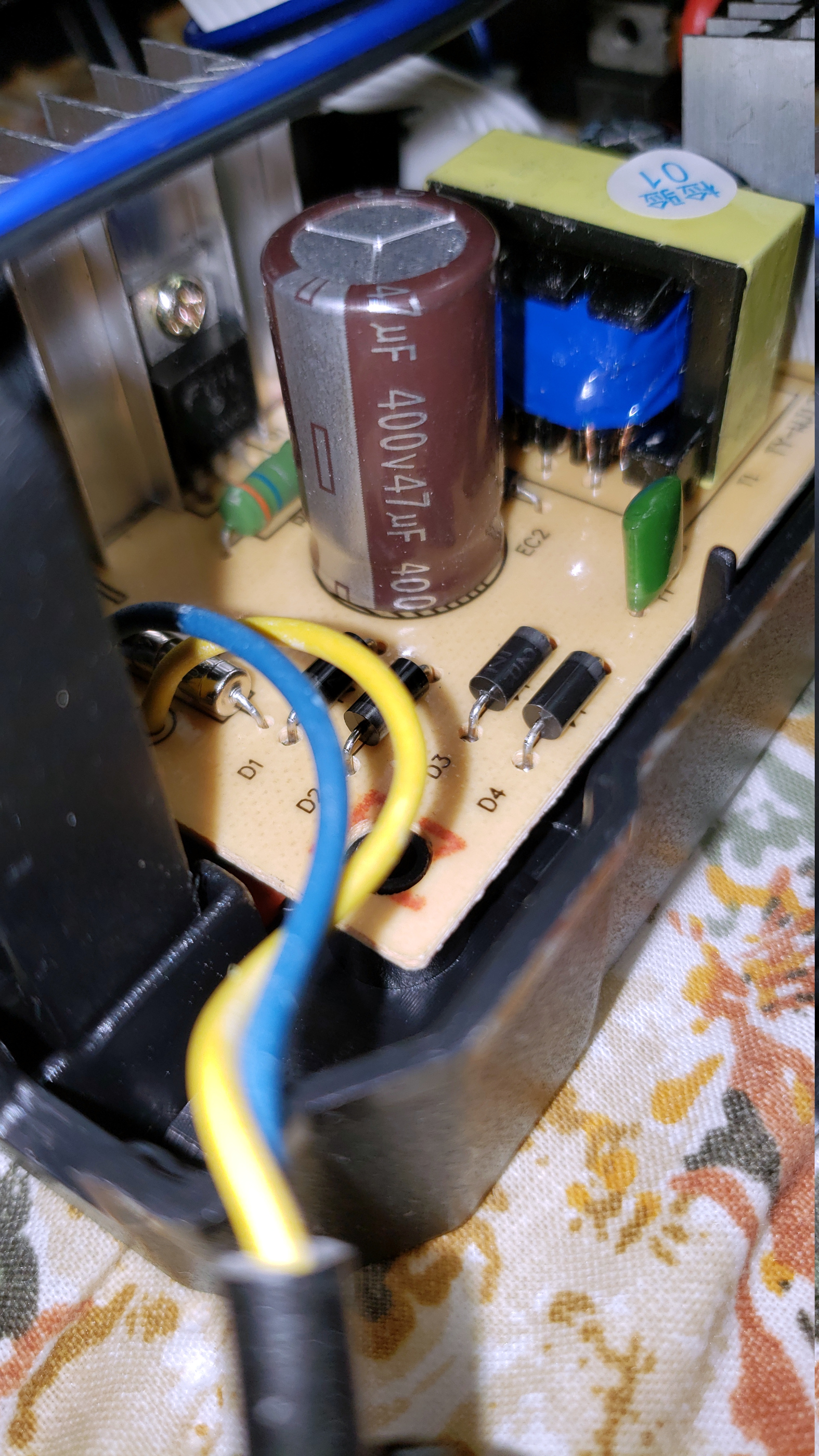

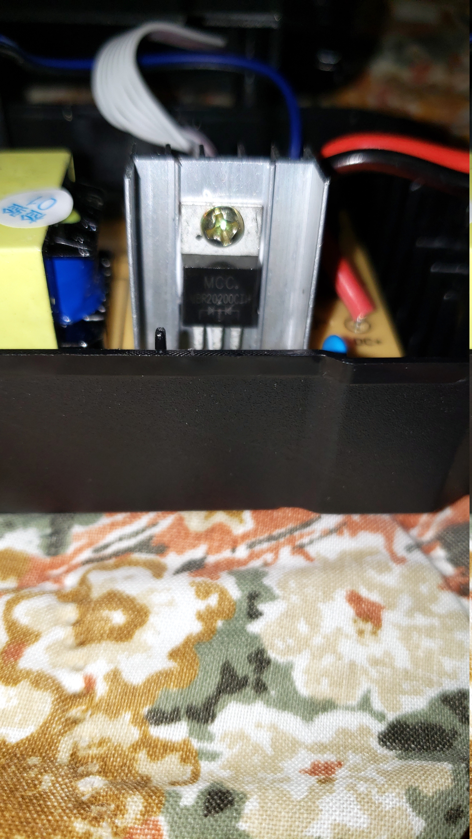

    Chinese made 12v 6 amp lead acid battery charger info
    I posted another thread like this for a TV power supply. This is for information purposes for anyone who has a bad one and wants to repair instead of replace. There is no model number on these but internally they appear to be the same, fan being the only difference I can find. If a component is damaged and can't be identified, this may help. One I have has the brand name XinJieBao on the front above the display. The other isn't marked.
    My impressions. I can't say for sure on the chips and such but the HV capacitor is a very low quality one if I think. I tried to google it and also checked the Tom's Hardware tier list. It isn't listed. For me, if it isn't listed there in one of the top tiers, it isn't of good quality. They don't list every brand of low quality capacitor made but they do seem to have a complete list of the high quality ones. Of the three chargers I have , one has a brand, others does not. Inside, the difference is the fan. The one with a brand name has a very quiet fan. The one without has a low quality fan. One was bad out of balance and stopped working within a hours use. If it has a red and black wire for the fan, quiet and works well, so far. If it has a blue and black wires, not good. I've already ordered replacement 50mm fans. Fan seems to kick in when charge amps is above about 2 amps.
    These chargers actually function quite well as far as design goes. It has a pulse repair feature that I use quite often. It does work pretty well. I tend to use a desulfator once or twice a year tho to really condition a battery. This charger seems to work well enough for day to day use. It also seems to do a good job of maintaining a charge. I've left these chargers hooked to a battery for months with no damage. So far, these are under $20 on ebay.
    The pictures are attached. Hope it helps someone. If nothing else, if someone is planning to buy one of these, you have a idea what you will be getting. In a year or so, I plan to replace the HV cap. At least it may make it last longer, if other components are of reasonable quality.

    Re: Chinese made 12v 6 amp lead acid battery charger info
    Did you put an oscilloscope and a CT on it to see what this “desulfator” is actually doing? I put desulfator in brackets on purpose, because there are too many gimmicks around that claim do desulfate, but are worth sh*t. I’ve built quite a few desulfators, but mine are much bigger than that and you can hear the battery posts humming. I can’t see this thing doing much besides increasing the charging voltage a little bit. I suppose you get that same effect with an old battery charger and let the battery boil for a bit.
    Not that I wanted to dump cold water on this, but I’d say you have more luck desulfating a battery using a small electric fence spiker.
      • 31195
      that actually looks really good inside.
      as for trying to get crystals off the plates, i cant see anything there that would do it.
      the best devices for that do things like dumping huge inductors into the battery to create current spikes.
      you wont do that with a switching psu.

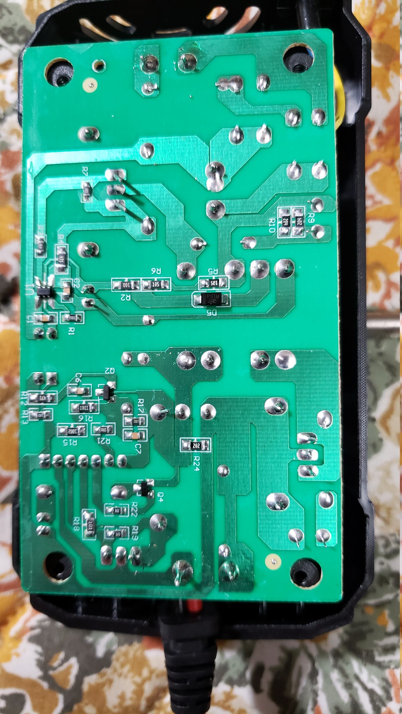

          Helps to see pics of the underside of the board, where the IC's are.
          The SMPS runs steady to power the front panel, fan etc. and there is a rectifier - the SSP7509 extra mosfet must do the pulse generation.
          It looks the same build as another chinese charger I bought. Fair quality, oddball semiconductors and built for very low cost.
          One problem is the inrush current is very high, loud ca-bang when you plug it in as there is no NTC or resistor for the primary cap. The two caps run hot, they are stressed. 6A output is a bit optimistic. It should have second fuse F2 populated so a short does not burn it up. There is no Y-cap to prevent a little zap when you touch the car, no EMI filter CM choke, X-cap etc.
          Out of the 10 reasons lead-acid batteries fail, sulphation is but one of them. This has been is known for over 100 years, everything tried.
          I looked at research papers using electron microscopes to look at the crystals because they are also the cause of lead-acid battery charge lifetime being like 500 cycles. Every discharge cycle, sulphate crystals form until the plates are pretty much covered.
          The crystals can be different sizes and shapes, stuck in the pores of the plates. I did not see really solid proof desulfators work unless they are crazy high in pulse power, kW level. Knocking the crystals off the plates is unheard of, they get stuck there and I think you can only hope to dissolve them a little.
          I've built my own desulfators but did not see anything spectacular for results, so I am now a non-believer.
            I don’t see anything that suggests that there is big pulsing power inside. I only had luck desulfating car batteries with huge power. And even at that it takes a few days in order to desulfate a heavily sulfated battery. Desulfating does work, but like I said, it’s not going to happen with these self powered circuits, or these small chargers. Maybe it will get a battery done in a year or 2. Minimum gotta be a voltage doubler with 4 large caps almost the size of a small coffee cup, 2 caps in series for each side.

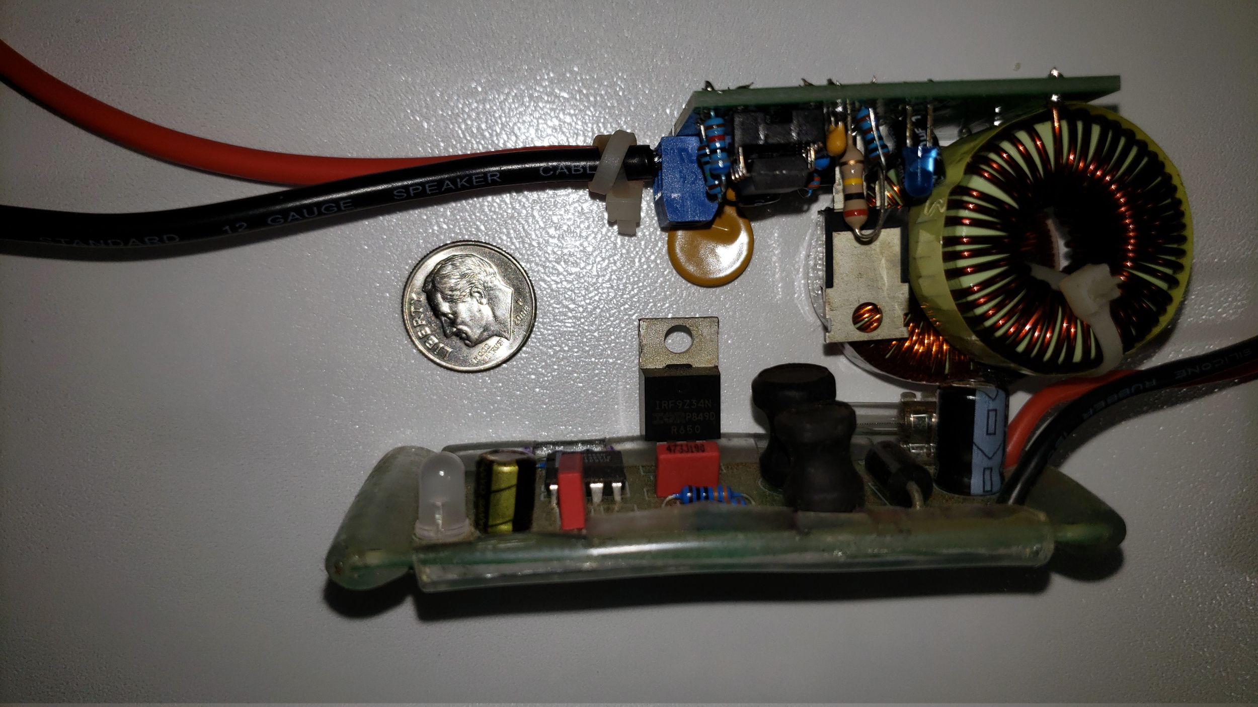

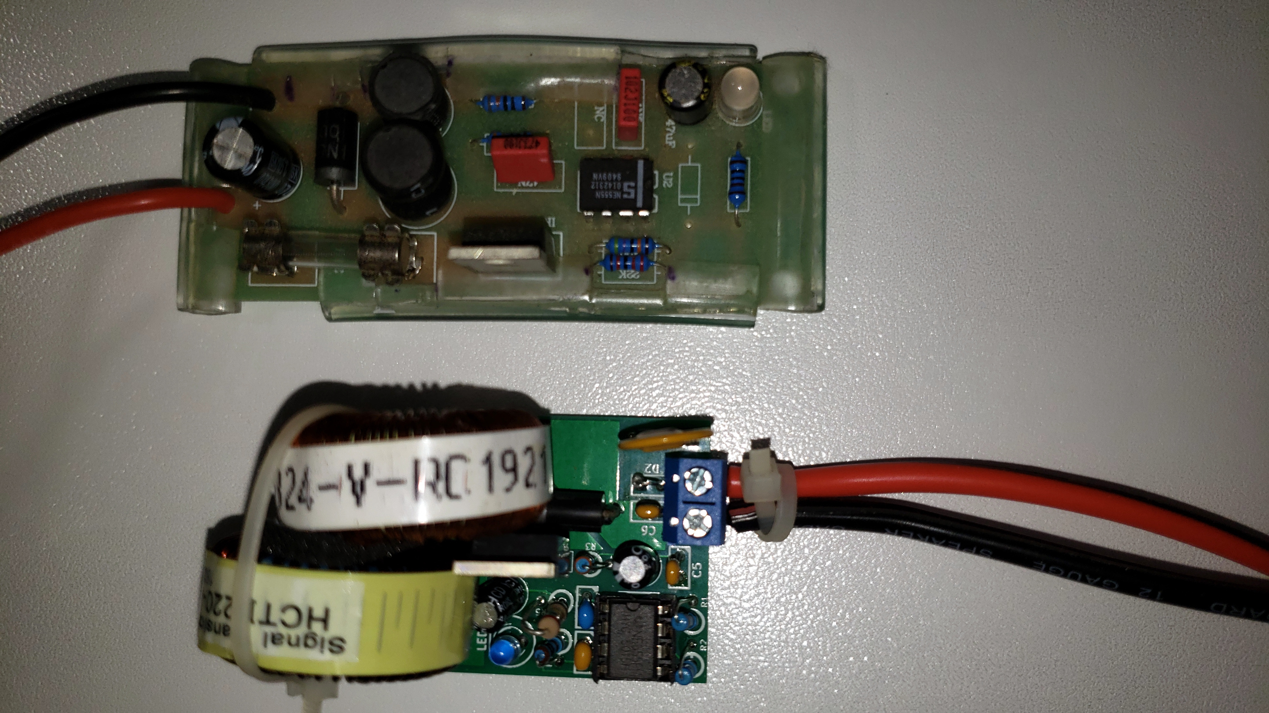

              Yes, batteries fail for several reasons. Usually mine fails due to a shorted cell, often in something that gives it a bouncy ride. Sulfation is a common one tho. I didn't think they worked either until I used it on several batteries. The example in post above was only one of many I've done this on. I have seen this work but it does take time. The example battery above was over a two month or so period of time. It did improve pretty fast at first but it took a while to get to where it is now. Despite it being about 20 years old, I believe it would work in my car even tho I replaced it because it tested weak.
              There is another board in the charger I didn't take a picture of. I was going to add it to the original post but the edit button is gone or I'm not seeing it. I'll add it here. I guess that is where the brains are but I don't see anything that would create a pulse of any kind either. I read somewhere that it claims it is a 'pulse charger' because it hits 18 to 20 volts for a brief time when it is in repair mode, That may help some but I don't have a battery to test it with. I've already repaired the old batteries I had.
              I'm also attaching a couple pics of the desulfators I mentioned. The small one is one I bought off ebay. I don't expect much from it but I've had some success on small SLA batteries, over many months. The larger one is the open source version that has been tested by a lot of people. I've seen people talk about it on forums, youtube etc. It's also the one I used on the battery in previous post. I made ten of these. One doesn't work and I put it in the junk drawer. May repair it one day but I never needed more than a couple at a time anyway. Heck, 3 or 4 would have been enough but ten boards was a good price point.
                That desulfator with the 2 large inductors, are not good. You can put that on a fresh battery and it will keep it clean, but that is about it.
                I think your desulfator in post 1 isn’t a desulfator. I think it is a charger that has a desulfate mode. Probably all it does is ramping up and down the output voltage. Let’s say from 14V to 20V DC. While this mode helps, it does not really desulfate. In order to get the white stuff dissolved from the buss and and the plates, you need power and yet it still takes days, plus I have to water the battery too.
                  The one with the large inductors worked on that old battery and several more like it. When you have a battery that can't handle a load for any amount of time, put on the desulfator and a trickle charger to keep the battery charged and over time it is able to last longer and longer until it lasts close to a new battery, it is working. It's hard for anyone to convince me what I see with my own eyes work, isn't working. The one battery I used as a example is only one of several that I've done that with. I might add, many others have built that same desulfator and had similar results. It's how I found the thing, reading about others using it in different places and even found a video by the guy who I think originally made it. People that live off grid and have battery banks use these a lot to make batteries last longer. When you have a dozen or so batteries, lasting longer saves a lot of money.
                  Still, I've thought about using larger inductors for that thing. I'm talking some really large ones. As I mentioned before, I'd have to hand make those inductors tho. That's quite a lot of effort when what I'm using works, even if it does take some time.
                    The 555 desulfators with "big" inductor are useless - it's not the physical size of the inductor- it's the current peak that sets the battery's pulse current. I have built and experimented with those types. A battery has huge capacitance so a several A in an inductor is nothing noticeable.
                    If you could dump even a 20A impulse into a battery, it appears not enough to dislodge sulphate crystals. They are mineral insulators embedded into the plates and require a major blast to move them.
                    I think you need at least 50A impulses, whatever you can pump in before causing gassing. Or maybe the gassing is what displaces the crystals?
                    Note OP's charger has no impulse inductor so I'm not sure what it's doing. The extra small mosfet with no heatsink might be part of it - but still, not enough power.
                    Beyond a good charge+equalization, I'm not sure a battery would recover much more. Some smaller sulphate crystals do apparently dissolve with a good charge+float for a while. But this is really rare, I've never seen it.
                      Thing is, my real experience says it did. I've had several batteries that were weak to the point they were about useless and after a lot of desulfation, they work very well. No battery will return to 100% new but they do get to a point where they can be used as intended. It does take a lot of time tho. A car battery can take months of desulfation to get back to a usable state. One of my biggest uses, preventing sulfation. I do the same as off grid people do. I use these on a regular basis to prevent sulfation from building up to levels that causes a battery to get weak.
                      The small ones I bought off ebay, they help a little on a small battery, like a SLA battery with a small amp/hour rating. Even that takes a really long time. I don't use them anymore. They just way to slow and for larger batteries, almost pointless. They not much use on small batteries either.
                      The battery charger, I think their pulse is just a split second increase of output voltage to around 18 to 20 volts. To be honest, I bought these for the smart part since they can be left charging even after being fully charged and not damage the battery. The repair part, I don't really care about. That part we agree on. If it does anything, I don't think it is much. I don't see anything inside that even indicates it could do anything.
                      Either way, I hope the pictures of the inside will help someone one day. Maybe just the HV cap goes bad. It's likely that anything else would be cheaper to just replace the whole charger. Except maybe the cheap fan.
