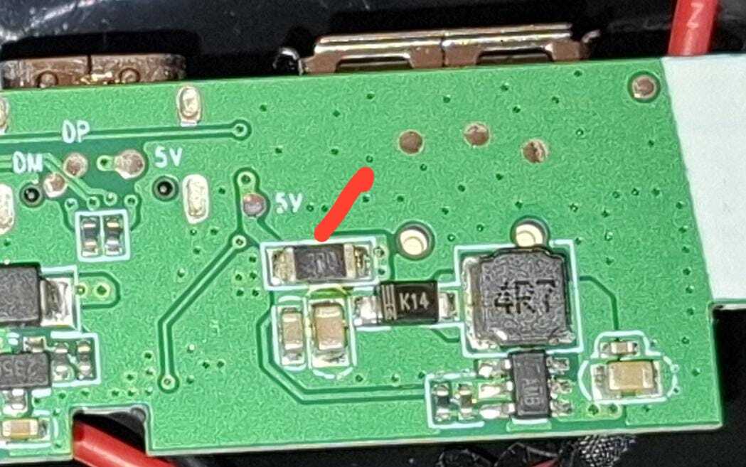

                I have finally managed to get inside.
                I have attached some photos of the board

                              • m1ch43lzm
                                • Mar 2019
                                • 481
                                • Peru
                                The LN2220PAR looks like a step-up boost converter, your microscope is powered by a lithium battery? If yes that may be to boost the voltage for the usb port
                                This AliExpress listing claims to be a "replacement" of FP6291 and MT3608, both step-up converters
                                https://aliexpress.com/i/1005008340248788.html LN2220PAR MT36291 SOT23-6 24V Replace FP6291 MT3608
                                Attached the MT3608 and MT36291 data sheets, only difference is a current limit pin 6 which may be left floating on the MT36291, I can find MT3608 modules already assembled on a PCB very cheap on ali for less than $1

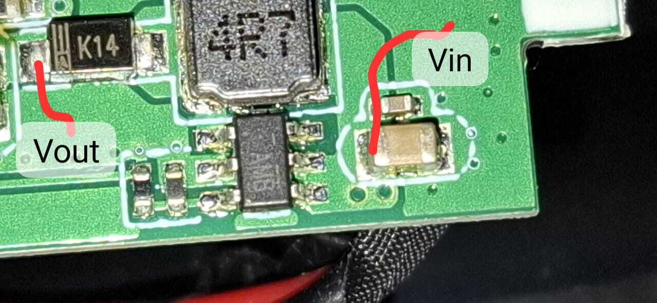

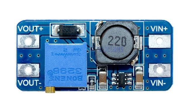

                                  • m1ch43lzm
                                    • Mar 2019
                                    • 481
                                    • Peru
                                    Measure voltages here
                                    Click image for larger version  Name:	boost1.jpg Views:	0 Size:	83.4 KB ID:	3641269
                                    At Vin it should be the battery voltage, Vout should be 5v
                                    Not sure about this resistor, is there a hole in it? To the left of that resistor is your 5v output for the USB port, measure resistance across it, it should be a very low value
                                    Measure resistance across the caps below, shouldn't be shorted
                                    Click image for larger version  Name:	check this.jpg Views:	0 Size:	85.8 KB ID:	3641270
                                    Click image for larger version  Name:	mt3608.jpg Views:	0 Size:	37.6 KB ID:	3641271
                                    One of the many readily available MT3608 modules on the online stores, the layout is very similar, you can harvest the IC from there if it's determined to be faulty
                                    EDIT: measure the current draw of your USB lights when plugged in to a regular USB power adapter, if it's too high it may have blown that resistor
                                    Maybe that USB port is supposed to work only with a USB stick for saving the pictures/video

                                      Thanks for the reply
                                      I was going to measure that resistor
                                      I will wait for the new parts
                                      The USB port is meant for the ring light and was working until one day it was not
