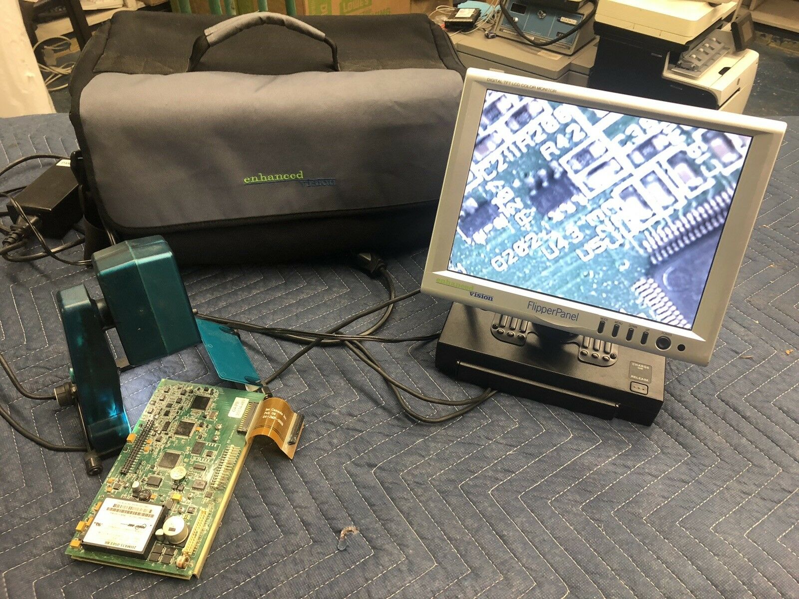

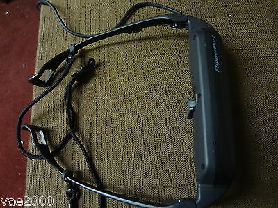

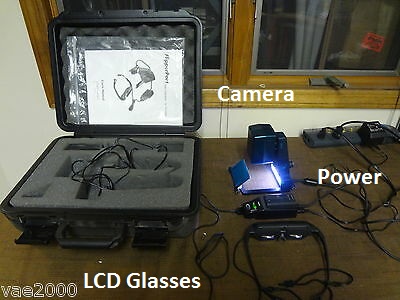

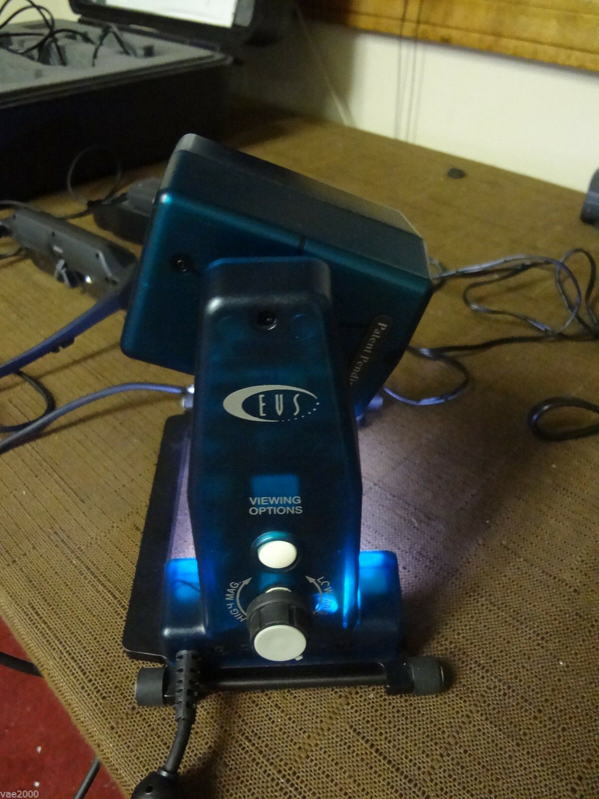

              To view REALLY difficult subjects, I use a "Flipper" that I rescued many years ago. The advantage is that you can move the camera TO the subject (instead of bringing the subject to the camera/microscope). The "glasses" are particularly useful in that you can have your head looking AWAY from the subject and still be locked onto whatever the camera is seeing.
              [I used this, recently, to repair some sensors inside a car door without taking the door apart. I'd forever have been twisting and turning to get a good view with my EYES but the glasses let me not worry about where my eyes were "pointed" as long as the camera was locked onto the target!]
