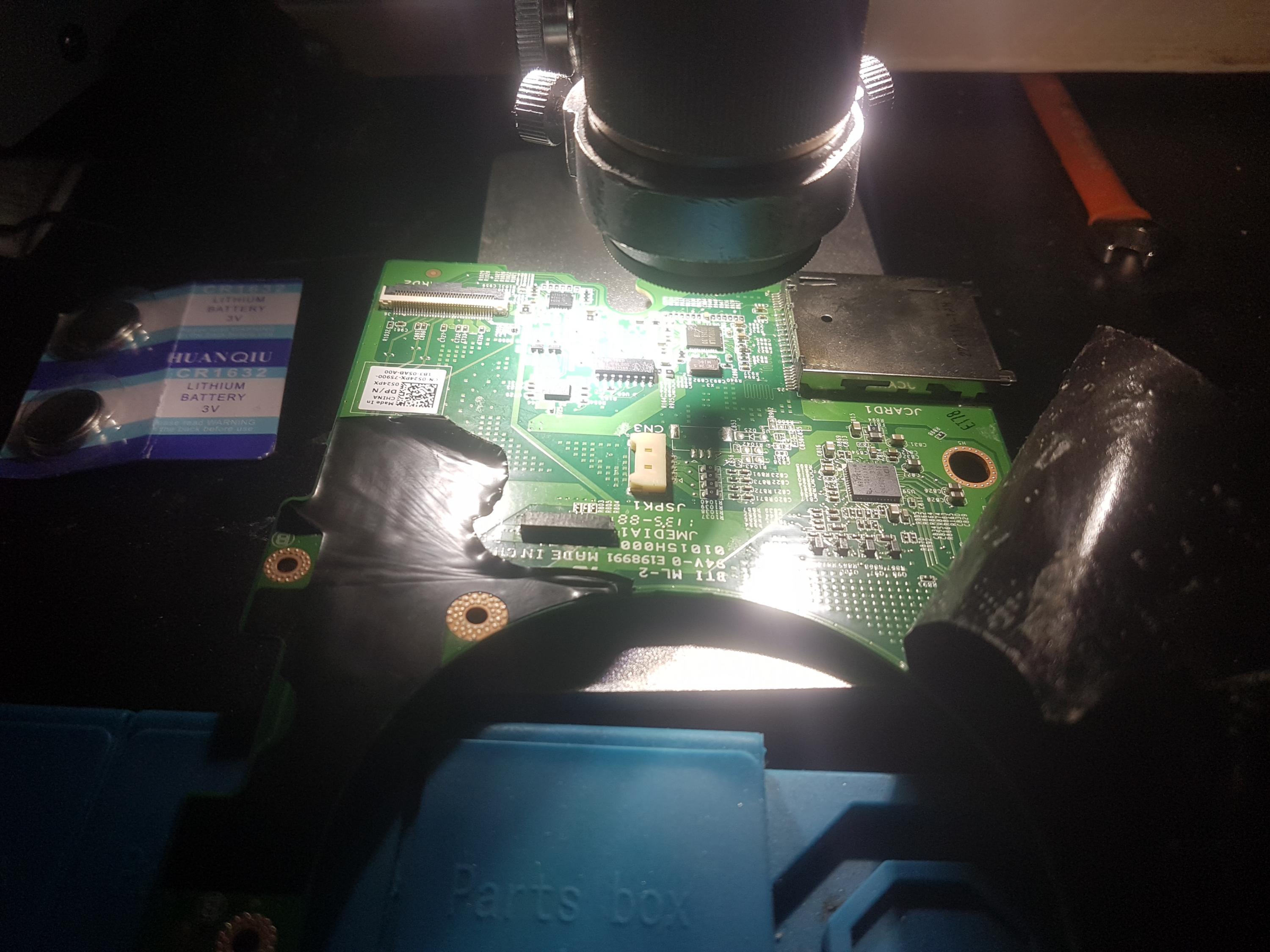

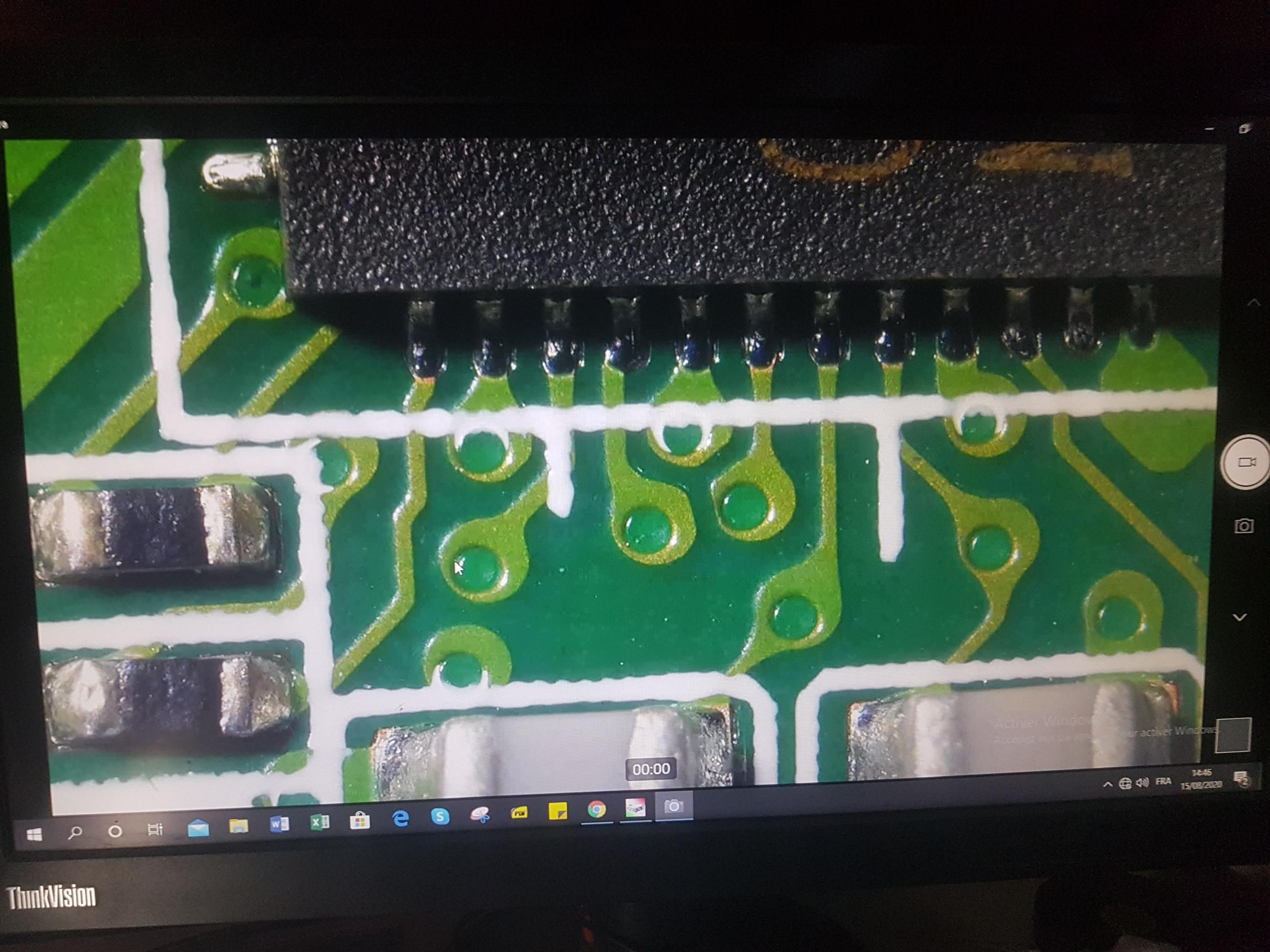

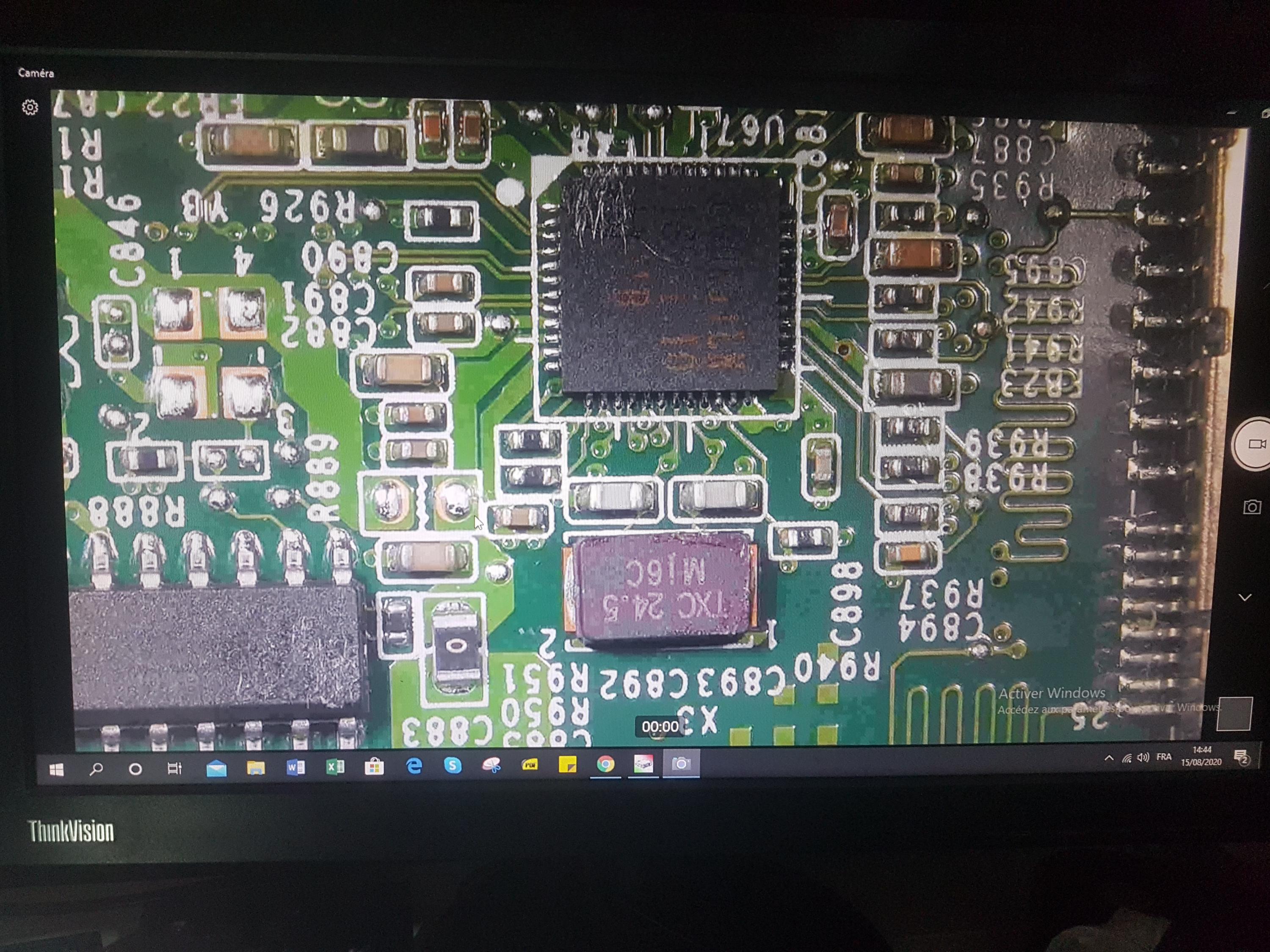

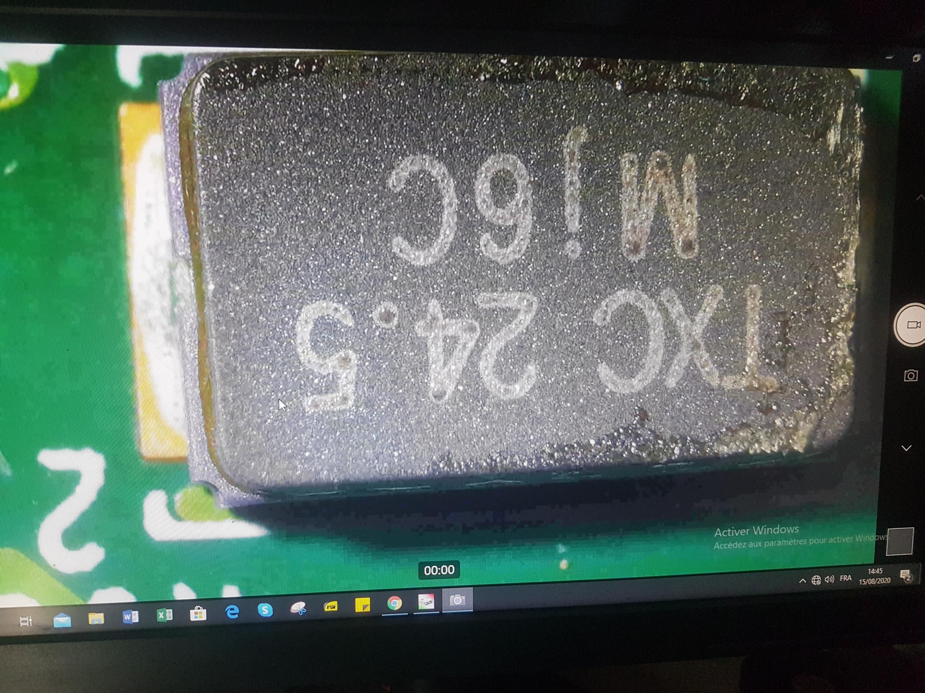

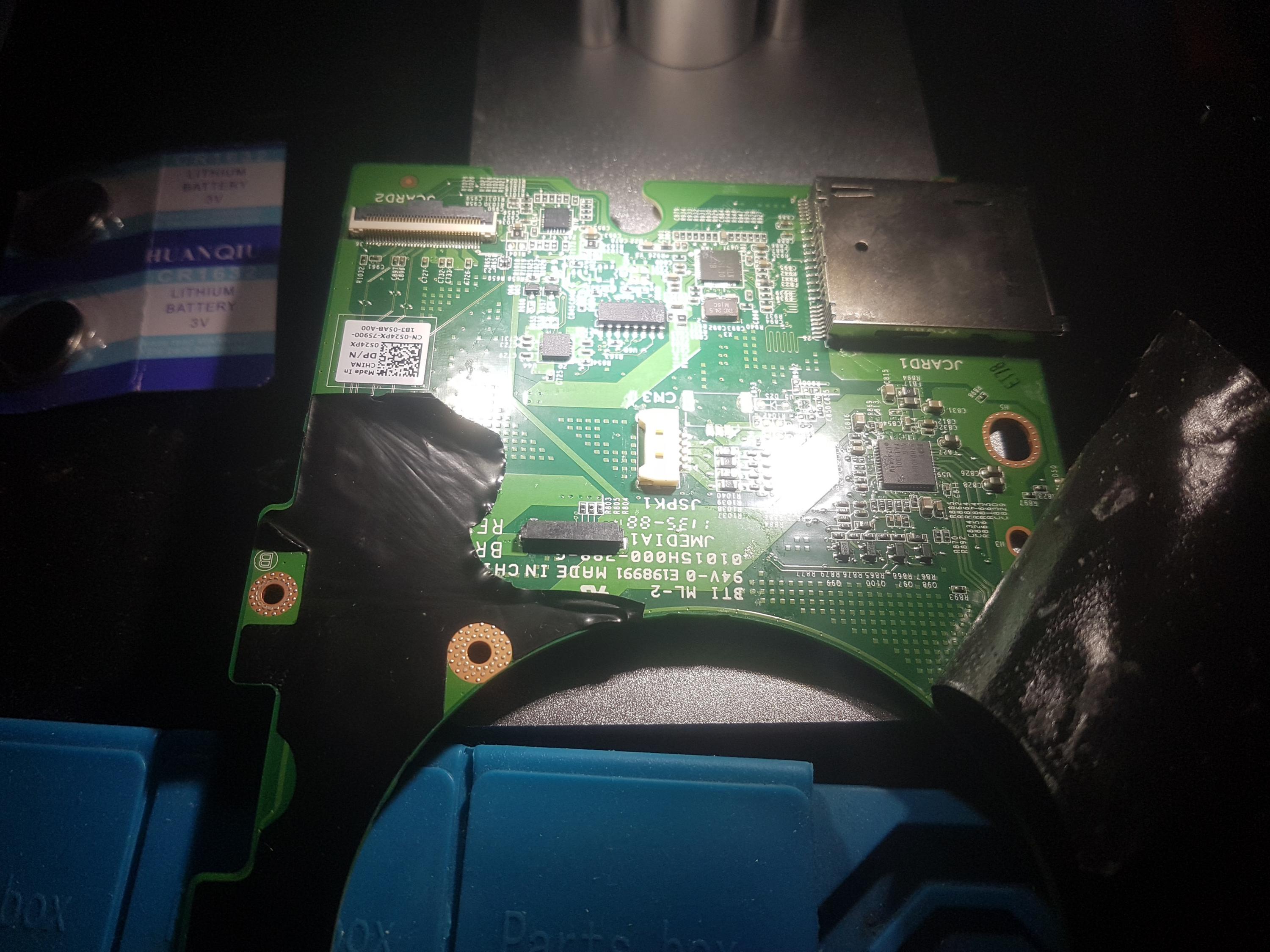

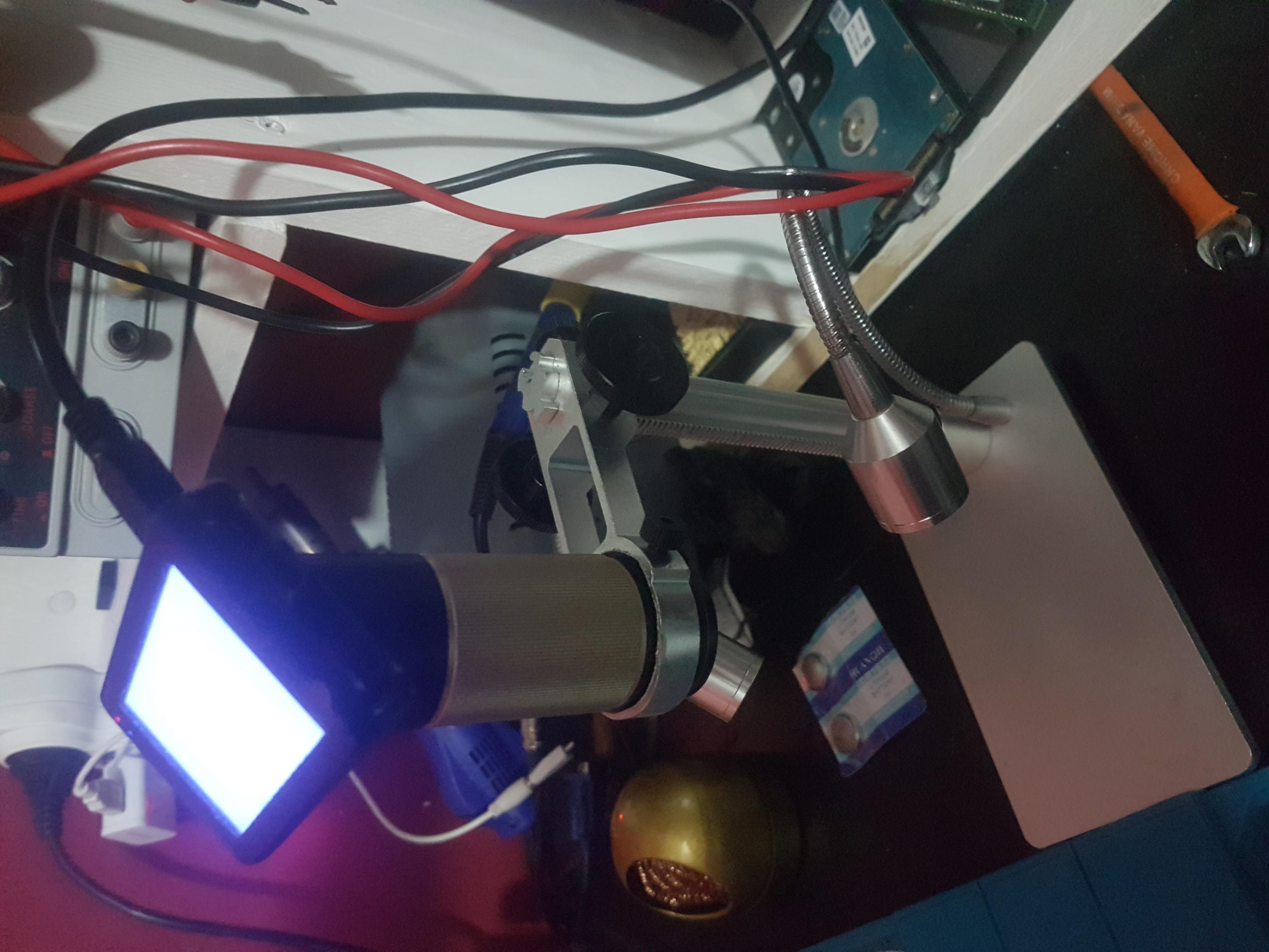

        Here are some pictures i took

          I'm still working on a DIY solution to replace the metal stand cause its not helpful at all.

            • Maxpower3
              Bad Veteran
              • Feb 2018
              • 1356
              • France
              Re: My Andonstar ADSM201 Microscope Review

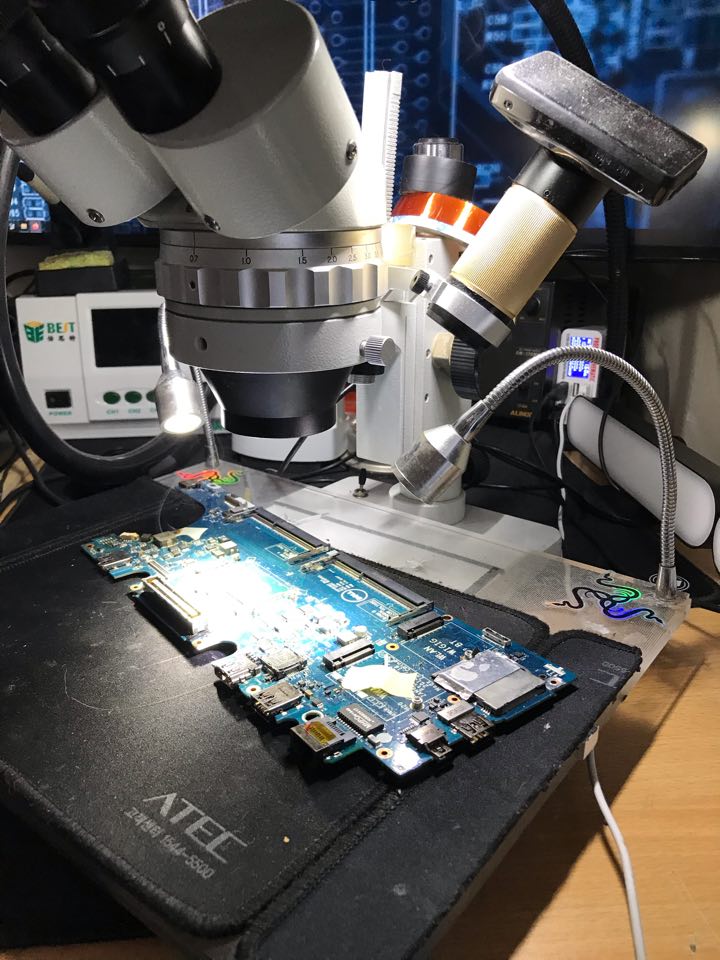

              Mine will end these last days like that.
              It helps but not very practical, compared to a microscope.
              I now use it to broadcast and video back to pc
              he survives the transplant now
