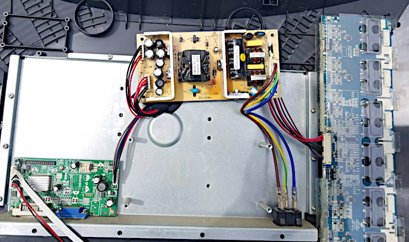

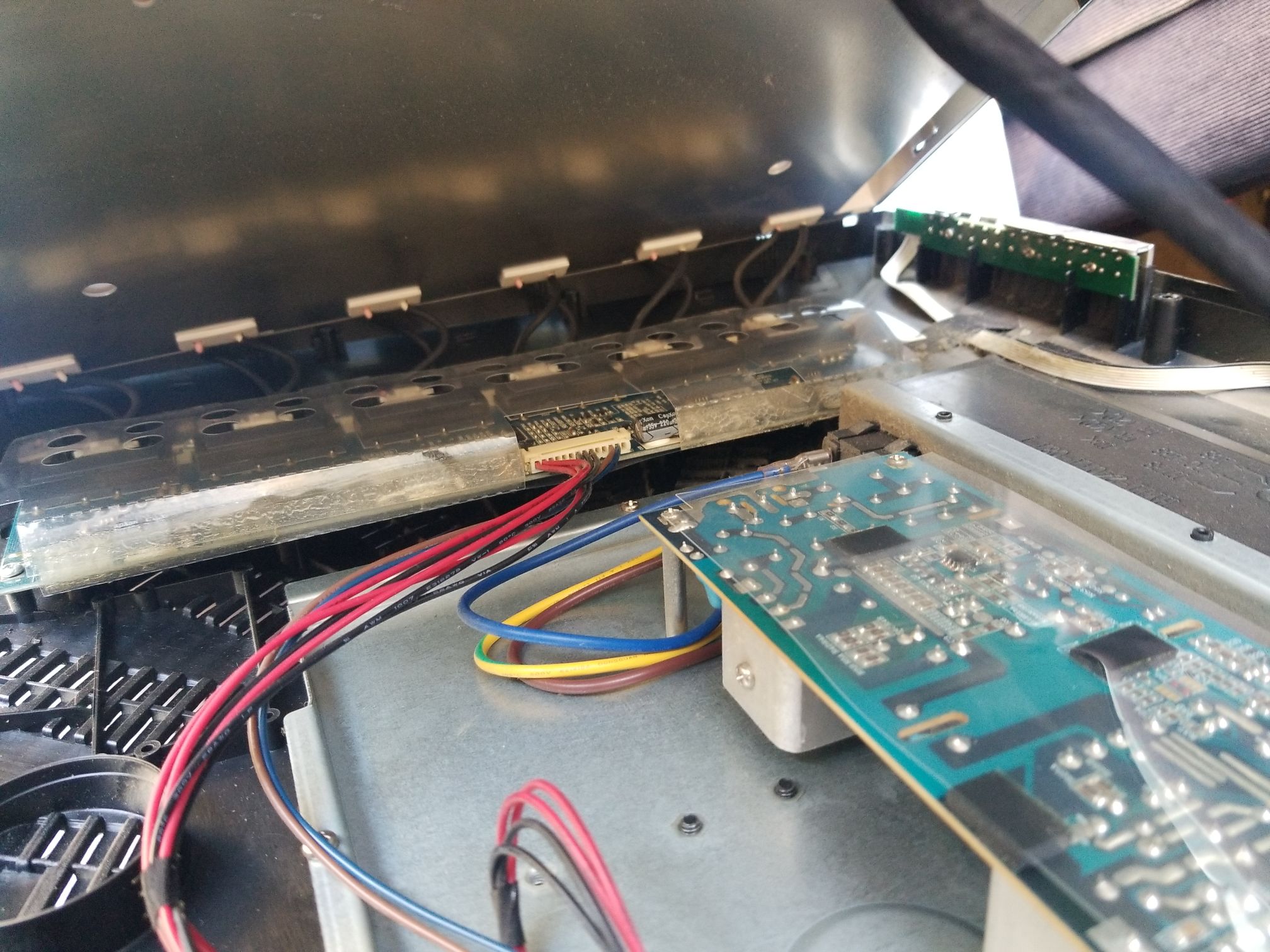

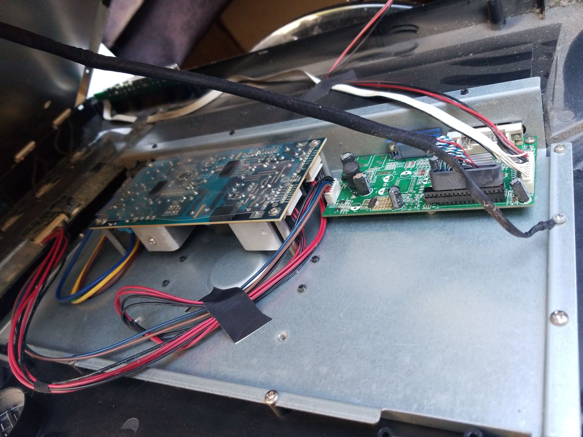

          Re: VisionQuest 24" monitor: works sometimes
          Opened the case. Best shots I could get without two sides separated.
          What do I need to take apart? I have to figure out how to unplug the various connectors to separate the screen from the back without breaking anything during the unplugging. Working things out as I go...

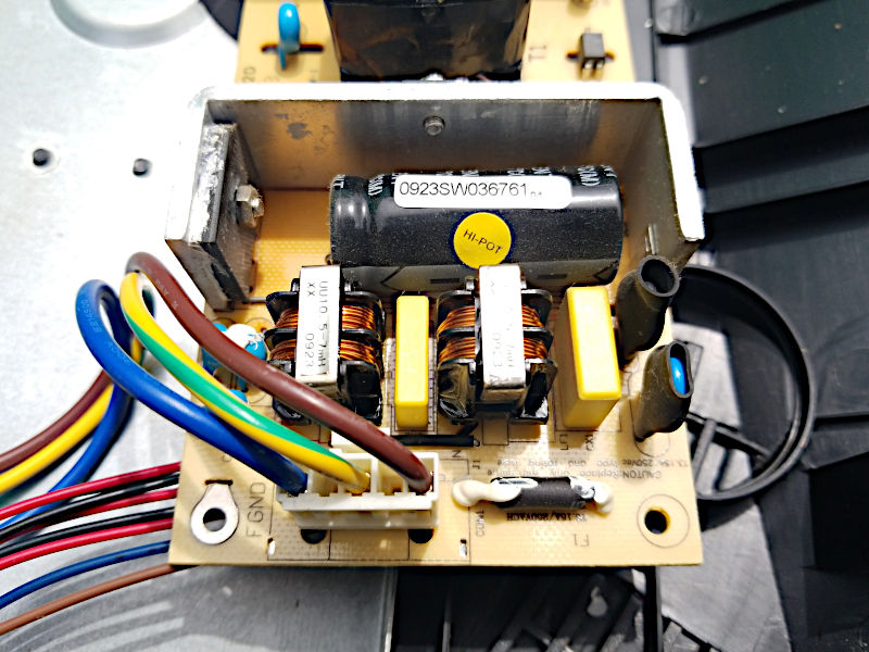

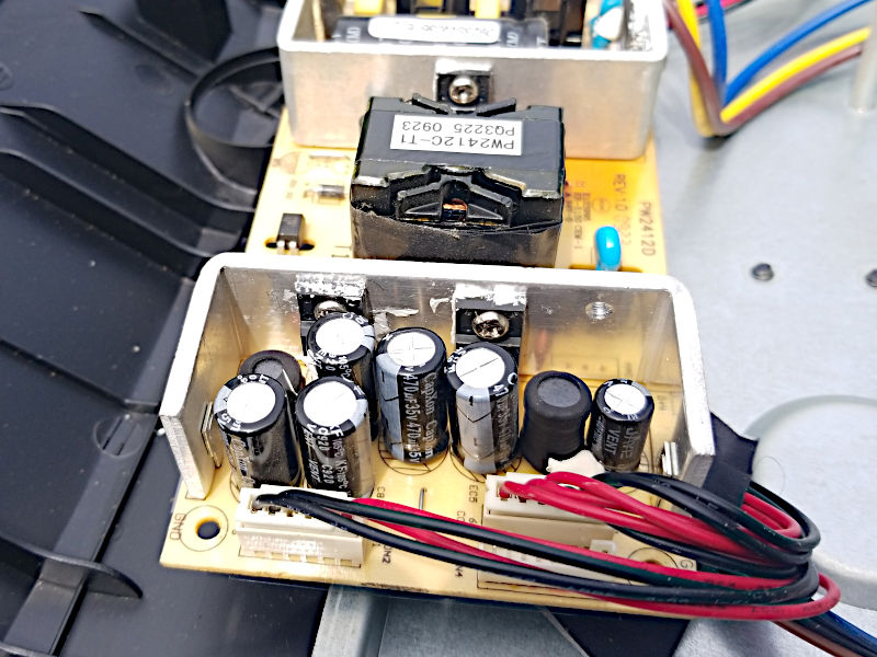

          • Curious808
            • May 2022
            • 39
            Examined the capacitors. No bulging or leaking, all look clean The white stuff on some of them I IDed as glue.
            What's next step? Do I remove all the capacitors and test them?

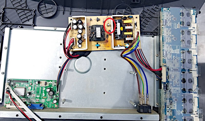

            • R_J
              • Jun 2012
              • 9591
              I would start by replacing the small electrolytic next to the mosfet in the center of the power supply board, this cap can dry out over time and result in the power supply not starting
