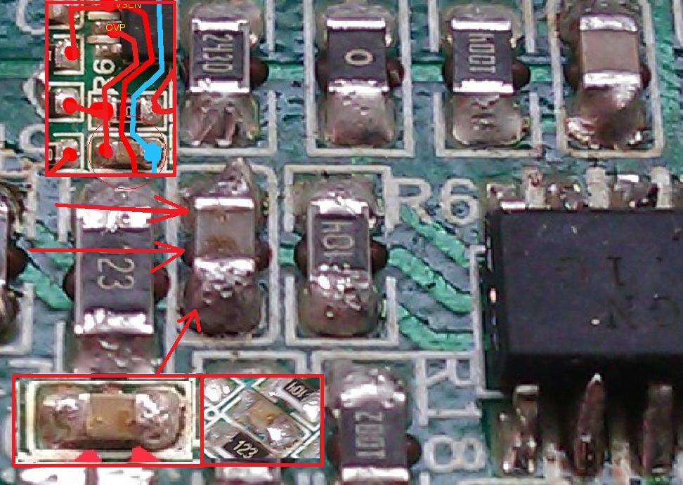

      Thanks PlainBill.
      Thinking about that OVP input I took a closer look at it. Makes me wonder if I've found a bad capasitor. At least it looks like there are fractures in it so I think I better change it. How could I identify it's capasitance as I have no schematics.

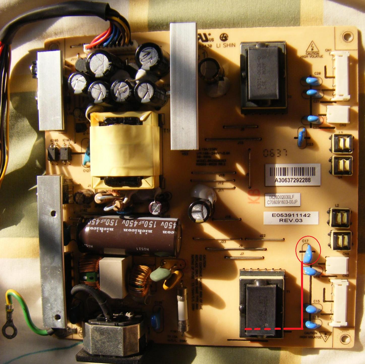

        Re: HP w20 LCD Display Inverter, running out of options.
        I was watching some old pictures and it looks like that cap was looking allright when I got this monitor. It must have gone like that during testings or when resoldering it.
          It's going to be difficult to determine the value. The first step would be to determine which pins on the IC it is hooked to. There are several timing caps that set delay times. If this is one of those, it will be fairly easy to select a 'common' value.

            #105
            PlainBill
            It's connected to pin 7, OVP, parallel with that 100kΩ
              Try something in the range of 1 - 10 nanoFarads. If you have a junk box with through hole ceramic caps, experiment. It shouldn't be critical.

                  #108
                  I got replacement cap for fragmented one. I purchased MMC with capacitance measurement capability and found out it was 98 nF so I replaced it with 100nF
                  I measured also IC pin 13 (CT). I don't know if it means anything but if I measure it with multimeter, backlights immediately go off and AC voltage goes like this:
                  1,8 V~ -> 9.9 V~
                  Seems pretty sensitive circuitry... even though in this situation monitor can be switched back on immediately.
                  You bring up a very good point. Q22 appears to be SMD code RKM; Q23 certainly is. That is a RK7002 MOSFET. Because of the way it is wired, it certainly changes the voltage on the OVP input of the controller. Because of the tests you did with jumpers we know that reducing the voltage on the Vsens input will prevent shutdown.
                  PlainBill
                  I was wondering would it be worth trying to get rid off Q23. If that is the part which screws VSENS input signals, removing it like it's been done on REV 3 board might help?
                    1,8 V~ -> 9.9 V~
                    Try it.

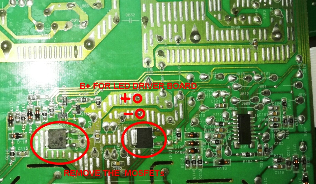

                                      #118
                                      I need help. I'm want to update my hp w2007v from ccfl to led.
                                      I've already buy the led stripes and led drivers.
                                      Can somebody help me where to find 12V for drivers on this board.
                                      If need any info please tell me.
                                      Pictures attached.

                                          #120
                                          See picture for the B+ for the LED driver board.
                                          You still need to locate the BL_ON signal and the Dimming signal to control your LED backlights.
