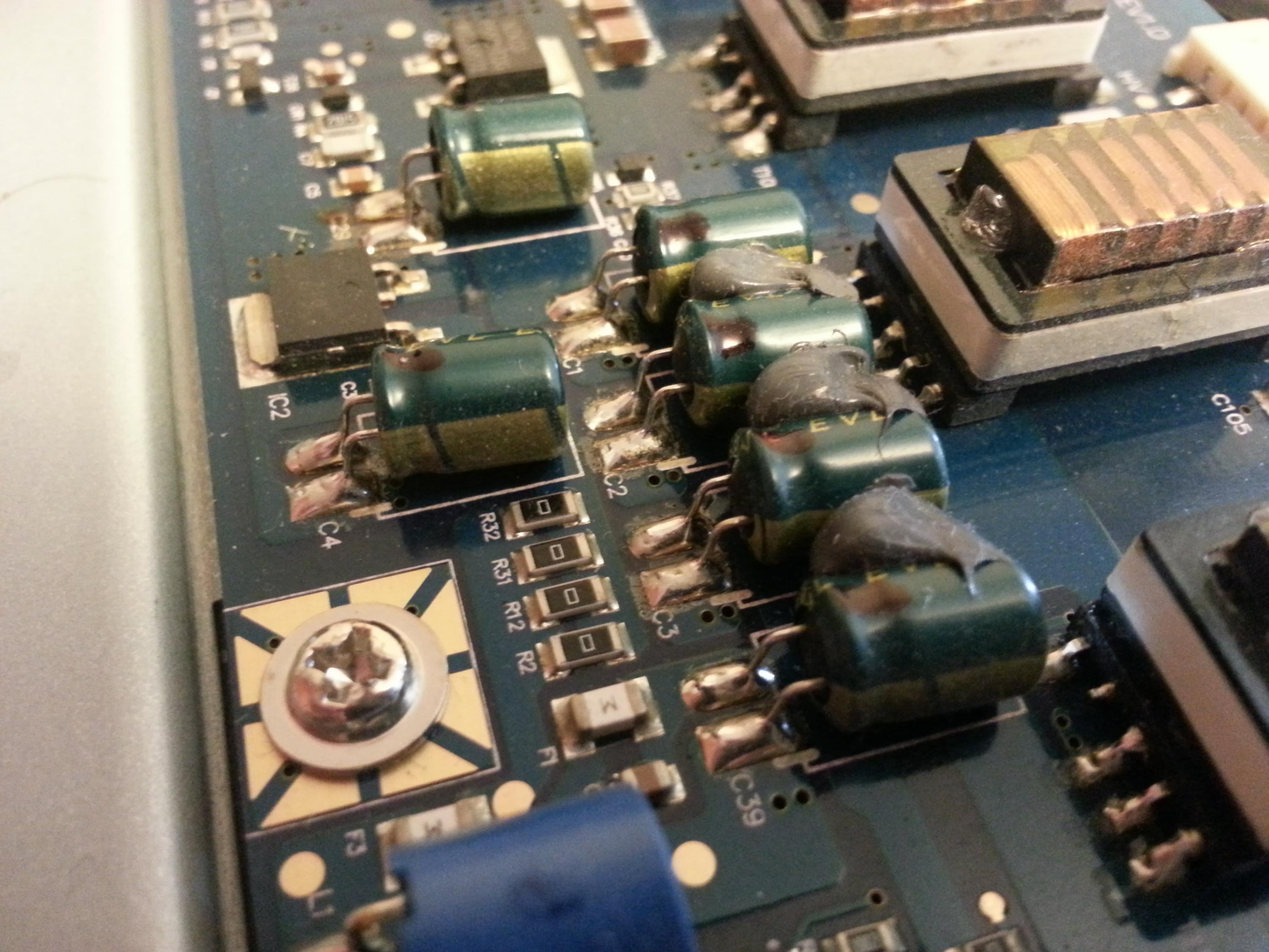

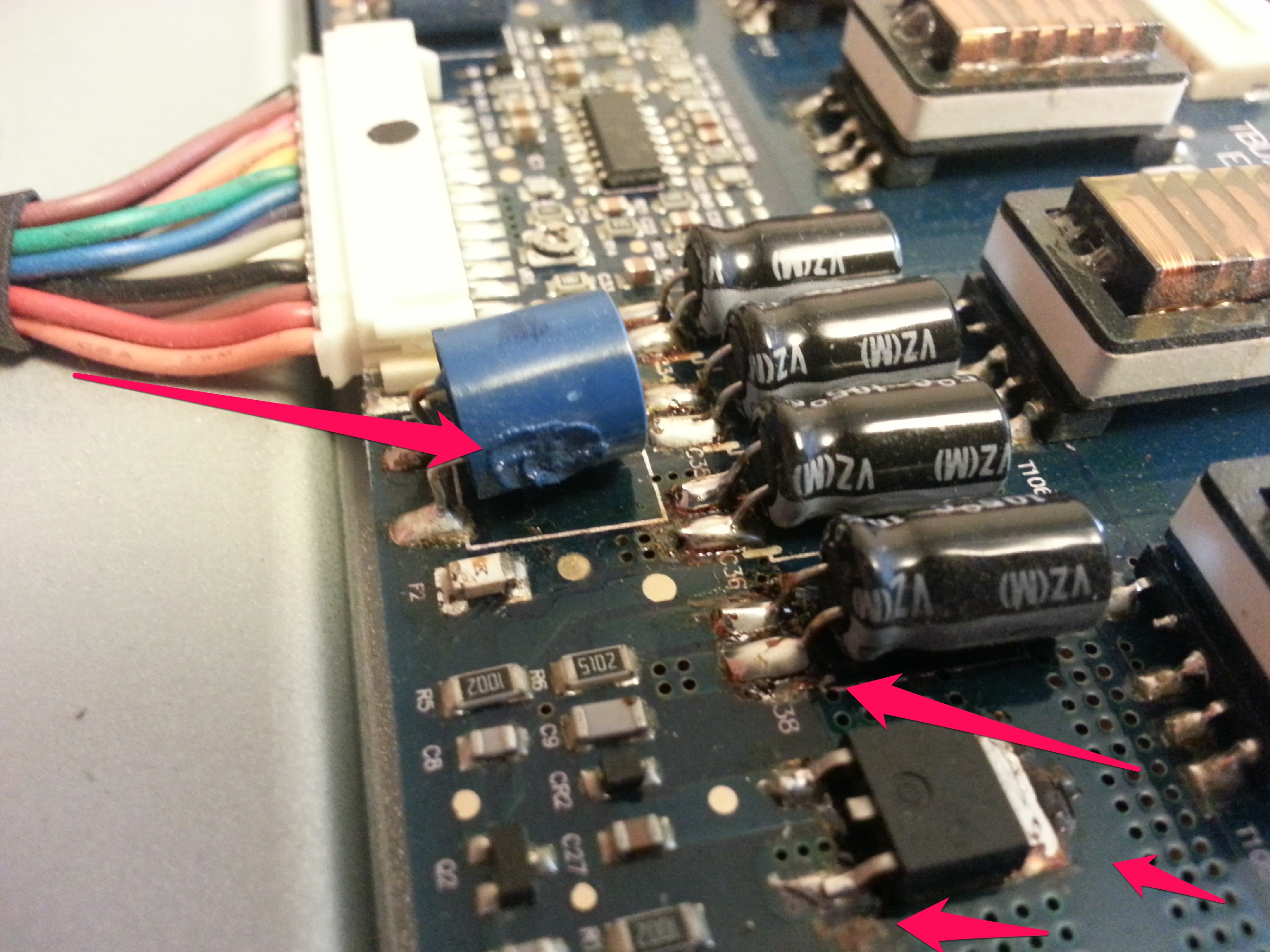

                So I have this same monitor it displays the ACER logo when you turn it on then goes black, and the LED stays green when there is an input, amber when there isn't. I was checking out the inverter board and looks like I need to replace the 10 usual caps, but it also looks like I need to replace one of the plastic blue ones and I have no idea what to replace it with. Here are a couple of pics of my inverter board

                  That blue component is an inductor, you did not damage it that bad, just melted the plastic case, that's all.

                    Re: Acer AL2416 AL2416W 24" 1920x1280 LCD Monitor
                    I take it the first picture is the right side and the second picture is the left side? This is what happens when the guy ahead of you does a half baked repair. He should have replaced all of the caps in this case, to prevent future problems.
                    You'll also want to check the (2) NIKOS P2804BDG mosfets and the (2) NIKOS P5504EDG mosfets. And the (3) little white fuses marked with an "M".
                    When the repair is done properly, it will last. If it turns out you have a shorted mosfet, just send me a PM. I think I have a couple extra's somewhere.
                    And like budm says. Don't worry about the blue plastic inductor. I did that once too when I wasn't paying attention. Wondered where that burning plastic smell was coming from.
                      Yeah my friend bought it from Goodwill, so who knows who had it before and the inductor was like that so I wasn't sure about what happened but yeah looks like whoever tried to fix it got a bit too close Thanks! I'll check those out ASAP which might be awhile since I'm flying down to Cali.
                        There are a few threads about this monitor in this forum, did you already read them? Search for '2416', '2416BW' or simply for 'Acer'. I posted my efforts in repairing my 2 2416's in a number of threads, one of them is https://www.badcaps.net/forum/showthread.php?t=17052 They may prove helpful in your repairs.
                        I'd start with replacing all the caps on the inverter board. The original ones are relatively small, so you have to make sure the replacements will physically fit. And do watch out for the correct polarity when soldering them in!
                        Looking at your photo's the coil does not appear to be internally damaged. It can't hurt to measure both coils for continuity, as you now have the monitor cracked open anyway. But I highly doubt there's anything wrong with it.
                        The FET's are difficult to get hold of, but judging by your description I don't think they're kaput (yet). If either they or the microfuses were shot, you would not even get a visible image for just a few seconds.
                        If replacing the caps doesn't result in a stable picture, it's probably the HV circuitry or wiring to the lamps that's defective, maybe the lamps themselves. Bear in mind that replacement lamps are expensive and very delicate. They break before you even know it (speaking from experience ).
