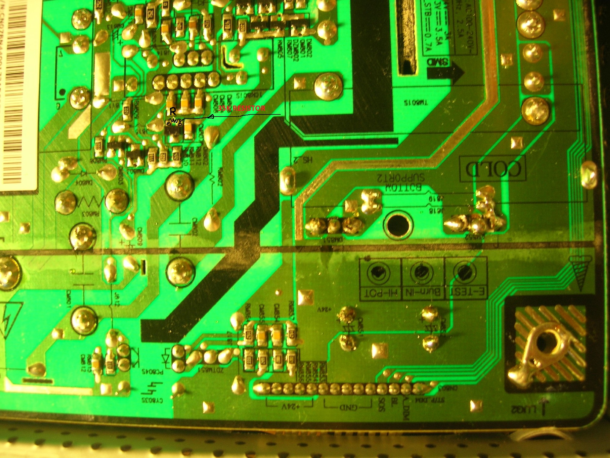

      Is the 24V rail jumping only with all six inverter outputs connected to the backlights or were you able to determine if the 24V was stable if one or more of the inverter loads
      was disconnected ?

          Do you think leaving some of the inverter outputs disconnected is detrimental
          to the inverters ? I was able to at least see and determine the screen was
          stable when I left one of the six inverter output disconnected for about 2-3
          seconds before the inverter board decides to shut off. I checked out all six
          inverters one at a time and they all showed the screen without flicker during
          those 2-3 seconds before the screen goes black. This process told me the
          inverters and the backlight are ok and the problem is with the 24V.

                  A little explanation fo my mod: during shut down time, this br npn transistor must go open and stay open, but for some reason of residue electricity remain conductive and because power supply is in shut down operation and no power is anymore supplyed to inverter and main board voltage jump rapidly to dangerous value, and burn the m2power controler. Some ideas to this i get from burned resistor found on this power supply.

                                          I have the same monitor and i have the same problem.
                                          Resistor RB805 burned, QM802 also have a open circuit.
                                          If ICM801S (Fuji Electric controller f9222l ) is working, I don't now.
                                          Question:
                                          Is there a way to measure f9222l?
                                          Can i meassure with not connecting the invertor board?
                                          I have tryed with a temporely NPN transistor (BC547B) with a 10 omh resistor on base.
                                          No luck to get power on PCF4863G (pin 8 close to zero volt)
                                          Can i be sure to buy a new f9222l IC
