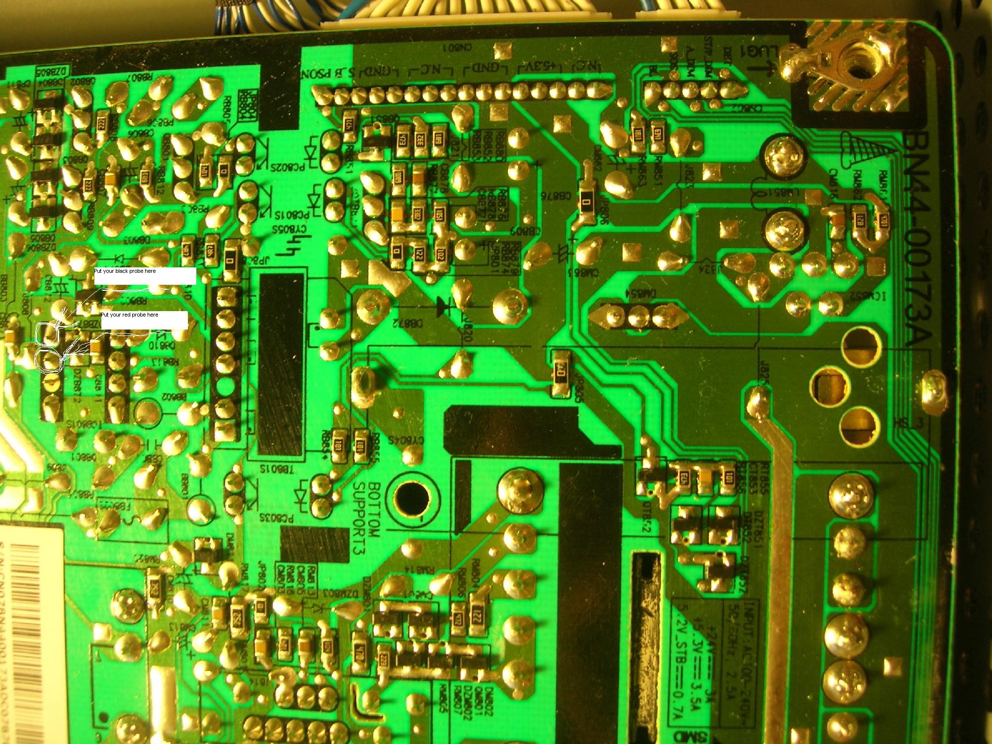

                  Found this too

                    Re: Samsung Syncmaster 245BW
                    Originally posted by stewart710
                    Found this too
                    That looks like the power supply controller. I'll have to absorb the details and figure out what points to test.

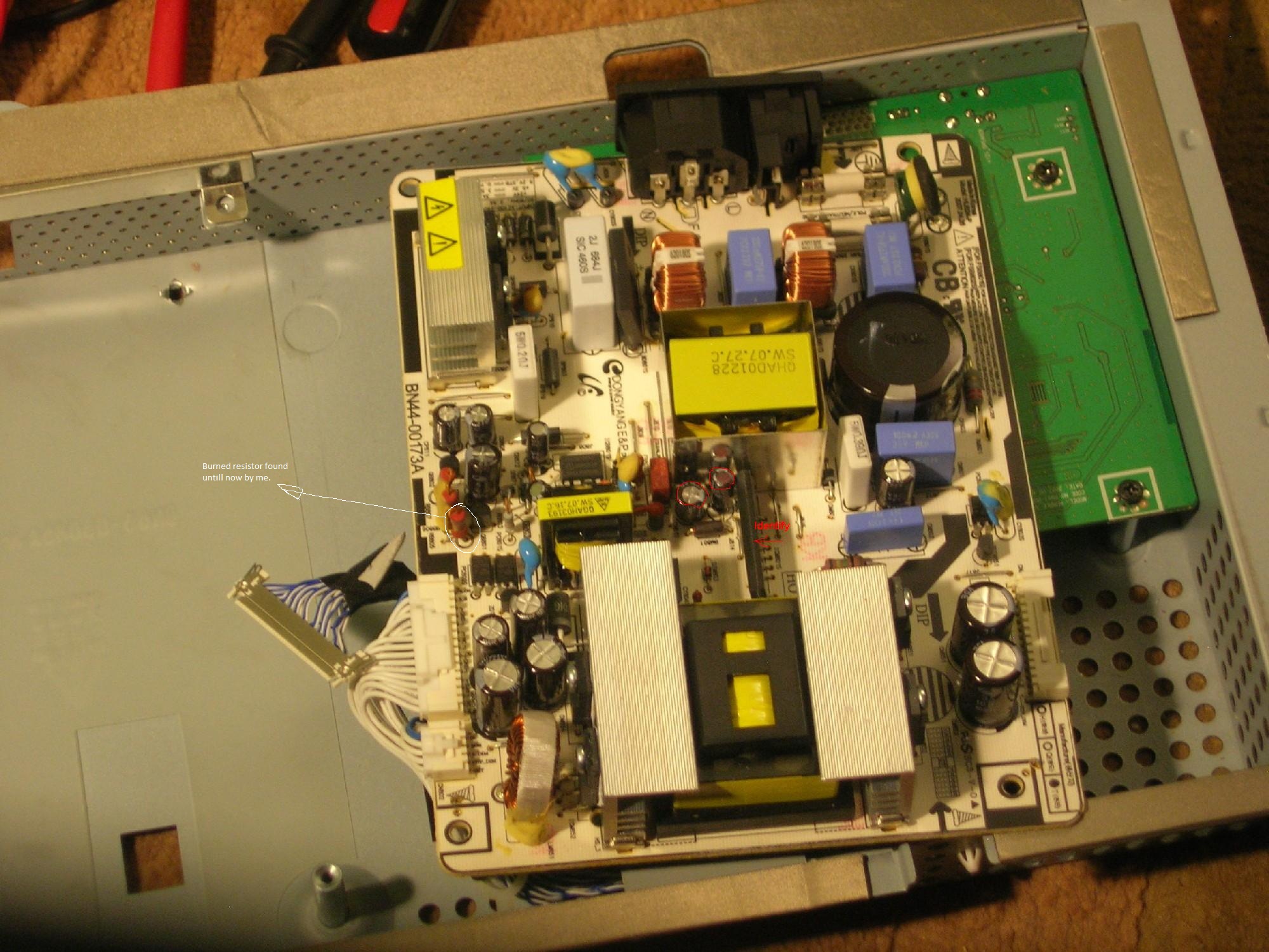

                                Me to trying to find the solution on same monitor, samsung syncmaster 245b. Simptoms are the same like yours here. When try to power on, only blue led on the on button lit blue. Monitor dont start, inverter dont start, but there is a 5.2v standby power. This is the only voltage from power supply. No 24v or 5.3v, Found burned resistor RB805 68ohm. All caps ok, tested with esr tester, and tested for capacity. Tested all other resistor, all found ok. When testing for voltages on vcc pin on ice3B0365J found strange voltage, 11v-16v dc fast changing values, testing for ac was 30v-35v on the same pin (. Tested diodes for vcc pin power and found all ok, then try to change this two diodes with similar, and again nothing, same strange and not stable voltages on vcc pin. Other two integrated circuit are without any power supply. Tested optoisolators , and all seams good. Tested all other diodes and rectifyers, and everithing seams ok, but power supply just dont start. So for now, only one resistor burned, and changed. Ordered new ice3b0365J for 5 euros and maybe in 2-3 days will arive. I dont know if this will fix the supply but i will try this solution, and if you didnt solve the bug on this monitor, and dont have any sugestion or news on your problem, wil change the ic and see if this was the reason for dead supply. Any sugestion or help is greatly apricieted.
                                    This is the photo made from you, i only marked burned resistor.
                                      My resistor appears fine, reads 67.4 ohms

                                        Did you test the ics for supply voltage?? Try to test to see how is your voltages on the chip. On your picture i will mark test point for dc power supply on this chip, try to test ac voltage on the same test point. Let see how is yours reading .
