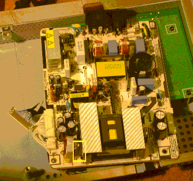

    Originally posted by mladen82
    I can't find that ic on my board!!!???
    This 5 pin IC regulator is mounted to the heatsink that is closest to the two
    connectors going towards the logic board. Check the attached picture
    (Board.gif) showing where this part is exactly.
        Ooh yes, i saw
        thanks
