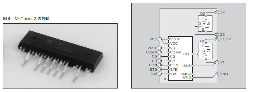

            I go these voltage measurements for you on the 24V Fuji Electric controller.
            All the voltages is referenced to pin 8 on the IC which is primary hot ground
            (as opposed to secondary ground). When making the voltage measurement on the IC please be careful with the meter probes and do NOT slip as the pins are
            very close to each other and you do not want to short one pin to the other.
            The F9222L IC has pins that are not populated and some that are cut. You still
            need to count each pin# even though they might not be present. For instance the first three pins are not present but I still needed to count them starting from 1 to 3. The first pin available is pin 4.
            All measurements referenced to pin 8 (ground):
            Pin 4 - close to zero
            Pin 7 - 19V
            Pin 10 - 4.94V
            Pin 11 - 1.26V
            Pin 12 - 4.94V
            Pin 13 - 3.03V
            Pin 14 - 1.02V
            Pin 15 - 4.93V
            Pin 16 - 0.50V
            Pin 23 - 391V
            Remember these voltages are with the 24V output working so you should
            get different measurements as your 24V output is not working.
            See attachment for the pinouts for this Fuji F9222L controller.

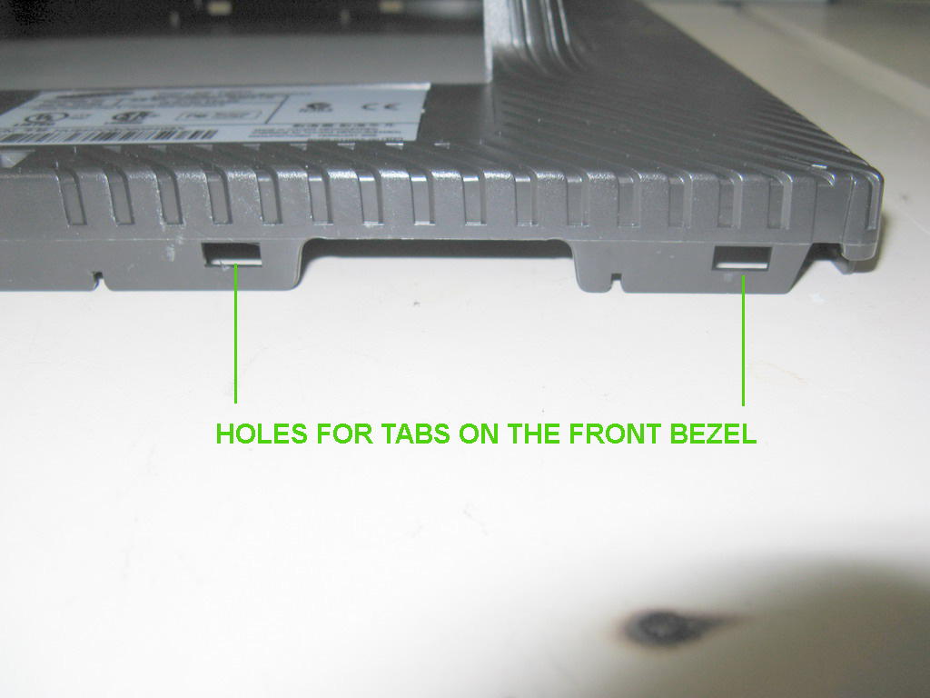

                    Hi guys, I have 2 of these and one of mine has failed too. I was hoping that you might run through the process of opening the case without ripping it to pieces...

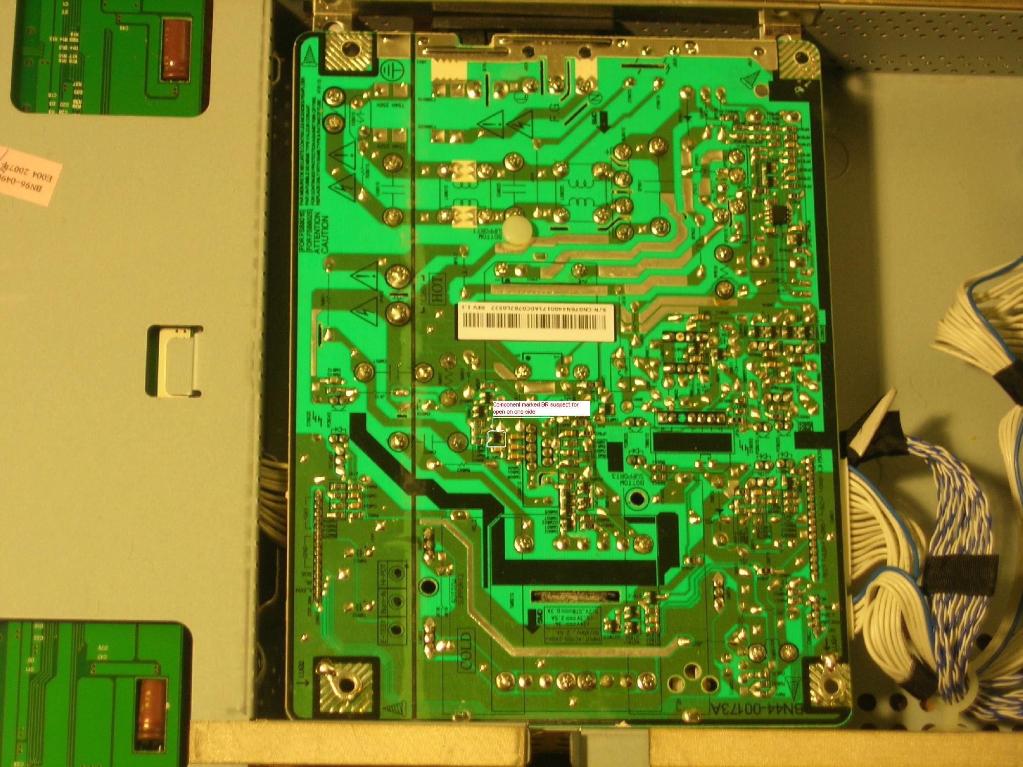

                          I have exact problem with Syncmaster 245B, model code LS24HUBCBQ/EDC
                          Power board: BN44-00173A
                          Standby voltage +5V is present but no main +5.3V and +24V for inverter
                          Stay tuned for problem seeking.

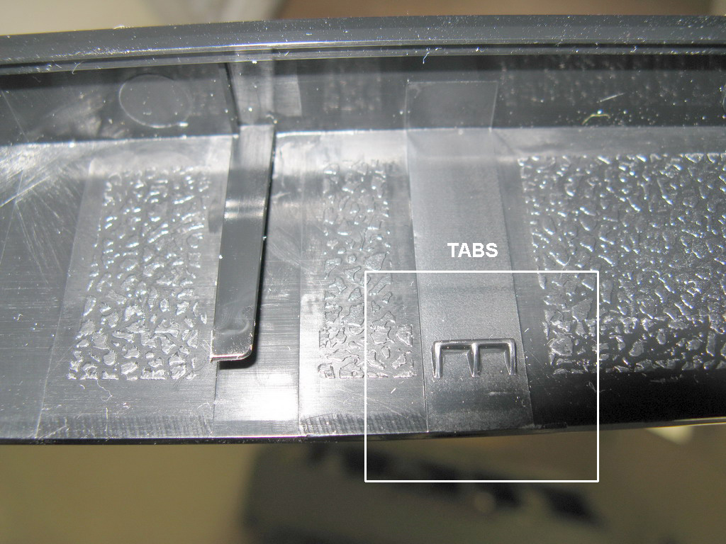

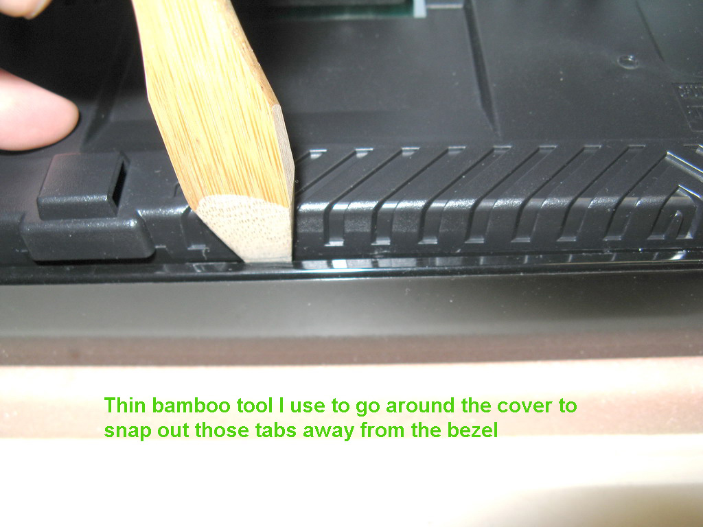

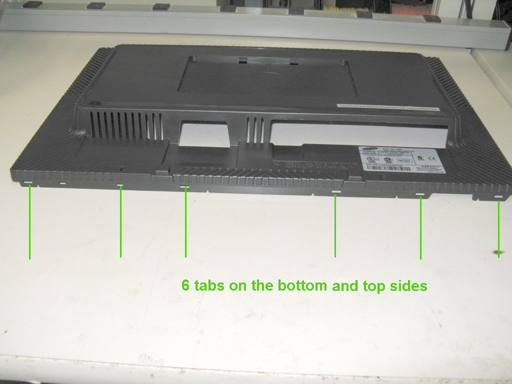

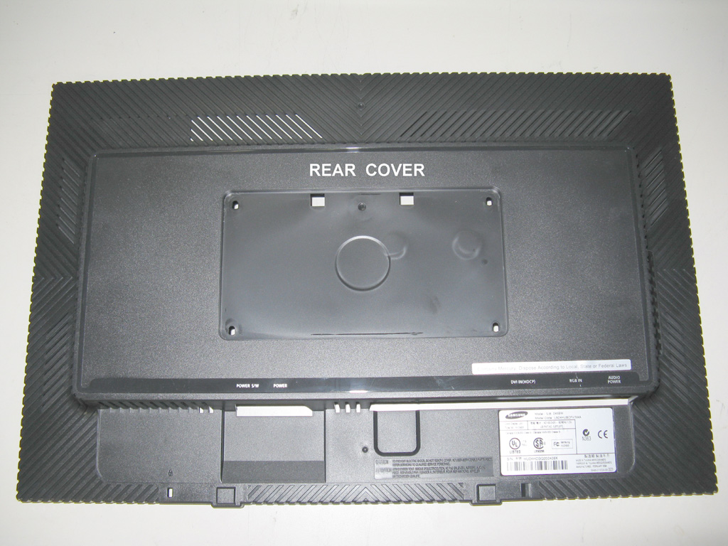

                            Attached are pictures of the tabs on the bezel you will need to pry and pass
                            them by to remove the cover. There are 6 of these tabs on the top and
                            bottom ends and 4 on each side of the monitor. I have a home made bamboo
                            tool I use to go around the periphery of the cover and bezel to snap each of
                            these tabs away from the cover one by one. Once all of them are off the
                            cover you should be able to remove the cover easily. You can use two flat
                            blade screwdrivers in a pinch to remove the cover. I usually start the opening
                            of the cover somewhere near the middle top or bottom side. Use one
                            screwdriver to hold the initial position and a second one to go around the
                            periphery of the monitor. Good luck.

                                    I shorted Stb +5V with PS_ON pin, so i can simulate Power On state.
                                    I done some measurement, voltage on primary capacitor CP803 is 310V, so i assume PFC controller is not in working condition.
                                    PFC controller is 4863G, VCC is 0V in Power On state, so PFC is not running.
                                    Will continue to troubleshoot this.
                                    • mladen82
                                      • Mar 2009
                                      • 39
                                      • Montenegro
                                      #58
                                      Re: Samsung Syncmaster 245BW
                                      Ok, problem is solved with replacing burned resistor RB805 (temporaly with 45ohm).
                                      Now i reading both main voltages +5.3V and +24V.
                                      PFC was not in function because of open RB805.
                                      Thanx cloepula for resistor
                                      In for turn, i measure normal condition (PS ON) voltages VCC for IC's
                                      VCC voltage on ICE3B0365J - 12,5V (stable)
                                      on PFC 4863g - 15V (stable)
